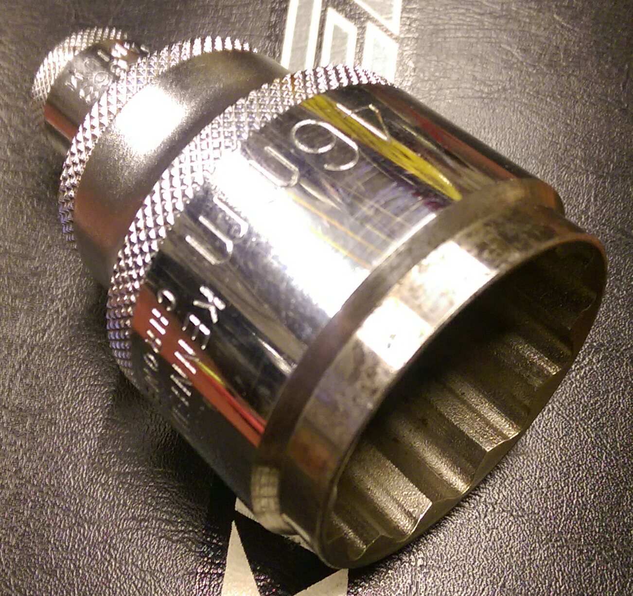

46mm socket

    If you have access to somebody with a lathe I would recommend turning the o/d down to about Ø56.5mm for the first 6mm or so, the socket then fits inside the recess of the cone spacer and gives you full contact on the nut flats.

    Yep. That's what we did
