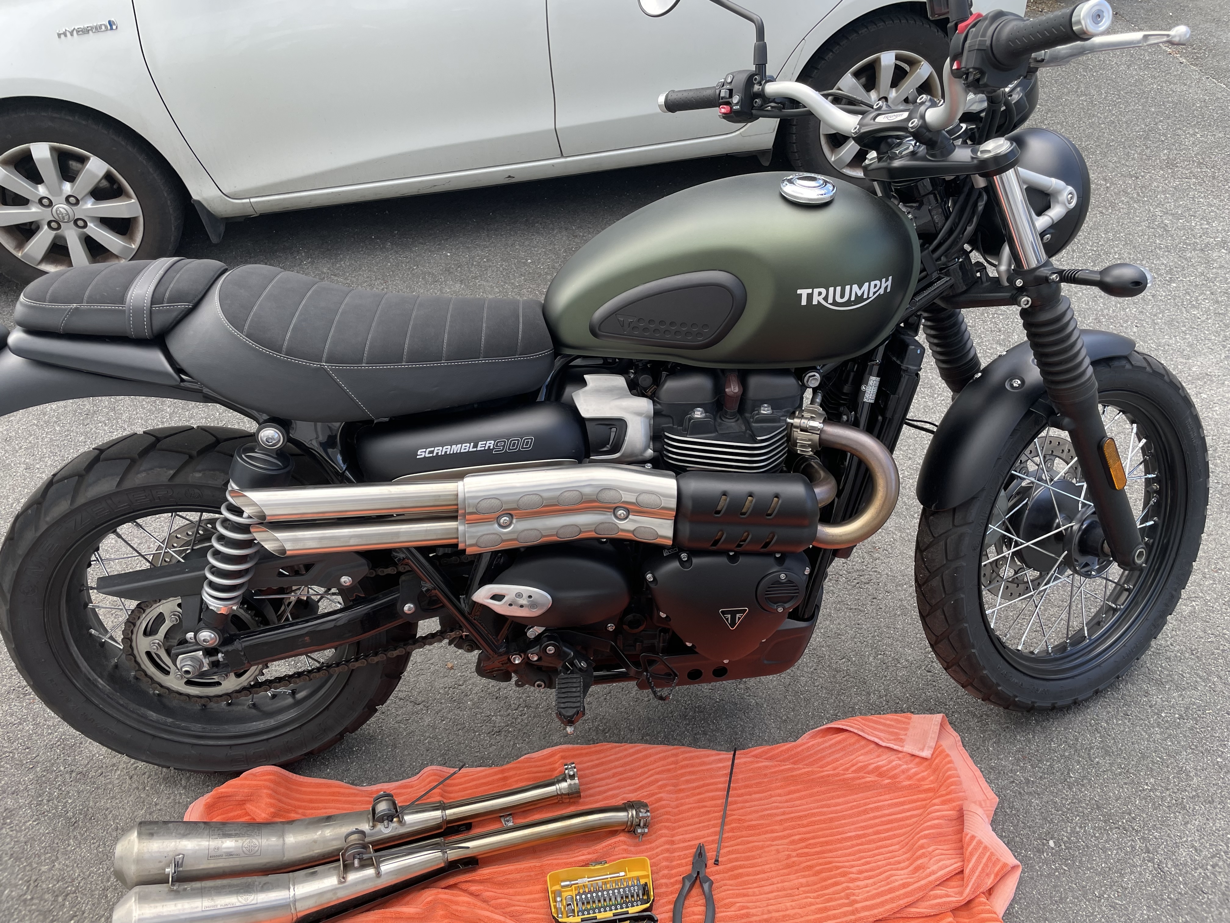

    Is there a reason you want to remove your catalytic converter? I just installed Total Triumph´s Guy Martin exhaust (see picture attached), and the sound is crazy loud even with the cat still in place. Installed some baffles to it and it even feels like there is alot more power. You dont have to remap. Either start the bike cold and let it idle until the fan comes on, wait for 12 minutes, and then its done, or just drive with it and it will remap itself over time.

    Thanks for your input. I thought a cat delete would help “wake it up”
    a bit. Your bike looks great. I don’t want crazy loud, just a little louder. I also want to just get on it and ride, not wait 12 minutes.
