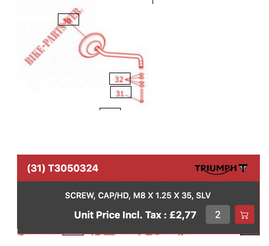

    OOOPS....got a few more pics in there than intended. But the drawing is the schematic for my mirror set up. That makes me wonder about the orientation of your extenders and whether they would work on my bike.

    To some digging but found the spec for the mirror fastener and it is 8mm.

    All good questions, Seedman. The lower end is not threaded. I expect that you could use the 8mm hex bolt to connect to the bike from underneath (might need a longer bolt). The upper end is where the mirror is mounted and it is threaded. You could thread another 8mm bolt into your mirror, cut off the head and use a lock washer to mount to the threaded end of the mirror extender. No damage to the original mirror. Or you could install a bolt from underneath and thread the mirror onto it (use Locktite or a lock washer). Also, completely reversible if you don't like the result. Your only risk is the price of shipping a small package.

    It now dawns on me that you could reverse the mount! Put the threaded end onto the bike mount with the 8mm bolt included, and use the unthreaded end to mount the mirror with the original mirror mounting bolt! Easy peasy!
