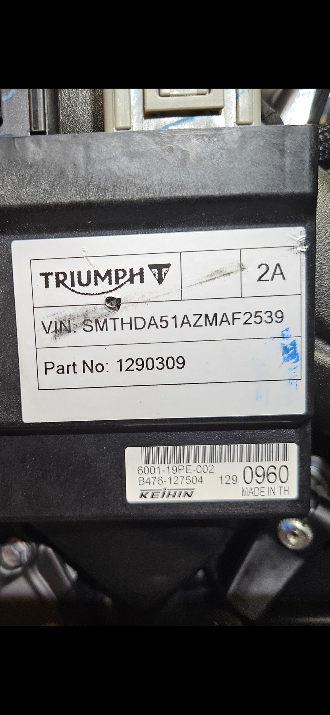

    Hey, I have a question about my ECU in my 2021 Street Triple S 660. I want to get derestricted tune but my guy is saying that this ECU is different than most 660/675/765 and has different chip Keihin RH850 instead of SH72531. I thought that they stopped putting RH850 like ages ago. But even if its there (see part number and stickers on ECU) could he use tuneecu or tunebuy like with any other Triumph? Cheers

    Triumph are making it more and more difficult to access the ECU with different chips, the standard Tuneecu and Tuneboy will not re programme the ECU, however there are a couple of companies that can do the work such as Woolich Racing. Woolich Racing Tuned (WRT) Software

    There is a huge difference between them yes, that is why I mentioned Woolich Racing, your tuner can purchase the software map direct from them, many tuning companies have been struggling re mapping Triumph ECUs due to Triumph making it more difficult to do, Woolich have devised maps for a number of the newer Triumph models, they have completed hours and hours of development to re programme these road machines, if racing a bike then it is a lot more straightforward (although very expensive to do). For road use it is better to fit the Rapid Bike Evo as this costs about the same as having the ECU re mapped and machine set up on a rolling road, the RBE is a plug and play unit, it smothers out the throttle response whilst making the required fuel changes etc, also it can be removed and re fitted if changing machines.

    Hi, I recently de restricted my street 660 and I can assure you you can use tuneecu, only thing is that you need to purchase the "de restricting kit" since the street has two restrictions, one to the throttle and one to the ecu.

    To see which map is right for your bike you must see with what number your VIN ends, example: my bike's VIN finishes with a 9972, so I will upload a map for VIN 97562 or superior. Also, remember that tuneecu has an internal database with all the OEM maps, so no need to go to a tuner.
