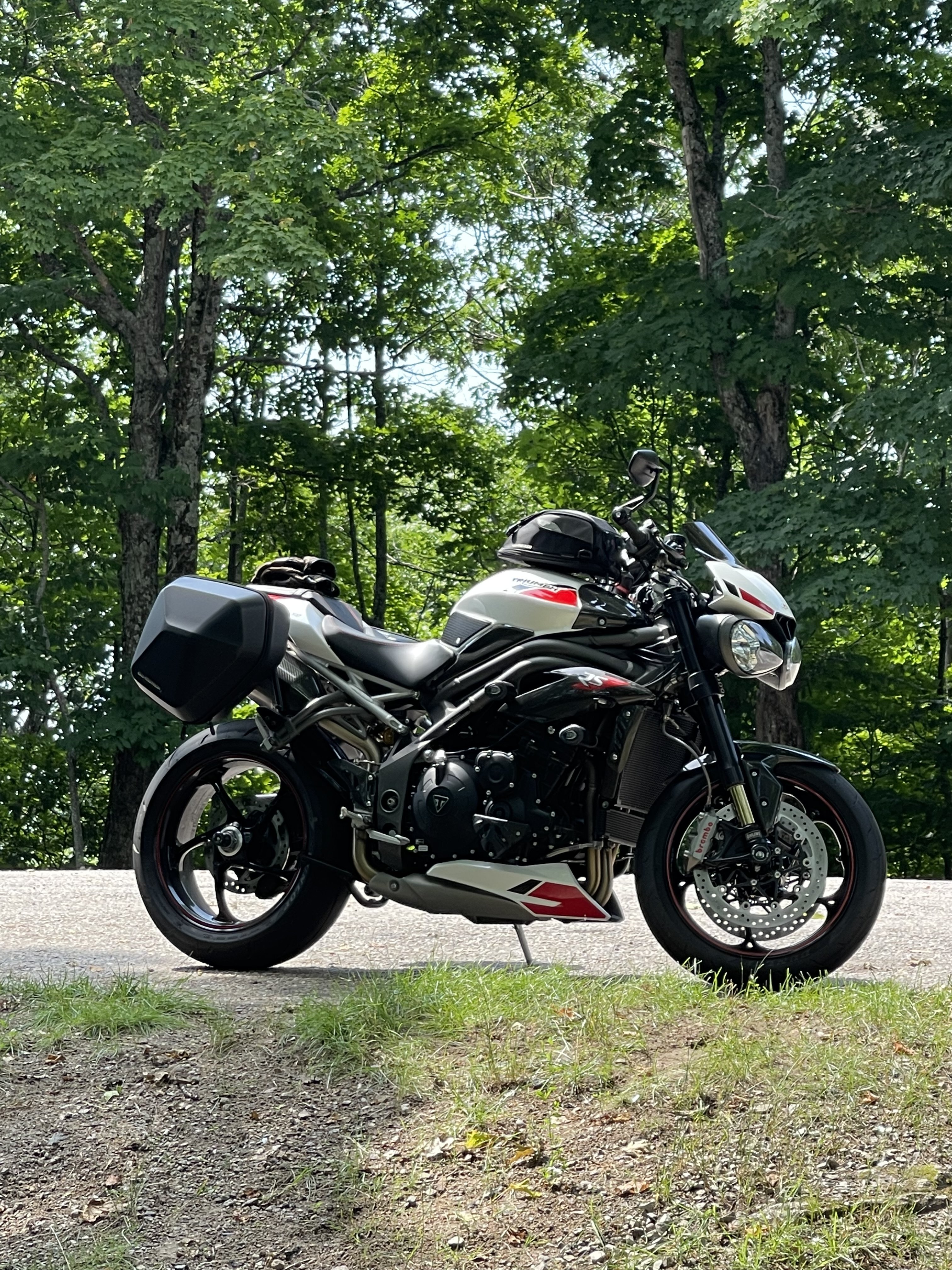

    I have the sw motech top box (givi v56) and slc side carrier set (with urban cases. Nice bits of kit.

    I have the same SLC side carriers and Urban cases on my 2020. Definitely nice stuff!

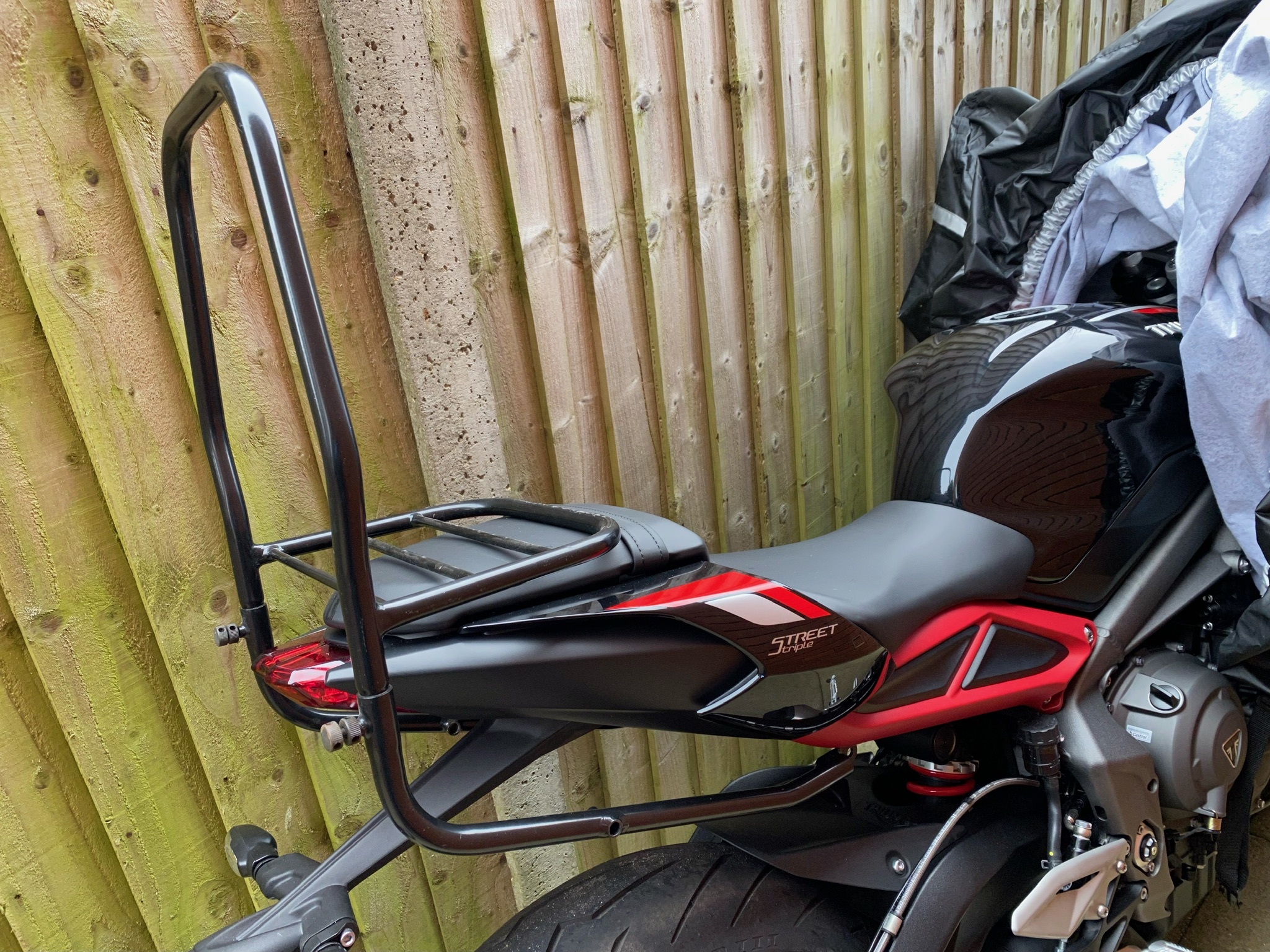

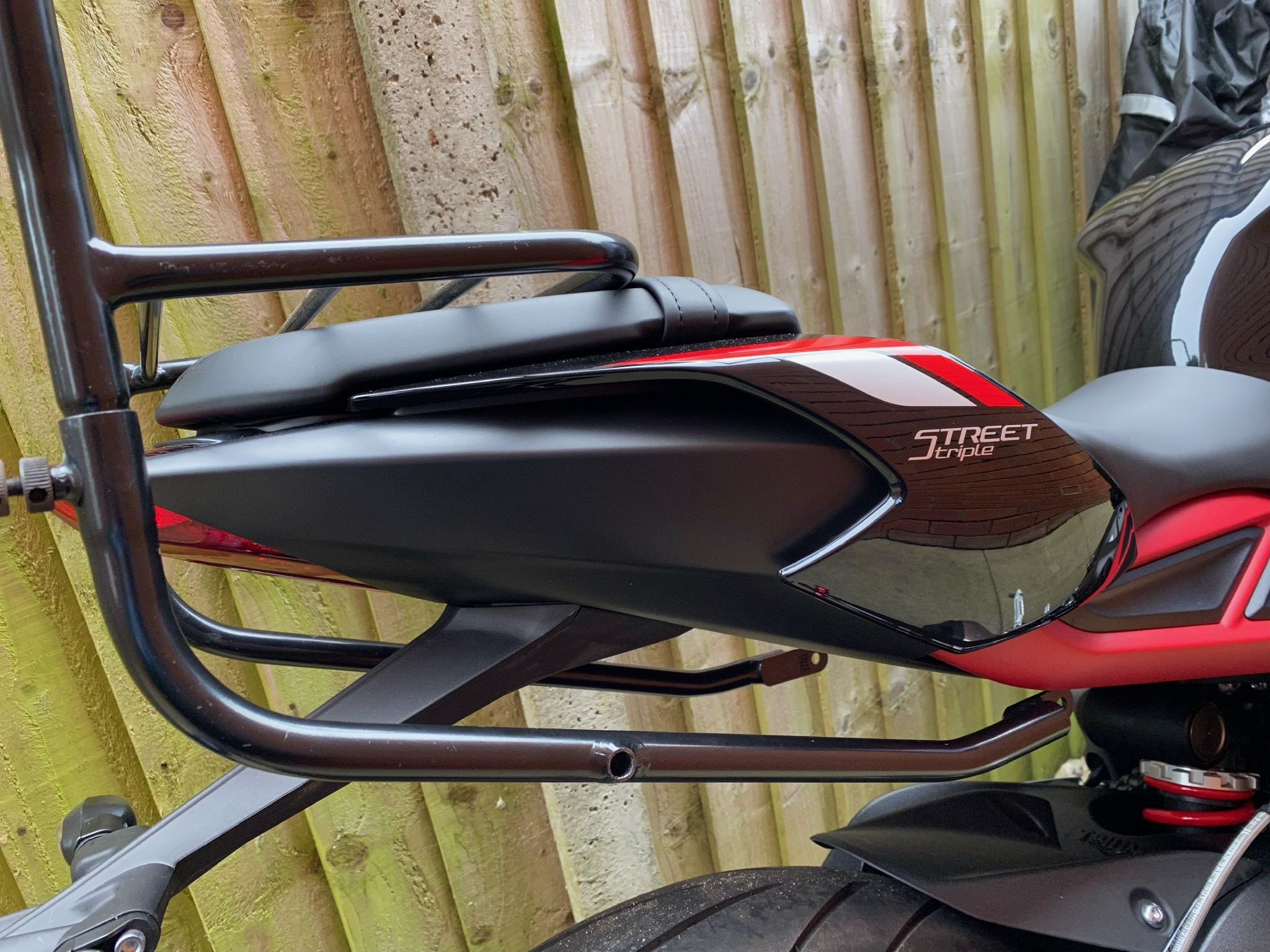

    Which is exactly what I’m in the process of doing. I originally bought my Ventura kit new in 2012 to fit my Ducati and I’m now in the process of making bespoke fixings for the L brackets to fit my Street Triple R.
    Front fixing already sussed using the rear fixing point for the pillion footrests which I have now removed (but not necessary for this to work) . The rear fixing is going to be more involved because of the way that the tail stalk fits into the recess in the undertray, but doable me finks.
    Will post photos when sorted but this is where it will sit on the machine.
    One thing to be wary of if buying used kit is that the A frame, grab handle and sports rack fittings have altered in width since buying mine. The bags will fit either version but new top bits won’t fit old L brackets.
    For those not familiar with this system the A frame complete with “shelf” rack can be fitted with the “shelf” to the rear when two up. Or if you have two bags they can be zipped together with one fore and one aft of the A frame, and they come with straps enabling use as a rucksack.

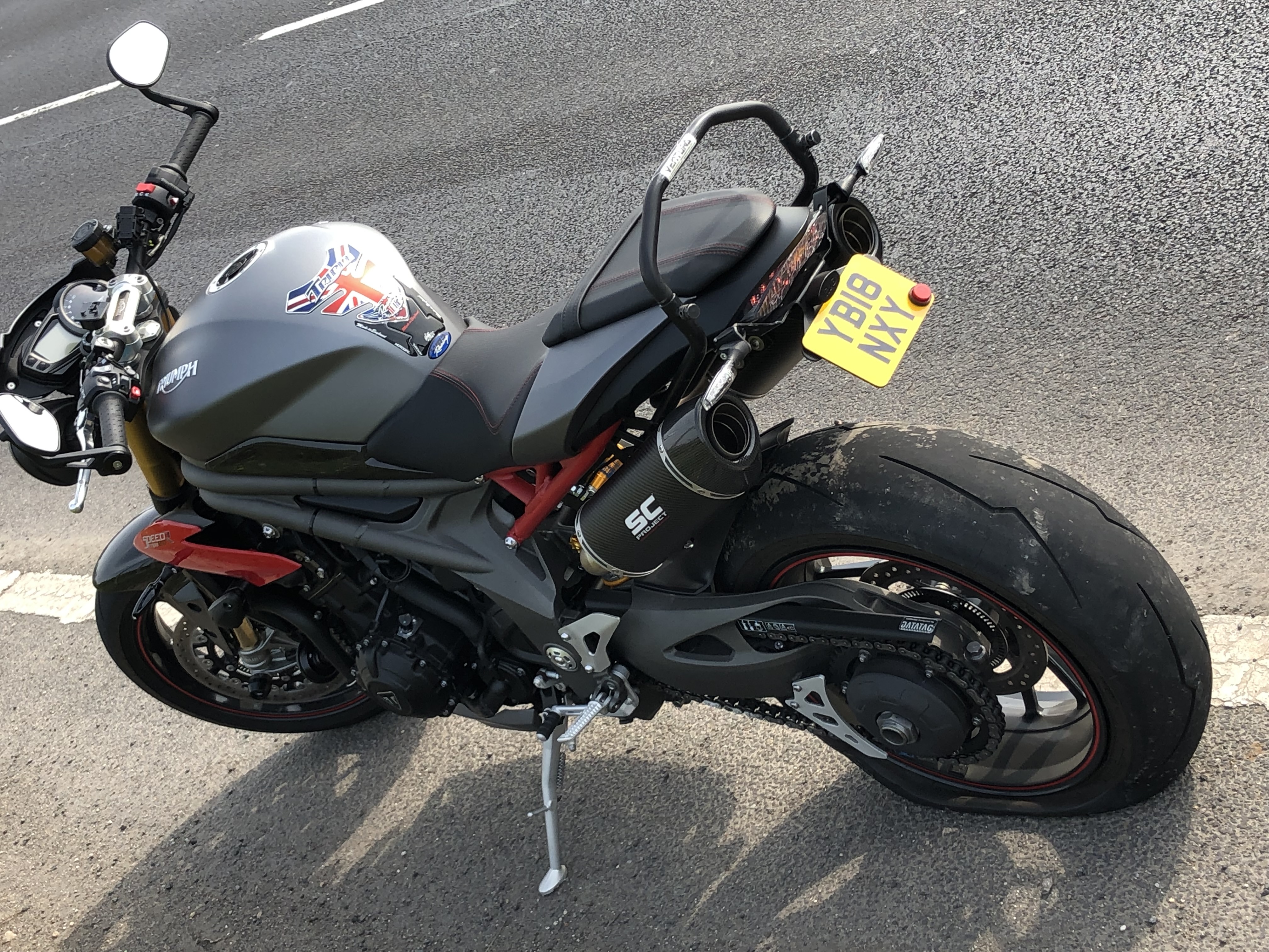

    I’ve never seen a street triple with a sissy bar before.

    yeah I use the grab handle (sissy bar)
    ?? When I don’t have my luggage A frame on.

    I have the Euro Spada and their tank bag. Have now sussed the rear bracketry which involves a SS plate sandwiched between the tail assembly and the undertray, countersunk screwed to the plate which takes the four small fixing bolts.
