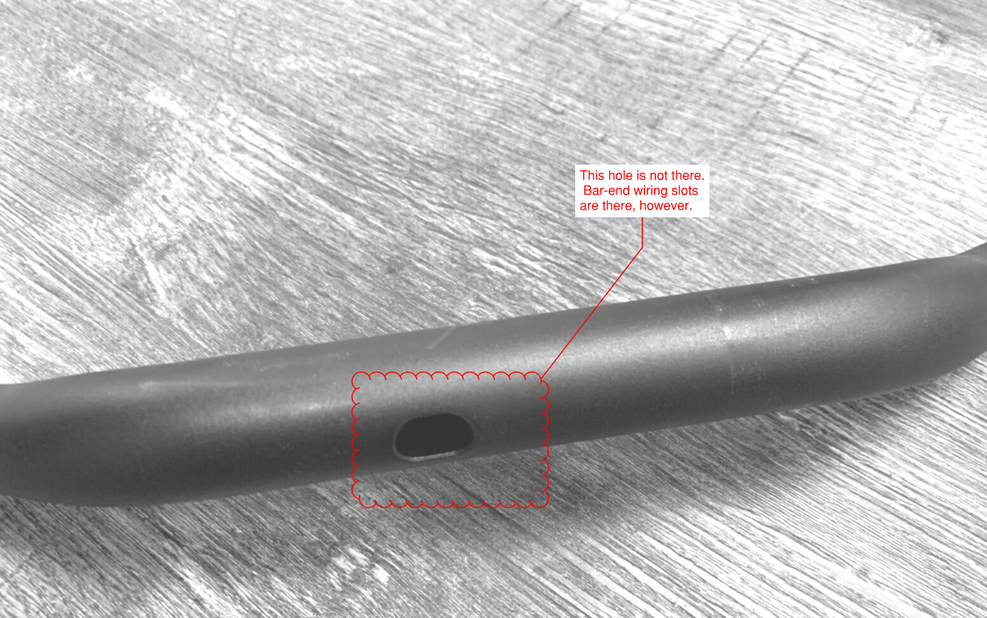

    Here is an image of what I'm talking about. Also, the finish texture on my bars is very smooth, so I think they are aftermarket.

    Its always best to use Triumph's instructions before and alongside YouTube videos. Go to the Triumph Instructions website (link below) and input Triumph's Accessory part number to download the correct instructions.
    Triumph Instructions.com
    On my 2018 (Euro4 engine) Street Cup and on Euro 4 Street Twins (up to VIN AE3381) there will be a blanking plug at the end of the handlebars (under the grips) that needs removing and slots covered by the switch gear for the looms to run through the handlebars.
    Download the instructions first to ensure that its the same for your bike.
    If you're confident safely removing the tank (you'll need to in order to run the wiring correctly) and can get the left hand grip off, then fitting is relatively simple, provided you follow Triumph's instructions. I’ve found them to be good on my bike.
    Hope that helps:)
    Edit: Having just reread the OP, my reply assumes you’re wanting to fit Triumph’s heated grips, other makes that I’ve seen don’t seem to need holes in the handlebars.

    Can't remember for sure but the connector might be in the switch housing instead of under the tank. Therefore no hole on the bars needed. As above, get the part number and check triumphinstructions.

    Every day's a school day and my OCD just couldn't resists checking Triumph's instructions for @Sconnie's bike.
    The instructions are pretty much the same as for my older bike, (Triumph hasn't reinvented the wheel for what doesn't need to be changed). The holes into the handlebars are under the switch blocks and out through blanking plugs at the ends of the handlebar, the connector for the heated grips loom is under the tank.

    Thanks for the help!!! I found the holes under the switch blocks!

    As I said, the holes that you need will be under the left and right switch blocks: The only way to check is to carefully open them up (there will be small locating tabs and holes if the handle bar is standard), there will be an obvious slot shaped hole, large enough for the heated grips wiring loom.

    Yes, I found the slots in the bar ends when I took my bar-end mirrors off. There is a plastic blanking cover over the slot. I also found the hole under each control cluster. So for the street twin, the cables follow the rest of the control wiring instead of coming out of the center of the bars. I downloaded the instructions and it looks pretty straightforward. Thanks again for the help! I'll have heated grips for our club's New Year's ride!
