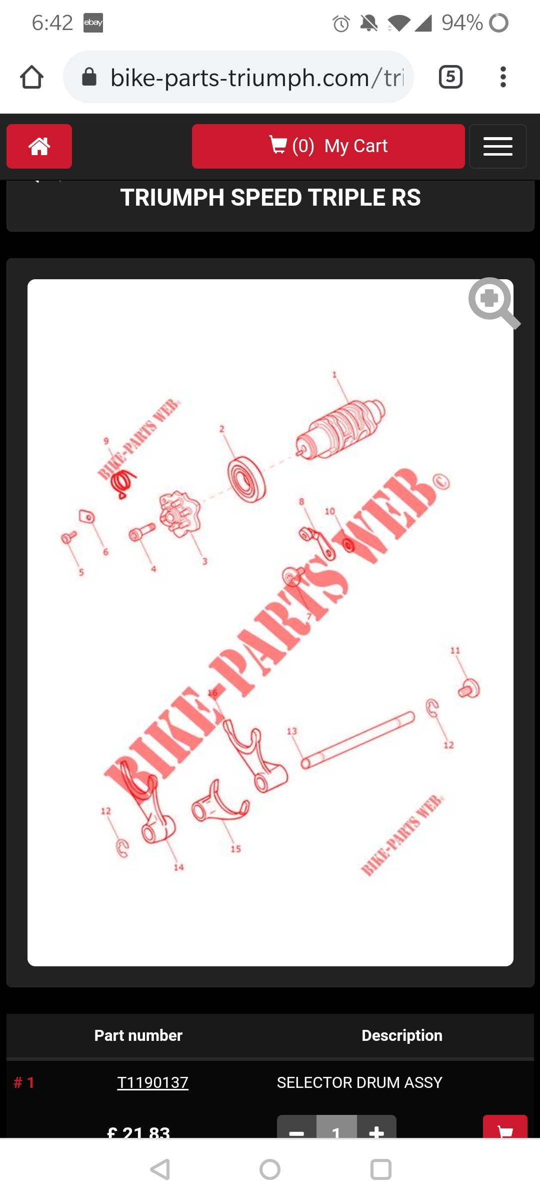

    I'm gunna tell you straight buddy, your gear box has been damaged, deactivate the qs on the menu and get your money back asap, on the forum we have alot of threads about this and I can tell you now, I got rid of my rs because of this problem, 1500 running in miles taking mine to and from the dealer, by the end I'd just had enough of it.
    It's a shame because it's was a great bike.
    At a minimum these will need changing, please see attached picture.

    Simply yes buddy, moving the gear shifter was tried and tested on mine at first, I had about 5-6 horrendous missed gear changes in total on my rs and that's all it took to ruin my gear box. :pensive:
    Do as you will but I'd disengage the qs, go to your dealer and get your money back, I know alot of people on here will disagree and will be disappointed in what advice I'm giving you here but I simply don't care, it's dangerous and it's not fit for purpose, all it creates is hatred for what is a good motorcycle.
