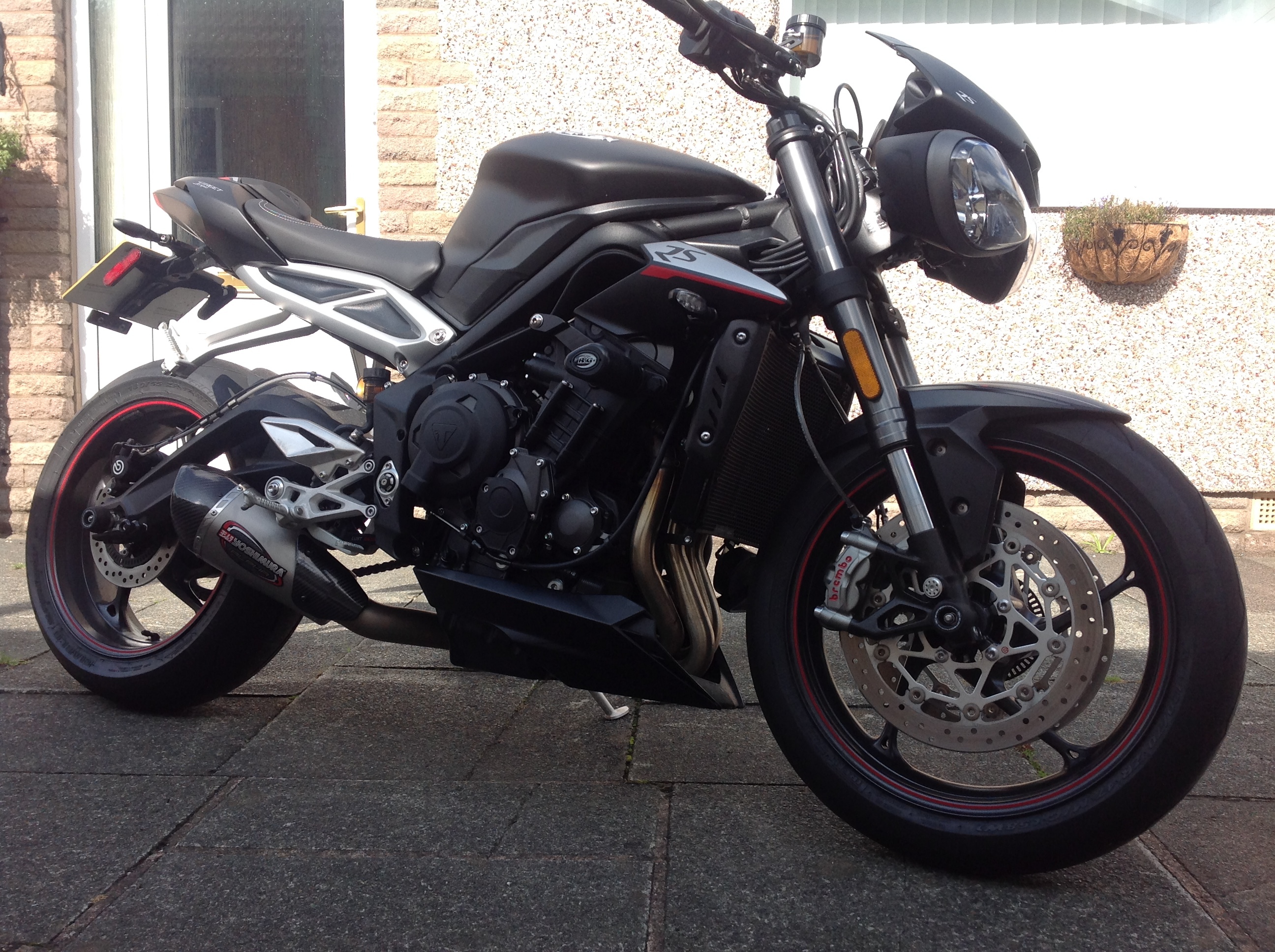

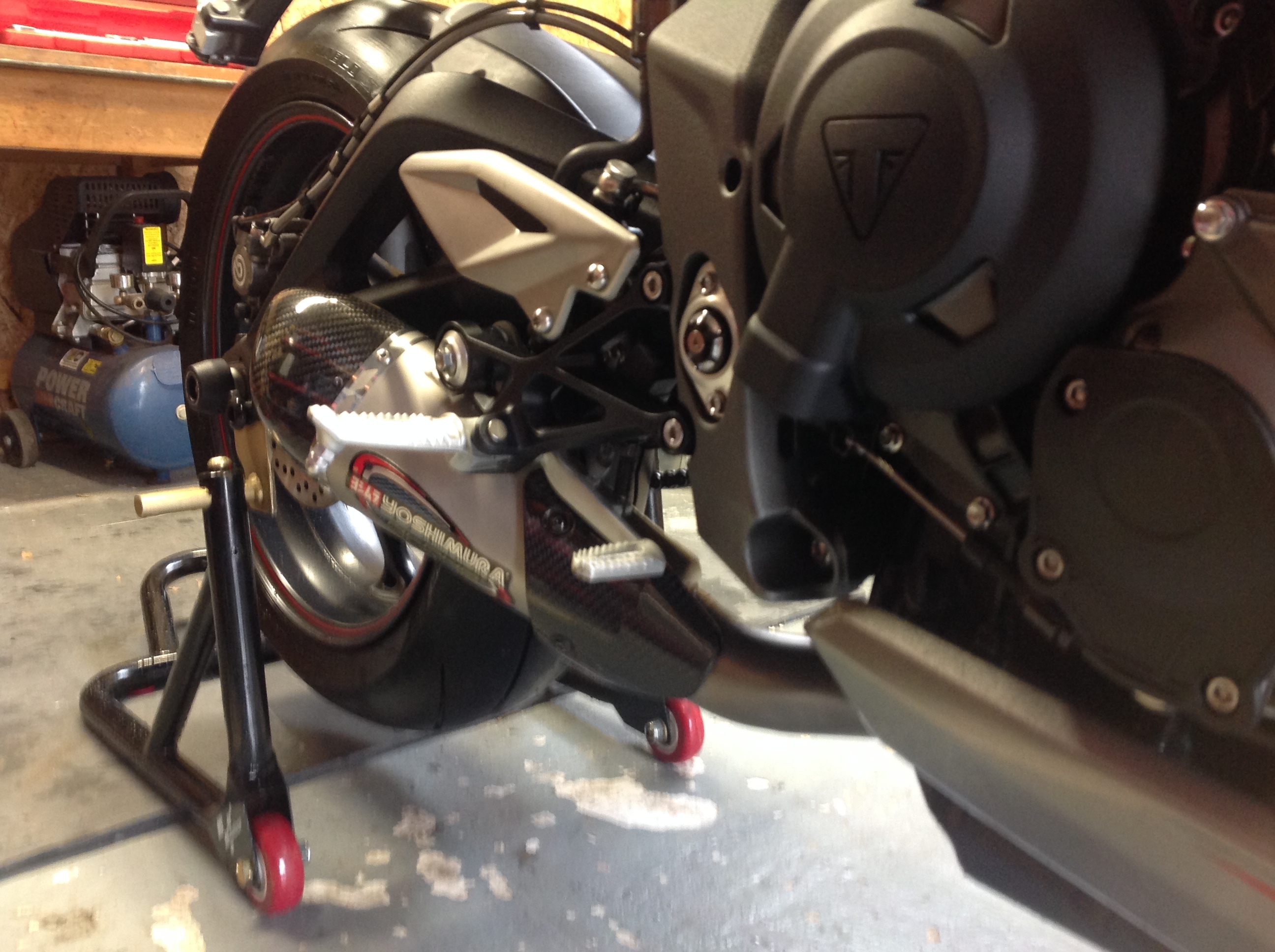

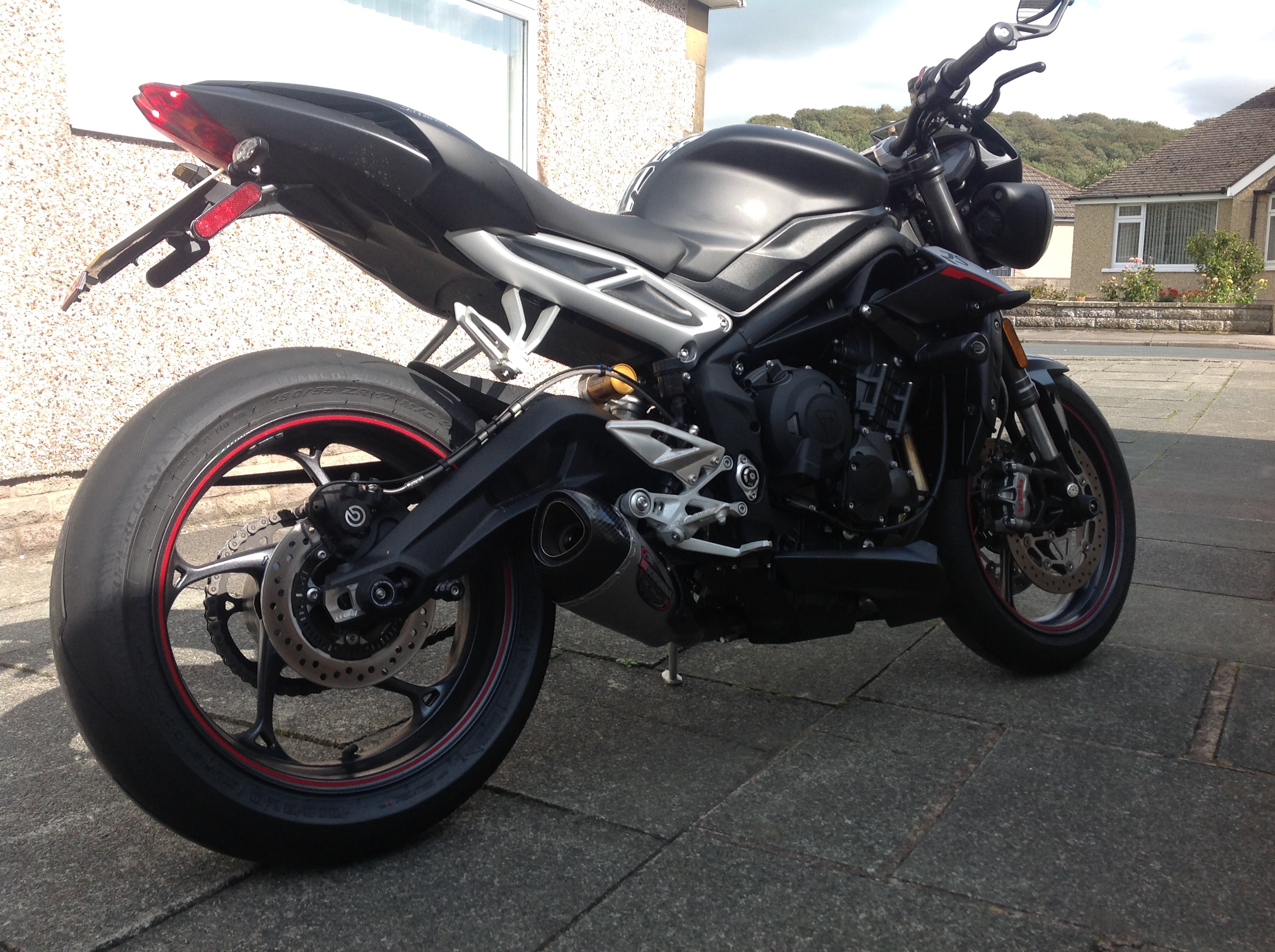

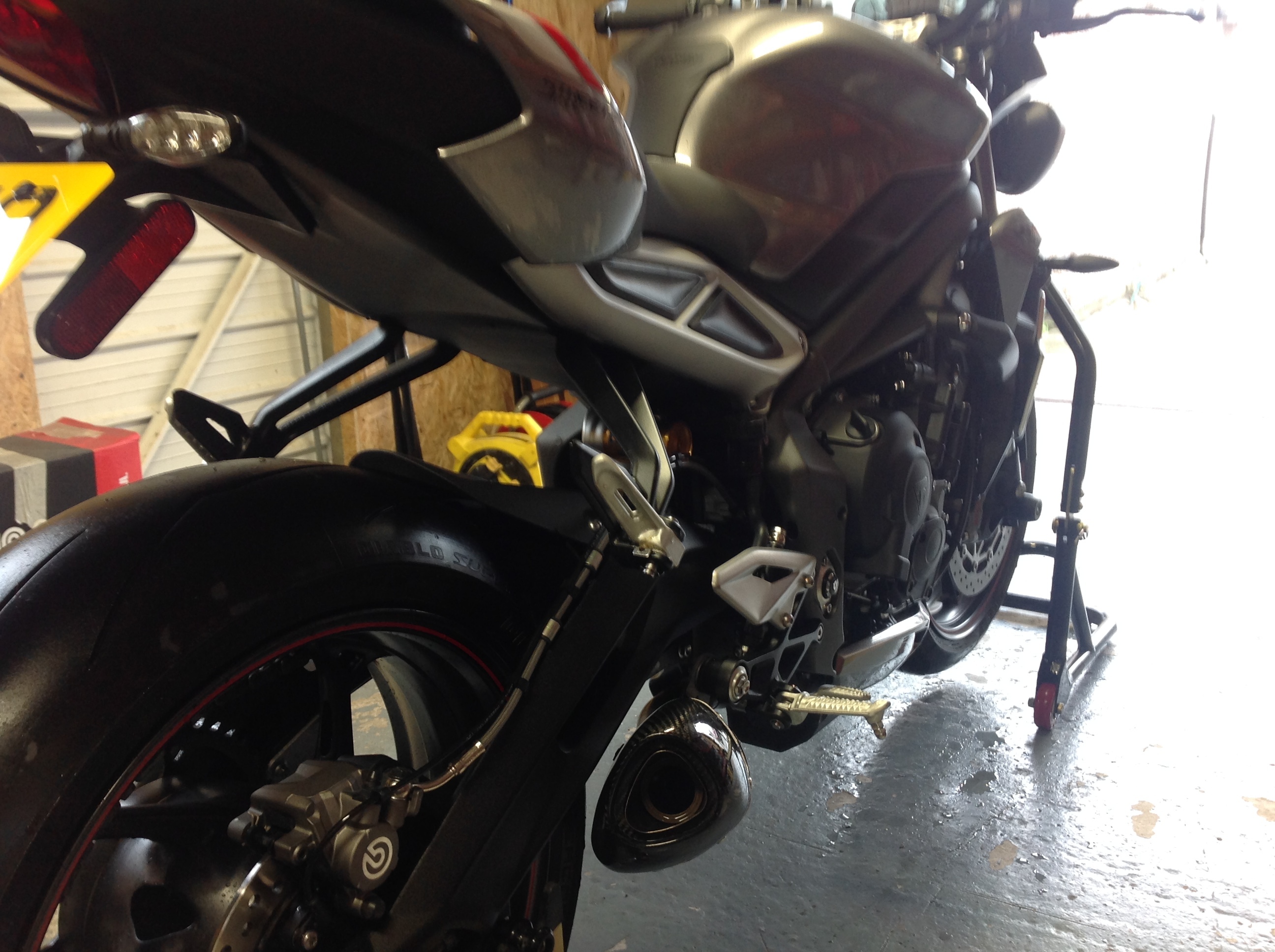

    The Arrow can is really straightforward to fit, it's not the lightest however, I realise you've already got it but the Yoshimura Alpha would have been a better option, it's super light and sounds fantastic, it's very loud with the removable baffle out though. It only takes around 30 minutes to remove the original and fit the Yoshimura, it only has 1 clamp for the headers and the original bolt on the footrest hanger. I fitted one to both my 2019 and 2020 Street Triple 765rs

    Looks very nice indeed! Maybe in the future I will have a look at this :)
