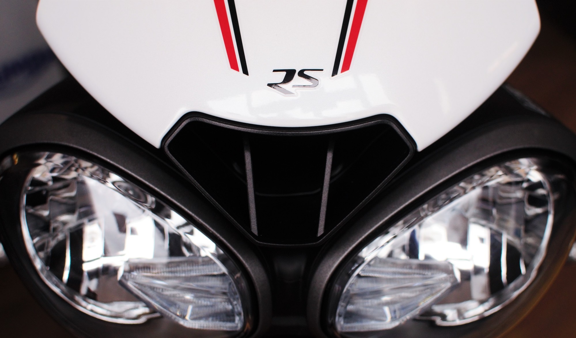

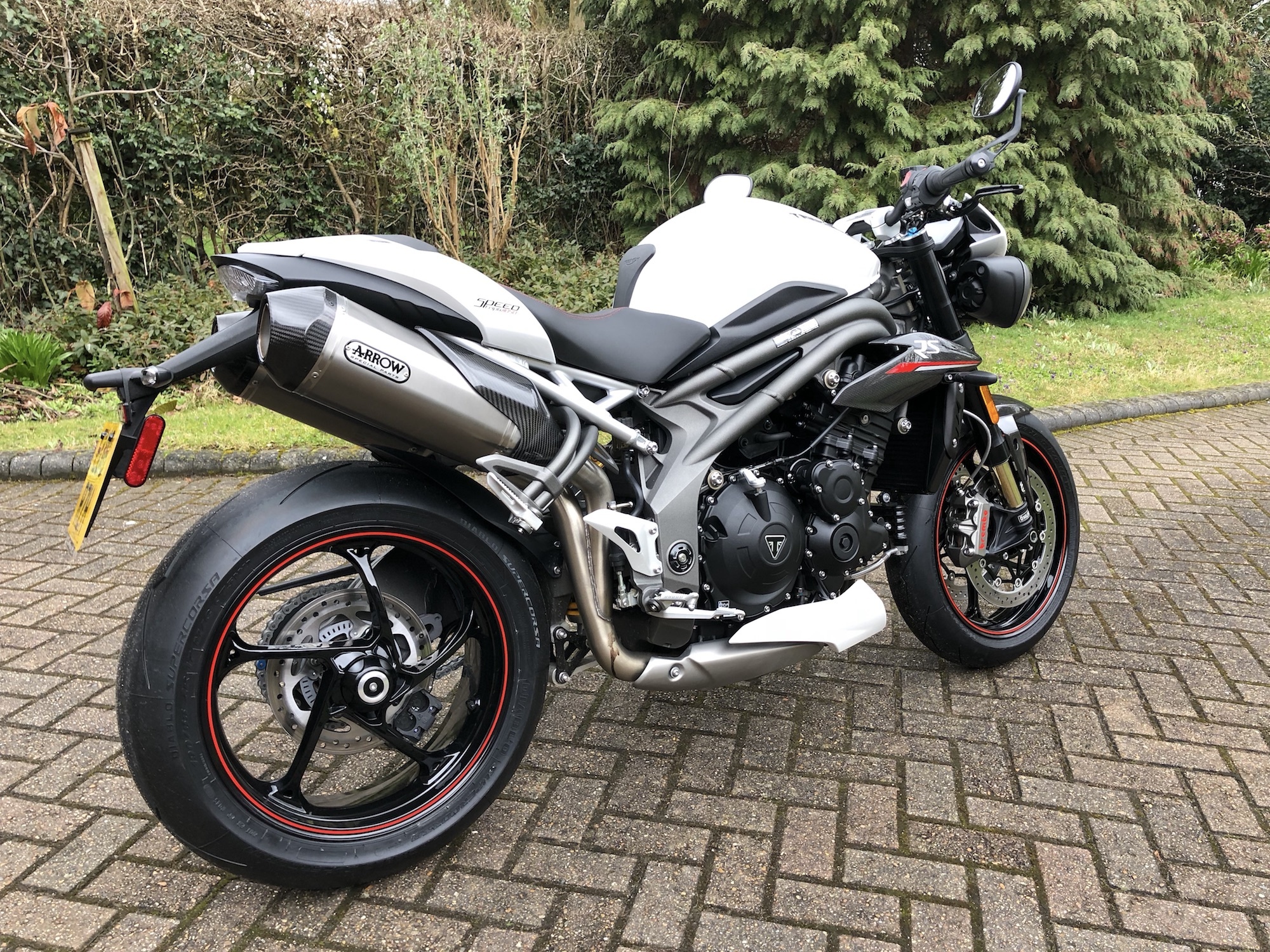

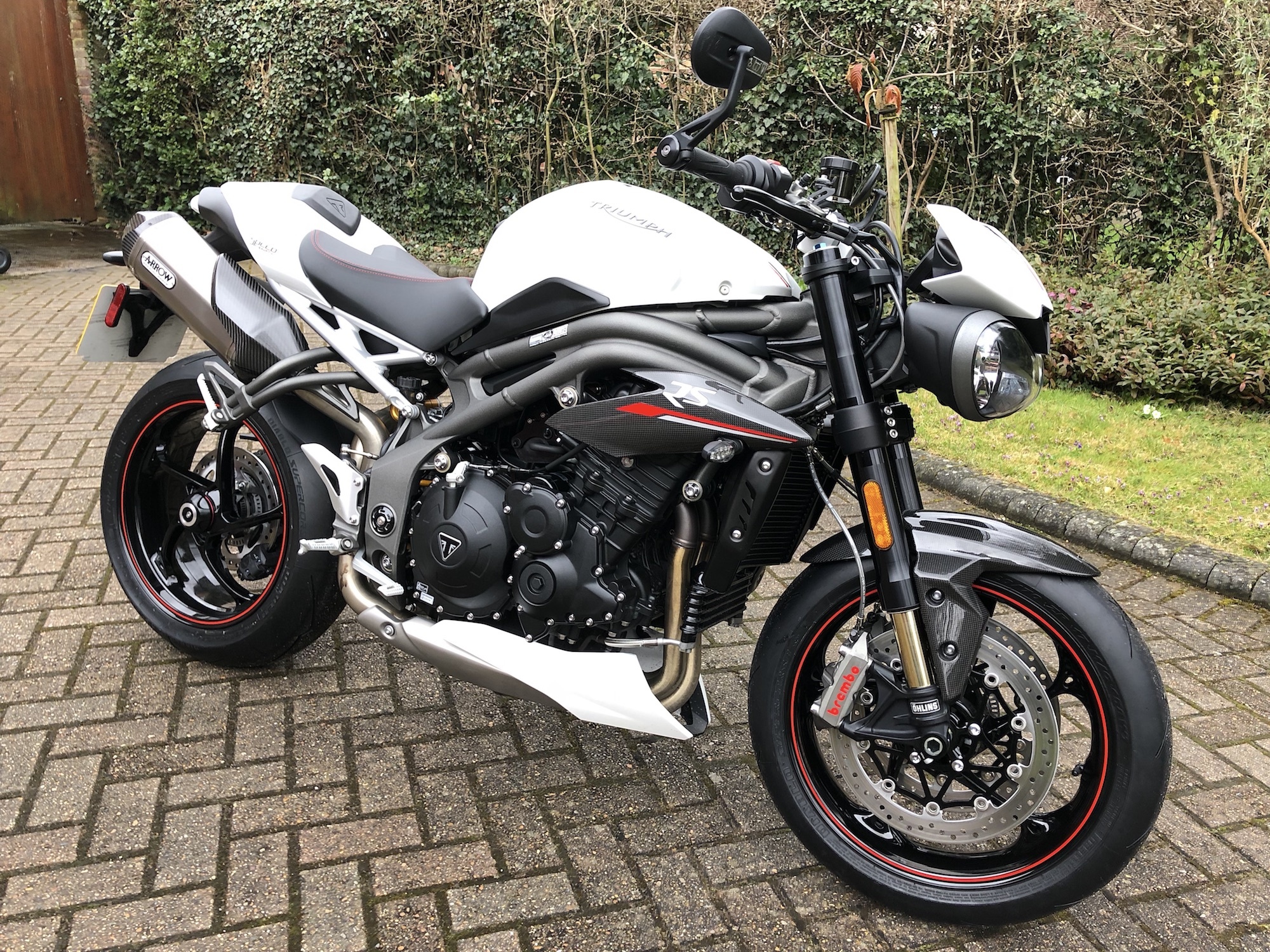

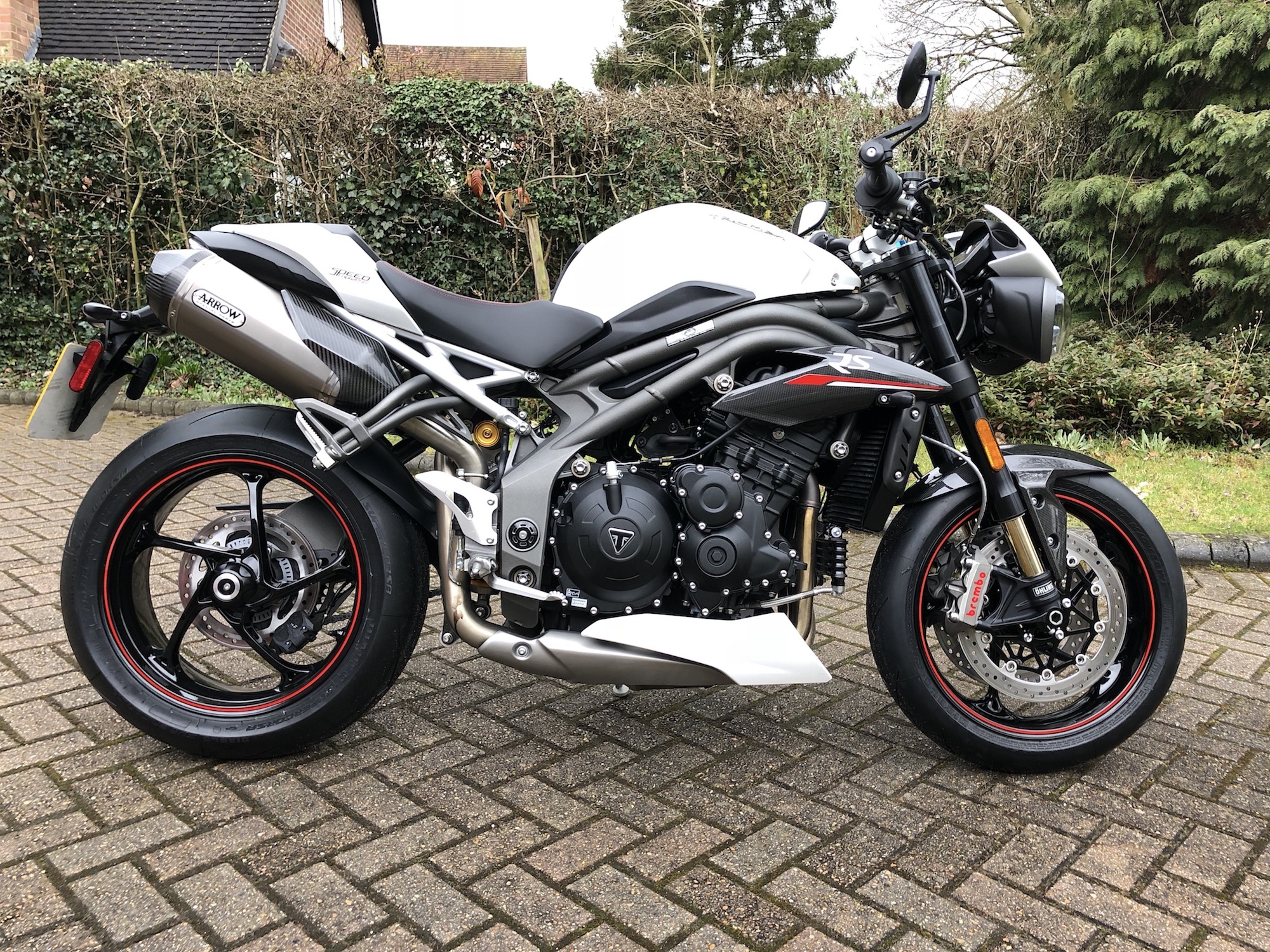

    I wanted to keep an ownership thread going, but the downside is that it's become somewhat lengthy.
    Collection day...
    The waiting is finally over and I'm very pleased to introduce you to my new Speed Triple RS :laughing:
    She only arrived at Jack Lilley (Romford) on Wednesday and they had her ready for today, which I have to say was exceptional service on their part. They've fitted a quick shifter (shift assist), alarm and a tank pad, and I opted for the carbon tank sides and slimline indicators to fit myself.
    I have a further stash of goodies retrieved from my old R to fit over the next couple of days, including carbon tail, hugger, chain guard and heat shield, billet brake reservoirs, crash sliders, engine sliders and axle protectors, rad and oil guards and a tail tidy. This work is now in progress (including an ACF-50 frenzy)...as evidenced in my last pic below o_O
    I didn't attempt any heroics on the way home and kept to the 3,500 rpm limit that's advised for the first 100 miles. It was damp and the tyres are obviously new. The engine is MUCH smoother though and whizzes up the rev range in a flash. Exhaust sound is lively but not loud and doesn't drown out the engine and induction sound.
    It takes a short while to suss out how to navigate around the info options on the display, but it's super clear and looks amazing. You can lock it on the white background setting, but the dark setting is 'auto' and it appears to switch back to white when it wants (I found that strange). I mistook the indicator switch for the menu joystick a couple of times - and also found out that it has self cancelling indicators (and a short press for three flashes setting too).
    I'll post up any notable technical tips as I discover them, but there are a couple of items worth a mention:
    The Evotech tail tidy fits fine with the arrow cans (the dealer cast some doubt on this, saying they had had a problem with the R&G version because the subframe had some differences).
    The old Arrow cans DO NOT fit (I was going to try my no baffles version) - this is because the link pipe is 2 or 3" too short where the single pipe mates to the cat. There's an extra* exhaust mount down there too - you can see it in my stripped down pic (just below the brake pedal).
    Edit: It's not actually 'extra' - the 2016 bike's cat exit pipe would have mounted to this support, where for 2018, the link pipe mounts to it.
    To sum up, I'm absolutely delighted with the crystal white finish - it really is a stunning bike :heart_eyes:
