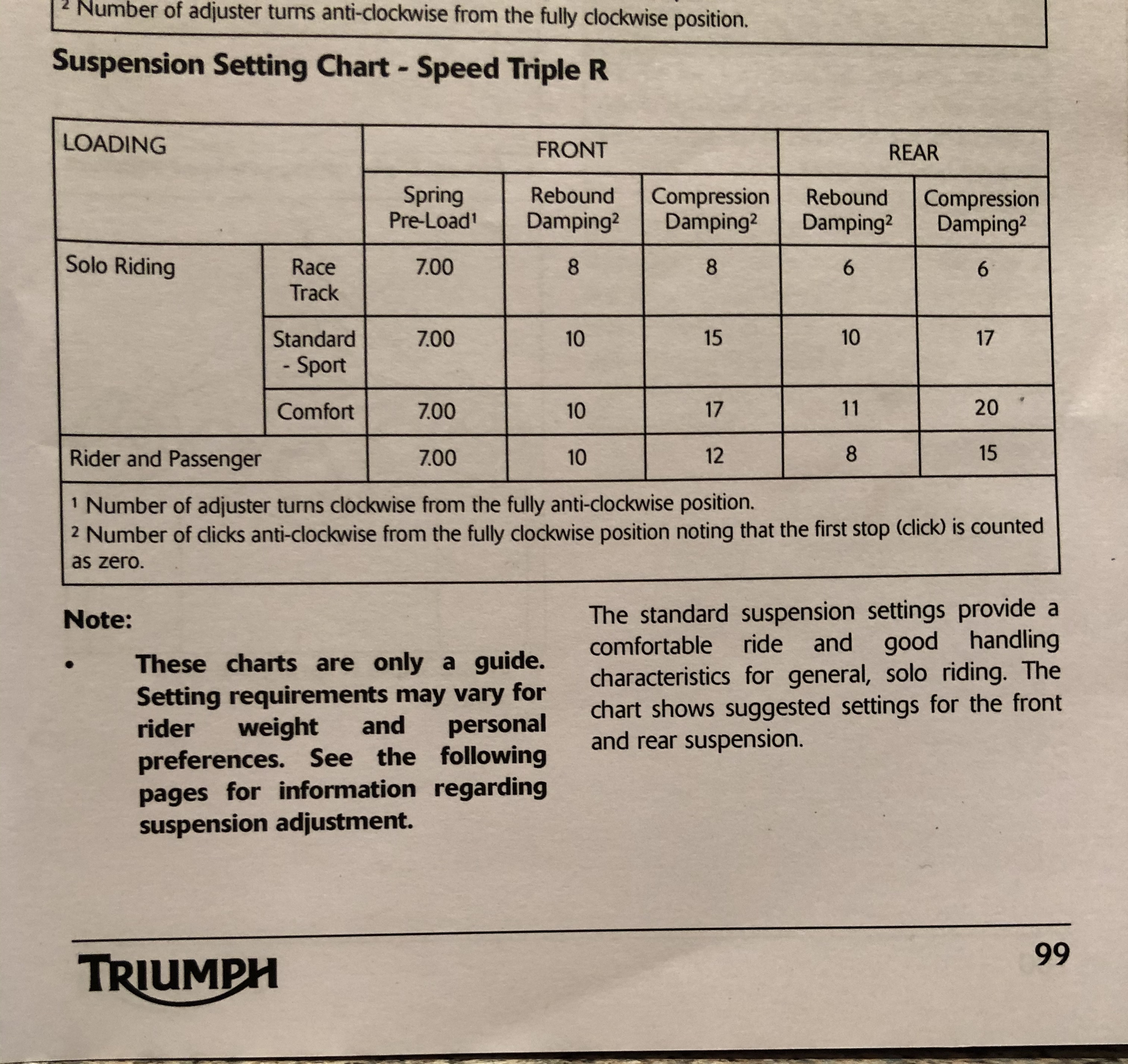

    Southend, Essex, England
    Luckily my bike needed a new fork seal, so has fresh oil in there, so I didn’t have it serviced when the shock was done, but going to get them done by local Ohlins centre this year.
    Here’s my set up card
    compared to standard and comfort settings
    So a click more of compression damping over standard.

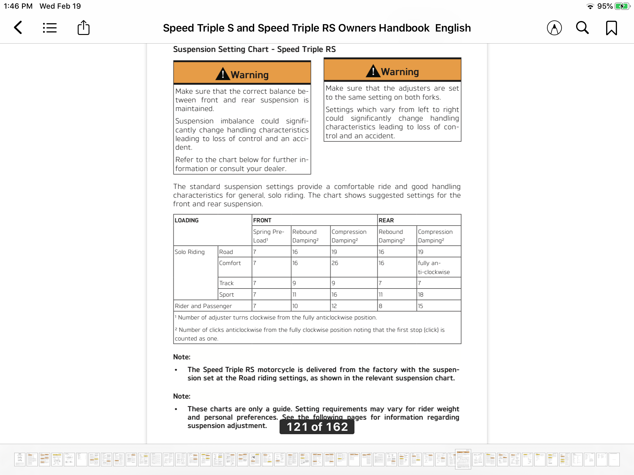

    What do you weigh Steve, and where you at with setting on the RS?
    I think they kept the same spring rate on them, 100 on my shock spring.

  18. SteveRS
    SteveRS First Class Member
    Jan 12, 2019
    1,273
    862
    British Columbia
    12.5 stone. Front preload is stock. Front comp is 9, reb is 10. Rear preload all the way out, comp is 18 and reb is 9. Don’t remember what the stock spring rate is for the shock.
