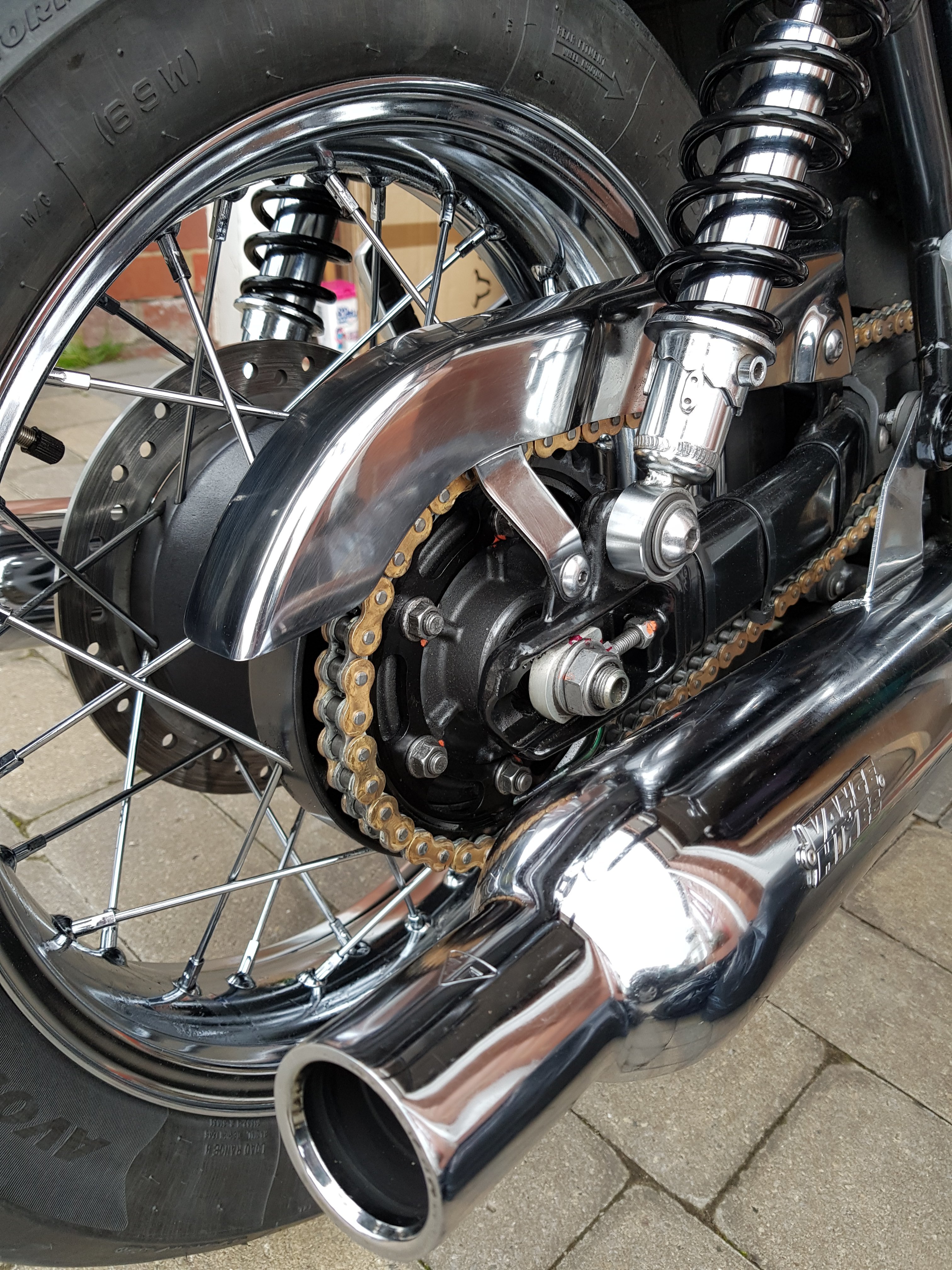

    Dozers Dad, My local T dealership have agreed to replace the chain, half price. So good on them for that.
    But still £155
    I'm going to get the old chain from them and decide what to do after!

    I wonder if the chains are going on the bikes at the factory with too many links, reducing the wear adjustment
    If the chain is lifting off from the teeth on the rear sprocket then the chain is worn, if it is just at the full reach of its adjustment but not worn, then too many links.
    I would certainly ask for a DID ZVMX heavy wear chain, would last twice longer than those cheese strings supplied by Triumph

    Just using fingers only. A new chain and sprocket won’t really be able to move much or not at all, a worn one will pull away enough to see a good gap between the chain and sprocket it’s sat on where, a really bad one will show the top of the sprocket tooth

    I've seen a zero mileage showroom floor model running a 37 tooth rear sprocket with the rear axle midway on the adjusters so either it's swinging arm design had been tweaked or the number of chain links had been reduced.
    One thing that does cause accelerated chain wear is sprocket misalignment. You should be able to see daylight down the gap on both sides of the rear sprocket and the inner chain plates when spinning the wheel backwards. If the chain is running up against either side of the sprocket teeth the load will not be distributed evenly across the chain pins and bushes which rapidly accelerates chain wear.

    UPDATE. After reading your many very helpful content on this blog, just want to say thanks to everyone;
    I complained to Triumph and got nowhere, my Triumph dealership however (Newcastle Motorcycles) came to the rescue.
    I bought a new, very good quality DID chain and sprockets for under £100 (as suggested) and dealership fitted it but with a link less to give me some room for adjustments.
    Thanks to Newcastle Motorcycles and you for that.
    Happy days.
