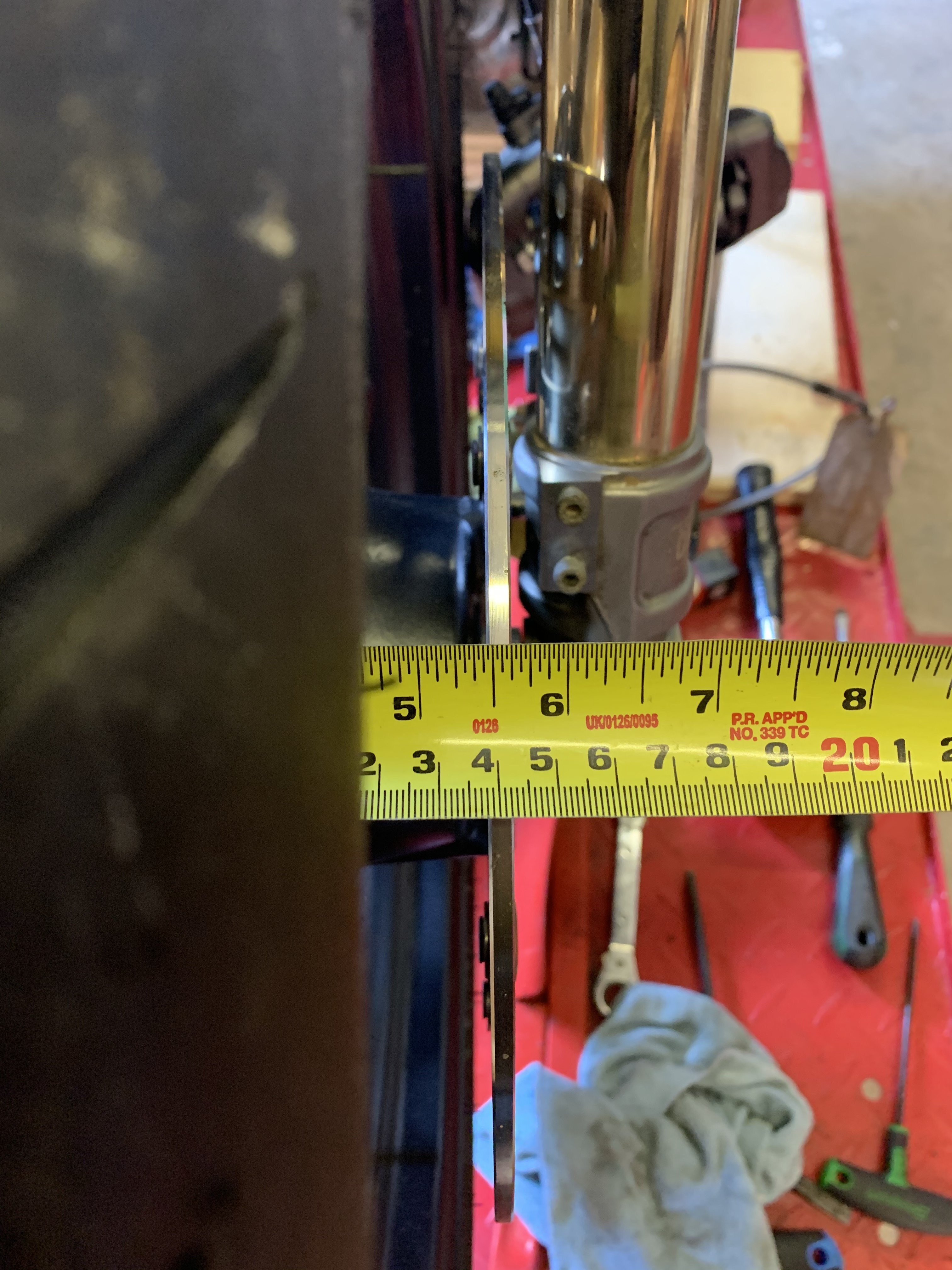

    Could a owner of a 2016 Speed Triple R with the Ohlin's front forks , measure the distance of the discs from the outside of one to the other, i am fitting a 2019 Ohlin's front end to my 2019 Speed Twin, and it would appear that the triple has a narrower front end although the yokes dropped straight onto my Speed Twin head stock.

    128mm from the outside edge of one disc to the outside edge of the other.

    Matt, that's quiet a bit, 7mm either side , thank you for that i better start looking for a front wheel
