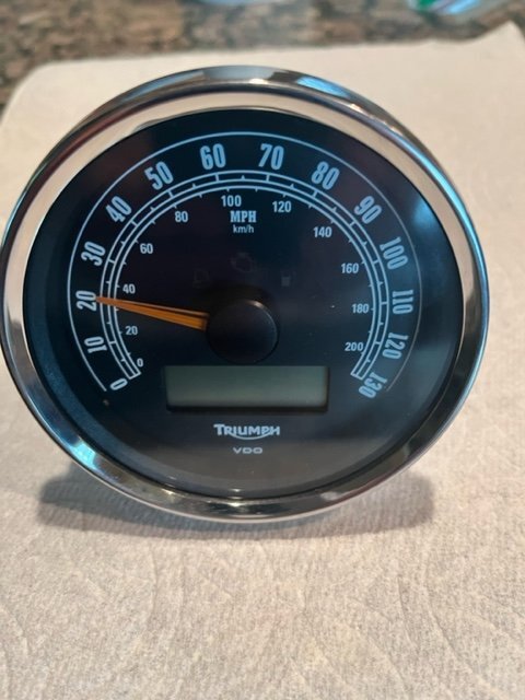

    Well, I got the tach and new housing .... did the swap and unfortunately there is something wrong with the wiring because the tach wouldn't work.
    The really unfortunate thing is when I swapped everything back .... somehow I got the speedo screwed up.
    It now has the meter sitting at 22 MPH instead of zero and I'm not sure how to fix it.
    I've got it off the bike .... but before I open it up and look inside I thought I'd try get more technical help in case I make the problem worse !!
