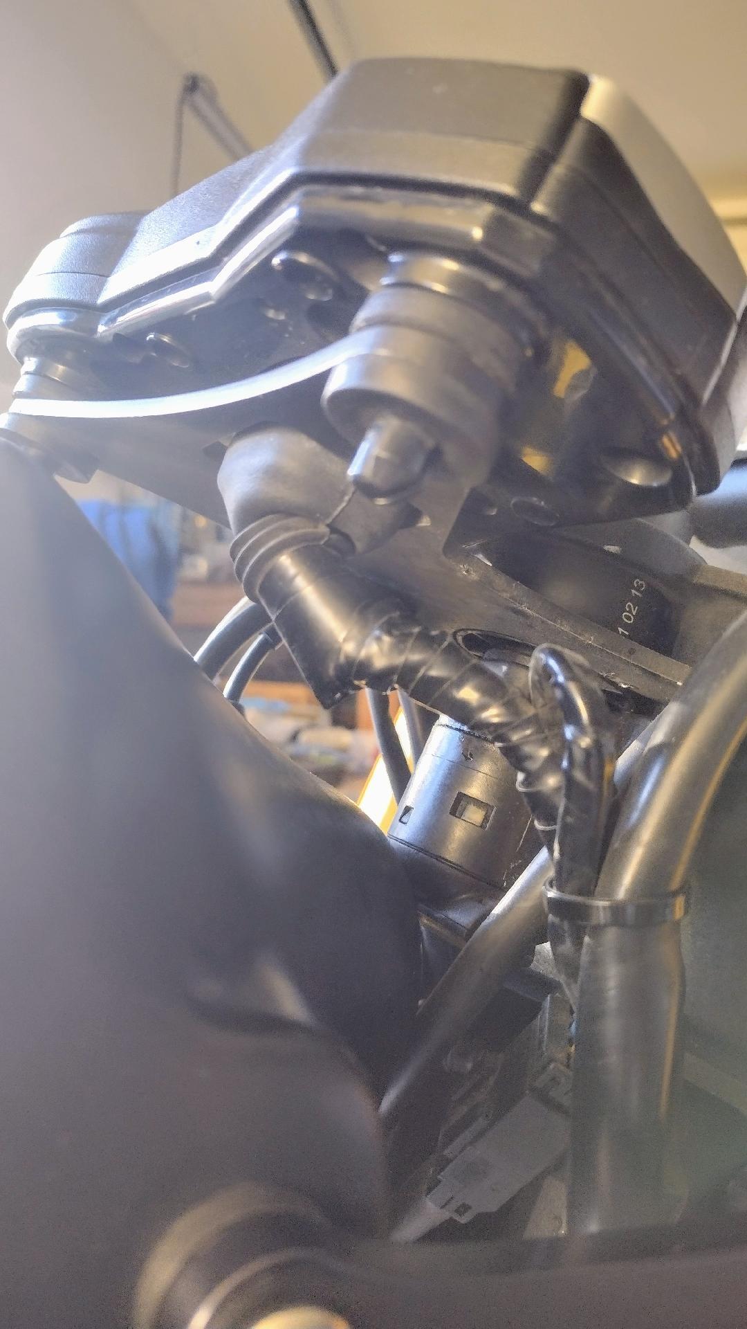

    So after all that today i have the check engine light on...now the dash is back to normal...will the light go out after 3 cold start cycles..does this picture look stock or has it been retaped

  7. TRIPLE X
    TRIPLE X Senior Member
    Sep 1, 2021
    484
    213
    Norfolk
    Yes, the light should go out as long as there are no fault codes remaining.

    I pulled that tape off found nothing redo it putting tie wrap around the harness boot going into cluster.....i would just like to go over everything again, i pulled the front brake lever switch as the rear brake light was not always working..wd40 fixed that......I lifted the tank to put the two wires on the battery for the low amp charger connection...refit tank..now the time clock needs setting on the cluster, ignition red button down on so i spent twenty minutes trying to get the kms to mph ...ignition off...on ...(i didnt know until a day later the engine has to be running).... so i stopped at this point...started bike up all ok...left on charge overnight...next day no start no green N on cluster....no power to clutch switch...pulling wires etc it came back to life...starting up check engine light on
