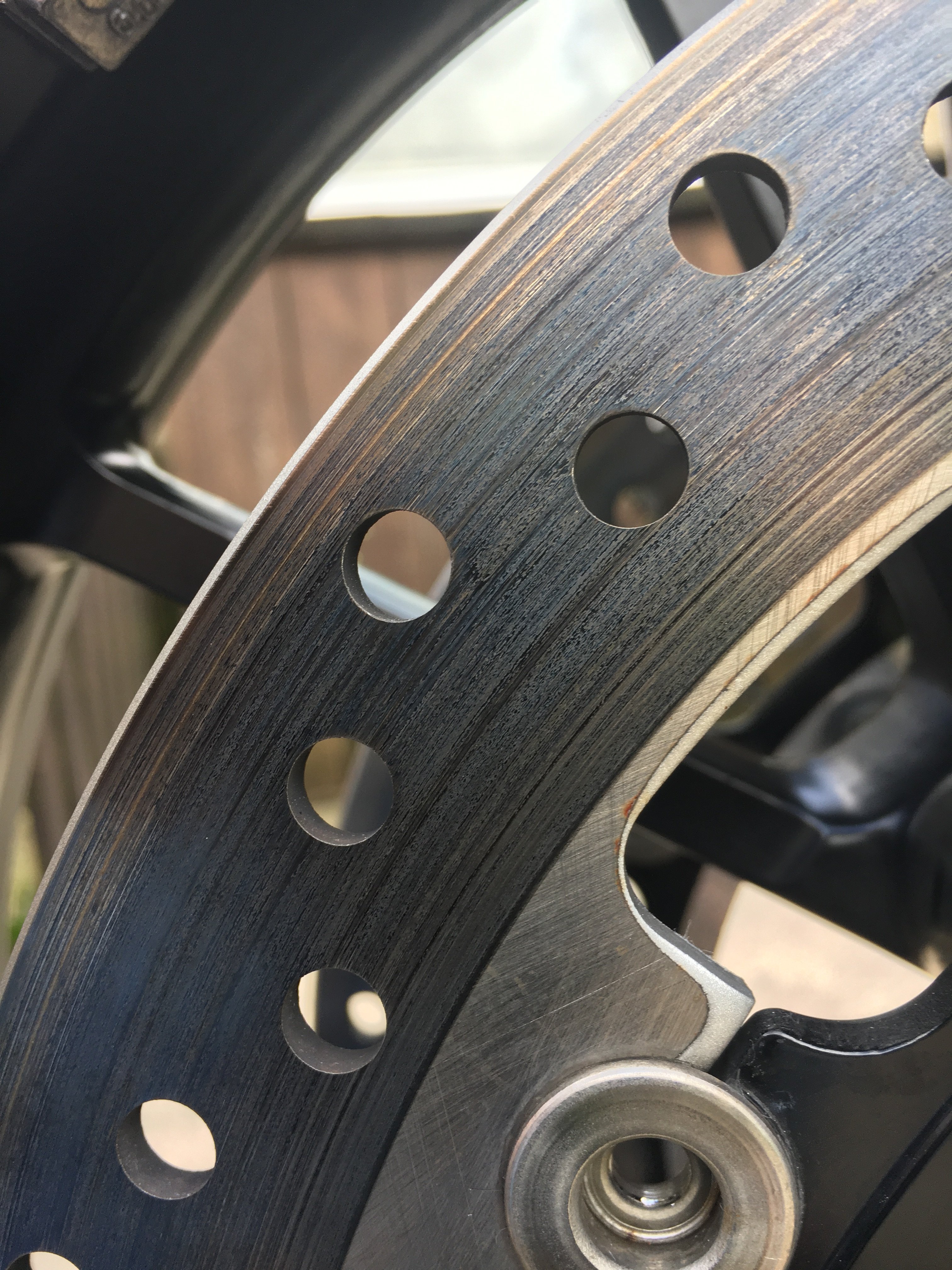

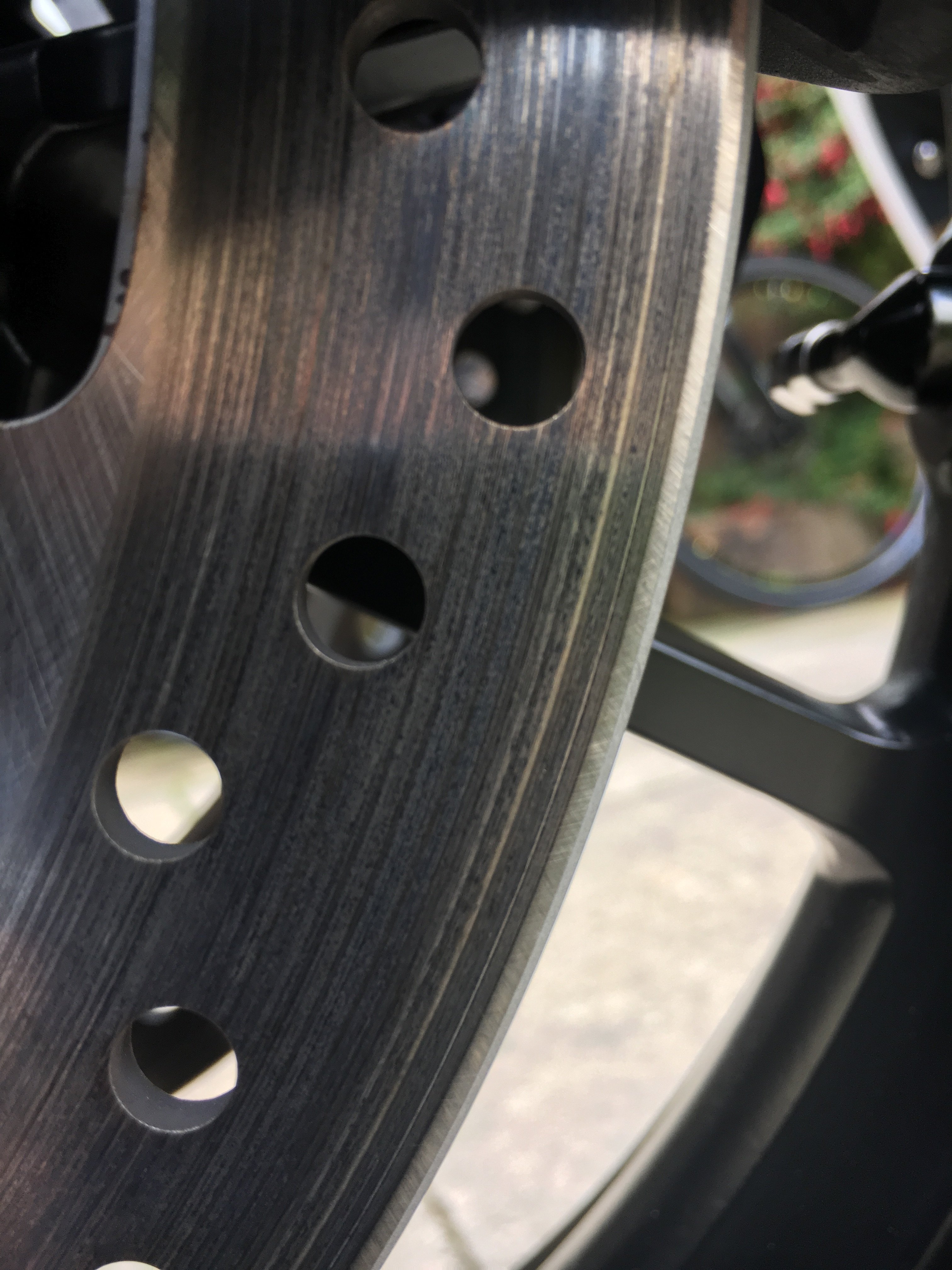

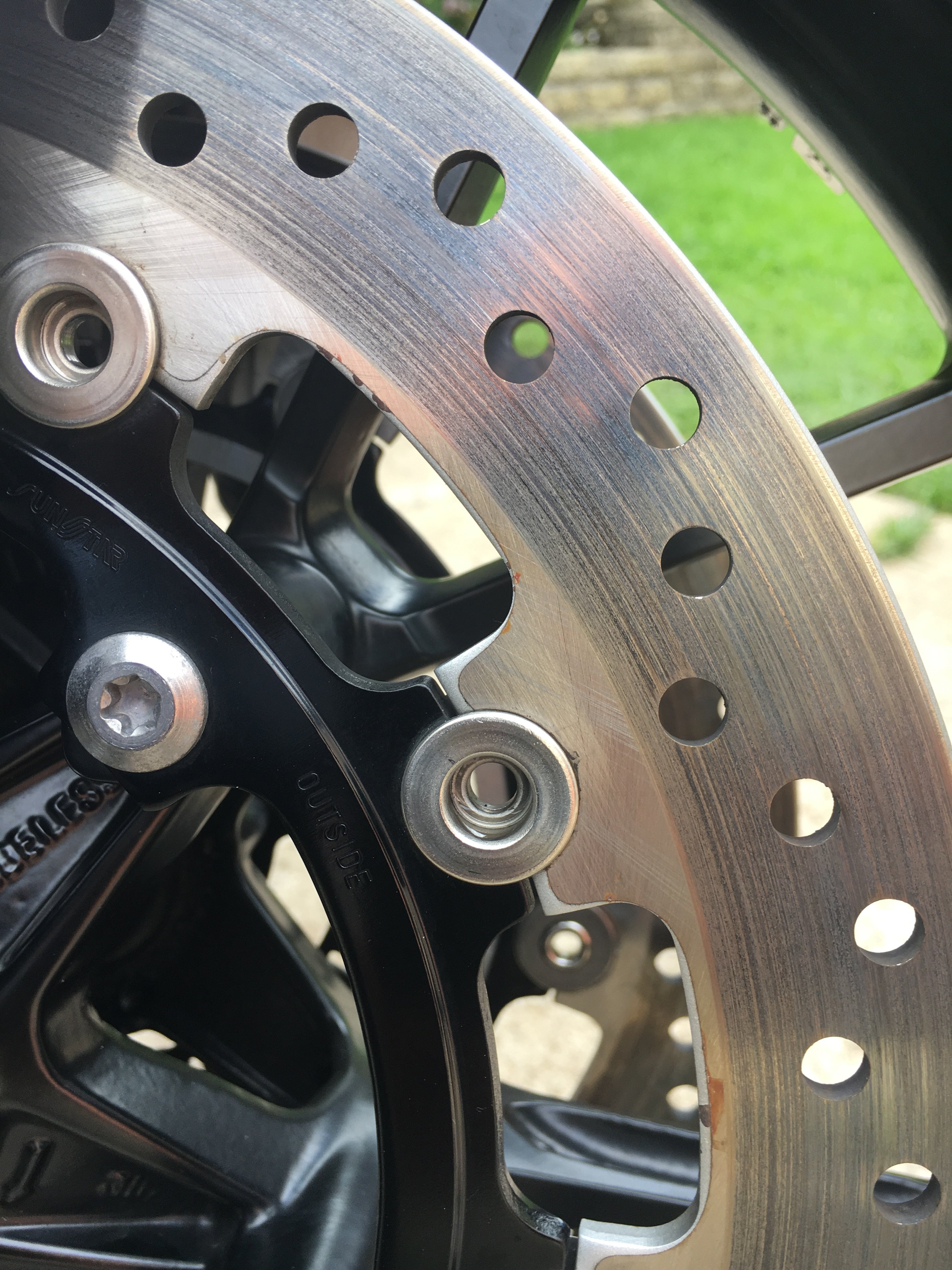

    Very interesting mate. thanks Will check that out now. photos of my 2 discs one looks like it not getting full contact BUT the did say they cleaned and scratched the pads up. but i have done 50 miles with some hard braking.first two are marked discs last is the un marked disc

    That first picture of the discs looks like there’s been some corrosion eaten into the surface at some point. There’s definitely some flaw in the surface.
    Either that or the pad surface is melting and being deposited onto the disc.
    Either way, I’d be looking for new discs and pads.
    Good luck with getting it sorted mate.

    Disc run out is spot on 1 is 0.00 the other 0.003 so 100% cock on. just cleaned every ring on the floating discs they were all spot on. Just checked and re set the calipers as per clip from Sprinter so that's all good. I think the marks on the disc could be from wear they have scratched the pads up, they may not have bedded in yet ? not 100% on that. Just took the bike out to re test it and still once heat in the discs/pads its doing it a judder right though the front end and can feel it though the lever ? All i can think of is bad pads but shop checked them of heat judder where the disc is heating up and the disc is not the same thickness all round, or a problem with one of the calipers but i know all the pistons move fine and am sure would have also checked/cleaned them ?.. if its not that i an at a loss. Shop ether take the risk and fit new discs and pads or they can have it back. If i was riding at !00% it would be like riding over cobbles when braking.As it is it feels like when you come up to a roundabout and go over the yellow strips

    Hard to say but I think those disc's are knackered. There is a lip around them and that will hamper braking.
    Regards

    Hard to tell but they sort of look discoloured almost as if they’ve got hot
    and that will warp the buggers
