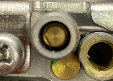

    Yes it helps for setting the floats; thanks
    I am still trying to figure out how to remove and clean the idle jets.
    This is what mine have; what looks like a tamper proof head. Screen Shot 2022-03-22 at 2.05.14 PM.png
    I have noticed 4 very very small holes right where the butterfly valve touches the body, these are right above the idle jet location so pretty sure I have to get these out to get this all cleaned up.

    I got it running! Thanks for everyone's help.
  5. capt
    capt Elite Member
    May 8, 2016
    3,052
    western Australia
    What cured it !!
  6. orttauq
    orttauq New Member
    Jan 1, 2022
    4
    Spokane, WA
    I had to get the idle jets out with the special D tool in post 23. That and another good cleaning while on the bench. Now I just need to get 2 new bowl seals (T1241036) but they are still on back order from local dealer.
