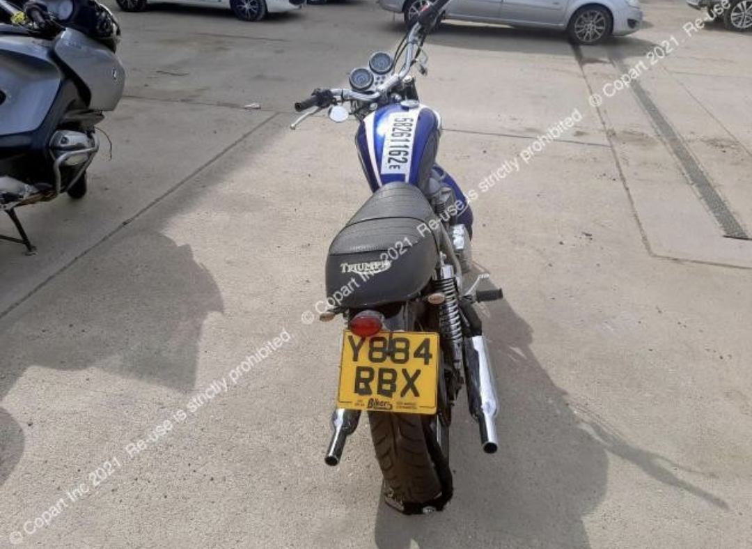

    Picked up a Vandalised/Stolen Recovered T100 last year.
    Screenshot_20230702-141935.png Screenshot_20230702-141955.png Screenshot_20230702-142010.png
    The headlight and brackets, some of the wiring, ignition switch and rear left foot peg were pretty much destroyed.
    The front mudguard, and tank were dented.
    It also had a altered numberplate from a 125 which I thought Essex Police would have removed but left it on...
