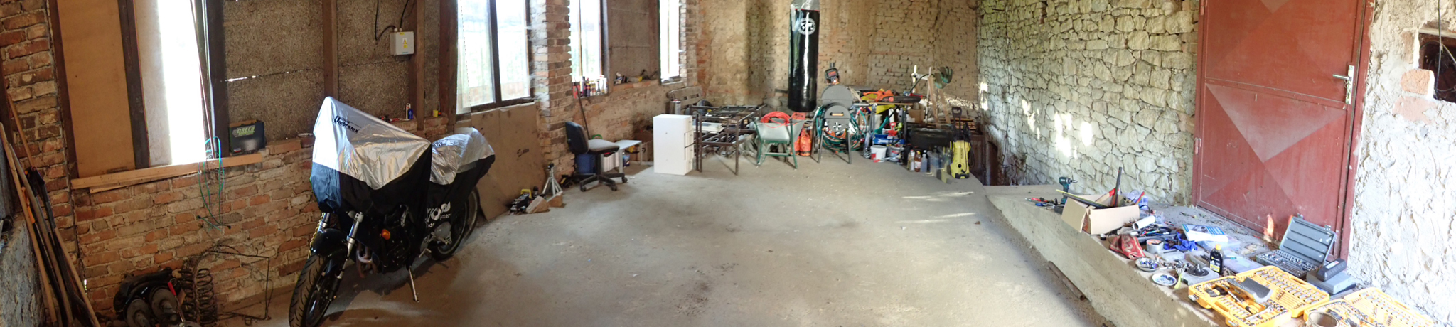

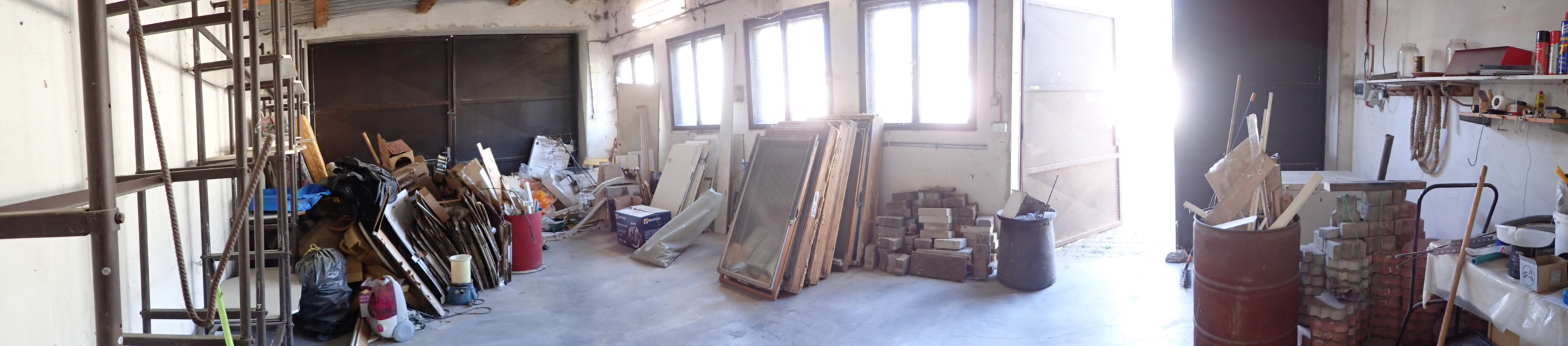

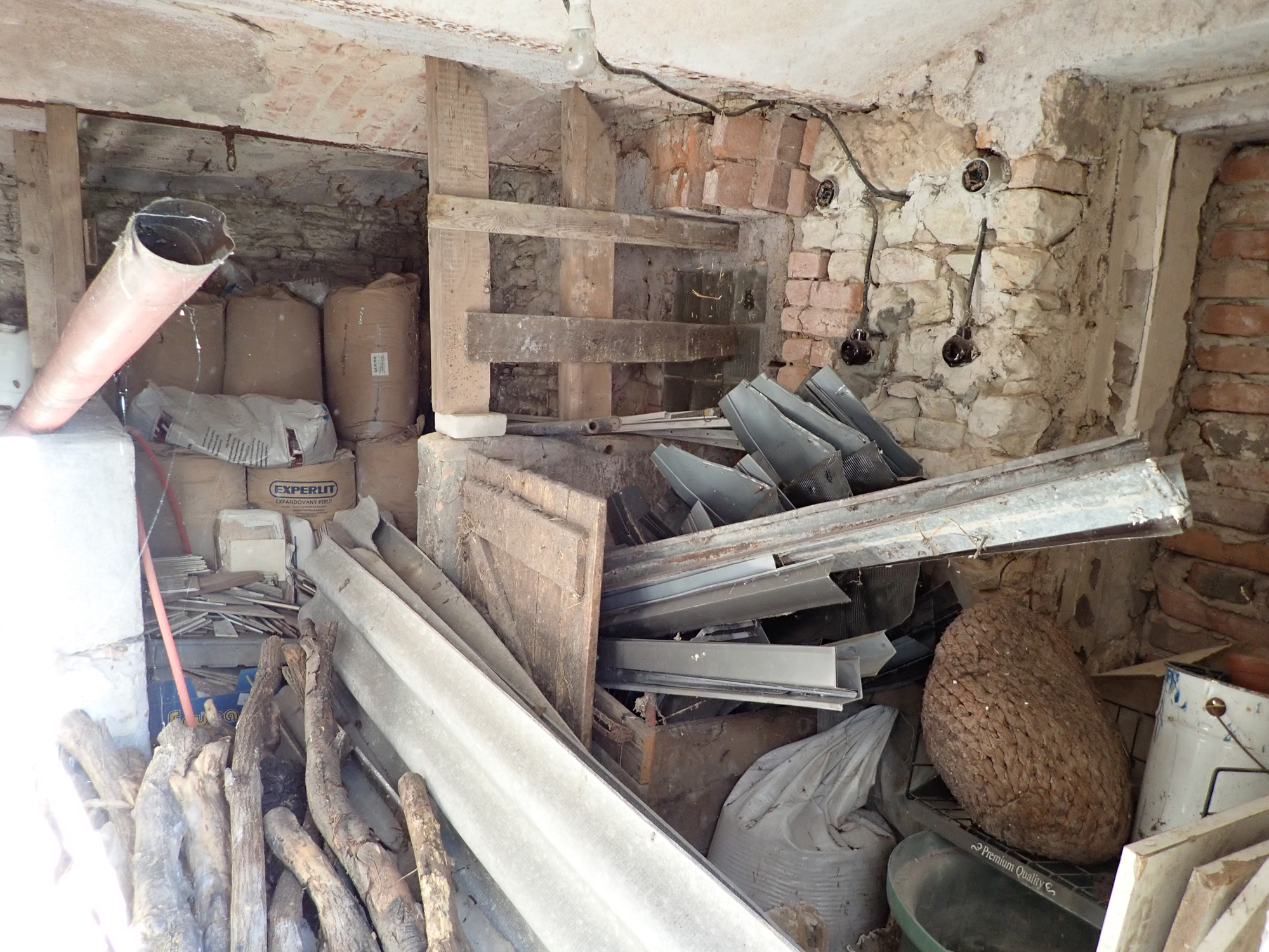

    So as I said, starting this project also means creating space in which to work. Below are my three areas.
    The double door garage will be the secure workshop for tools and bike, now I can actually see the floor, it looks like the best place.
    The back half of the barn will be for working on the car, plus any spraying or metal work I need to do (welding, bending, etc..).
    The small utility room (currently full of construction crap from the house) will be used for drilling and woodwork.

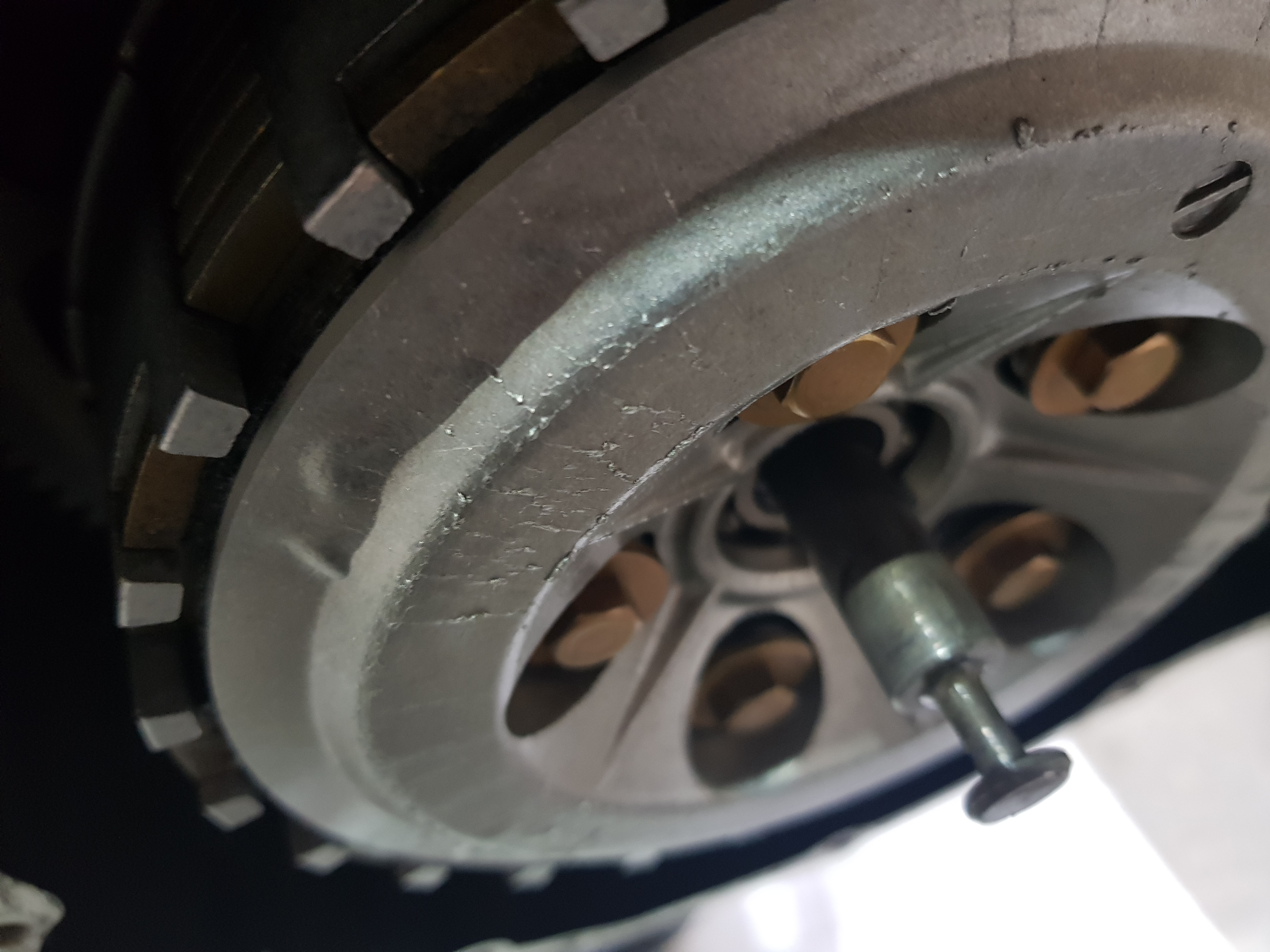

    I've got the clutch case off and notice a rippled bubble effect in the finish of the clutch plate retainer.
    Anything I should worry about?

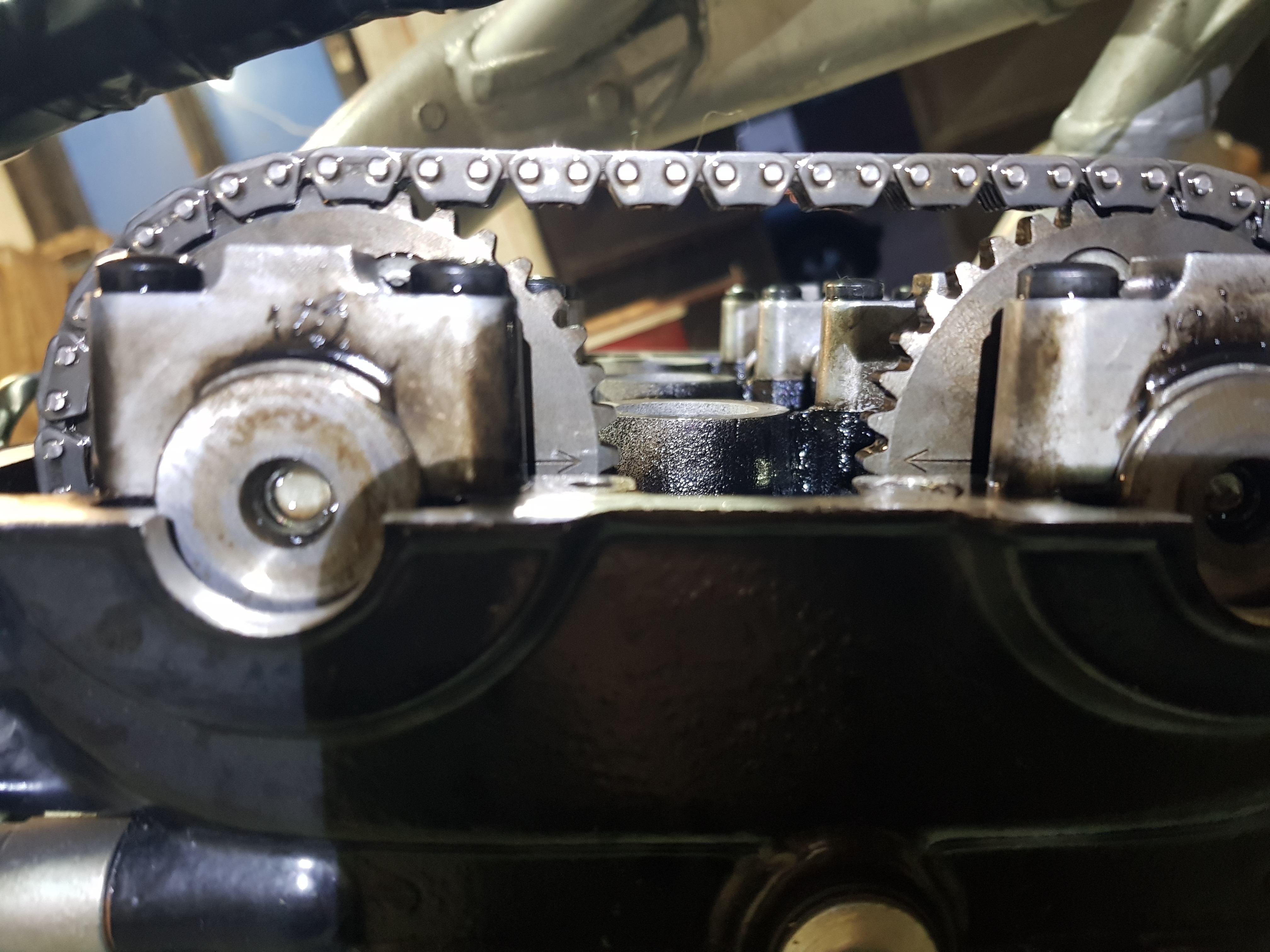

    So, with the top off, I have now managed to measure up all valve clearances.
    I had some trouble getting in there as my offset feeler gauge didn't go small enough and so was using a set of long flexible gauges which then led to bad words and many slices in the creases of my fingers.. I was able to measure down to the nearest 0.01mm with these, so not too bad.
    Whilst the clearances weren't too bad, there are a couple of issues I need to deal with.
    Some of the inlet valves are too tight so will shim them. I just hope it stays above freezing for long enough to get them out. I heard it's a little fiddly and with no feeling in the fingers, could get interesting.
    As I'll be removing the camshafts anyway, I will look at the bearings. Never used plasticgauge before so looking forward to that.
    The timing is also off by a fair amount, so will probably look into that, likely replace the chain, guides and tensioner whilst it's all open.

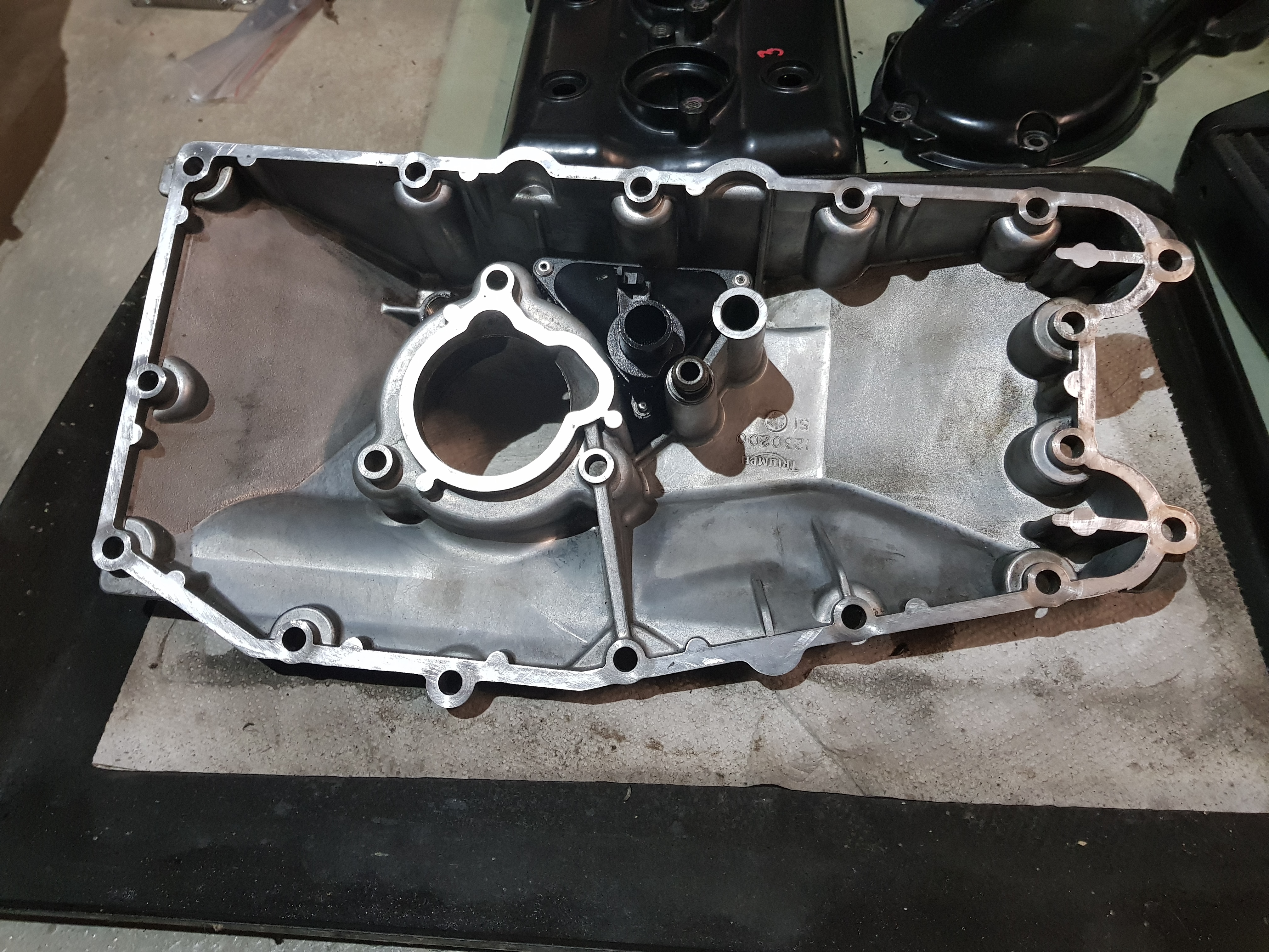

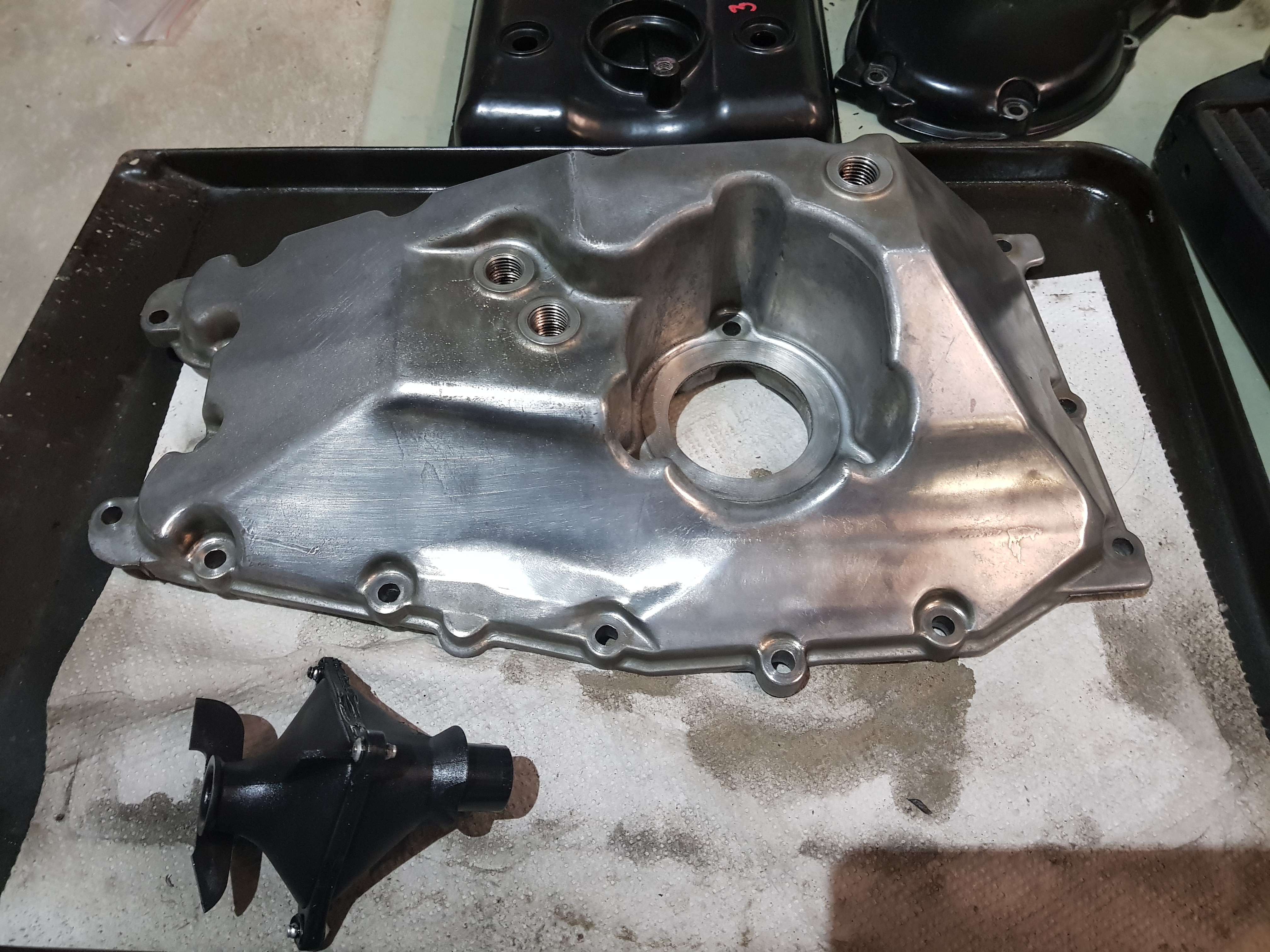

    This weekend I was cleaning the sump, valve cover and water pump.

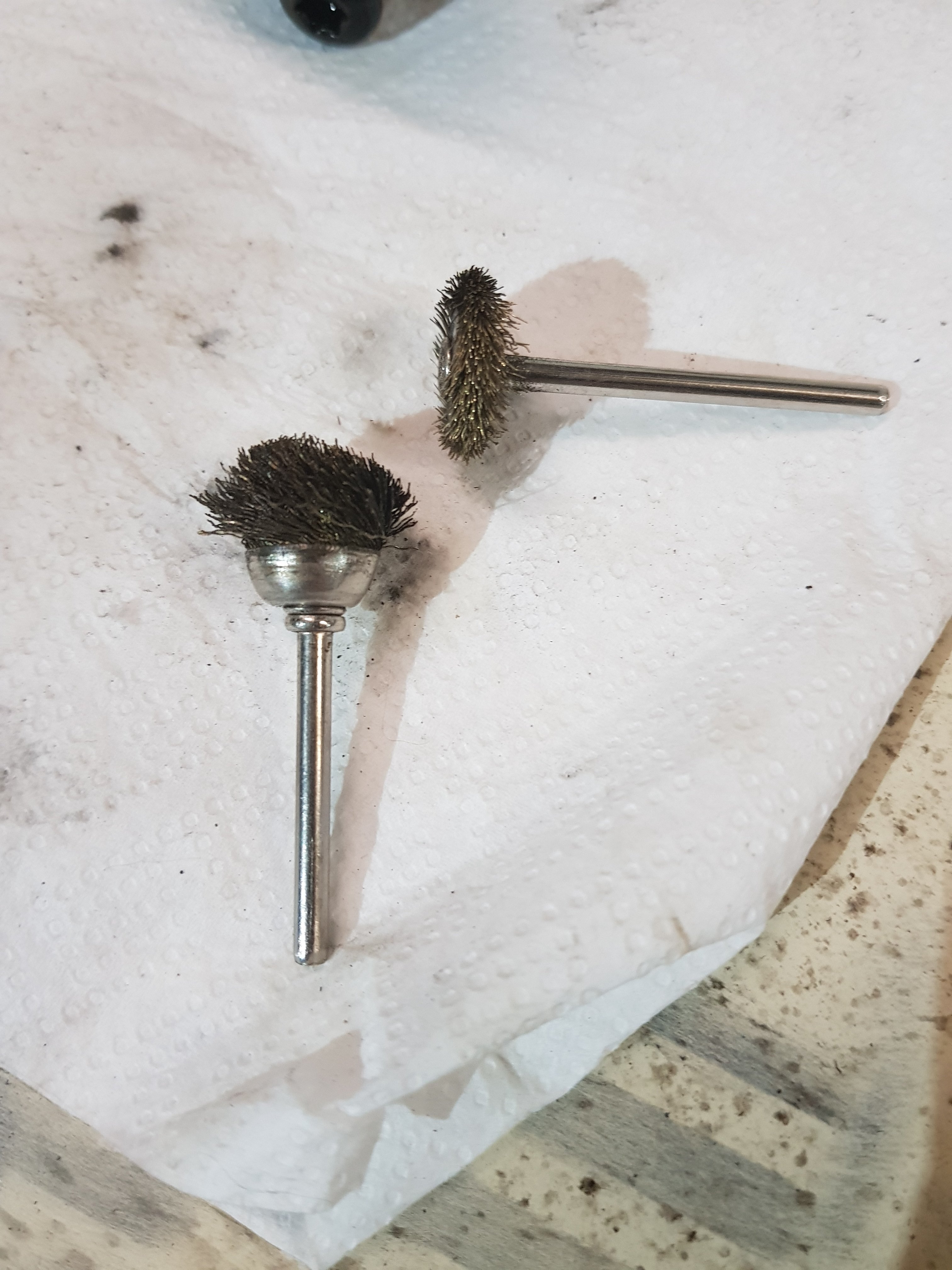

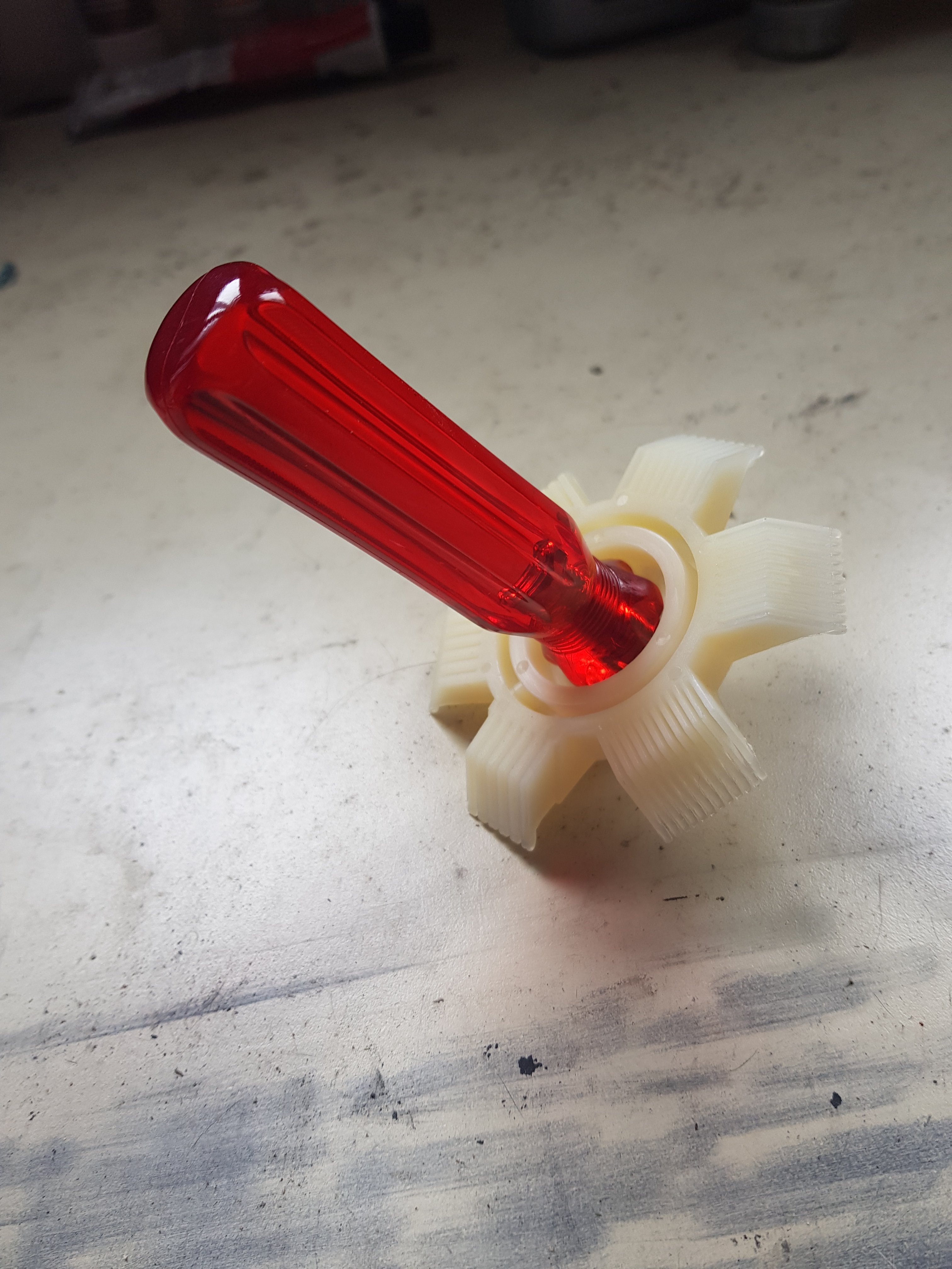

    So, I'll start with tools, everyone I have spoken to, and to be fair, past experience, told me I should just use brake cleaner and a razor blade to clean the gasket surfaces, however, to really get a good clean around the lips and little nooks I cannot recommend some brass brush attachments on the cordless drill.
    Those little things have done wonders for speeding up the cleaning process. A1 recommendation, even on aluminium!!
    I cleaned the sump and valvle cover to almost perfection in just a few short hours.

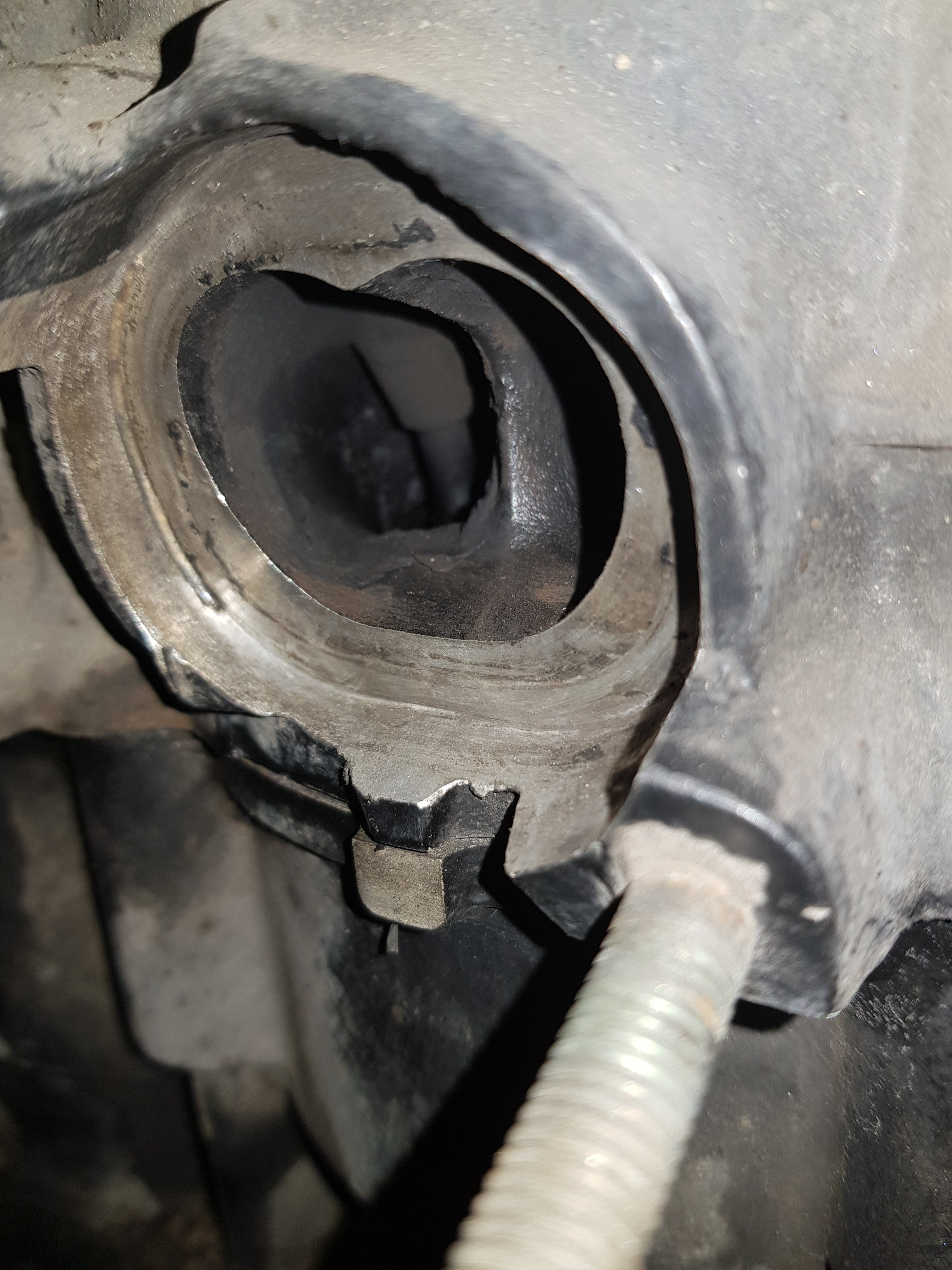

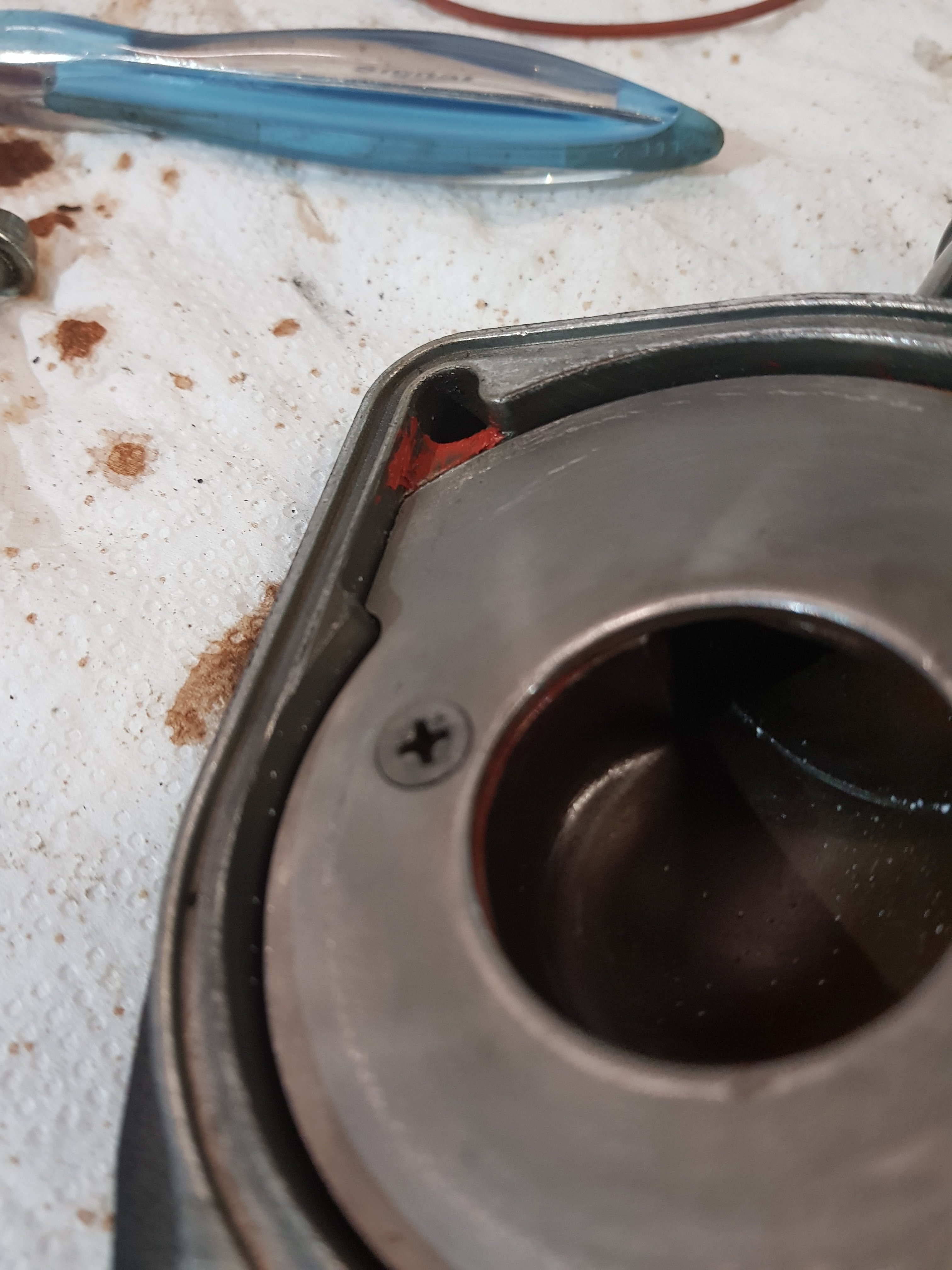

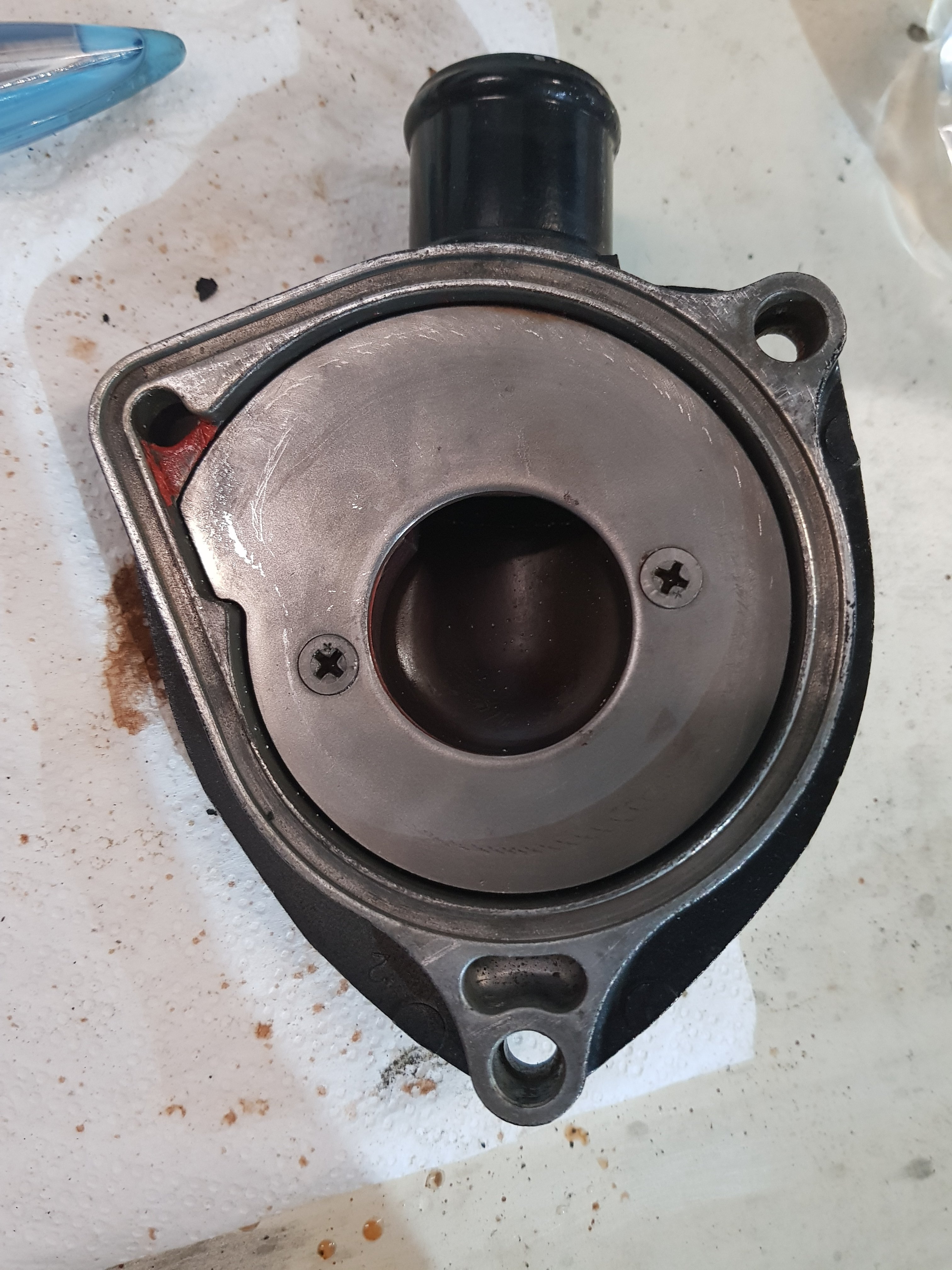

    The water pump on the other hand.. WTF were Triumph thinking with that? I mean, there most be a reason they allow the screw holding just the cover to contact the moving liquid, but when you buy a bike and all that was used in it was tap water, you begin to question stuff. The seal was good, but the inside was terrible. I had to wet and dry the cover plate inside and decided to use a little sealant between the plate and cover for future protection.

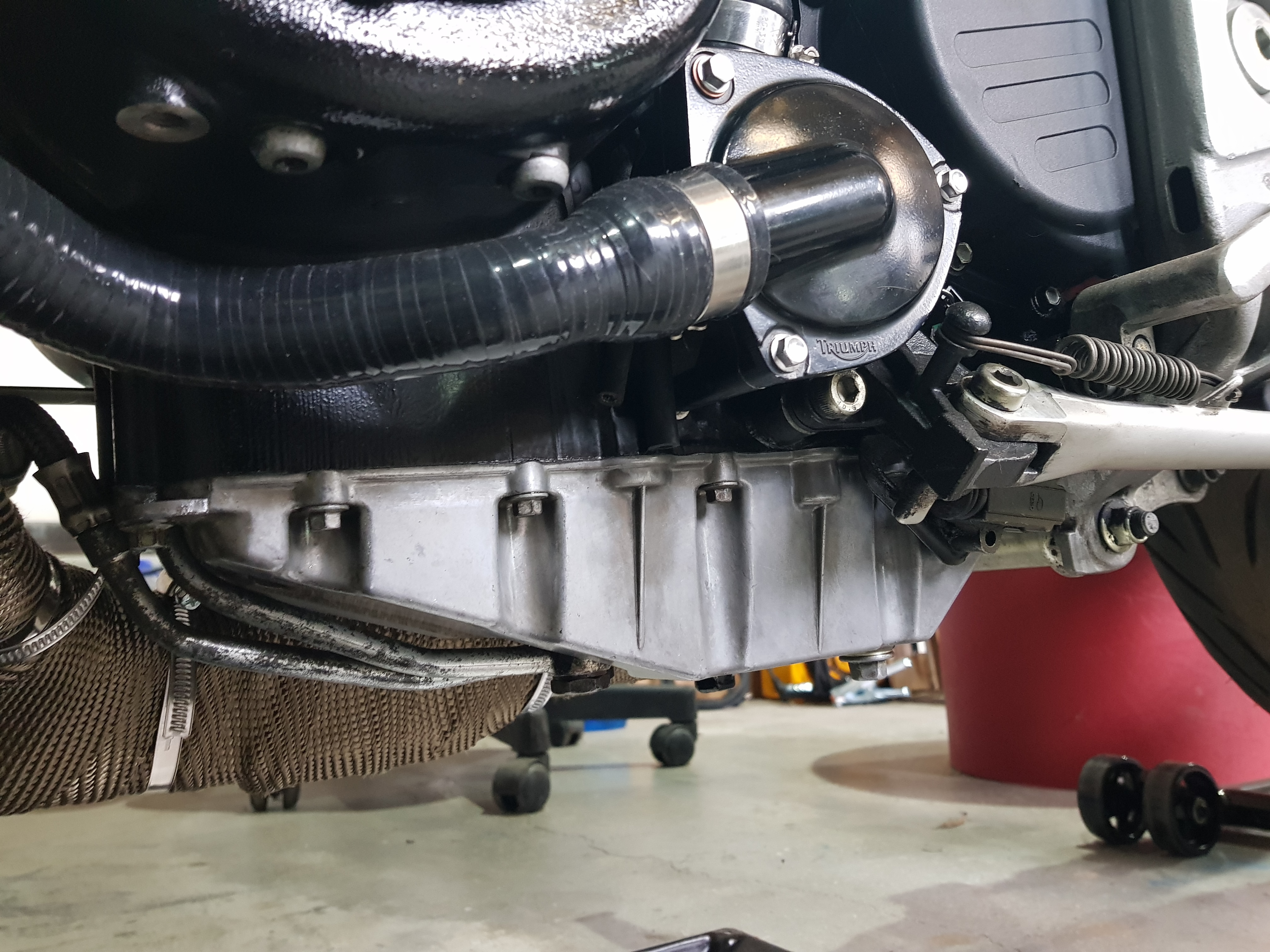

    Sooooooo, it's been a while since I last updated you guys.
    The build was going slow and waiting for parts to arrive over the New Year killed me.
    Living in central Europe and bying parts from the UK now brings a while new basket of fun.
    But...
    The clutch is in, all discs and plates were the same size and worked previously, so I've just changed the plates and put them back.
    The water pump
    , I fell like a tit, it's obvious to me now why the third bolt is open to the elements, it's a bleed bolt. Anyway, the new o-ring was fitted, everything is clean and it's all bolted in place. Should work like new.
    Oil breather seal
    on the LHS of the crank case is newly fitted and all put back together.
    A couple of small drilled hols in the edge of it allowed it to bend just enough to pull out by hand with no damage to the case.

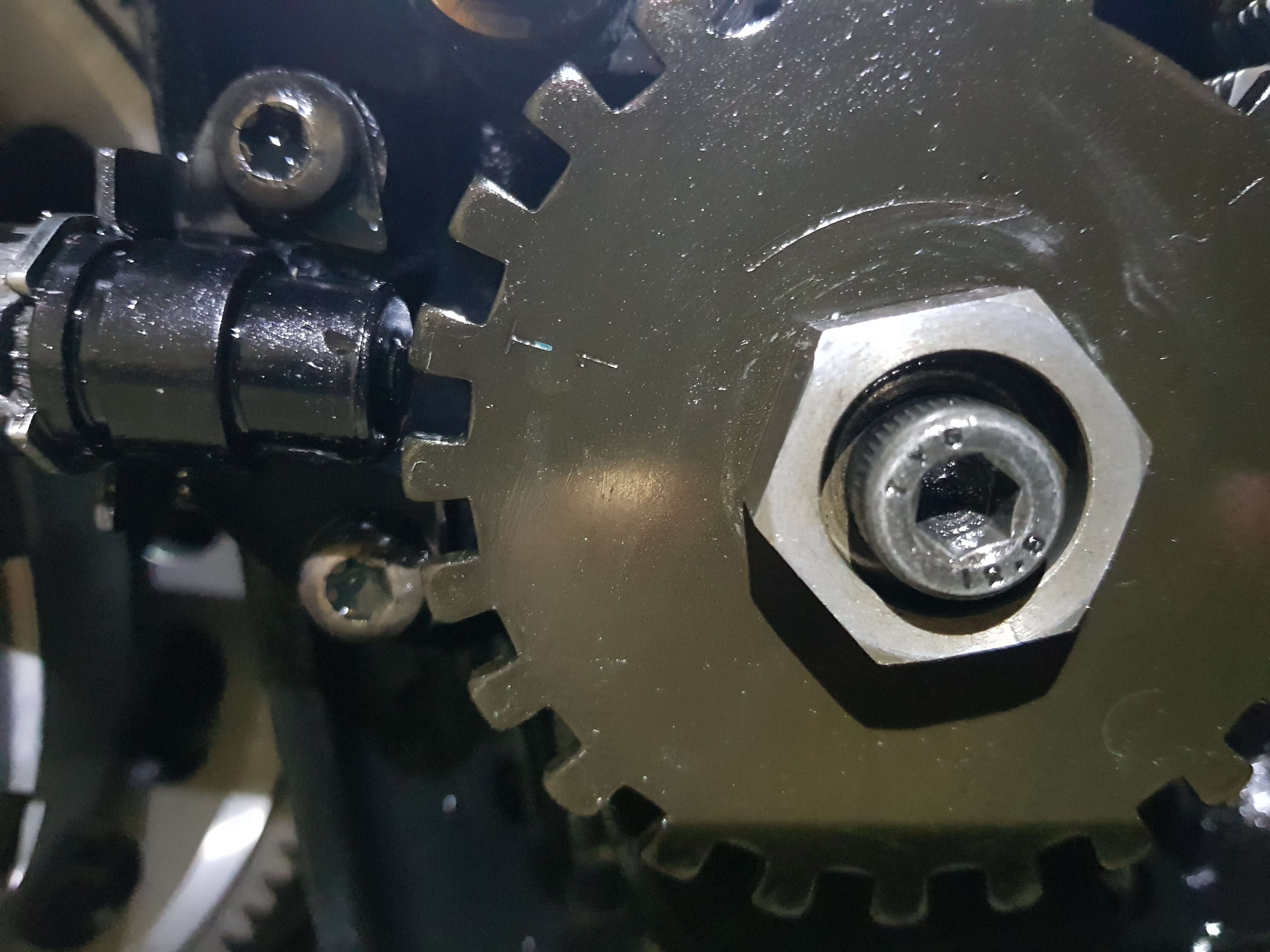

    Now... Valve clearances, those are all back to tollerance and cam shalfts refitted..
    Took me a couple of goes to reallign the timing and it's not 100% perfect, but it's as close as it's going to get on a 20 year old bike without replacing the major parts.
    The most difficult part there was trying to get the cover on and keep the seal in place without getting sealent all over the place.
    Changed the fuel filter cleaned the crap out the bottom and changed the couplings.
    There is a hell of a lot of petrol left in that bottom section even after pumping it empty. Anyone doing this be aware it doesn't feel like a lot, but it's near on a litre still rolling around in the bottom. Do it outside and over a bucket.

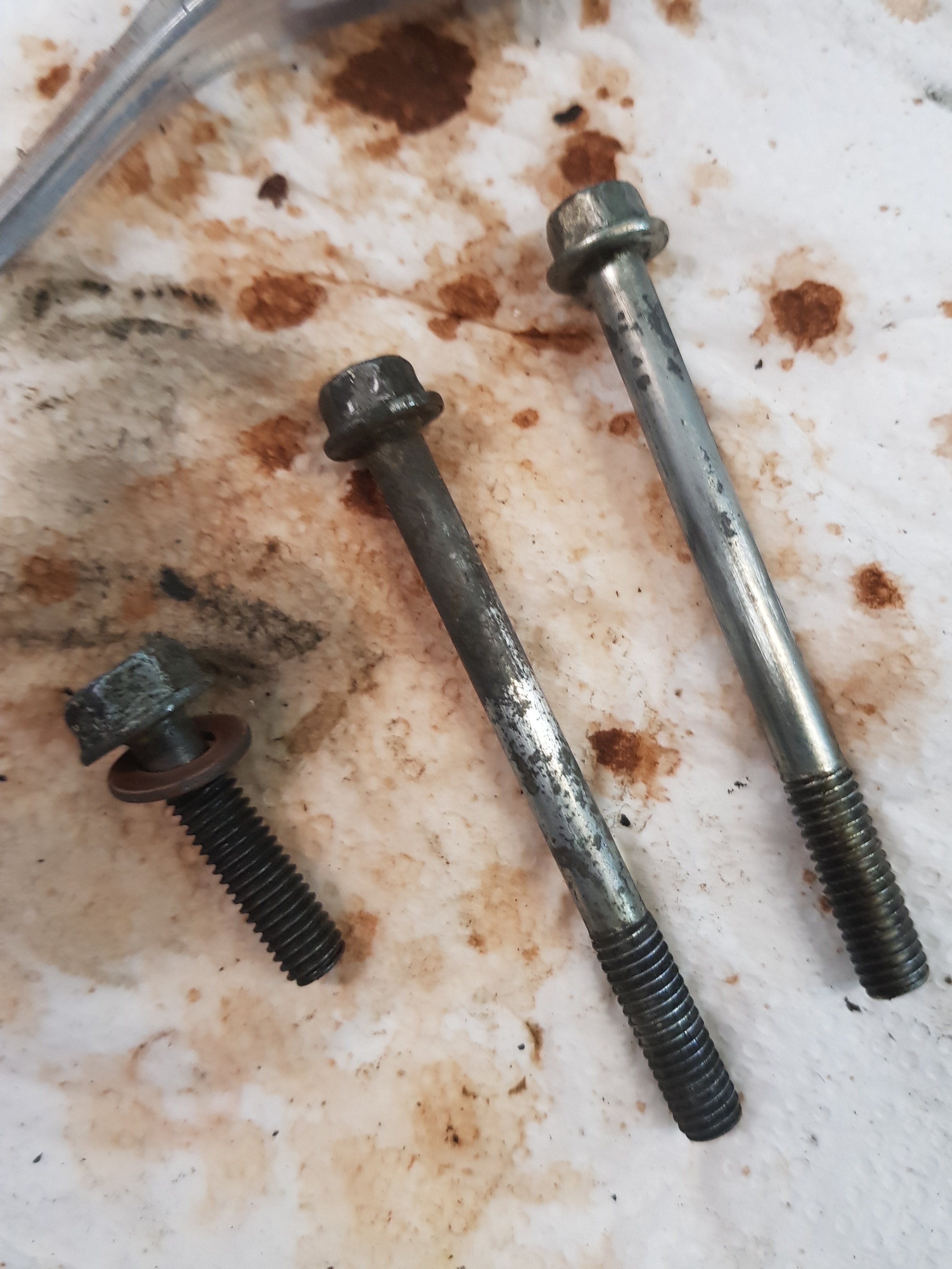

    Sump and oil pipes fitted, but I need a new torque wrench, anyone who has a good tip on a decent brand please let me know. I already snapped a bolt on my LHS casing putting too much trust in it. I'm going to have to retorque them once I get a new one.
    Exhaust downpipes cleaned. Used a light plastic spinning brush on the drill to clean them, a little brushed pattern appearing on them but I can live with that, it looks quite good. A whole lot better than previously.
    I replaced the old one that came out on the nut, but couldn't get the nut off, so again, I've got to wait and get out to buy some new nuts.
    Throttle body clean and reattached. Swapped the crappy corigated plastic for blue vacuum tubing. Not got them ballanced yet as I can't fill the oil at the moment. Will be using TuneECU and CarbTune gauges for that.
    Instead of replacing one bolt, I'm tempted to take this time to change all the engine bolts for new Pro-Bolt fasteners, maybe gold to match the new chain and sprockets that will be going on. Something to ponder...
    With it being -17 Centegrade and a good foot of snow, I have some time.
    Oh, got over the heat issue, got myself a little 10 fin oil heater from Sencor to keep the garage a little toasty.. Works wonders.
    TTFN and stay safe all.

    The valves were done, no major issues there, I put in the required shims, fitted the cams, did the timing or as close as I could get it.. think I will need to do the chain at some point later. And fitted the cover.
    The whole process was very straight forward and the hardest bit by far was getting the cover on and keeping the rubber seal in place whilst I did it. A little wiggling and lining up with some gasket sealant and slowly pressing it all down and it seems to be ok, no leaks as far as I can tell.

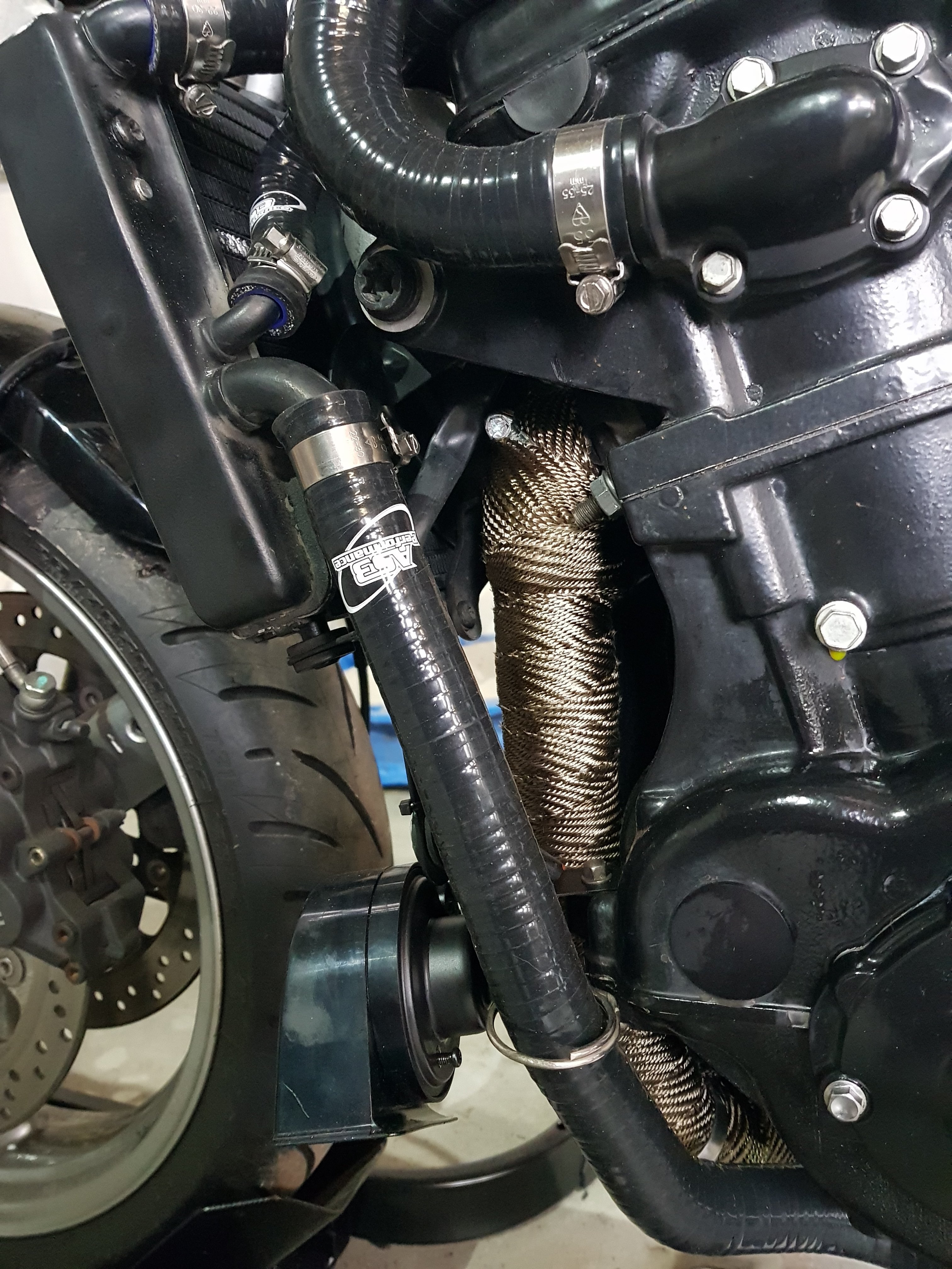

    Although I cleaned the exhaust, I decided to wrap it whilst it was all apart.
    I also fitted the missing stud and had to reorder some new nuts.
    I sprayed the pipes first with UHT paint, gave a nice good wrap on the centre pipe to reduce heat from either side, sprayed that, then wrapped the outer two with the Titanium DEI wrap.
    I stopped trying to use the metal cable ties as they didn’t keep the wrap tight and ended up fitting some tube clamps. It’s a little more obvious than I wanted, but it is a far better hold on the wrap. Wear gloves, this stuff made my arms itch for weeks.
    When putting the Throttle Body back on, I noticed the stepper motor piston was detached, could easily be why I was seeing rough idle and stalling at junctions. However I also changed the plastic tubes that were on there for some more suitable rubber hose.

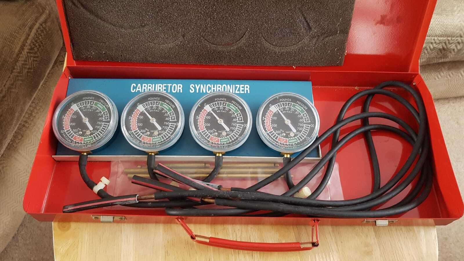

    I am currently waiting for Chronopost to deliver my vacuum gauges and the new stepper motor so I can finish the job.
    I am yet to get TuneECU to stay connected to the ECU, it connects then instantly disconnects. Alain has had much trouble with this over the last couple of months and so I haven’t played with it too much due to licensing issues…
    Think I will have to link a car battery up to the bike to see if voltage is an issue, although I’m currently running two bike batteries and it’s on a charger…
    Will have to see what’s going on here later. There's nothing wrong with the power to the plug, I checked already and the fuses have been removed for lights, although I am seeing a steady drop in voltage when the ignition is on.. Something else to check later.
    The cooling system has all gone back together nicely, still need to burp it properly and I’m a little annoyed by all the new ASE logos being up-side-down on the hoses. Maybe just my OCD kicking in.

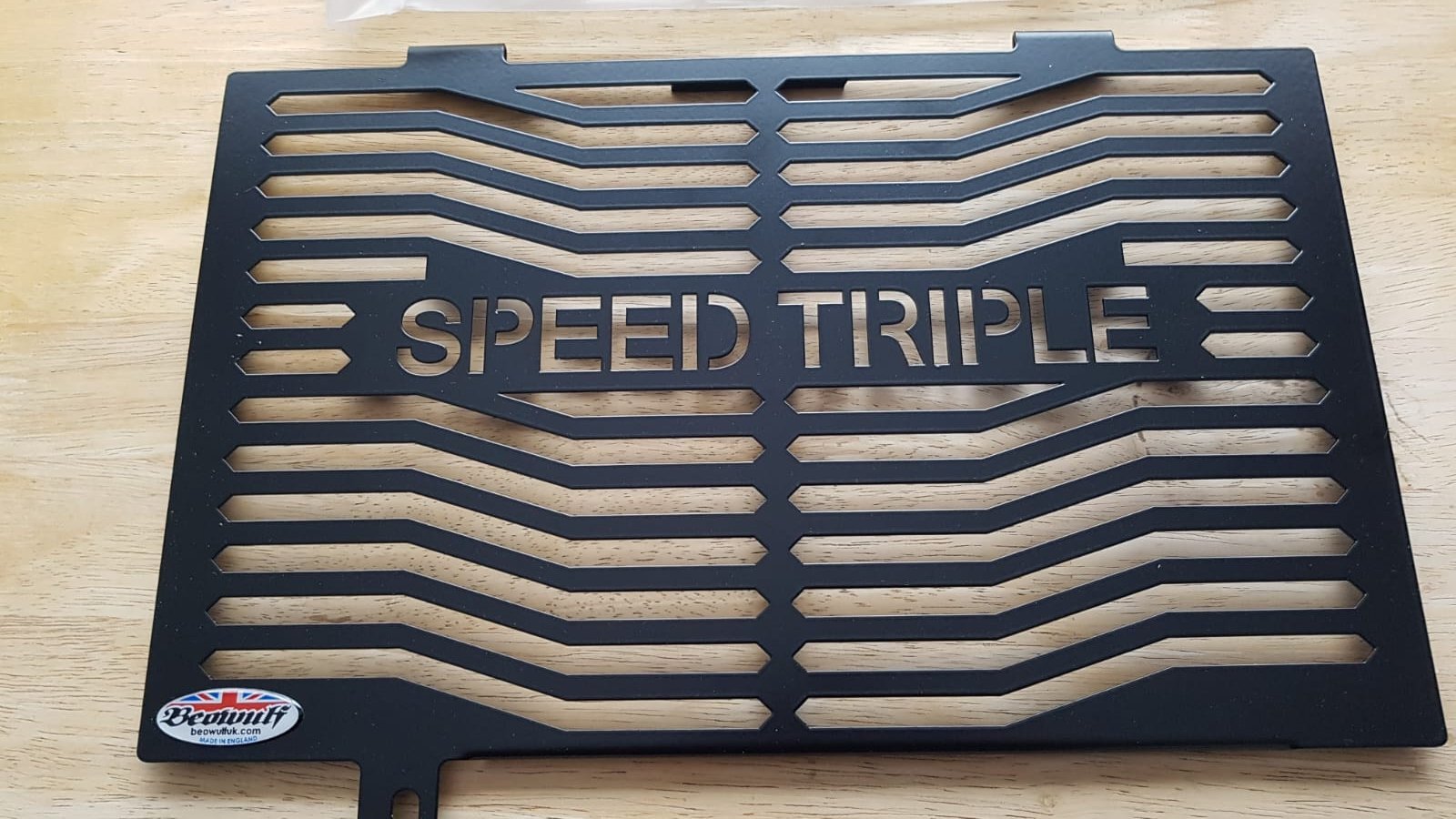

    A little damage to the fins I will comb out and a new BeoWolf radiator guard to fit when running properly.
    Cleaned the air filter, changed the oil - note to future self, ignore the torque settings in the manual when using a K&N oil filter, nip-it-up so it’s doesn’t piss all over the floor.
    Because I’ve been waiting for parts, I’ve been doing a lot of cleaning and some minor cosmetics.

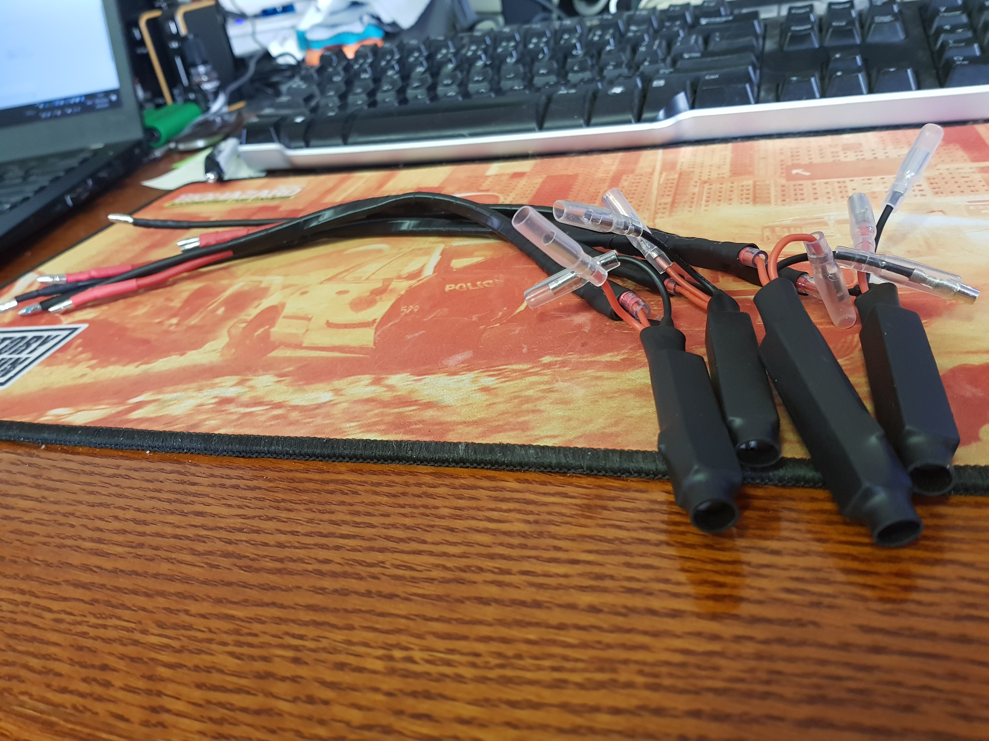

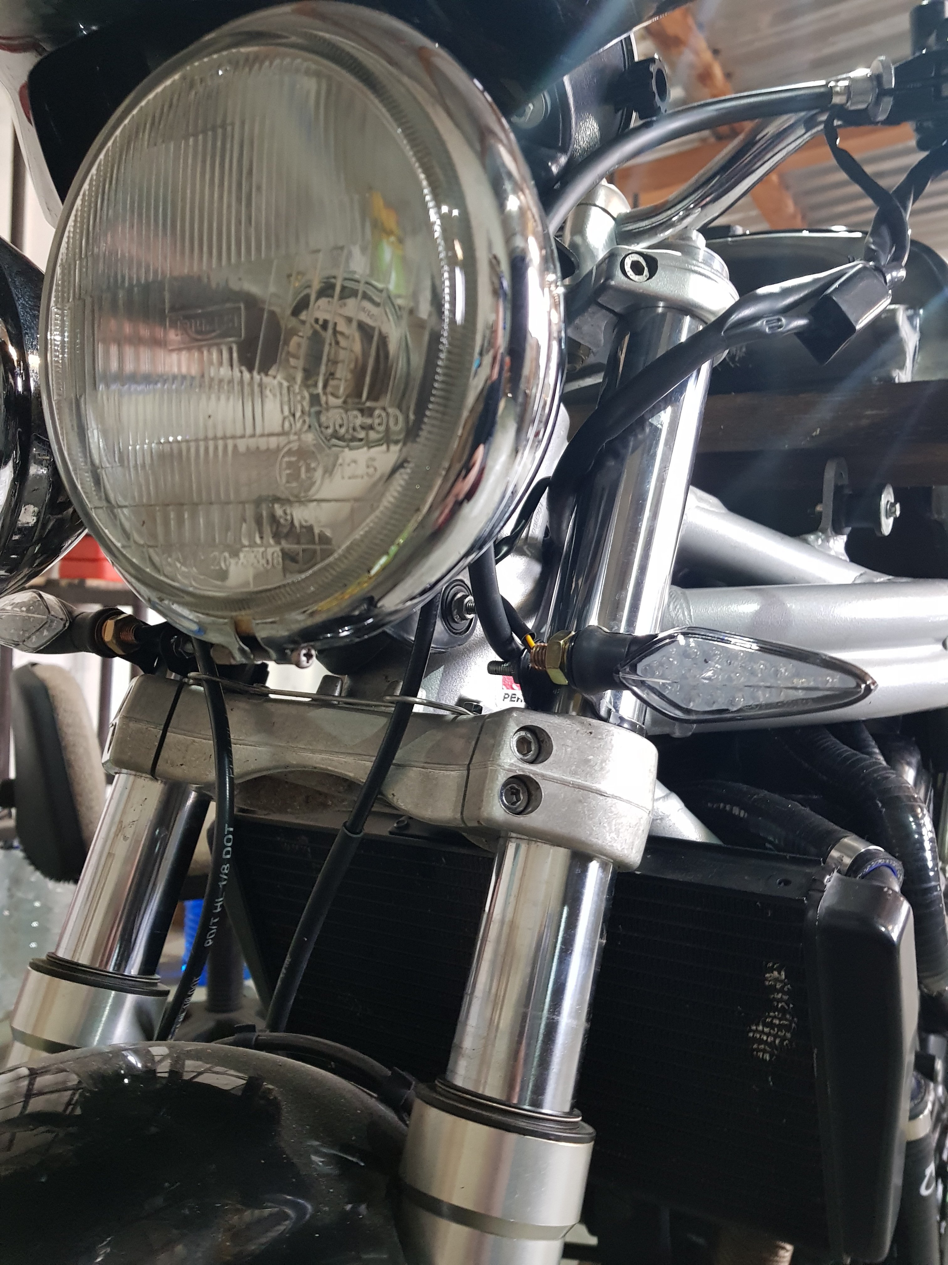

    I moved the front indicators to the forks, changed for LED's and added the resistors. Looking at them now though, I’m not sure now if they will catch the headlights when at full lock.. Will test that when off the blocks.
    Denali Sound Bomb fitted, but again, it’s quite fat and I’m not sure if I’ll leave it in the original location or move it.
    Still looking for an undertray and seat cowl so I can do the rear end.
    Added a Trident GP Stubby carbon can too. This however is not stubby and not GP style, I will have to contact them back and see what happened.. because of waiting for parts, it’s now been quite some time since I received it. Should have had a quick measure up a long time ago.
    So right now, I’m still waiting.
    I fired her up, started straight up, awesome, and sounds much better, I’ll have to wait until I balance the throttle before I can put the air filter back on, refit the tank properly and let her warm up.
    I hope this has solved the ticking issue.
    So for now, with the last freeze of the year expected this weekend, I’m still waiting for tools and parts before I can test my work properly.
    After this, new chain and sprockets (will be running on 18 front and 46 rear), a distribution FuzeBlocks unit to go in so I can run additional accessories (yes, I’ll be getting some grips) and I can move onto the suspension at some point after that.

    I have never liked the seemingly 'hidden' nature of my front indicators - barely poking out from the radiator fairing. I like that yours are on the fork.

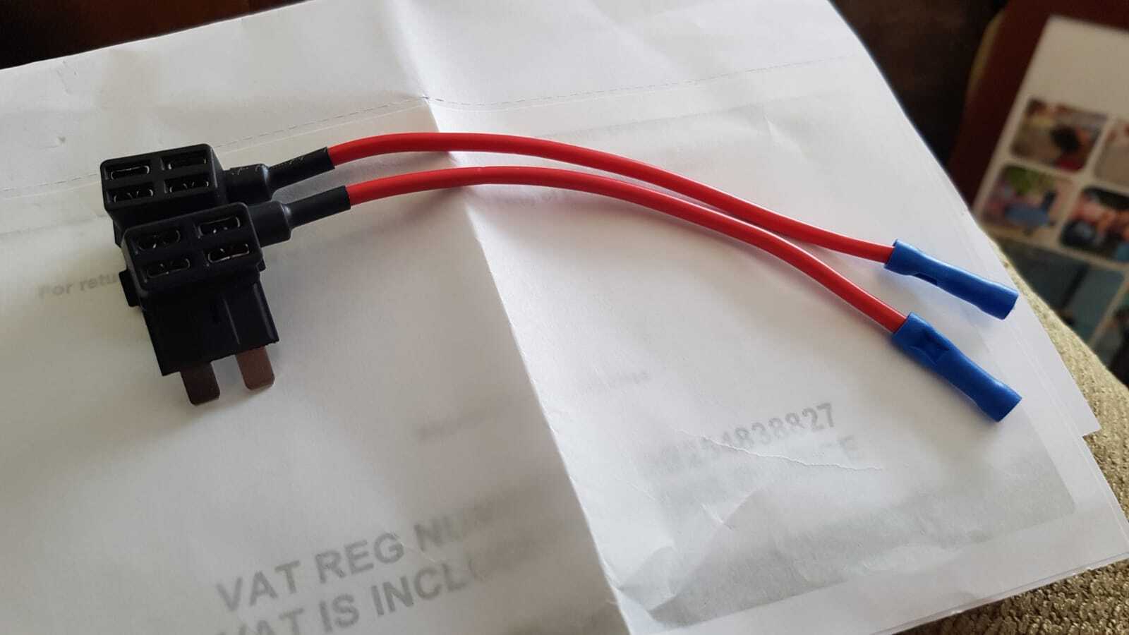

    I tried to use an inline splitter at the fuse however they didn't fit as the connector was too wide, so soldered in a separate wire off the light for the numberplate.
    I tired to comb the damage out of the radiator without success, I kept asking myself if it's just too far gone to comb or if these things actually work.
    I cheated and used the BeoWolf rad protector to cover it all up..
    Throttle balancing is very, very easy, although a little fiddly. Plugged the Carbtune in, started her up, waited for the temp to rise and adjusted at idle, reving in between to find a stead pulse then checking at around 4-5k rpm.
    The three heat cycles did worry me slightly.
    The first one, was spluttering and wanted to constantly stall,
    The second started at 3k rpm and moved slowly up to 5k rpm after 10 minutes,
    The third one went well and was doing ok until it ran out of juice at just over 12 minutes.​
