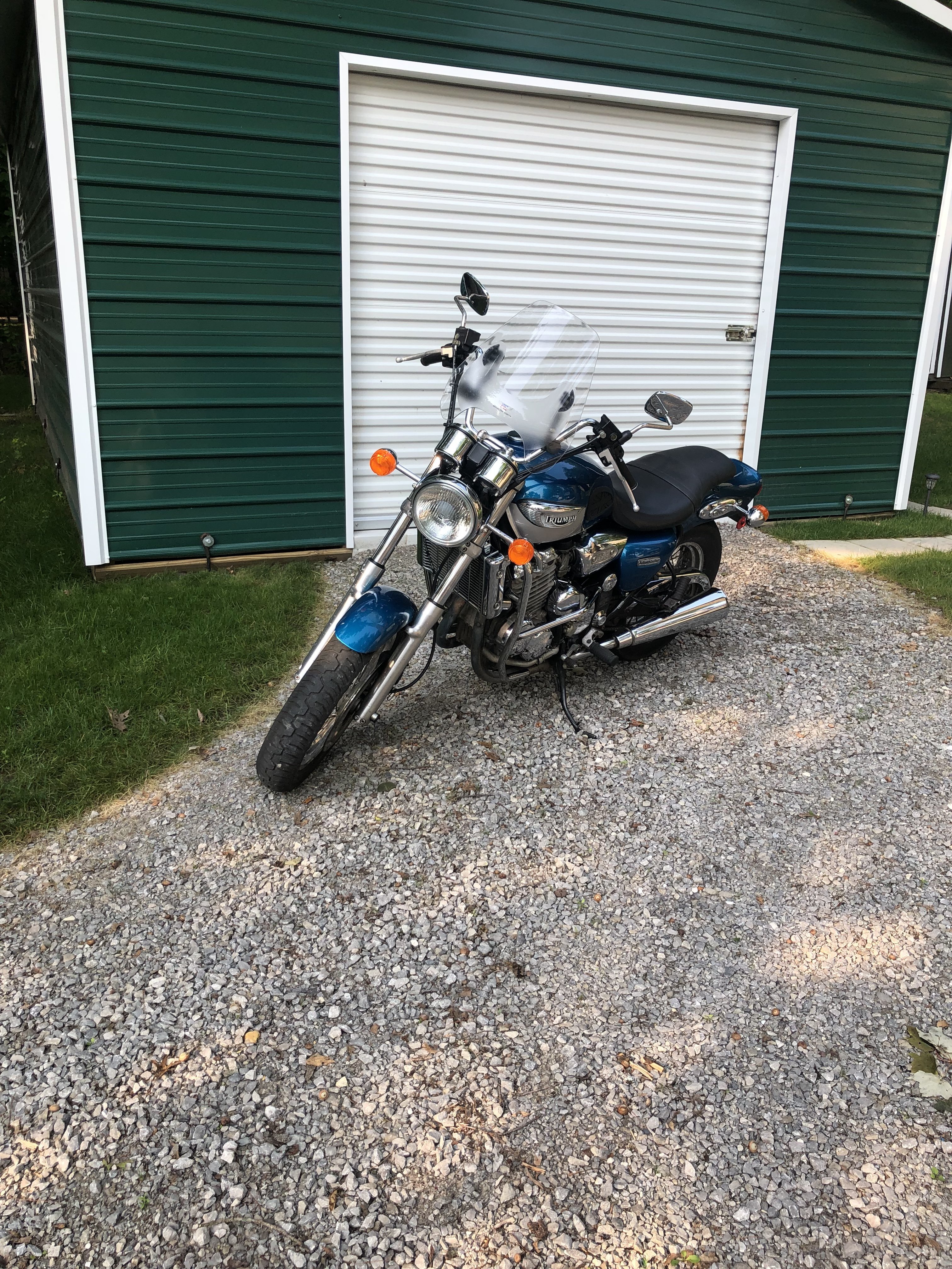

    Hi,
    I have a 1996 Triumph Adventurer 900. Just got it out of the shop. Carbs completely gone thru, synced, new plugs. All fluids changed, new brakes also has an extra inline fuel filter. Running premium 95 with a cap full of Klotz octane booster per gallon. Anyways. I took it out for a 5 mile run and on the way home it just shut off and wouldn’t start. I dog walked it a bit and it finally started back up. Now I don’t trust it. Two days before I put 40 miles on it no issue. Has anyone else encountered this problem and maybe have a solution? Any help would be greatly appreciated.
    Thank you,
    Dan
