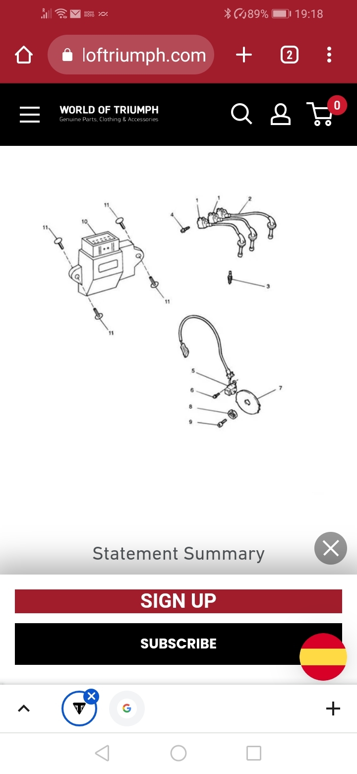

    No, the part you need is, the following
    Ignition System 111989 Part no 5.
    It's almost at the bottom of the page. I'm on my mobile at the moment, and I'm not too good at giving exact locations. But I'm sure if you go on that website and put in the details above I'm sure you'll find it. I'm no mechanic, so someone else might come along to confirm the part number. Also I can't zoom in on the picture. Hope this will help you out. Keep us posted :)
