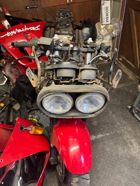

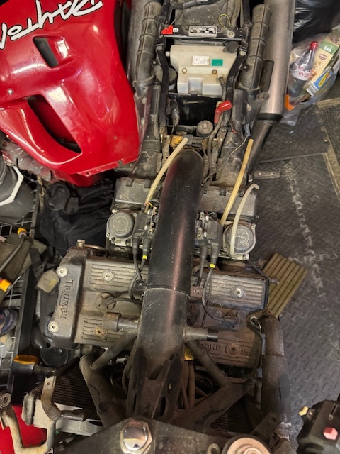

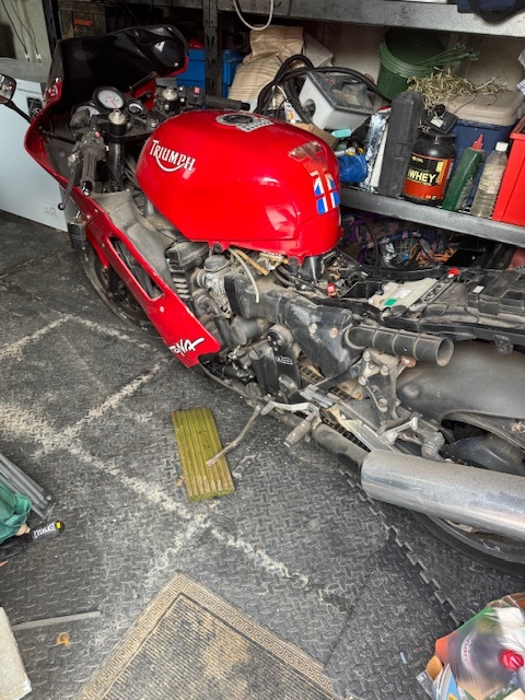

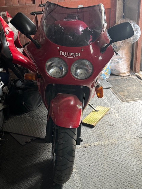

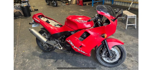

    I started a thread in the Daytona section but thought it probably best to have it in the correct area.
    For quite a while I have been looking for a project but prices seem to have gone mad. During a drunken moment of madness and with some persuasion from the wife I bought a rough Daytona 1200 on eBay blindly. Bike has just under 18k in the clock and hasn’t been in the road in 10 years or so. It was also unknown if it ran.
    well it’s here now, very dirty and the big strip has begun. I will be doing this slow time and not sure how deep the strip will be yet. The fairing and panels are now off and I’m going to attempt to see if she will spin over as soon as the new battery turns up tomorrow.
    below are a few pics…eBay and the compact area in my garage.
    if it spins freely then I’ll strip and clean the carbs etc then look at the starter and ignition system…..see if I can fire her up in the next few weeks.

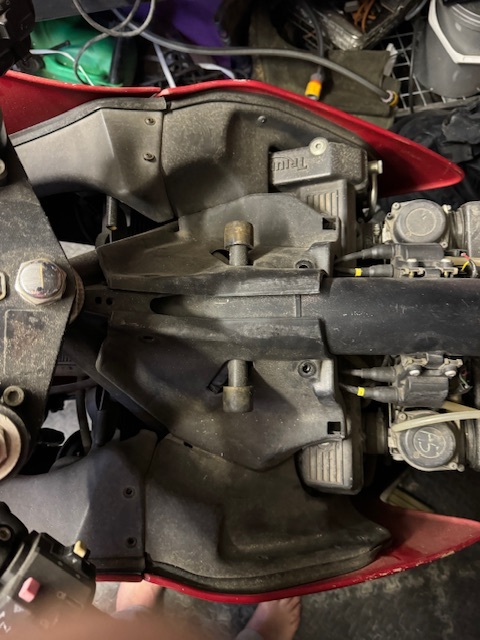

    Haynes wiring diagram is as much use as….
    Airbox and carbs removed, the more I dig the more I regret
    The wiring looks a mess with odd connectors not connecting to anything.
    Airbox snorkels are both rubbish as are all the carb rubbers, rear shock is corroded and will need a swap too.

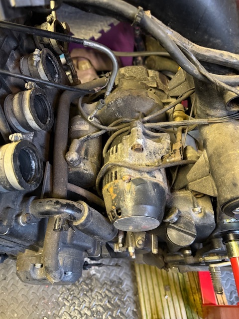

    Plodding along with it, it’s turning into a real money pit
    Carbs rebuilt and sonic cleaned.
    Electrics sorted.
    Shock and linkages off, linkage was cracked and shock corroded badly.
    Back mudguard removed as badly chopped.
    Now found YSS shock I bought is missing the bottom linkage bushing and seal.
    Exhausts fell apart as I removed them, need to figure out how to remove the link pipes from the manifolds.
    Still lots of cleaning to do.
