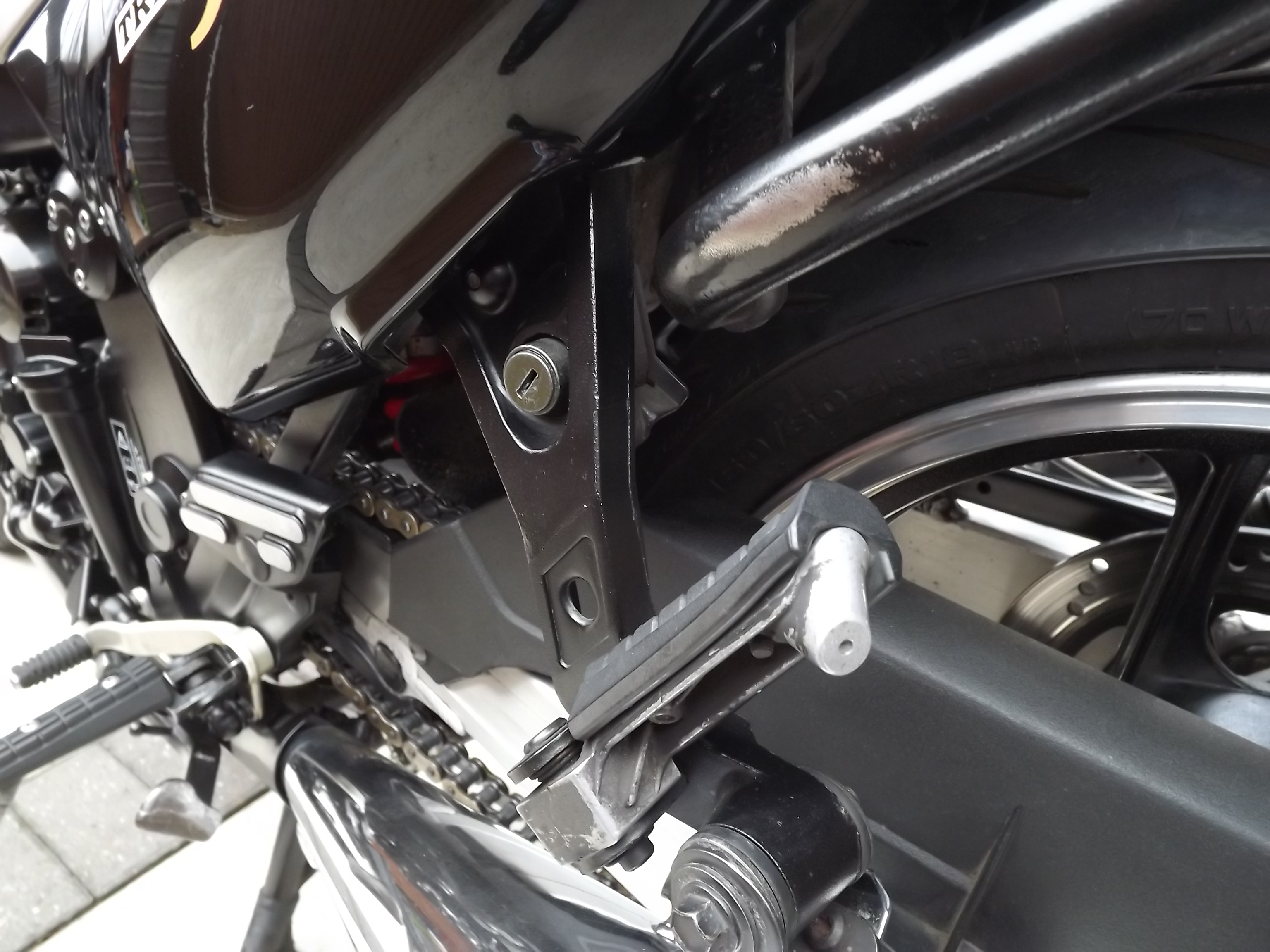

    There should be a keyhole/lock on the left side pillion foot peg bracket which is used for unlocking the seat. The ignition key should fit it.
    Hope the picture helps.

    Thanks again, yes I know about the key but either the lock is fxcked or the cable as turning the key does not move the wire in the cable to release the seat.
    So at present have been told to pull at the cable hanging by the rear fairing near the lock. I will need to get that sorted

    took the lock apart and the plastic inside has worn away one side, do you know where I could get a new (secondhand) lock as will transfer the plastic section to my lock so I can keep the key
    thanks Graham

    Hi Graham. Looks like the lock body is available to back order :-
    https://www.fowlersparts.co.uk/parts/5065/speed-triple-carbs/ignition-switch-seat-lock
    Part number 15 on the diagram.

    Put an extra washer under each of the bolts, when you refit the mechanism. It raises it a bit, and makes it much easier to get the seat on and off.
