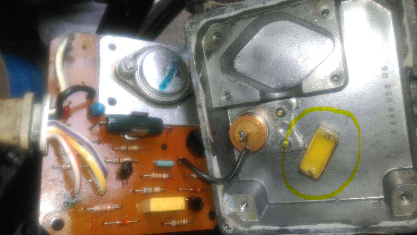

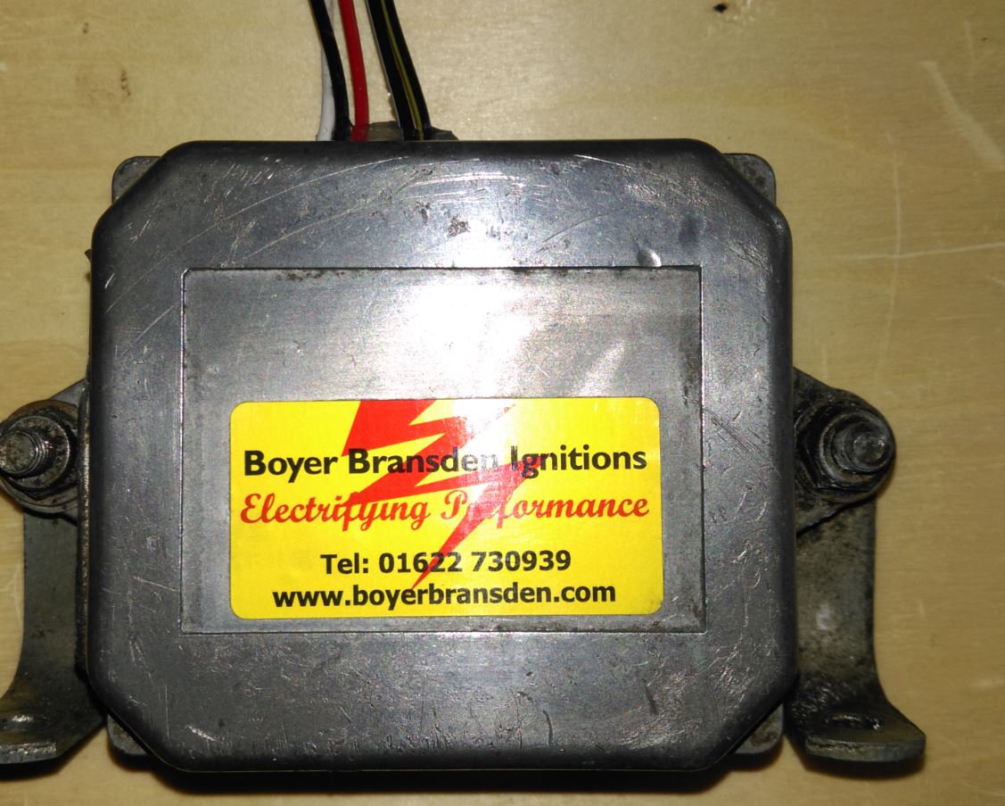

    Well, I stripped of the old lucas system and it clearly had something rattling about inside, see attached picture, i fitted the boyer and engine runs fine, i am awaiting my 2 in 1 coil before i test drive but feel confident, i will leave converting the rectifier till i have the ignition sorted. I ground out the Lucas casing and fitted the boyer inside, saves a bit room under seat for any other additions. Capture.JPG Capture1.JPG IMAG0214.jpg

    Good work Derek, and a neat use of existing housing.
    Have you checked that you have a stable voltage at battery with engine running, of between 13.5 and 14 volts?
    I would still recommend replacing the regulator/rectifier with one of the modern Wassell dual phase units, as the original zenner diodes have a habit of sudden failure, often wrecking the battery and sometimes even the E.I.amplifier.

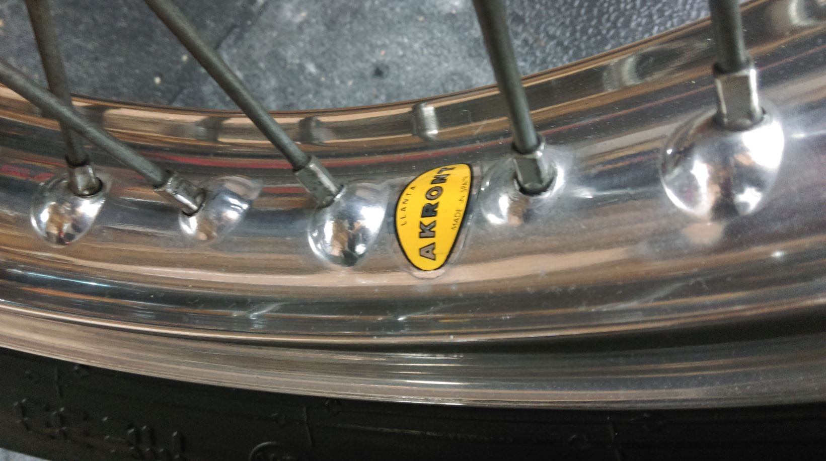

    I have got, and plan to change it, just wanted to get the other stuff out the way, spoked alloy, not sure what they are , made in spain?
  14. thebiglad
    5,064
    Akront rims are aluminium, well-known and highly reputed.

    Yes they are good rims, the four stud morris wheels can be a bit suspect (some say they are prone to cracking), but the lester six stud wheels fitted to export model seem to be ok.........mine have done 60,000 miles and I haven't managed to break them o_O
