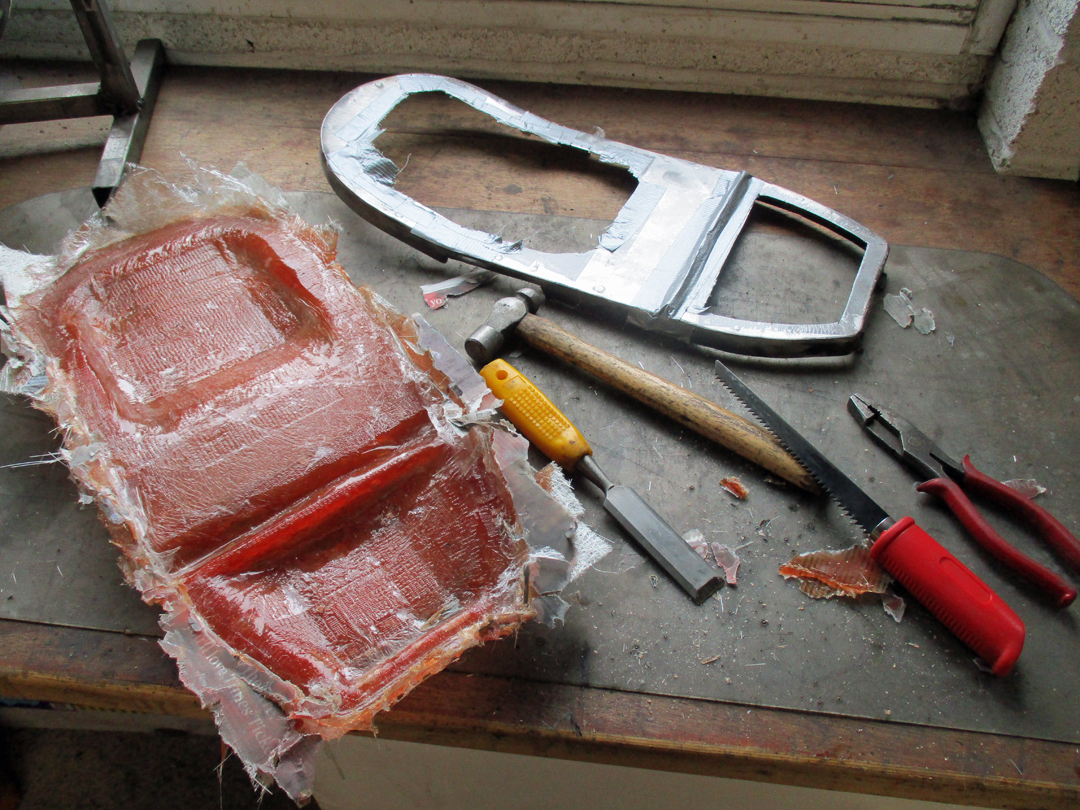

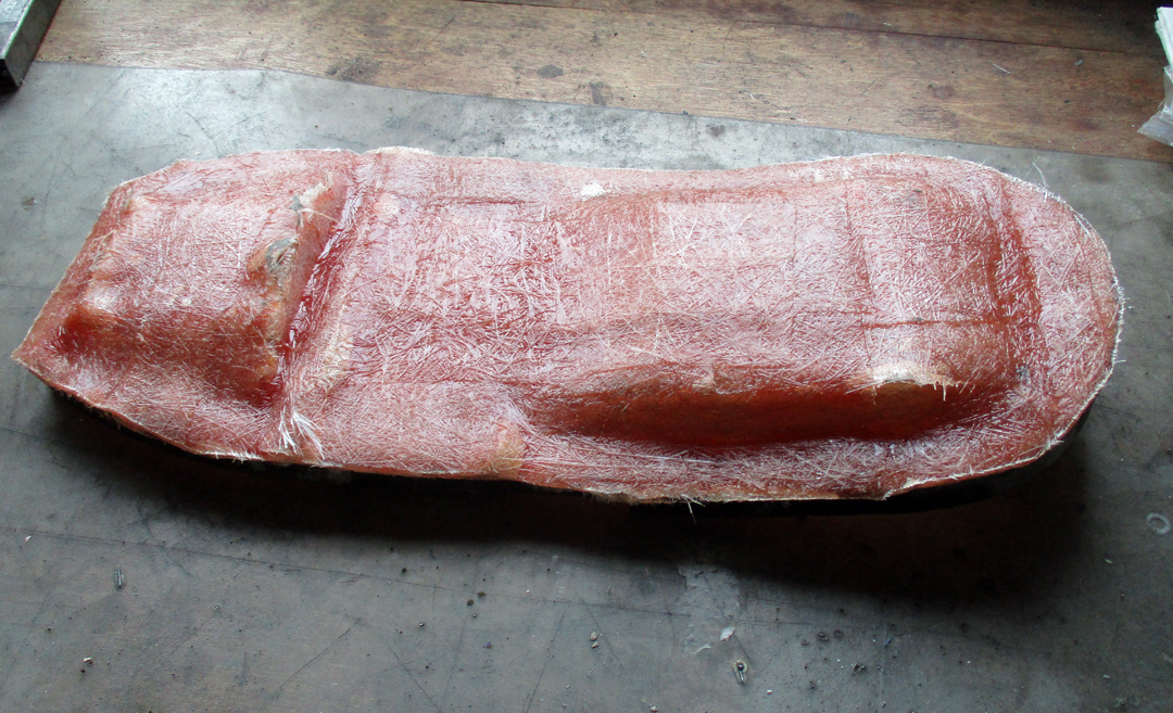

    This is what I had lurking in the garage, it looks all gooey but it's solid.
    Cor, it took some removing from the frame. I thought I was going to break it but found that a chisel and hammer was the best route:
    Of course everything needed a clean up. The resin had dissolved the duck tape adhesive which all had to be cleaned off with solvent. The lacquer thinners made short work of that. Cellulose thinners was just as good but I don't use that anymore as I'd be dizzy after using it to spray with.
    Disc cutter zoomed around the edges to clean the glass fibre up a bit. I kept away from cutting too small as I'll do that when it's back on the frame.

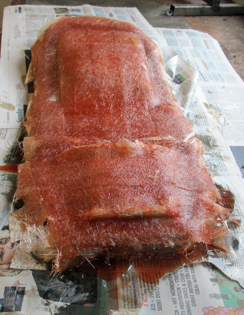

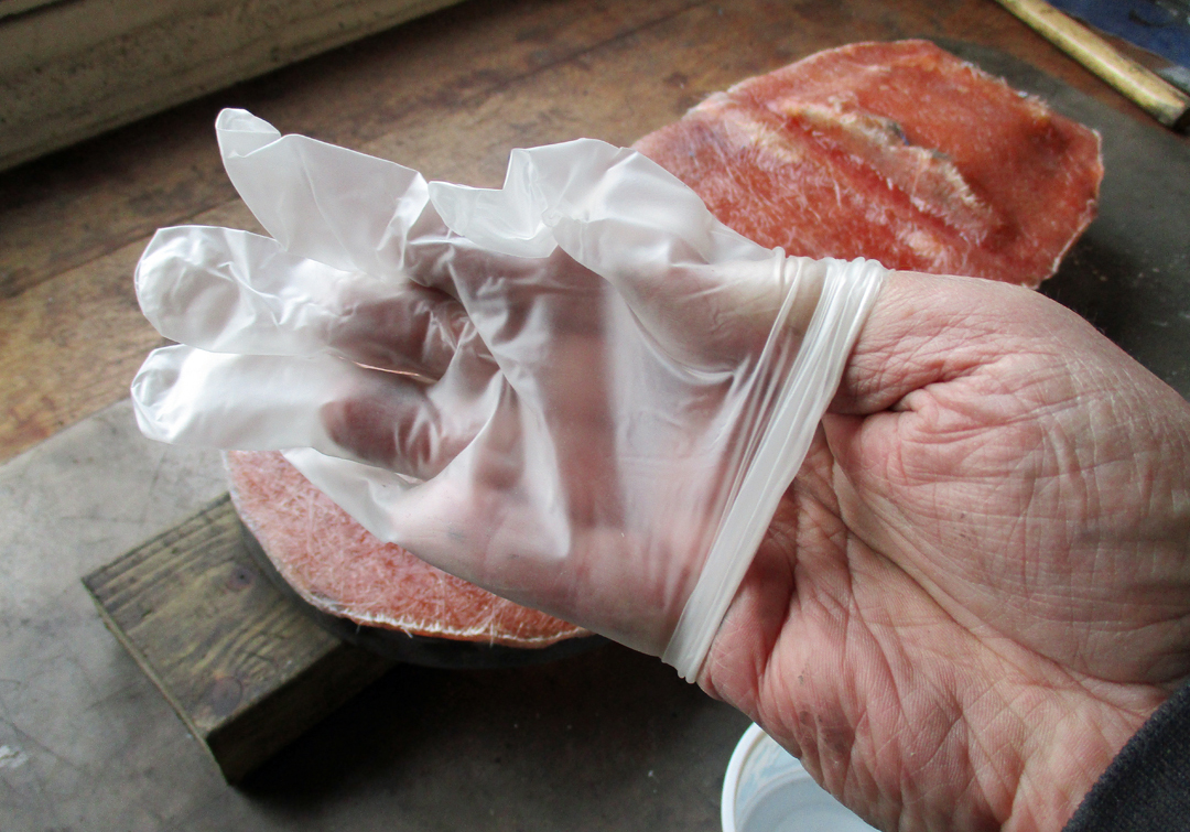

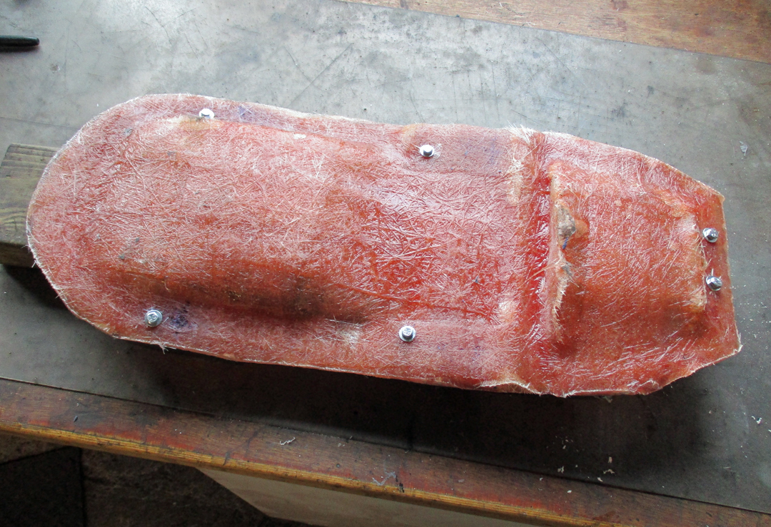

    Drill through frame and seat base for bolts. But as the bolts will be splayed front to back due to the angle of the frame I drilled the holes larger to give some wiggle room to get them out again.
    Then the messy bit again and try to get the blimmin gloves on
    Go over all the bolt heads with a load more glass fibre and strengthen up some of the thinner vertical patches:
    And drink several cups of tea while it hardens.

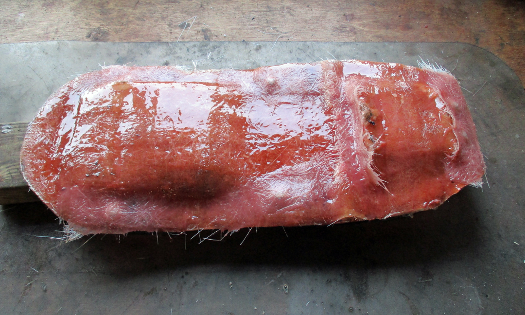

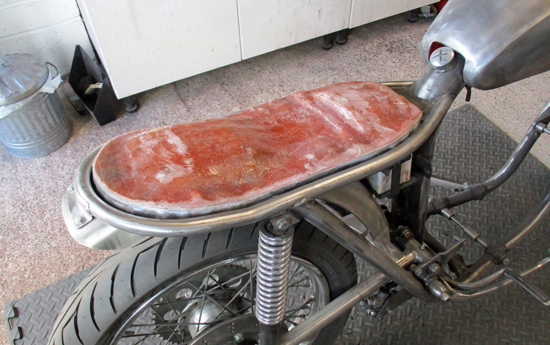

    Lever the thing off again cause, of course, it'd stuck back to the frame again. Trim down the overly long bolts.
    Go around the edge with a flap disc on the grinder. And whack it into place.......aha, quite pleased with that :cool:........Over....

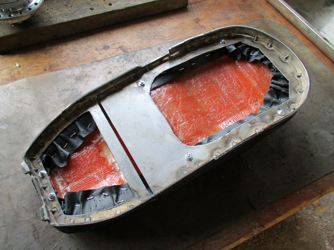

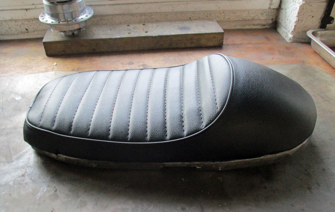

    I really didn't know what I was going to do today to get the seat put together. I've never tried this before and had always relied on buying something from some custom shop as it's waaaaaay out of my comfort zone of doing things up with spanners.
    So, I farted around cutting up bits of foam and trying to make something to resemble a seat. I know that if the seat looks wrong it buggers up the whole look so was getting resigned to finding something for sale. Then, bless her little cotton socks, the Admin Staff arrived, like the cavalry over the hill, with her stapler. Here it is bolted to the made up frame (that I now need to weld up properly)
    Look at what she did - ha :D

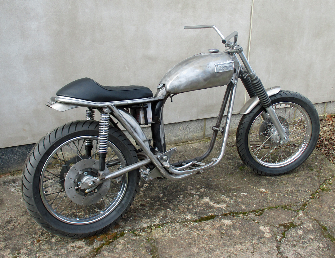

  20. Iron
    Iron Elite Member
    Dec 29, 2021
    2,753
    943
    Bob Ross Studios
    #160 Iron, Jan 28, 2022

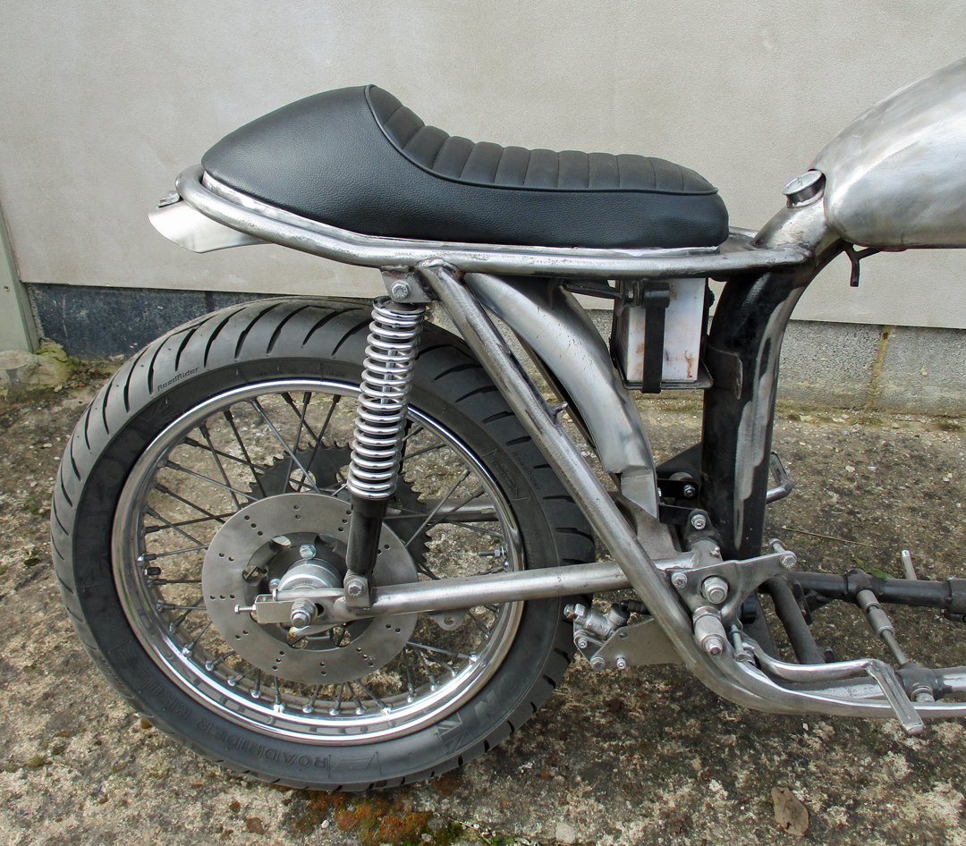

    And here it is on the bike:
    Well chuffed with that for a first try. I might even paint triumph on the back of it :cool:
    So, seat number 4 it is. Good choice all...
