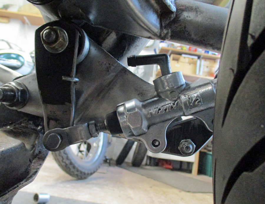

    So, put me thinking cap on and went down ze garage. Here's the existing rear master cylinder in place:
    Doesn't leave a lot of room with the new tyre. And maybe putting a fatter one in later when I learn how to lace rims.
    This is the usual method to fixing these cylinders. (I went to look down the local trials bike shop):

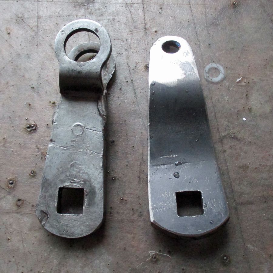

    I could weld brackets on the frame and rear brake lever but as I wanted to reuse the return spring therefore leaving the lever and all in place why not reuse the bracket:
    So I made up a little plate as a spacer and bracket to secure the cylinder onto the existing which would allow the piston to be operated in the original manner. This allowed me to cut off the electrical operating arm on the footbrake lever (much nicer all smoooooooth)
    Then to make up a bracket to replace the existing to operate the piston

    So, only needed two bends and allowed me to use my square drill:
    And put it all back together and it seems to work. Hooray :)

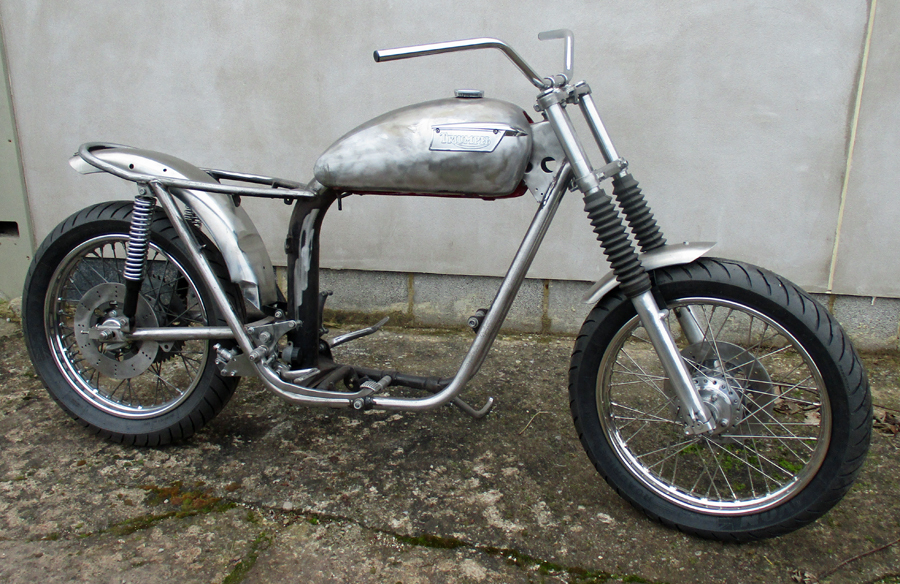

    So, standard mudguards I think just cut down but what seat?
    I'm thinking something like last one with the rear subframe loop cut and bent to suit. Too cold today brrrrr...

    I like the bottom one but if it fits inside the loop leave it like that as the loop/frame would stand out nice.

    I quite like the 3rd but I think it depends on the guard/light cluster

    Hmmmm......still musing on the seat. The Admin Staff isn't keen on the last little one. But I'm liking the exposed loop of the subframe and a little round back light.

    I think we're trending towards 3 or 4. Not anything standard. This is 3
    From the side it looks ok, but from the top and/or back looks very plastic and that arse, hmmm...I could paint it with something
    It doesn't sit well on the frame. Some modifications and thinking caps required.

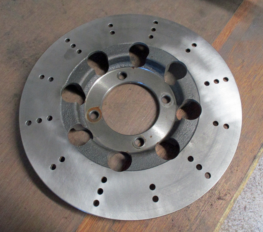

    This side of the disc is luvly, looks never used
    The reverse has obviously had a piston pressing onto it.
    Obviously just one piston in the caliper had been working. Always worth checking the bits are operating correctly when one has a bit of a maintenance check. Such as changing the pads.
