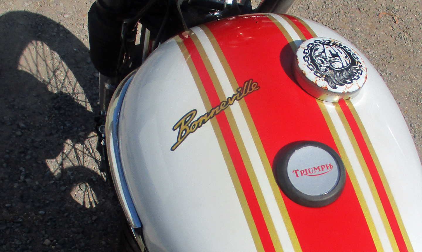

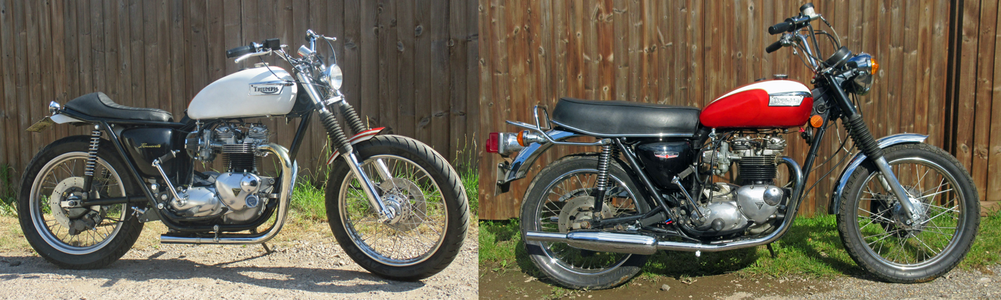

    Had some wet sumping - which took some sorting as the PRV and the oil pump both decided not to work properly (it was a new PRV too) so when I thought I had it figured out the other decided not to work. Still have a bit of stand off with the carbs but......sorted :)
    Here's a before and after (or rather, after and before)
    And a hand painted Zombie petrol cap just to finish it all off - hooray....
    over....thanks.....:cool:
