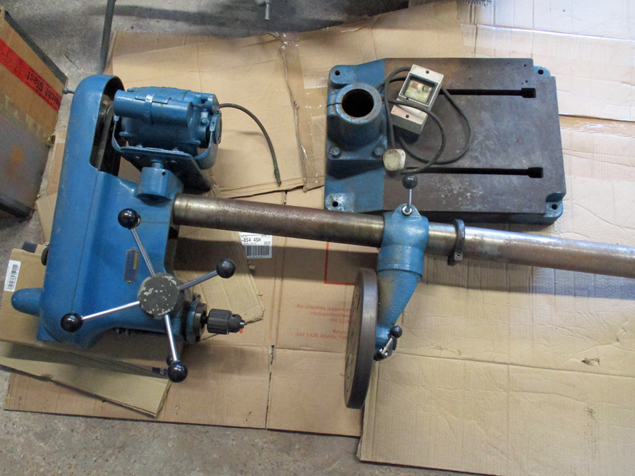

    Yep, leaving it there until I can take some bits off of it. I'd like to just undo the pinch bolt on the shaft and slide the drill section off. No chance, it's rusted on and much too heavy for an old fella like me - I'll get the Admin Staff to lift it. All that training with heavy shopping bags full of groceries will mean she'll just pick it up, one handed, and stick it into the base. :)

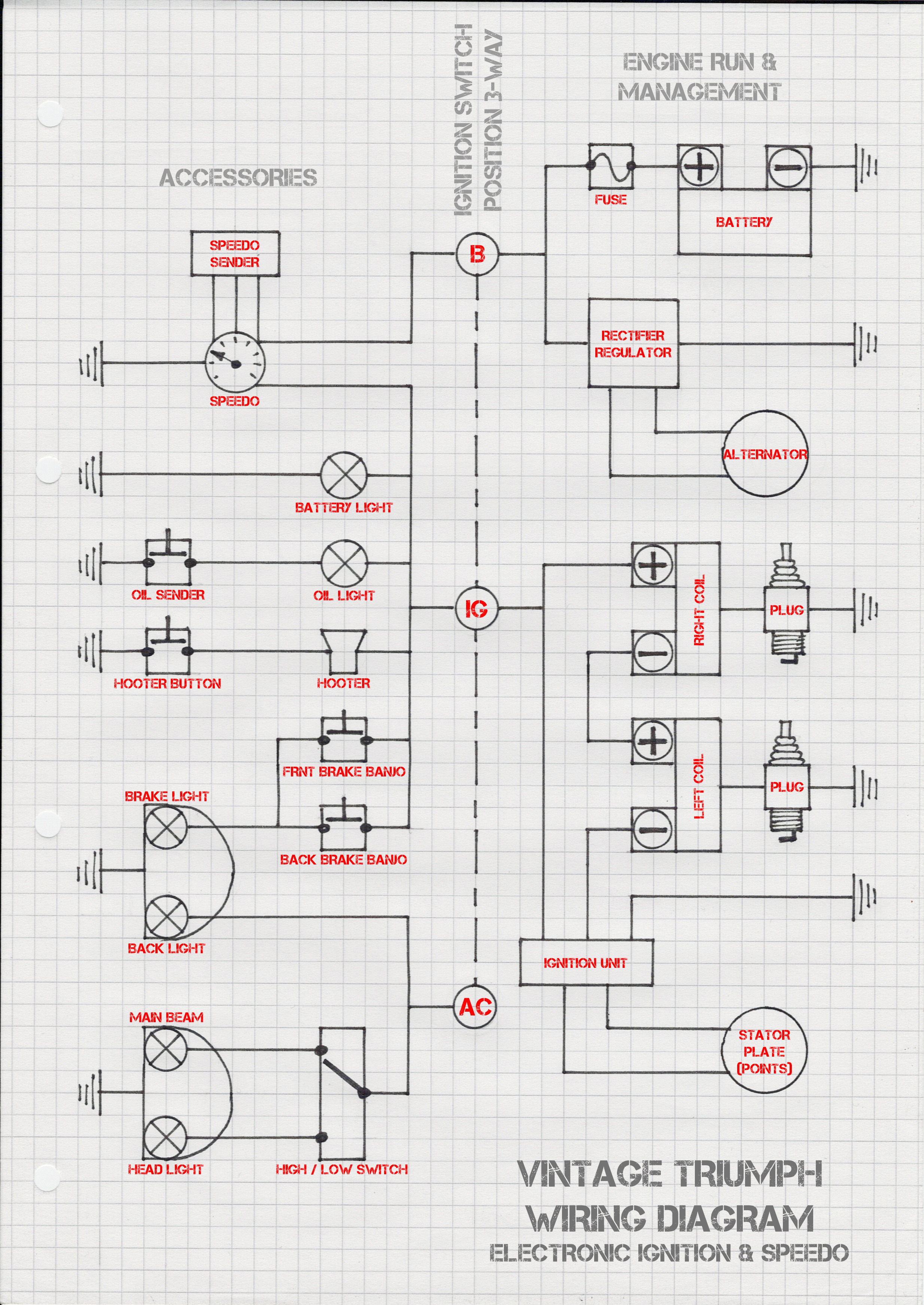

    Here's my wiring diagram that's drawn around the ignition switch positions. (Took me ages to do).
    Down the centre of the diagram are the ignition key positions. So they join electrically as the key is turned.
    There's no electric start, rev counter or indicators but these are easily added if they are wanted.
    The system is Negative Earth.
    The battery warning light changes colour and/or flashes depending on battery condition and charging.
    The electronic ignition is a Wassell Vape Ignition Kit (any ignition is basically the same but I like these).
    It's important to ensure that there's a good earth strap from the negative side of the battery to both the frame and the engine.
    Each component is shown on the diagram to wire back to earth to complete the circuit - this can be achieved by the item bolting to the engine or frame (as spark plugs, oil sender etc) or they can be wired back to the negative side of the battery.
    Obviously my copyright but that's ok, just send me £100 every time you look at it....:grinning:....over...

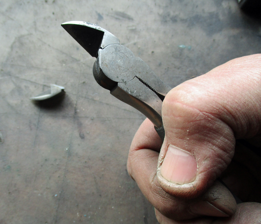

    Not been doing much lately, I think ye olde Hong Kong Fluey may have snucked into my nose and infected my gums as they've been larger than normal.

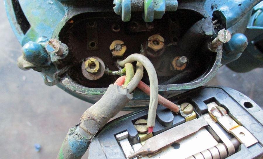

    I've also been figuring this out. And being an obvious electrical genius I spotted the two bare wires almost immediately. (look top right :eyes:)

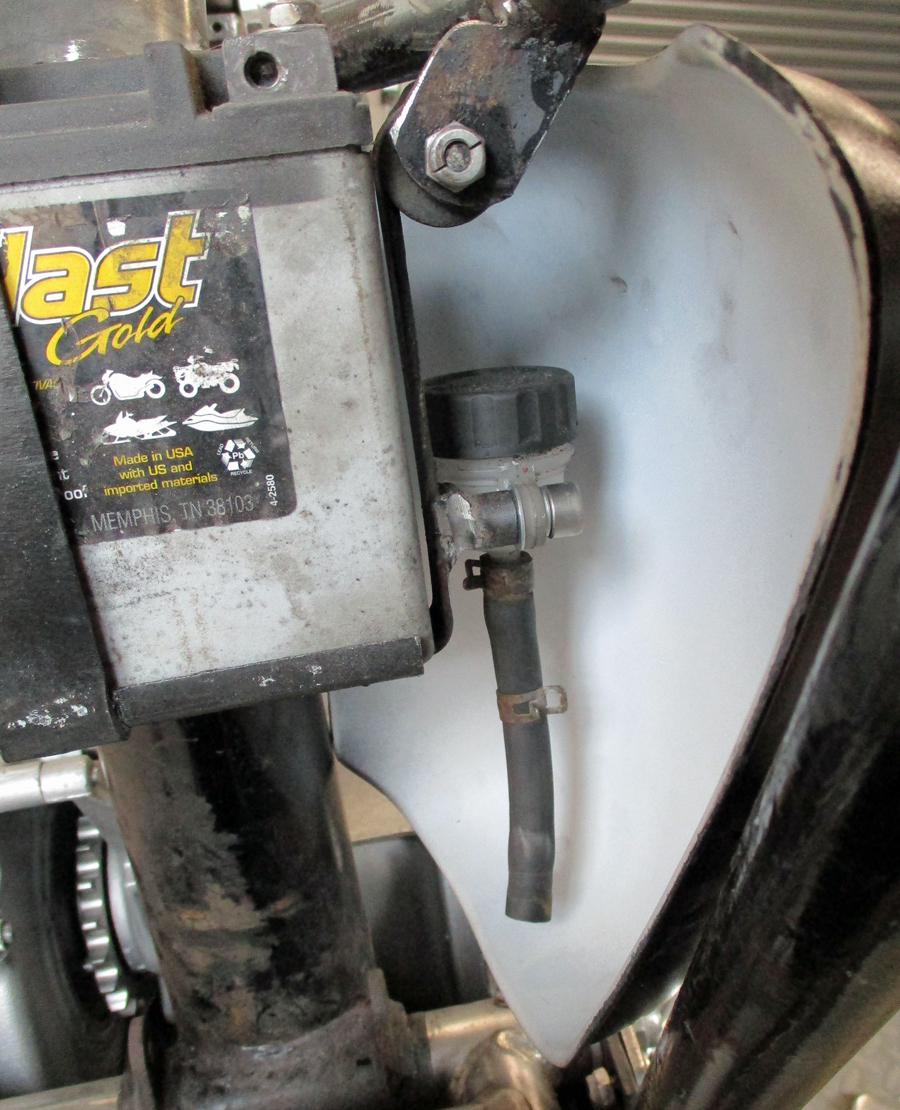

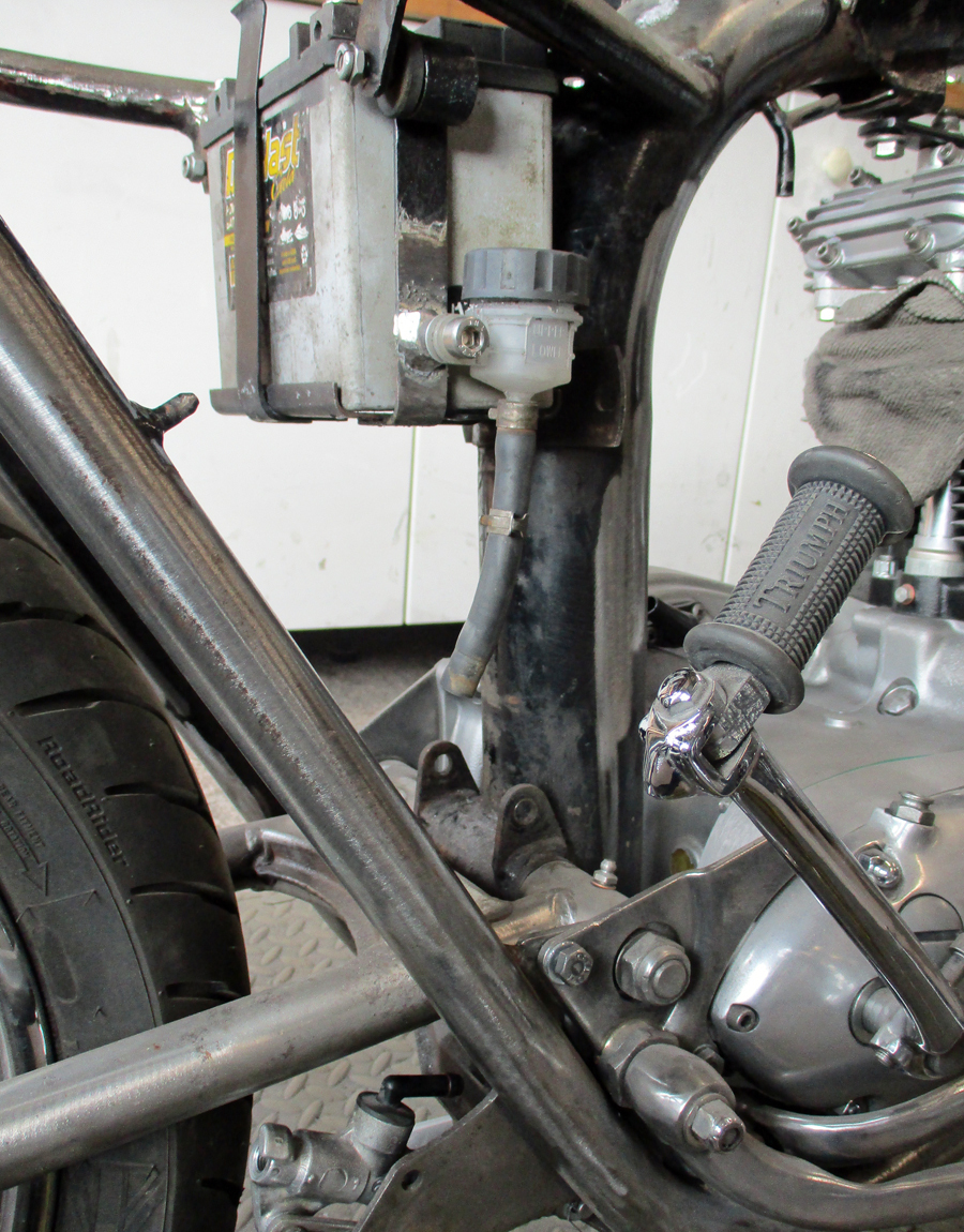

    Started taking his lordship apart for paint etc and found an issue I hadn't sorted. I had to find a spot for the the rear master cylinder reservoir. Welded a threaded top hat onto the battery box, sorted.
    Loads of room inside the side panel
    Just cut a new length hose and......
    Blimey! "What large gums you have...", "all the better for breaking cutters with my dear......" :neutral: Over...

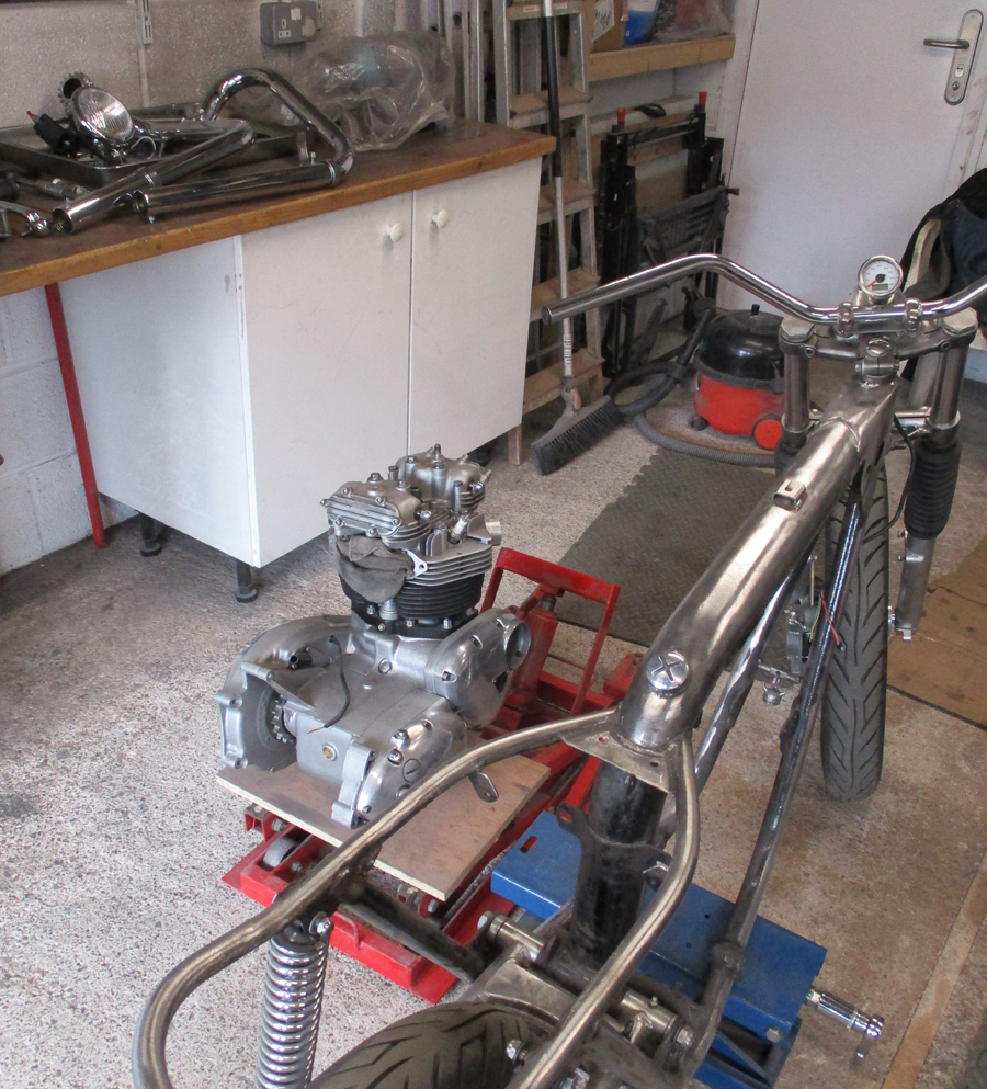

    All coming apart for paint.
    Will sort out finishing off any spot welds done in the build and sanding old stuff off for primer. I must sort a sand blaster if I'm gonna keep on doing this, or maybe just take it to a powder coaters.

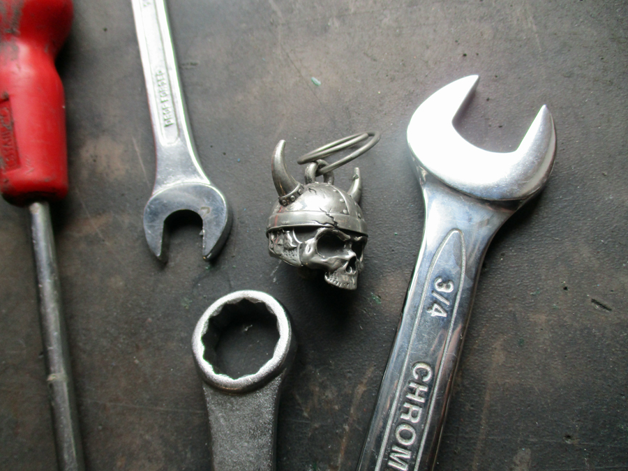

    Remember this little guy

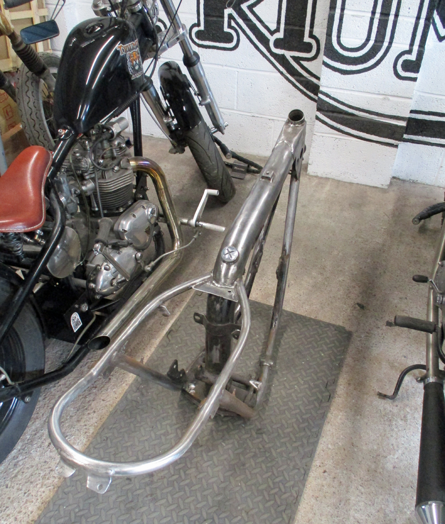

    I'd spot welded a bar across the duplex frame members to hang the spirit bell on. Once the engine was out and the engine bolts removed they had actually moved apart by an eighth of an inch and broke the spot welds. I never knew the frame flexed that much due to bolting up. I thought there may be some but have never measured it.
    The front mount on the engine is 2 inches wide, with the spacers in place on the mounting bolt the gap is 2 and an eighth. Well, there ya go. The viking spirit bell will have to go somewhere else.
    Learning learning......over....

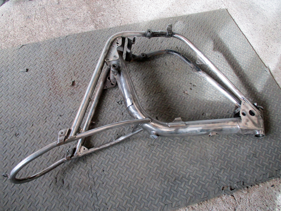

    This is the most shit job ever. I think bad memories are shelved away in my brain in a place called "I've forgotten".
    I've done quite a few frames and somehow I reckon I'll just start in one place and work my way round, it'll be a doddle. And it bloody ISN'T :mad:.

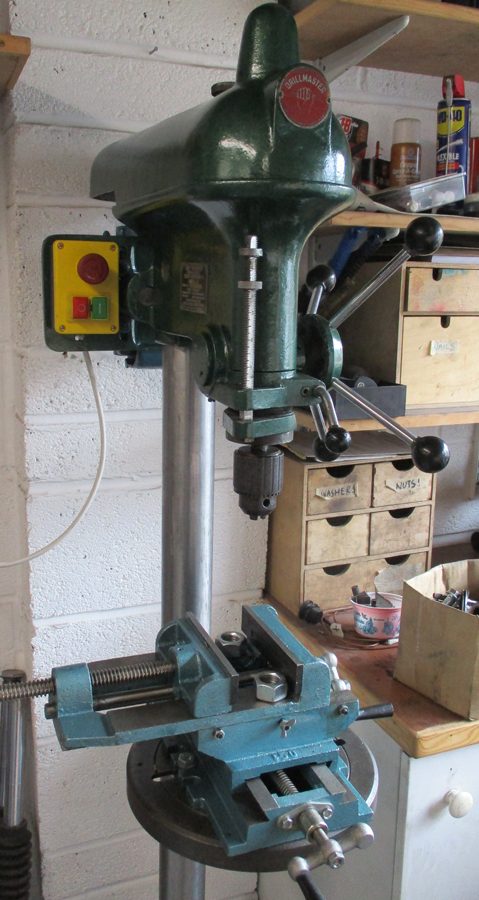

    Luckily, before I wore my fingers away, Postman Pat brought me a nice new on/off and emergency stop switch for the hand-me-down pillar drill. So, any excuse, parked the frame
    And wired up the switch to my absolutely luvly newly painted and operational machine.

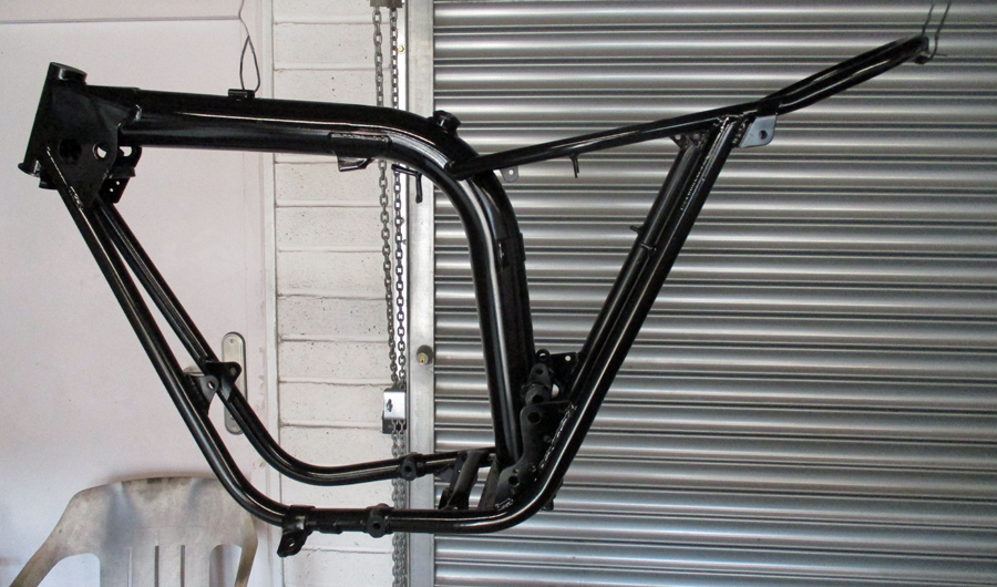

    Back to the sanding etc. and then 2 pack primer and black with a 2 pack lacquer.
    Always a bit of jiggery pokery when there's a few extra bits to do as well

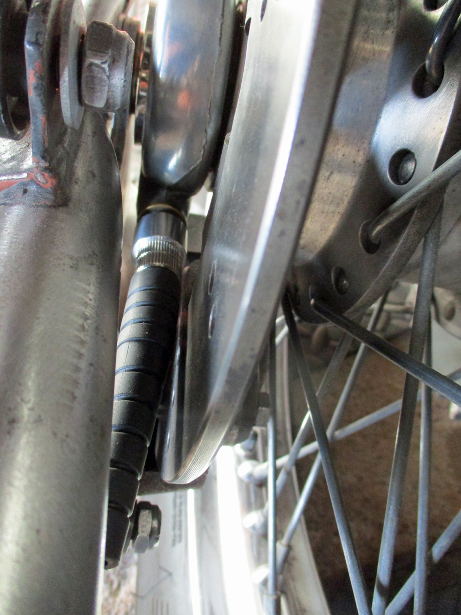

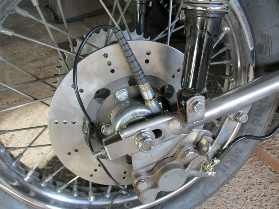

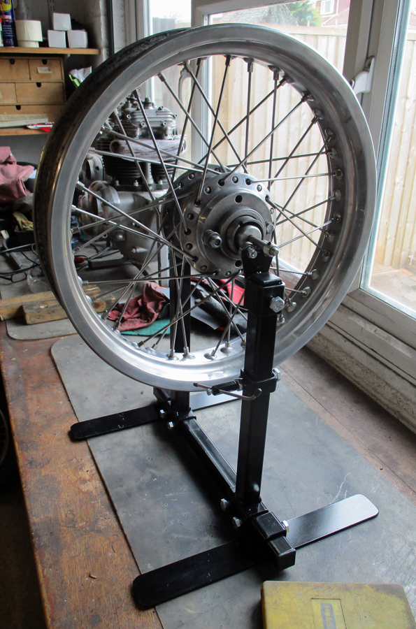

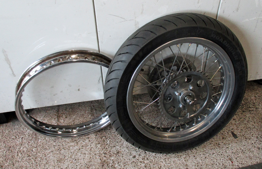

    So, while I was waiting on coats to tack off I had another look at that Akront rim I have.
    The existing wheel was off so I compared the size by laying the rim on top. It looked like it was the same size. The custom builder who gave it to me said it should fit (and he's built a lot more bikes than I have). So, got my wheel building jig whatsit thingamy out and was playing with the new spokes.
    The Admin Staff shows up with a tea. Luvly.
    She has one look at the rim with spokes in it and says "that's wrong, that hole is pointing upwards so that spoke should go in there" and wanders off to look at the washing on the line. (Why do they do that? Can't it just dry on it's own? Why does it need to be fussed with?)
    Fuck me, she was only right! Moved what the Triumph rim was 4th hole spoke into 3rd hole on the rim and it pulled everything tight and into line. FFS!

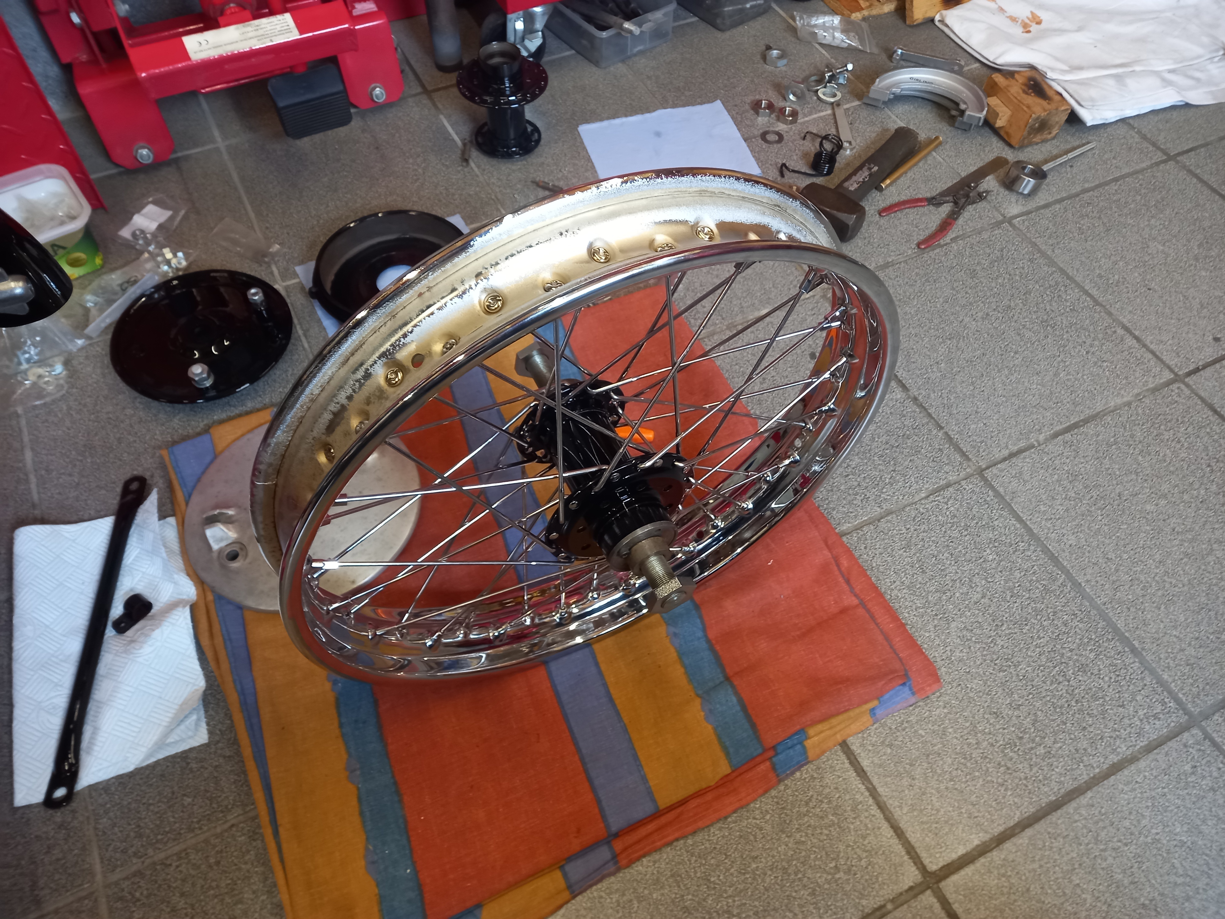

    So, (don't tell her), it all works and fits now. I happily played with my wheel building jiggery thingy and found it is quite easy to sort to get a wheel all laced up. Knowing that the tyre is fatter I would need to pull the wheel off centre even more it was just a case of loosening that side and tightening up the other.
    Putting the tyre on was easy but I broke my foot pump. Couldn't get the tyre to sit right so went to the garage and used their pump. Had to get the pressure right up to 55 pounds before the tyre rim popped on properly - nearly giving me a heart attack.
    A bloody whole nicker to use the air pump these days. And, and, I thought I'll get a gallon of petrol into the can while I'm there. Blimey! A tenner to get a gallon can filled! Jeez, glad I'm not going to work any more.
    So, any old end up. Tyre on and all straight. Jolly good.
    Here it is alongside the old rim. Looks miles better

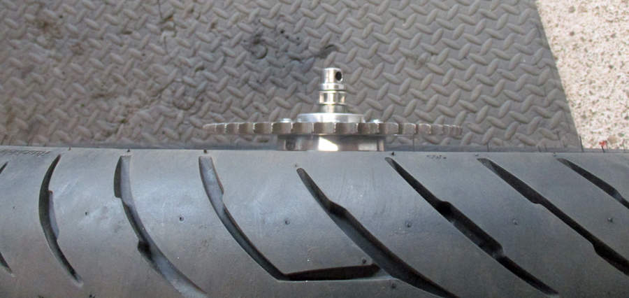

    And after putting in new bearings managing to literally burst my finger hitting it with the hammer. Oh the bloody bum holes poo bear fucker! Well at least there'll be no black man's pinch....
    I think I have enough room for the chain. Looks ok but need to pack up for now while I go find a plaster. :confused:
