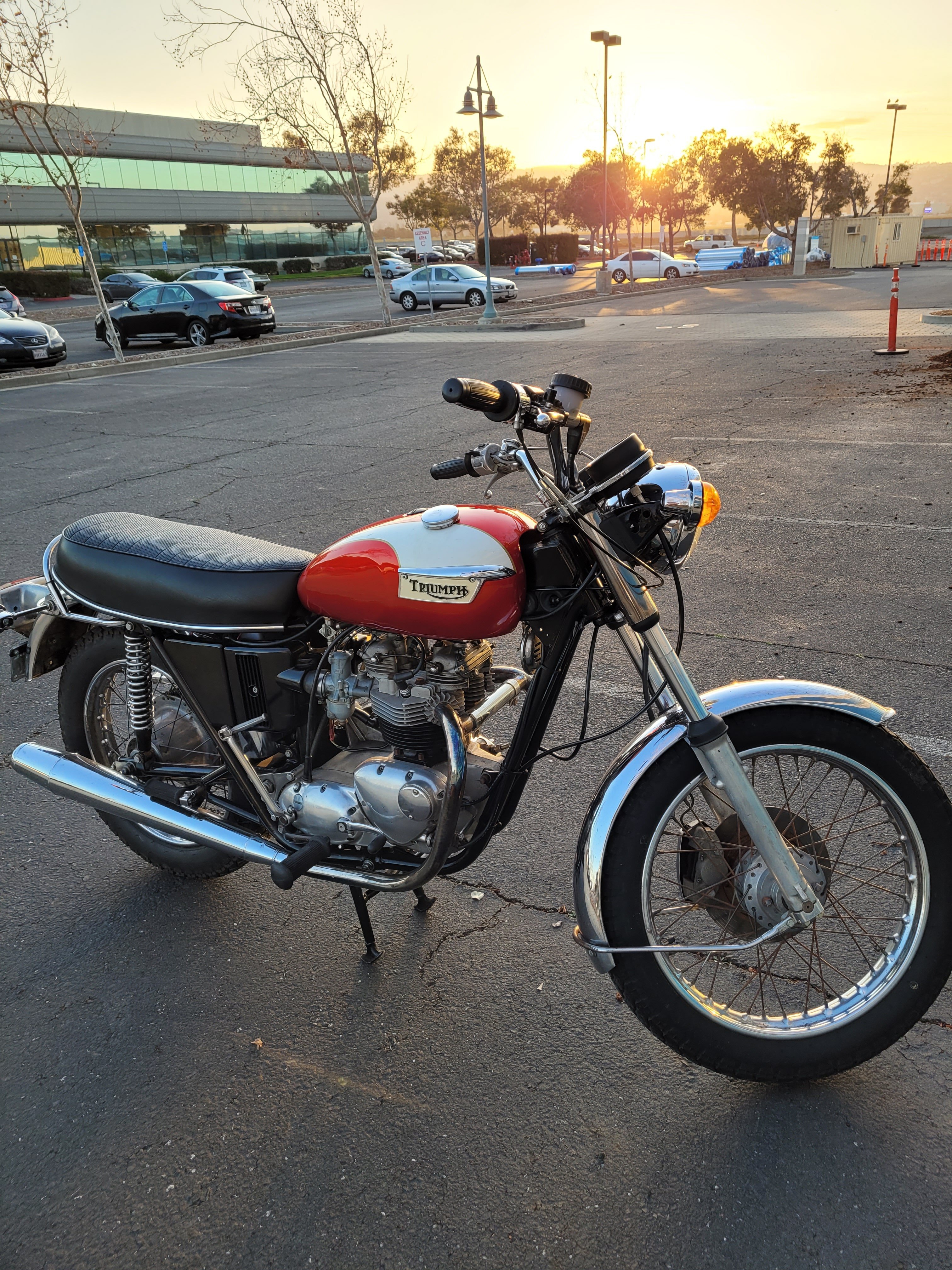

    Hi everyone, I'm new to the forum and I could use some advice. I bought my 1973 Bonneville T140 a few months ago. The engine was completely rebuilt and installed this year and it rode like a dream for a couple of weeks but its recently been having problems. It used to startup cold with no issues but recently the engine started cutting out while I was riding. It's now at the point where the bike won't spark or turn over at all when I try to start it. I trickled charged the battery until it was full but that did not help. I then replaced the battery completely but that didn't do anything either. A friend of mine thinks I could have flooded the spark plugs while trying to start it up. I am mostly a novice when it comes to troubleshooting and any advice would be greatly appreciated. Thanks!

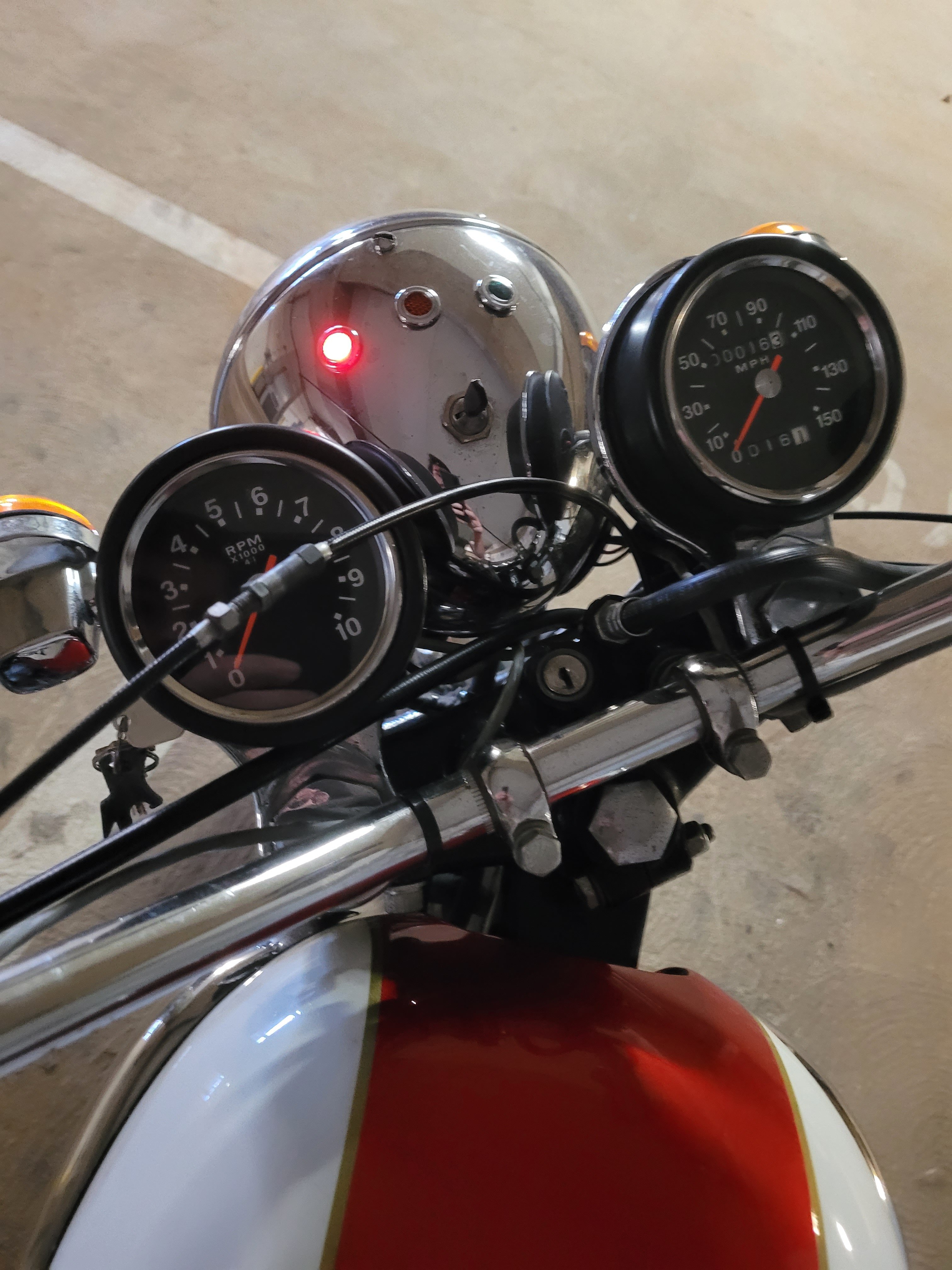

    but if you dont have a spark but do have the idiot light on the headlamp shell then your ignition switch and fuse appear to be working.

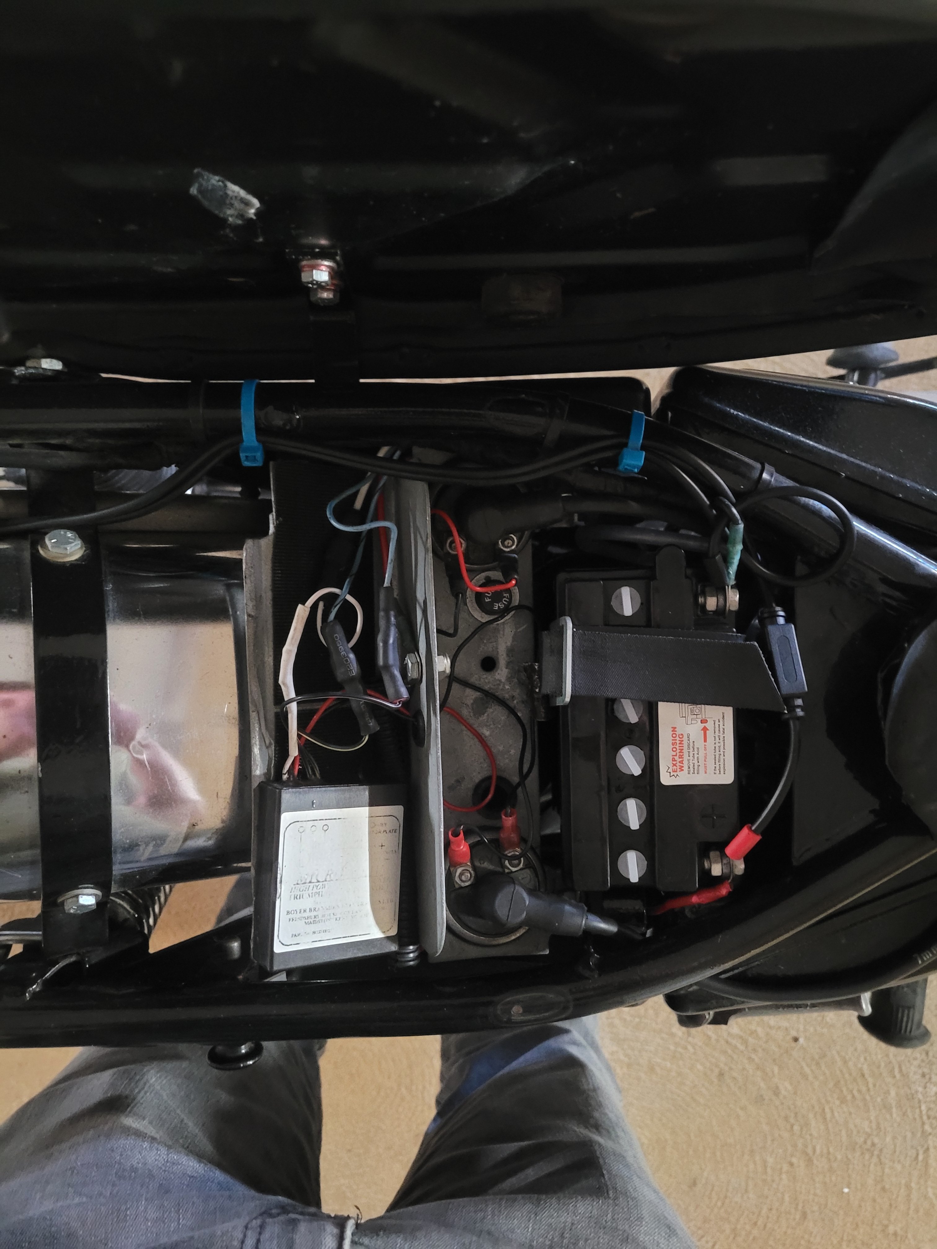

    I can see a Boyer ignition box so assume it has EI fitted :)

    anyway the boyer makes it easier to check. power goes into the boyer transistor box through the white wire. unplug that wire from the harness and run a jumper from battery negative to the white wire. everything upstream from the boyer box will be disconnected, so if you still dont have spark it will be tje boyer box, the coils, the secondary plug wires, or the spark plugs.
    check the boyers connection- black, white, and red wires. check tje two wires leading to the stator in the old points cavity.
    i once had a boyer stator melt its epoxy in the points cavity and stop working. take a look.
    if you still dont get a spark after hotwiring the boyer box, do the scratch test. leave the boyer box hot wired and unplug the black white and black yellow wires from tbe stator in the points box, or finds their ends somehow. scratch the bare ends together. if tbe plugs suddenly spark the box is good and tbe problem is the stator or downstream wires connections, plug wires or plugs.
    if there is no spark, be double sure by briefly unplugging power to the boyer box and plugit back in. within thirty seconds do the sctratch test again. if it still wont spark the problem is probsbly in the boyer box. you have to double check this way because a boyer box will turn itself off if it gets power but the engine isnt kicked within 30 seconds. they did this to keep the coils from overheating if you forget to turn the key off. its why you often must kick s boyer bike twice to start it if youve left the key on at tbe petrol station. unless you have gods own foot and kick hard enough to make the motor go round teice

    i forgot. are those the original 12volt ignition coils? because boyers work best with nominal 4 or 6-volt coils.
    boyer recommends coils having a total resistance of 3 to 4.5 ohms. two twelve volt coils can run up to 8 ohms wired in series like the boyer requires, but others can be found with lower resistance.
    i have a machine running two dynatek coils and a boyer. each coil runs 2.2 ohms, so th ecombined resistance is 4.4. within their recommendations.
    you running your boyer with the original coils might be part of the problem. if it is, you could solve the problem bu buying a single dual-outlet coil with an internal; resistance of 3 to 4.5 ohms, or two sngle outlet coils of around 1.5-plus each.
    you need at least 3.5 ohms combined or the transistor box will overheat.
    your motorcycle looks like its in very good condition, btw
