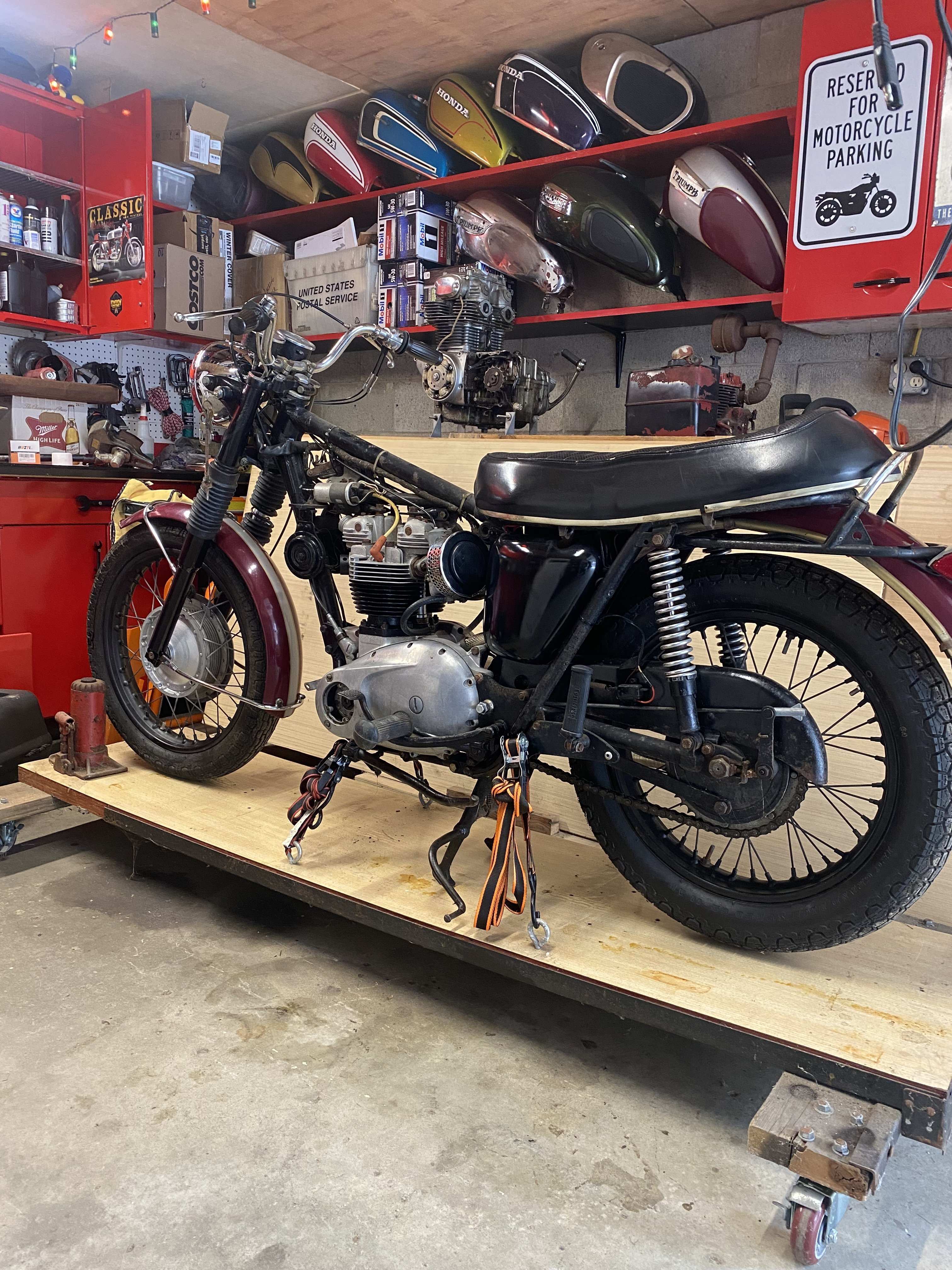

    well, still looks pretty stock. you have thr original rectifier setup to change AC to DC and the original finned egg under the headlamp to cool the zener diode for 12 volt regulation. if they work okay, youre good for the moment.
    its all original, as near as i can see
    time to read this
    http://www.triples.co.uk/articles/articles/sleepbeast.htm
    youll need a battery. get a sealed one, like an AGM. i use shorai lithium an motoblatts, they are very good but you need spark more than pricey aesthetics. any sealed battery that you will get is okay. get a sealed one.
    YOUR BIKE IS POSITIVE GROUND.
    NEVER FORGET THIS.
    do you have a shop manual and parts book? if not go to classic british spares:
    https://www.classicbritishspares.com/
    kyle there is your friend and will post pictures of his beautiful girlfriend for you.
    what you have is dormant, not dead. remember that you need old SG, SH oil, not modrrn SN stuff, else your clutch will slip. there are alternatived.
    lots of things to know but your machine is so complete many of them will not be an issue.
    your tires look new. how did that happen?
    dont worry about your old and leaking shocks. you will want new ones, but get it running first

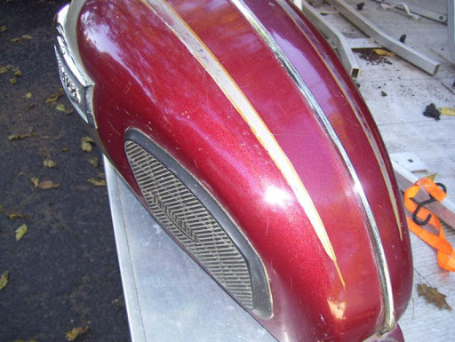

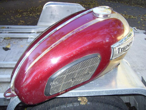

    is that the original paint?
    i dont believe this.

    @speedrattle that’s a better pic of the right side where the pinstripe and emblem paint have seen too much gas leaking from the cap over the years. 11DA42F4-4FE0-4193-832A-00A9448F51CC.jpeg

    Original tank for 70 as it left the factory :)
  9. Russell Stroup
    Russell Stroup Noble Member
    Nov 10, 2020
    624
    Pittsburgh Pa
    Thanks @darkman i thought maybe it was just a US spec tank. I don’t see anything online with that pattern. The silver should go towards the front of the tank from the top of the emblem. Plus the pinstripes don’t look hand painted like yours. Oh well, I still like the look. Just leaves a full restoration on the table if I ever wanted to do that at some point in the future. Plan for now is still, get it running and ride it as is.

    im reassured
    it woufd have been too much for me to take if the paint had been original too
