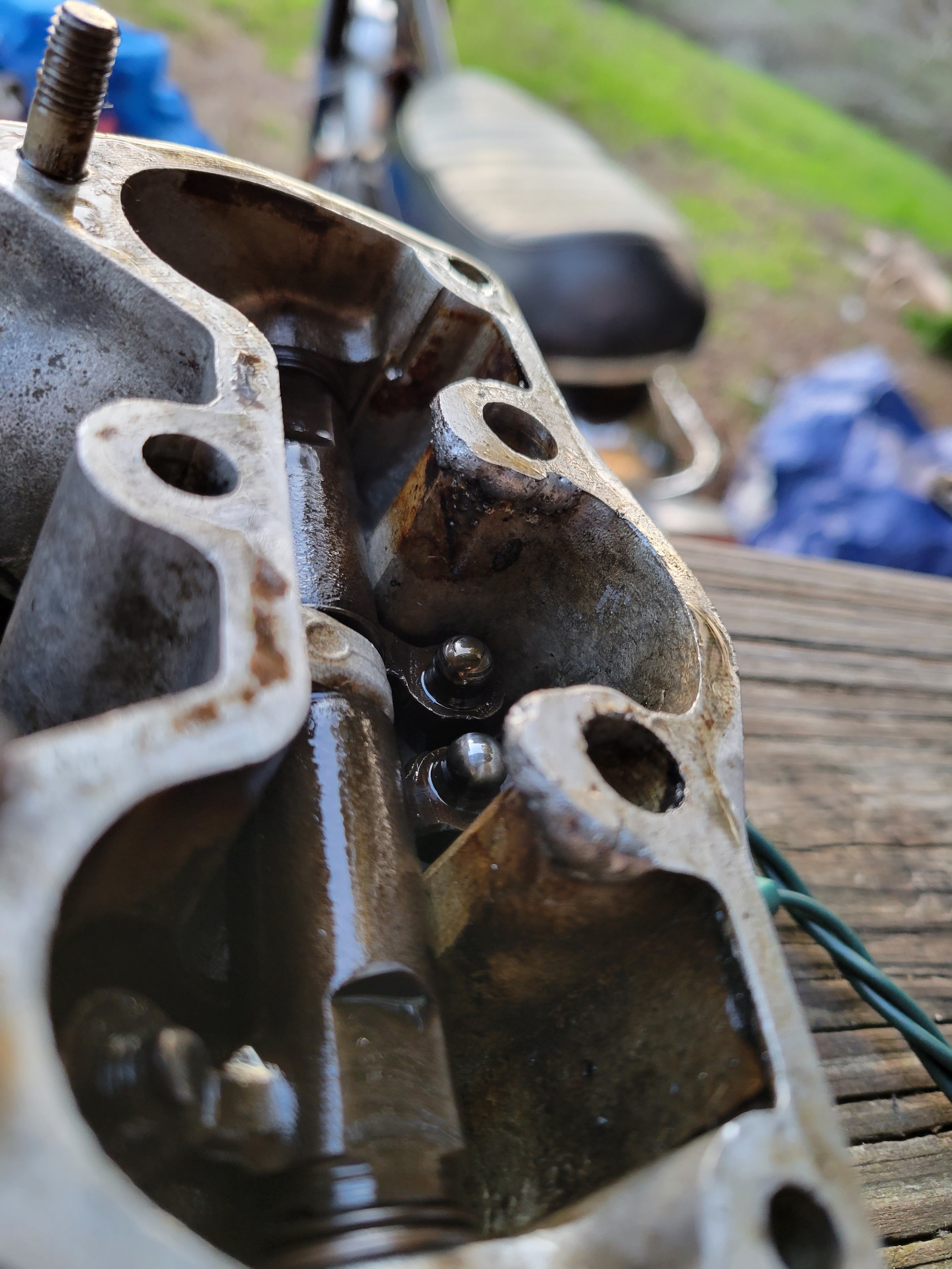

    But that got me to thinking, if oil is coming through the outside of the head, it must also be making its way into the combustion chamber and diluting the fuel mixture. And if thats whats happening, must be alot of oil coming in. But from where? Valves guides appear to be good, no oil on back of valves and I wouldnt think they could possibly leak THAT much oil even if they were.
    So given the new piston rings, Im wondering if my rocker cover gaskets are leaking and letting oil pass through the head bolts and down. Would that be a possibility given that no oil goes through the block on this motor?
    Or should I be looking at the piston rings again? With this recent rebuild, first kick psi is around 90psi maxing out at about 105psi. I havent performed a wet compression test yet, but thats a pretty high initial pressure I think if the rings werent sealing it would be alot lower.

    Comes down the head bolts from the rocker boxes...it's really annoying and hard to stop once you get it. I've used dowty washers, some have tried o rings but new rocker and head gaskets are always required. Anneal new copper ones and that sticky copper spray stuff - I've never had any luck with copper gaskets - lots swear by them.
    Looks like new barrels required which will solve any piston slap or rings sizing issues.
    Is that damage the same side as the damage to the head?

    Im not sure, that picture was taken with the barrels off no idea what orientation it is but next tear down I will inspect closer and find out.

    Your bore measurements do indicate correct sizing - standard is 69mm. (2.717 inches). Piston to bore should be around 4 to 6 thou if I remember correctly.
    Crack may have been due to overtightening of cylinder head due to gasket continued leak. It's important to maintain spec torques on these machines rather than just to keep tightening up due to an oil leak. Could have also been caused by the same damage seen in the cylinder head.
    Detonation of top of piston? Dropped valve?
    Oil will travel down the bolt's thread if it first gets past the gasket. 650 and 750 vintage Triumphs suffer from heads being comprssed locally around the bolt holes in the cylinder heads. Again caused by overtightening of the headbolts, which then do not seal on the washers and allow oil to drain down the threads. I've had this a couple of times, especially with copper gaskets.
    I've tried dowty washers and o rings but always come back to standard non copper gaskets.

    Yea, not sure what happened to the head either. My guess is that whatever happened to the head and piston, also damaged the cylinder wall (and may have caused that crack) and could have possibly been the reason that the cylinders were bored out.
    I never torqued the head bolts down, I just tightened them snug in the order listed in the workshop manual going across from the inside out. Usual head install. I do have a torque wrench, I guess Ill dig it out for the next and final rebuild Ill be doing.
    Im also going to check the head for warpage again, and Ill check the block. I never checked the barrels for warpage I dont think, so Ill take a look there.
    Installing custom gaskets on the rockers didnt appear to do anything. Dont know if it stopped oil leaking but bike still didnt start. So I ordered new non copper rocker gaskets, and will also check the rockers for any kind of warpage.
    It seems to me, after spending countless hours on this bike that the alloys used are really cheap and easy to damage. I mean, I got my wrench stuck and upon removing it I barely pressed it against the cylinder head and a piece of the cooling fin broke off. Tiny peice. But isnt the head aluminum? Appears to be more like white metal as easy as it chipped off. Im no metal expert, but this thing seems a little too fragile to be reliable long term.
    Also not familiar with old british manufacturing, but is this a typical cast job or has it been modified? Both rocker covers are like this.

    Both rocker covers have been welded as the cylinder head bolts have broken the rocker cover bolt holes. Again damage from either the engine problem in the past or severe overtightening to stop pushrod tube and/or headgasket leaks.
    O rings under and on the pushrod tubes need to be correct thickness, if the wrong ones are used then they can cause warping of the cylinder head. When placing the cylinder head before tightening of bolts the gap should be measured. I can't remember the 'squish' gap required but think it's about 30 thou.
    The bike should start, even with the damage that's been seen, so there's additional problems somewhere. One of the previous owners knew a lot more about this engine than was let on. Not an engine to trust....good one to get your teeth into though. I'd have it in a flash.
    I always end up completely rebuilding - even engines that are supposedly ok - I've never found one yet that was ok enough just to use.
    Remember, they are 50 years old and have been owned by ruffians with only a hammer and a pair of pliers to keep them going.
