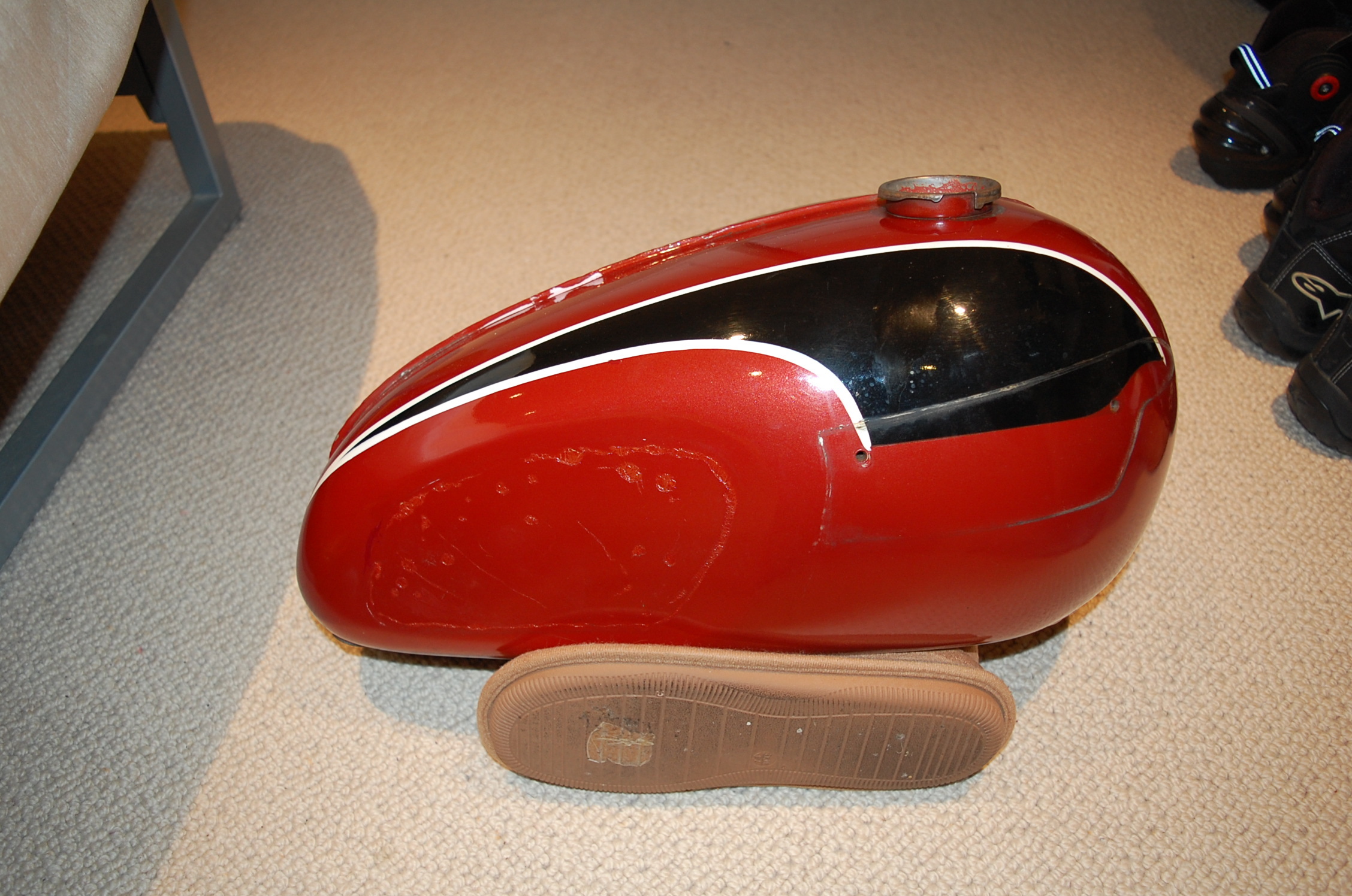

    What’s it now and what will it be?

    Its 1971 Olympic flame, the standard colour but original and tatty, i will be doing it in the same colour :) pix of old tank before painting.
