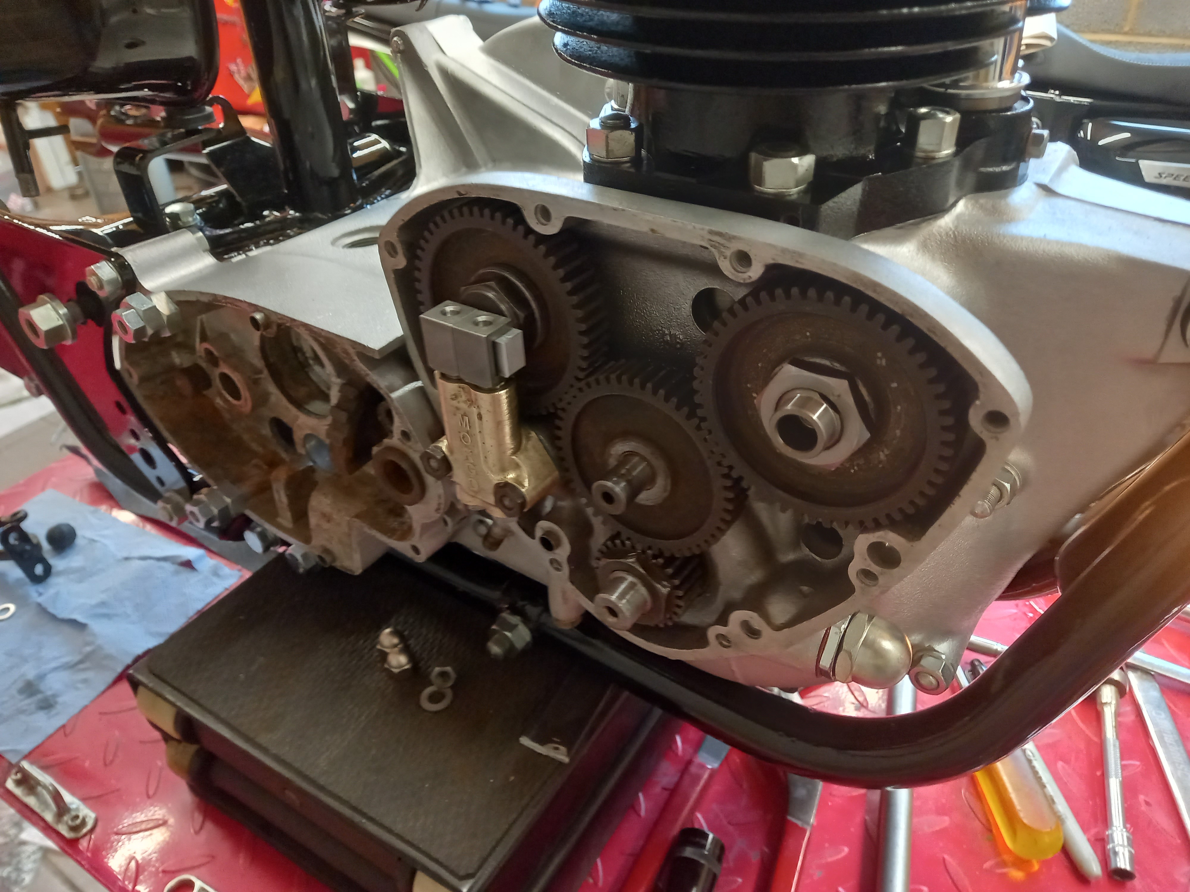

    A little bit more fitting.

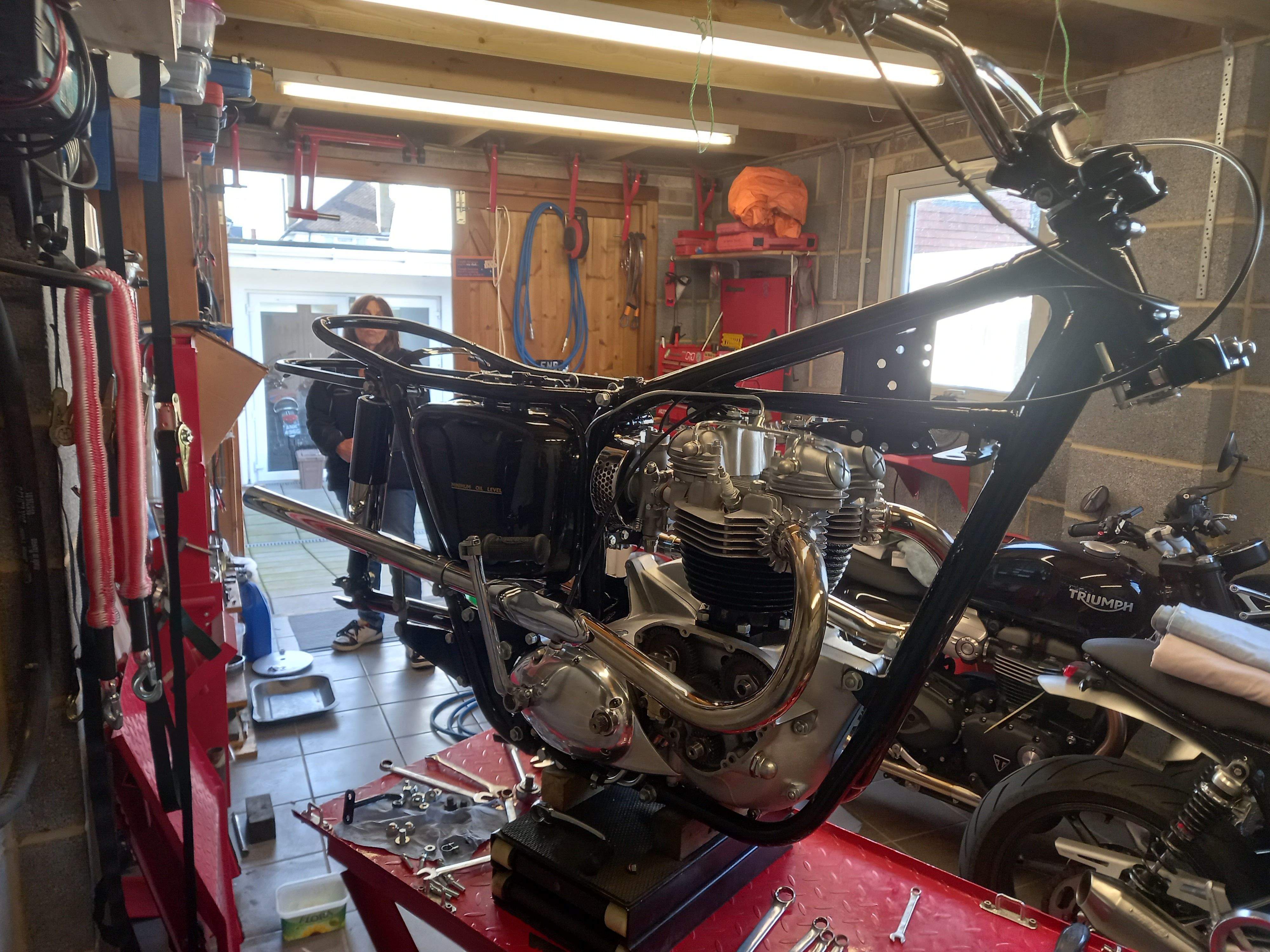

  2. darkman

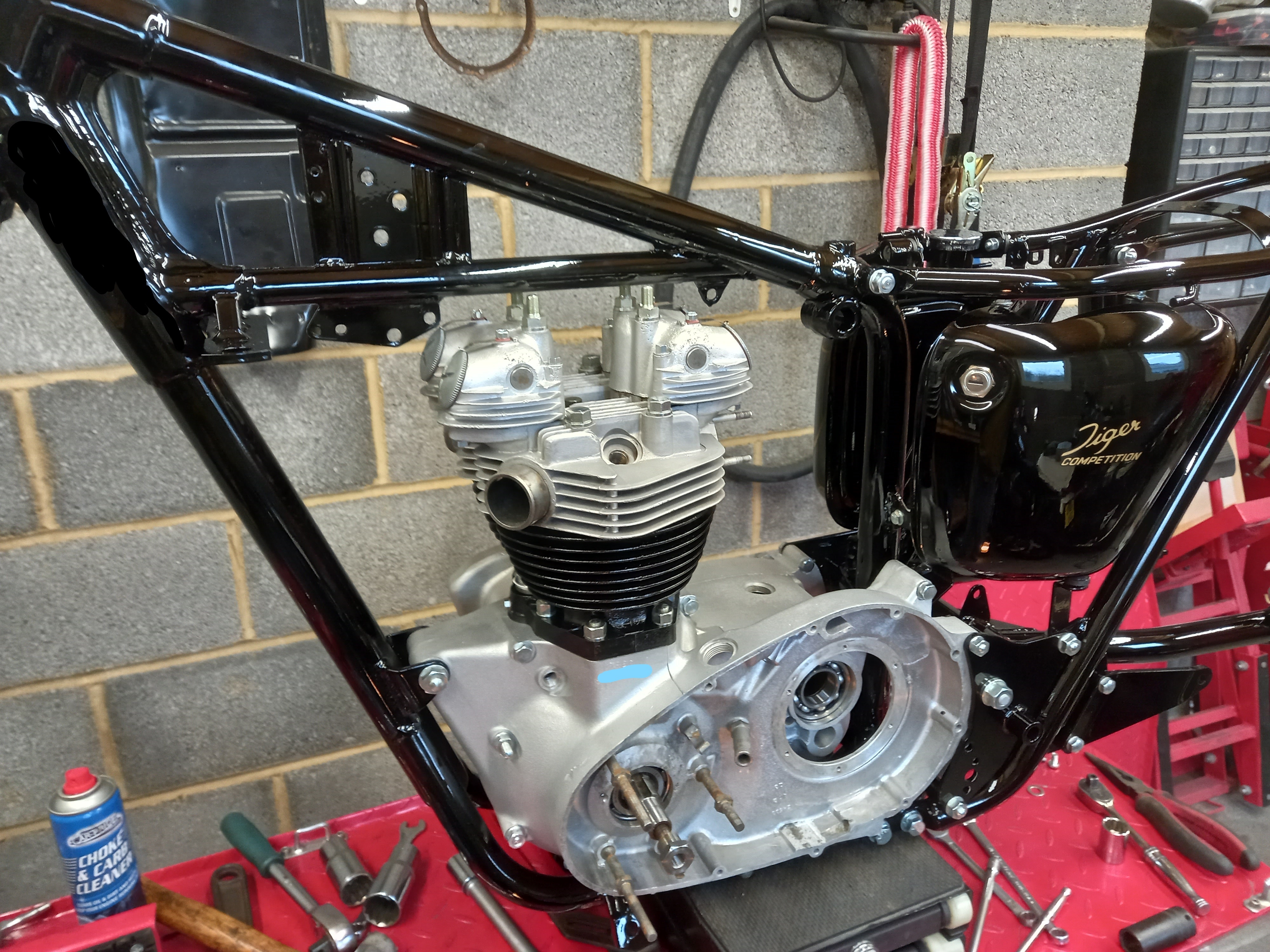

    7,641
    A little more done, timed and fitted cam gears and new Morgo oil pump, fitted new pistons and barrels after gapping rings. fitted refurbed cylinder head and rocker boxes.
    • Like Like x 15

    Bob Ross Studios
    All looking rather splendid (and shiny) :cool:
  4. darkman
    7,641
    Never going to be a show bike, as long as they are as close to what came out the factory and we can ride them then that's the target mate :)

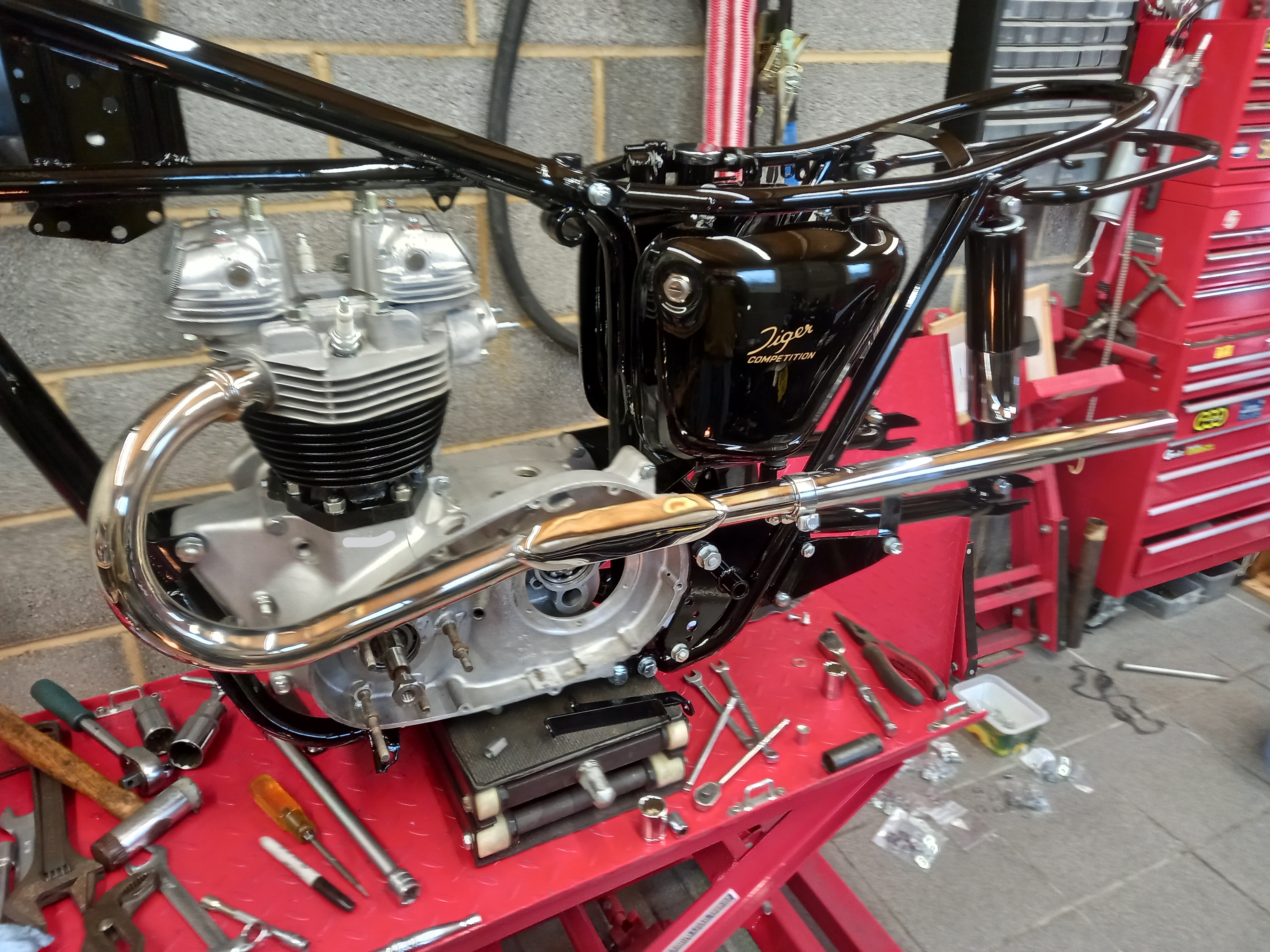

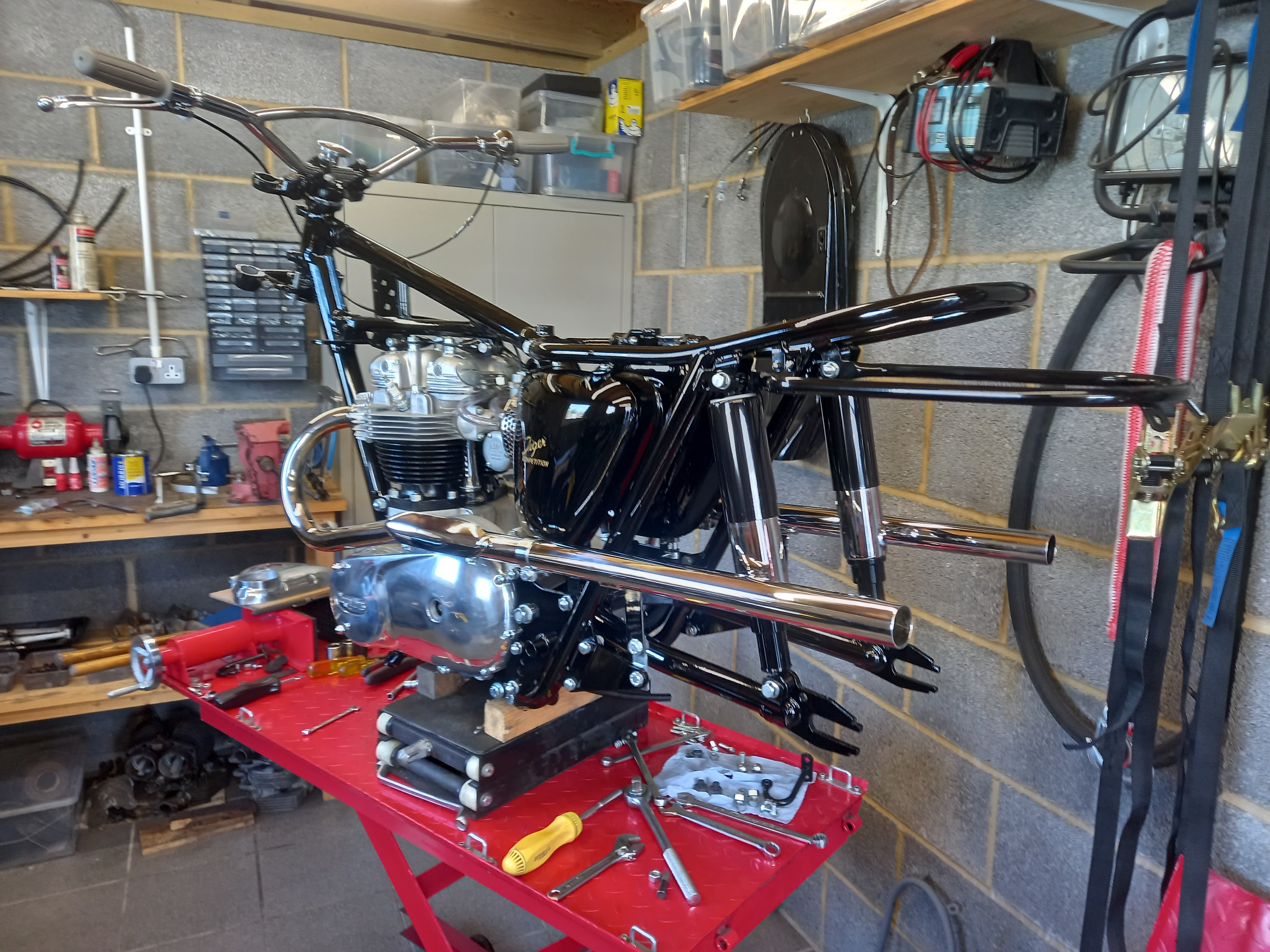

  11. darkman
    7,641
    I managed a few hours work this week, fitted the rebuilt gearbox parts, timed the cams and set up the TDC and 38° BTDC marks ready for the Boyer ignition, fitted the clutch alternator and new primary chain, polished outer covers and fitted the primary and outer gearbox covers, fitted both exhausts after making some extended brackets for the tail pipes as they are more upswept than the standard parts.
    • Like Like x 12
  12. Erling
    Erling Elite Member
    Dec 12, 2017
    1,120
    943
    Norway
    Your restorations are awesome, darkman, thanks for taking the time with the camera and sharing. Lucky Su, and I'm sure she's happy it's not a Tiger, judging from this ad.
  13. painless
    painless Well-Known Member
    Dec 16, 2021
    150
    83
    Powell River BC
    darkman, looking good. Are you putting baffles in the exhaust? I put some in my 59 Spitfire, it does take that sharp bark away.
  14. darkman
    7,641
    Su wants them open like i have on the TT :) Our last fling at youth before its to late :joy:

    Bloody nice that Eric. :cool:
    How come I can't get my covers as nicely polished as those, there's always those ally blemishes - do you keep going with the elbow grease till they go?
  16. darkman
    7,641
    There is a lot of confusion over Tiger and Trophy as to was it 68 or 69 and was it low pipes or high lol, i'm not building this bike as factory correct and you can only get a tiger competition decal as in 68 and as its a 67C but styled as an 66 SC i used a bit of artistic licence :) as for the cases i have a high speed buffer :) They soon dull down a bit for that more natural sheen though :)

  19. speedrattle
    speedrattle Senior Member
    Feb 19, 2021
    1,171
    appalachia usa
    hey
    i know nothing about stock cams. what are you using in this and what are you timing it at?
  20. darkman
    7,641
    I use the Harris half race 9989 exh and 3134 inlet cams with the standard woodruff key factory setting, i don't ever bother dialling them in to check duration or lift as they work fine in a standard engine.
