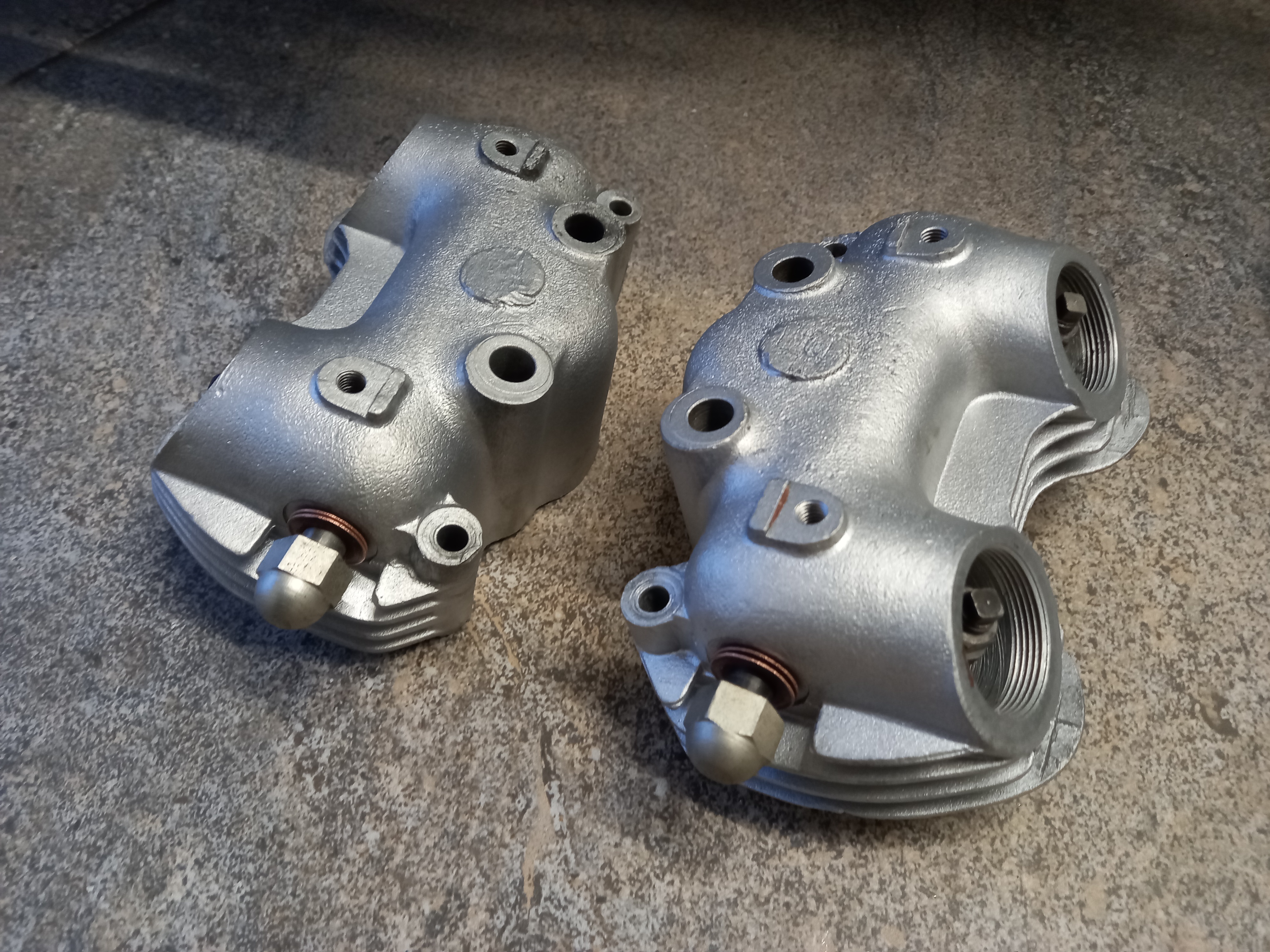

    At last the cyl head has been blasted and valves lapped in and reassembled, just waiting on the crank now so the engine parts can all be put back together.
    • Like Like x 11
