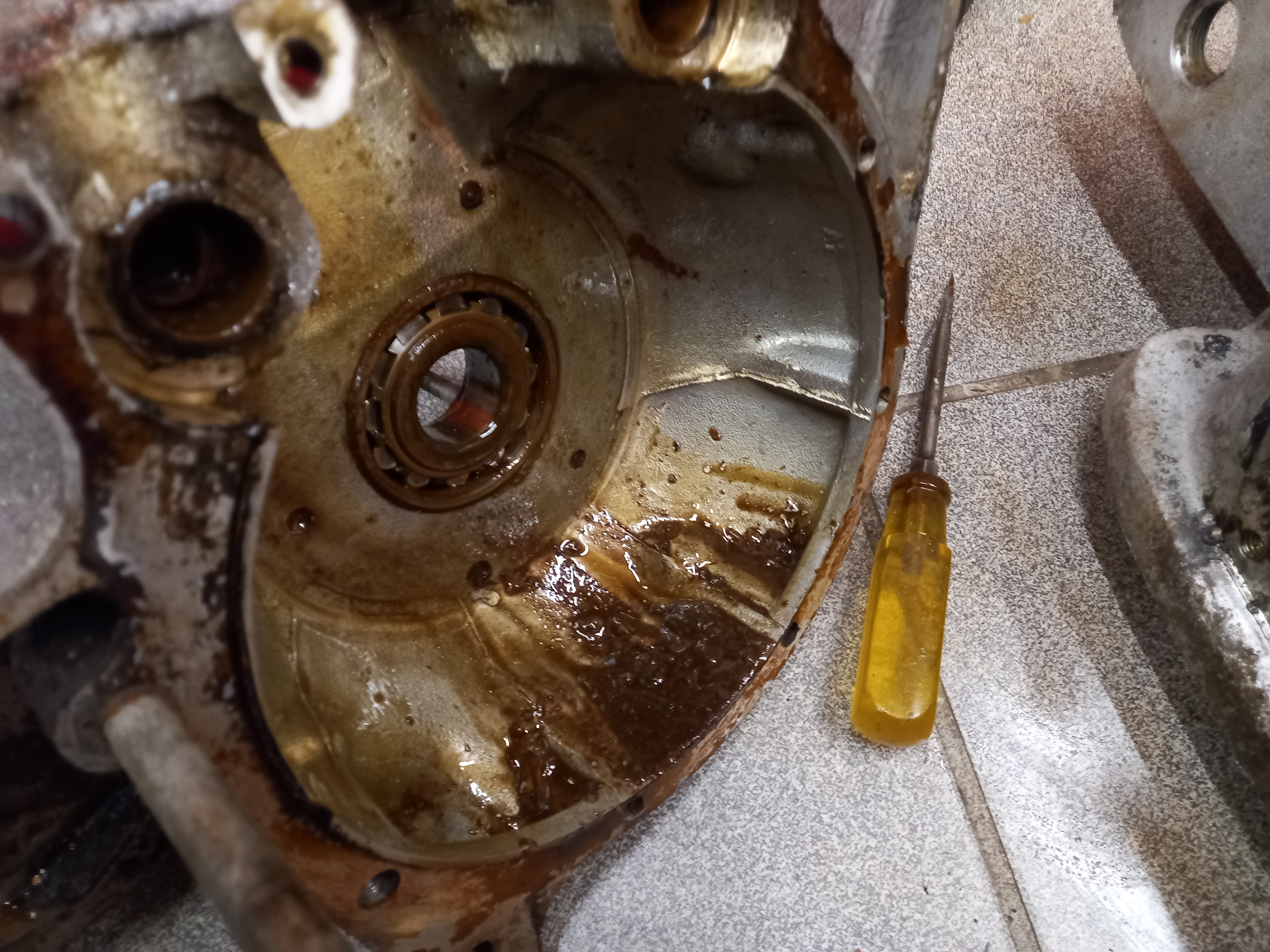

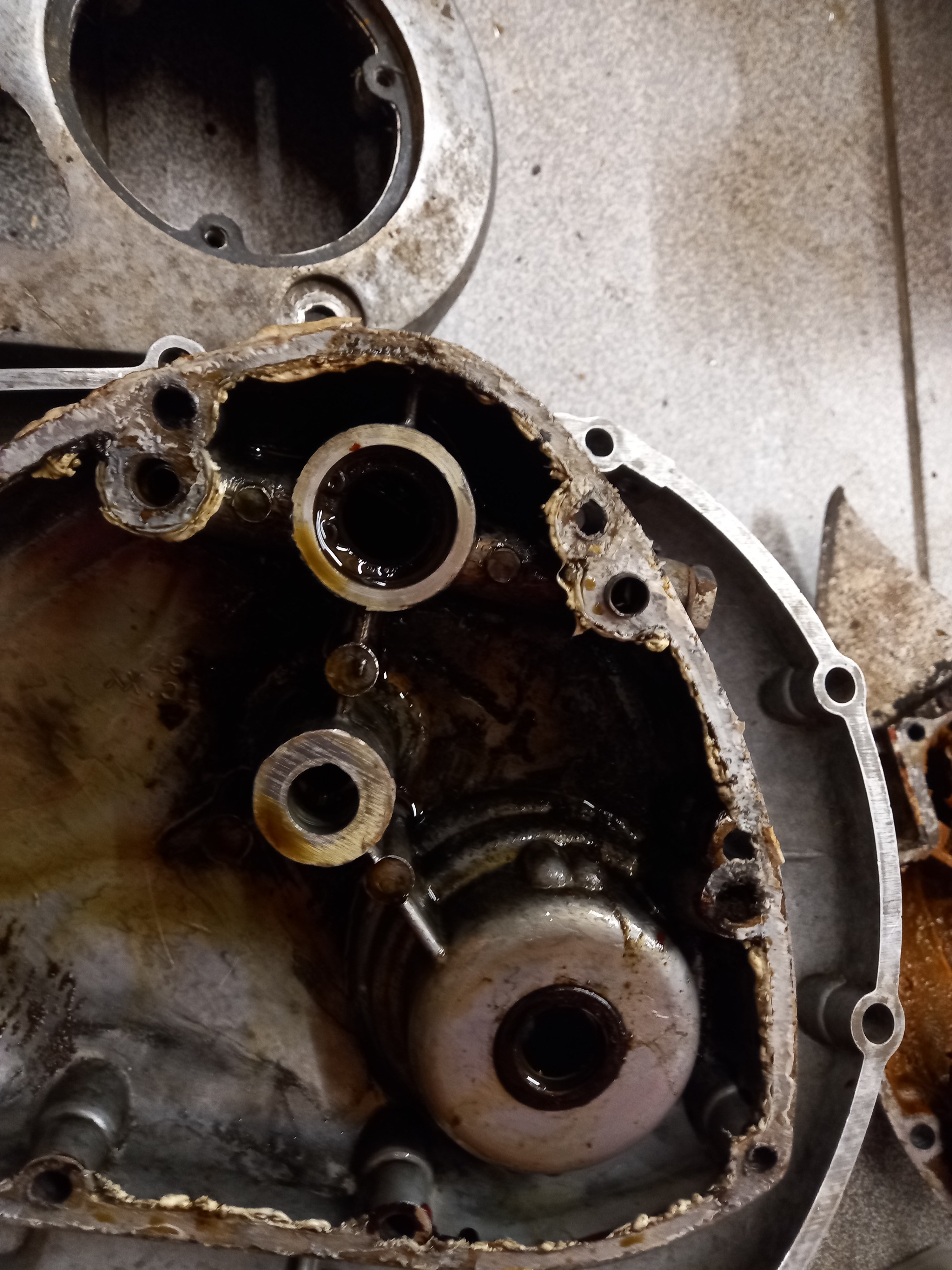

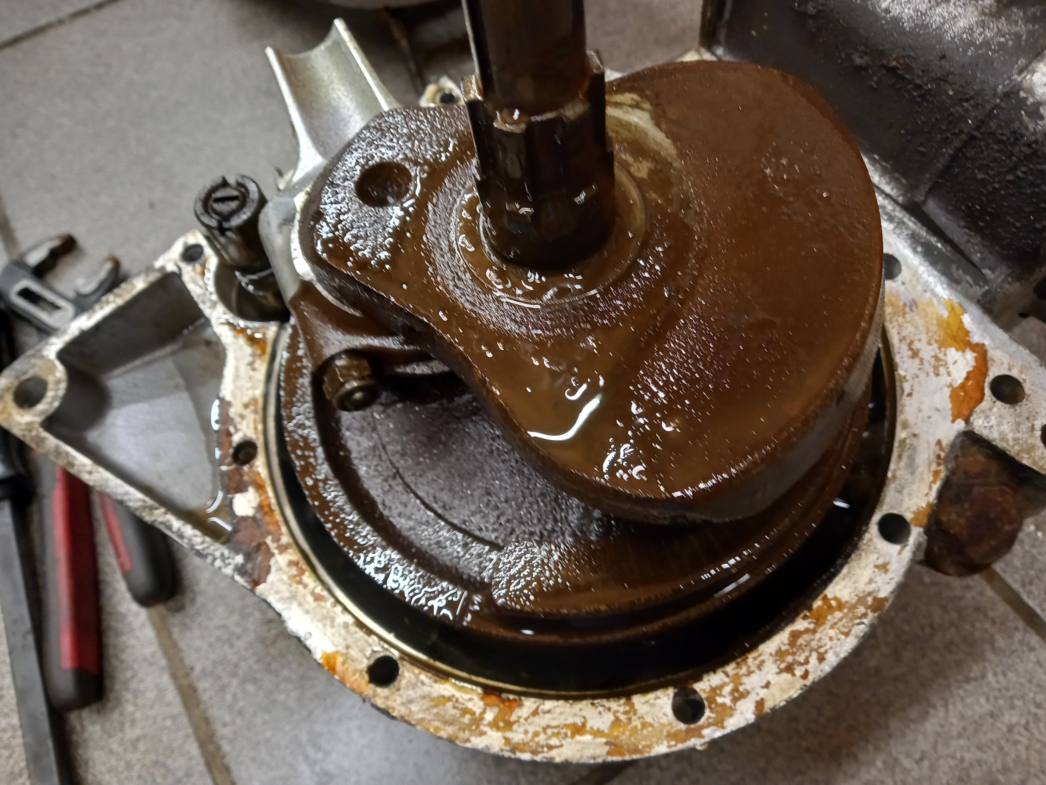

    As i did not want to watch the race live Su n me spent the day out in the workshop stripping her engine in prep for the rebuild, lots of water and sand inside :eek::oops:
  4. joe mc donald
    15,505
    Boy oh boy Darkman you have a job on your hands there. I guess i know how your festive season will pan out this year. I can't wait to see the bike when it has been in the hands of a master.

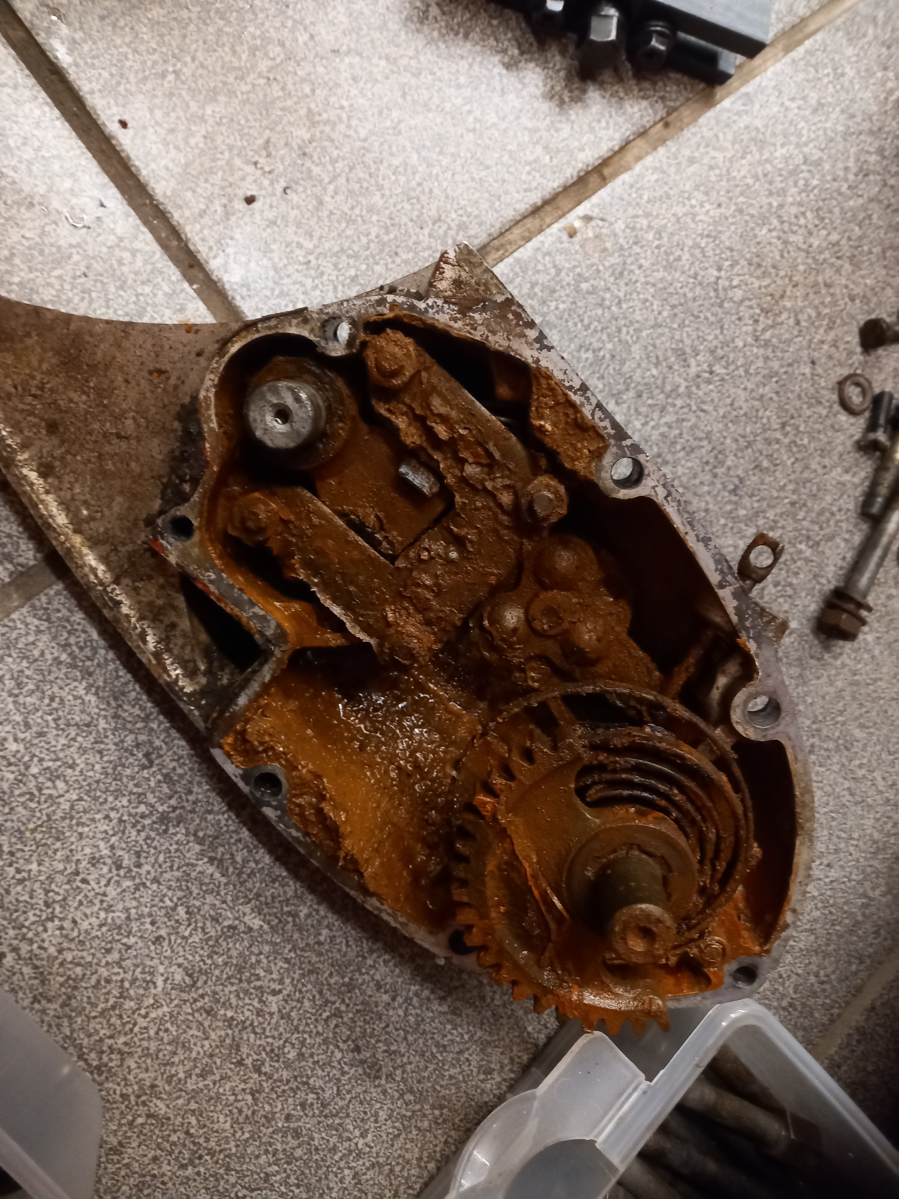

    my morgo was flooded once and the gearbox had rust in it when i tore it down. but it did not look as bad as that outer cover.
    what do the gears and shafts look like?

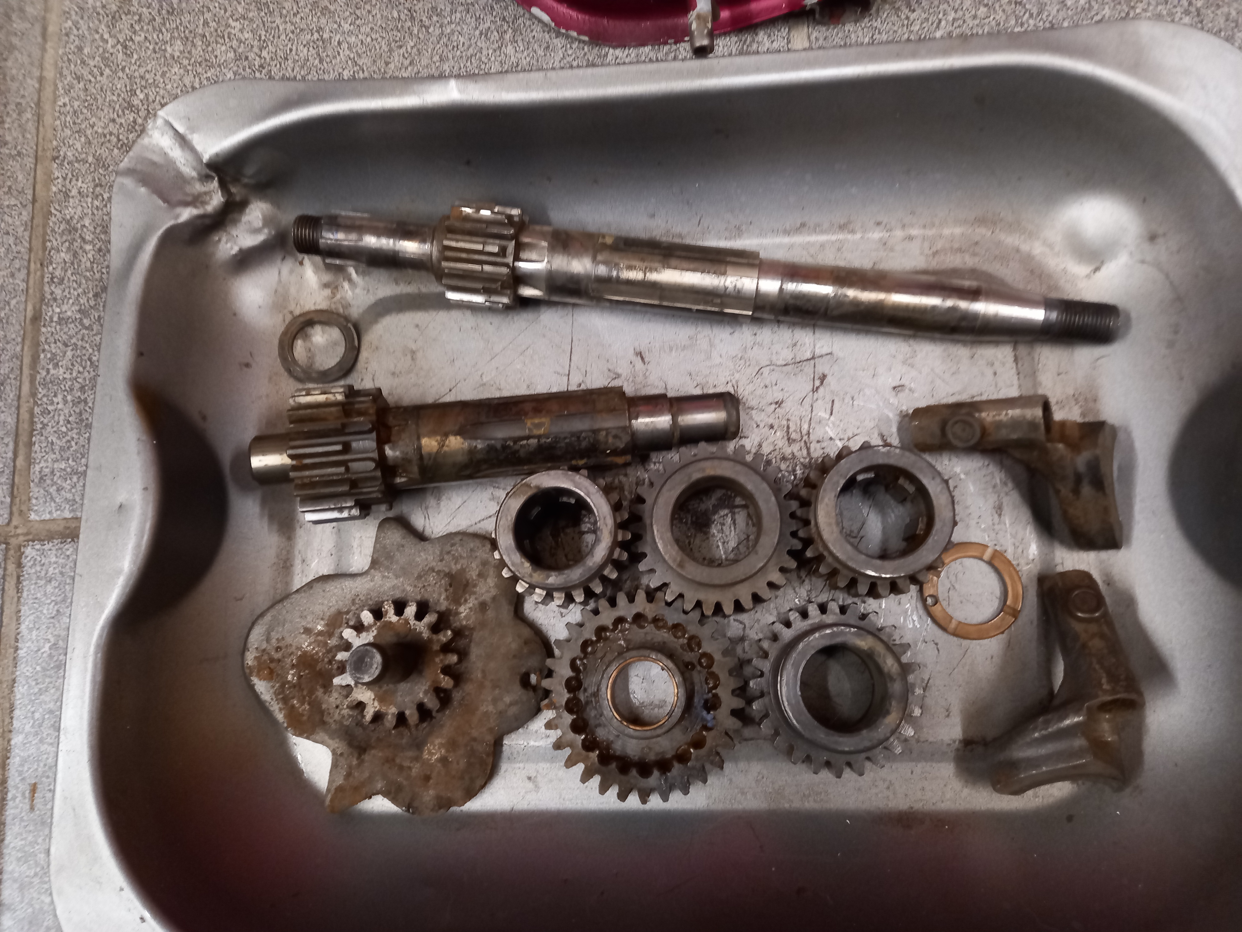

    Sadly most of the gears have pitting on them as do the shafts, possibly the layshaft will be ok but its that dilemma of how much pitting is acceptable. I will give them a thorough clean and then decide :) Luckily i have a good few spare parts.

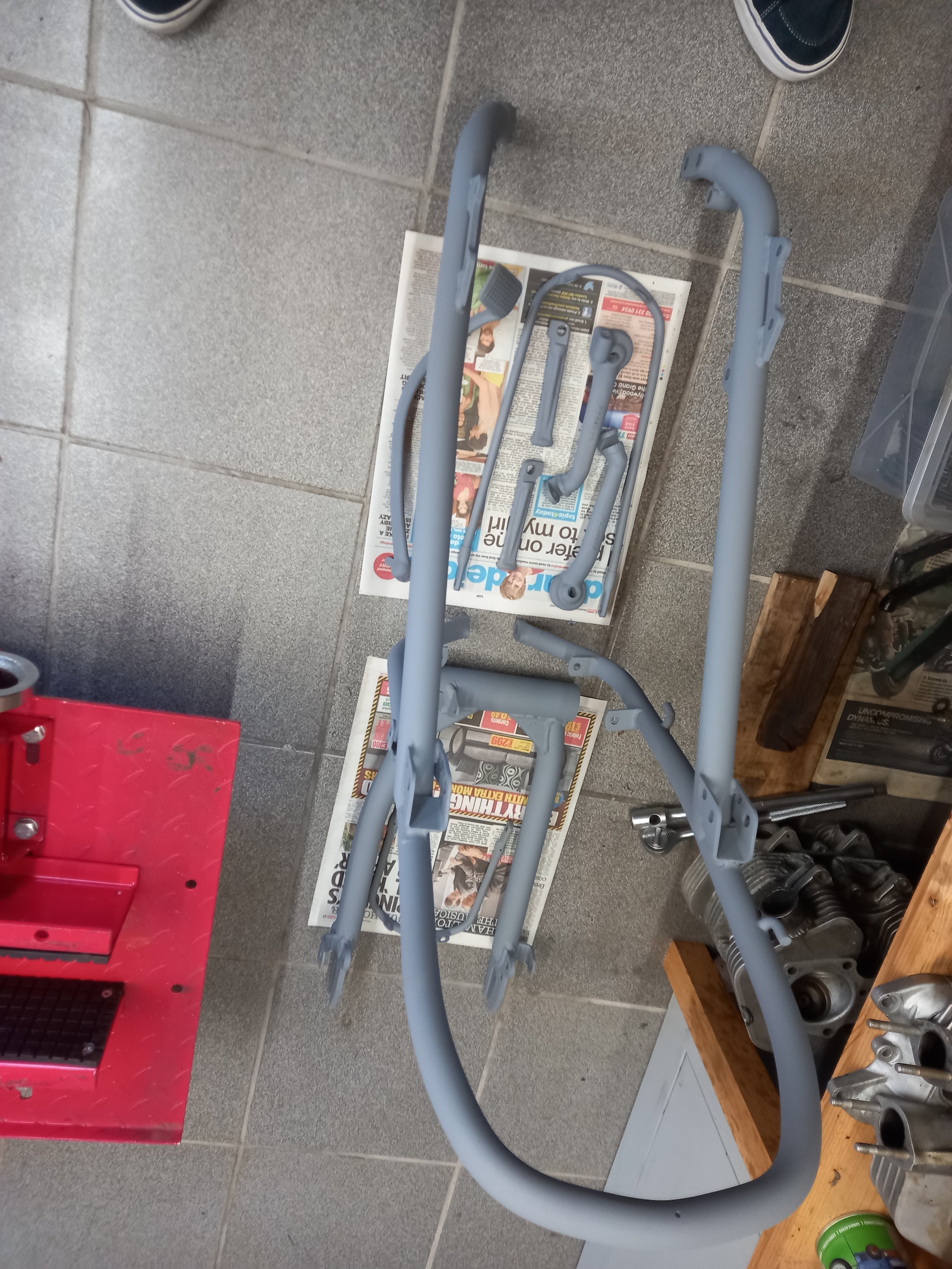

    Finished stripping the engine and Su is scrubbing all the good parts inc getting the sludge trap clean, also managed to get the frame parts blasted and in etch primer ready for pre build the repairs.

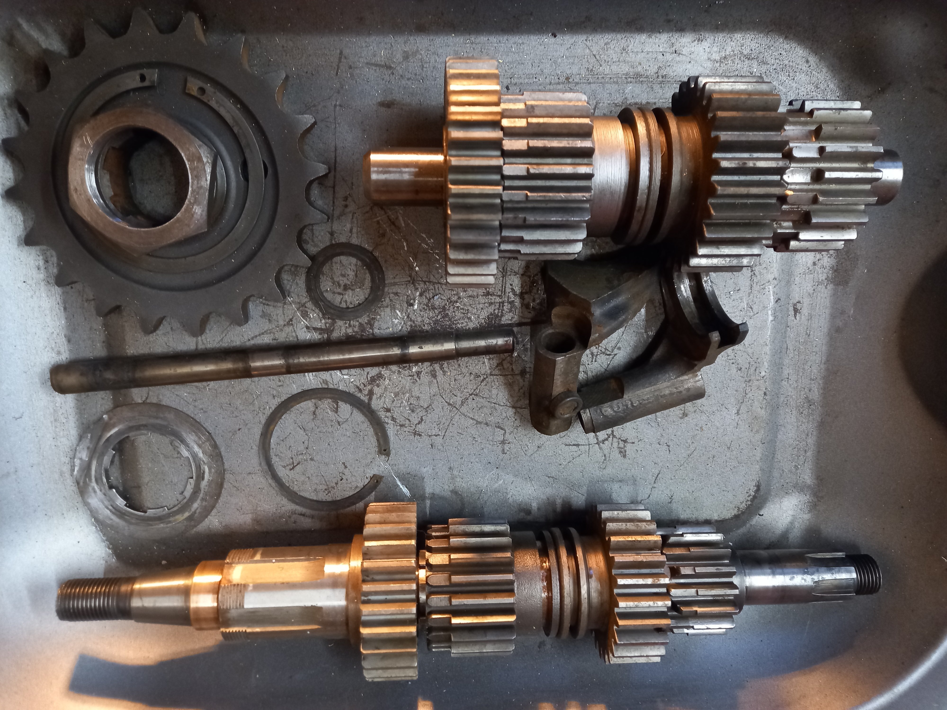

    Finally finished cleaning the gearbox parts, luckily i had a few new or nice second had parts and only need to buy the 3rd gears for the main and lay shaft. A pic of all the nasty parts to be replaced due to engine and box being full of water oil and sand :)

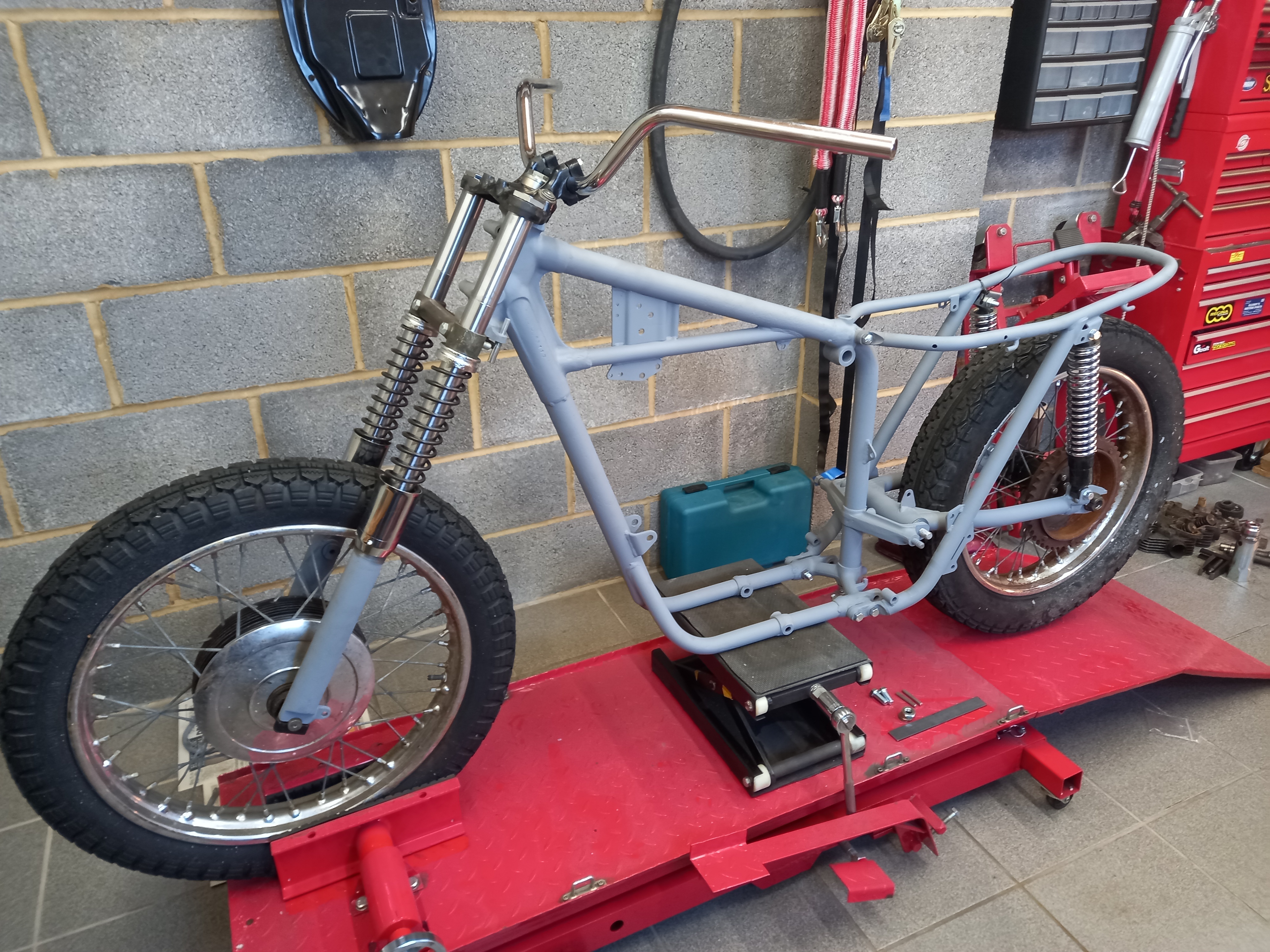

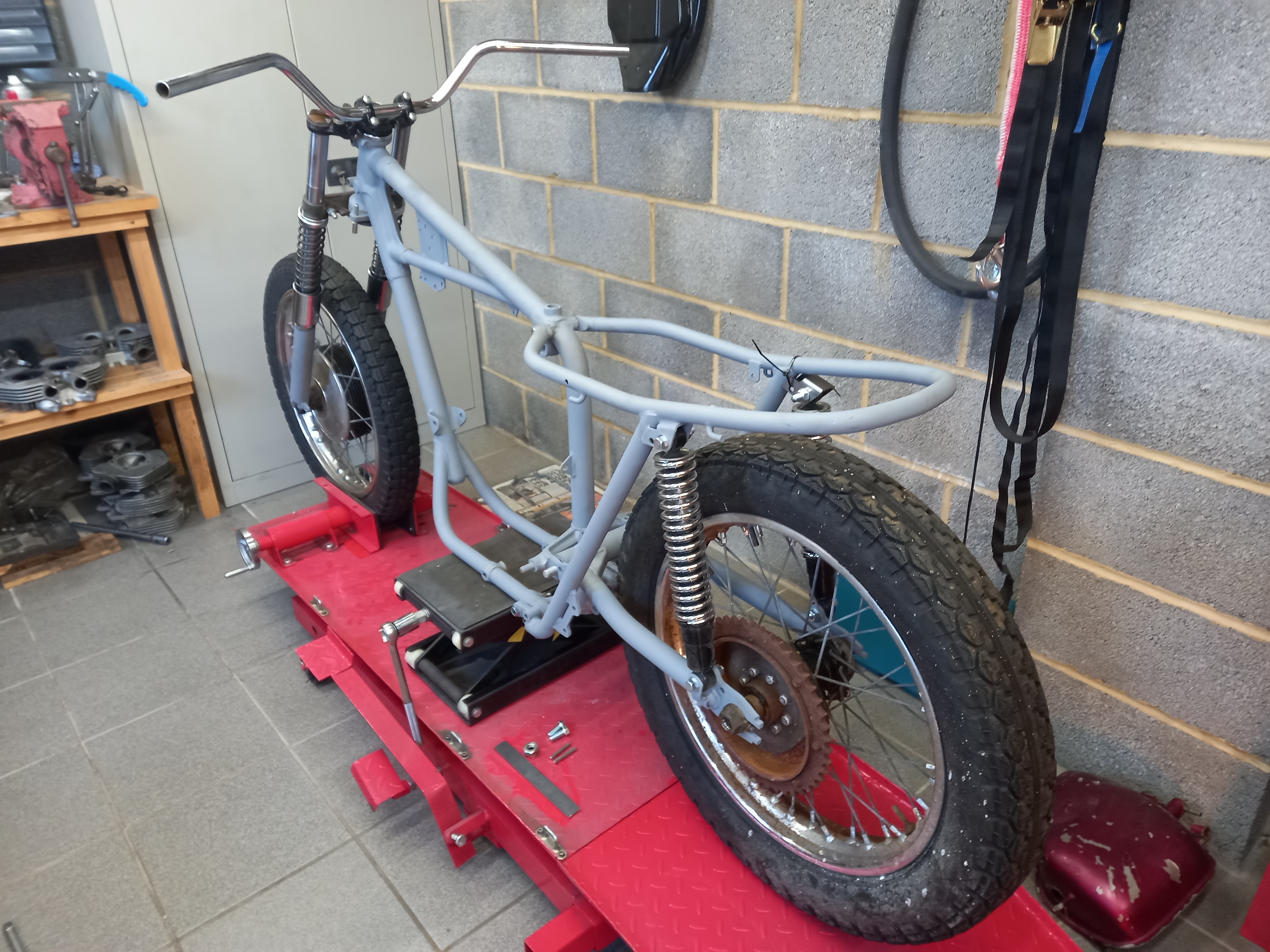

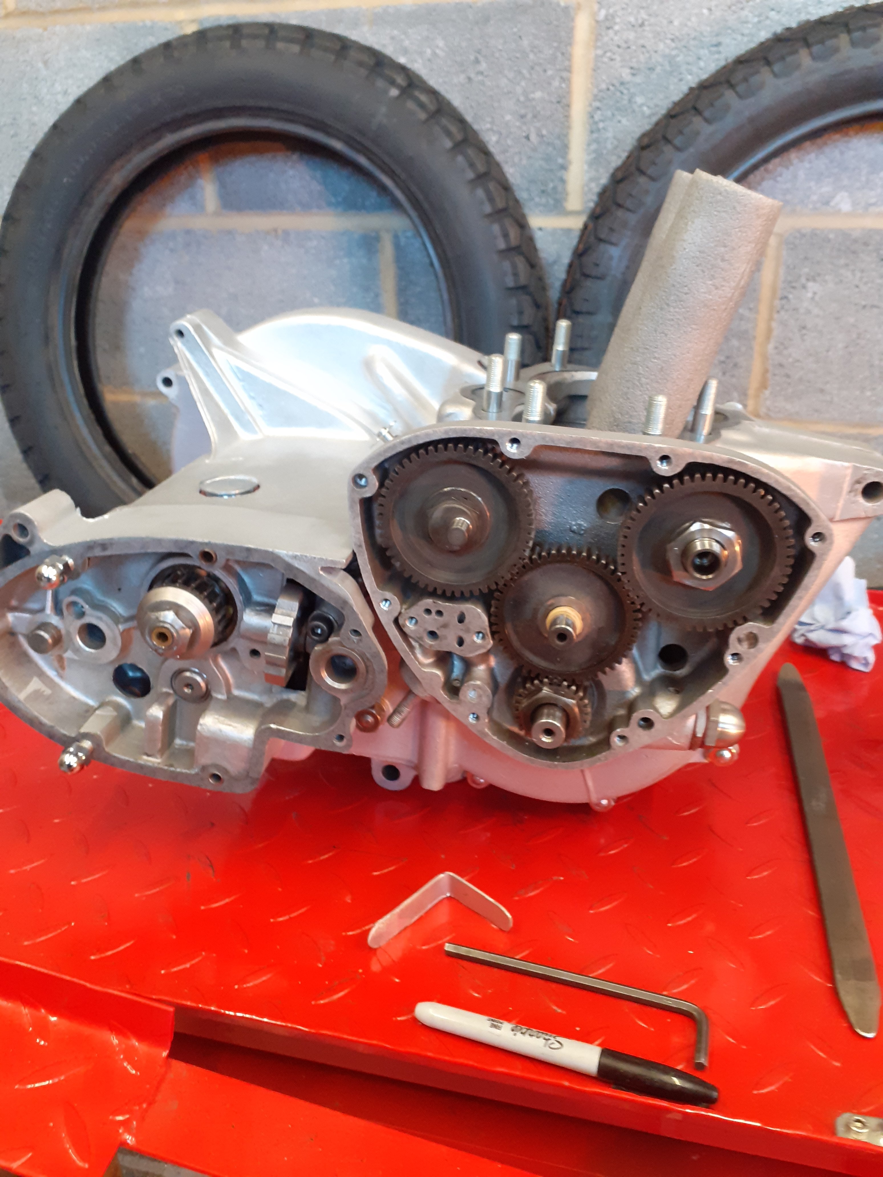

    The pre build is under way ready for welding side stand lug and tank brackets and the cases are blasted and ready for the engine rebuild.

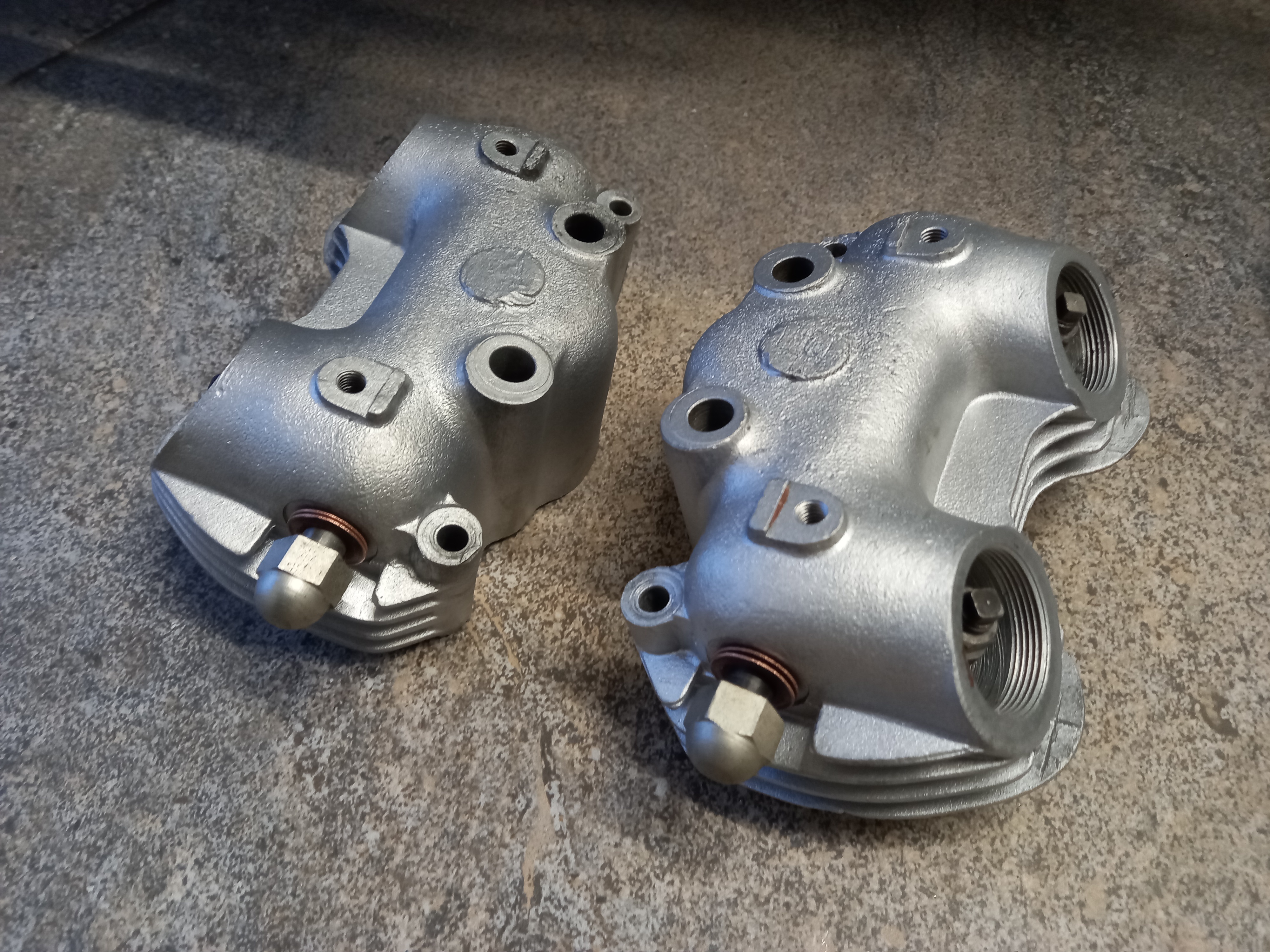

  15. darkman
    7,656
    Todays little jobs, rebuild the rocker boxes after blasting with new seals and clean off the old packing grease from the new gears and make sure it all works.

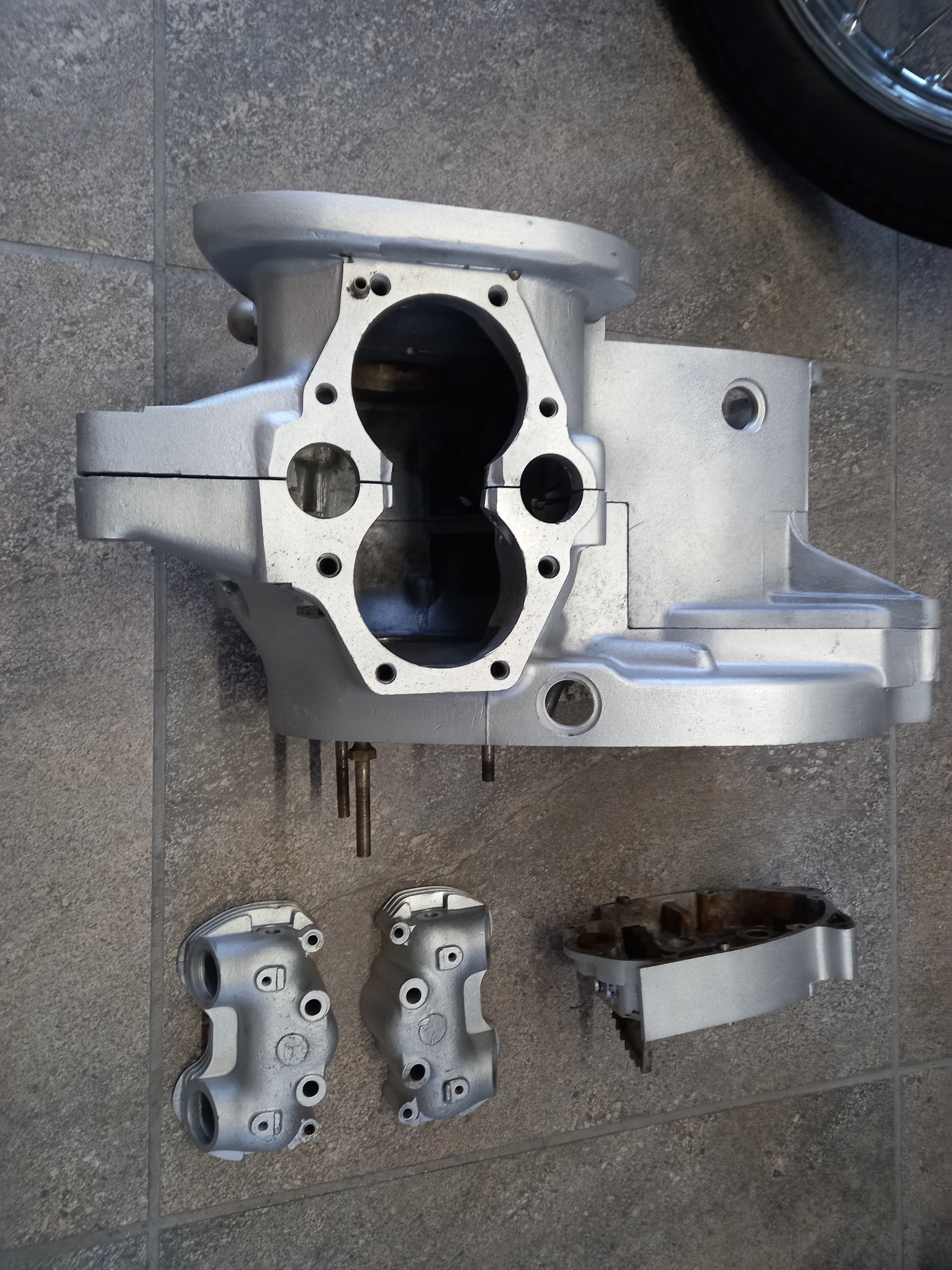

  16. Adie P
    Adie P Crème de la Crème
    Jul 7, 2018
    3,703
    MID DEVON
    Hi @darkman . Which blasting process(es) do you use and where do you get it done, please? Those engine cases look superb.
  17. darkman
    7,656
    Normally i do them myself with a hand held gun and glass beads but it's so bloody cold outside i got Steve at Phoenix in Poole to aquablast them Adie.
  18. Adie P
    Jul 7, 2018
    3,703
    MID DEVON
    Aaahhh OK. Cheers darkman. They've done a great job, for sure. Wellworth remembering (if I can! :)))
  19. darkman
    7,656
    If not then just buy some fine glass beads, here is one i did myself with beads and a cheap gun outside.
