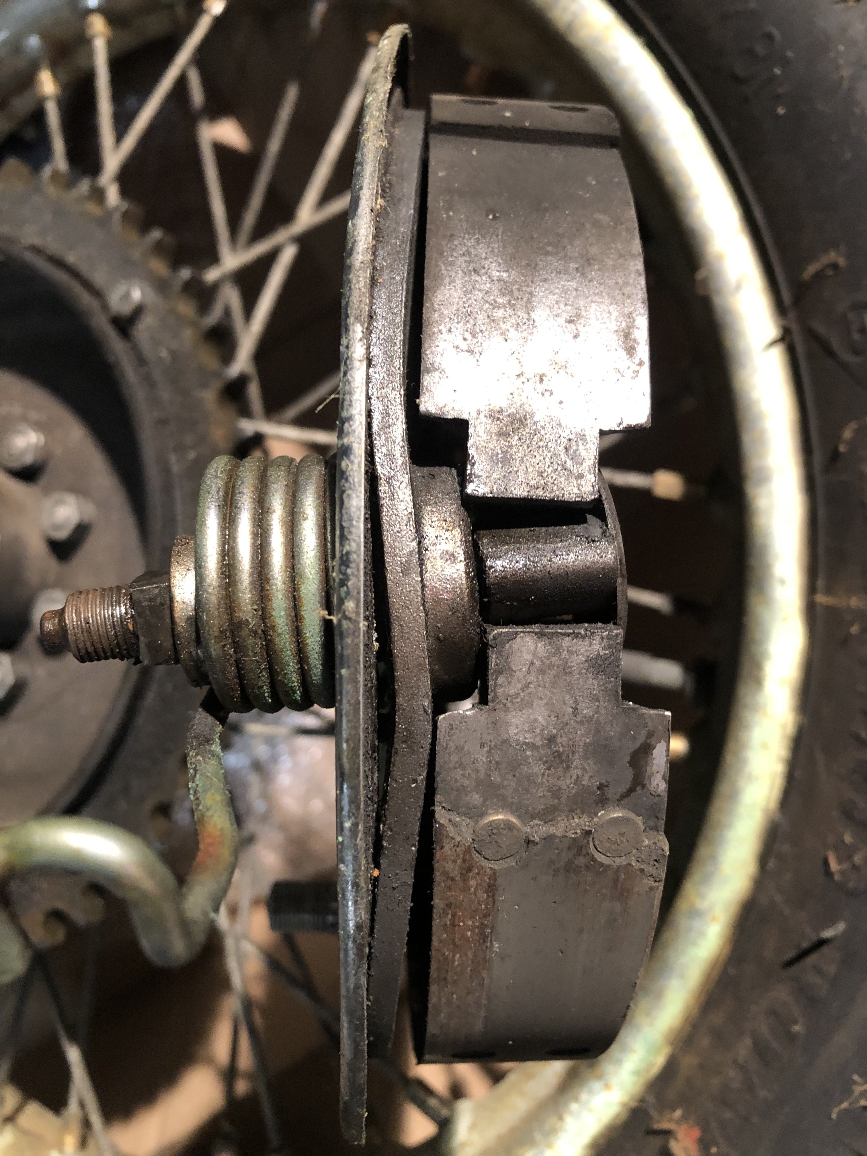

    As I’m waiting for some bearings and other engine parts before I start putting my motor back together - I’ve been taking apart my wheels and other bits. When taking apart the rear wheel today I found that the brake plate was bent. I’m wondering if anyone has experience with this sort of damage. Would it be possible for me to attempt to bend this back into shape? Thanks for comments!
