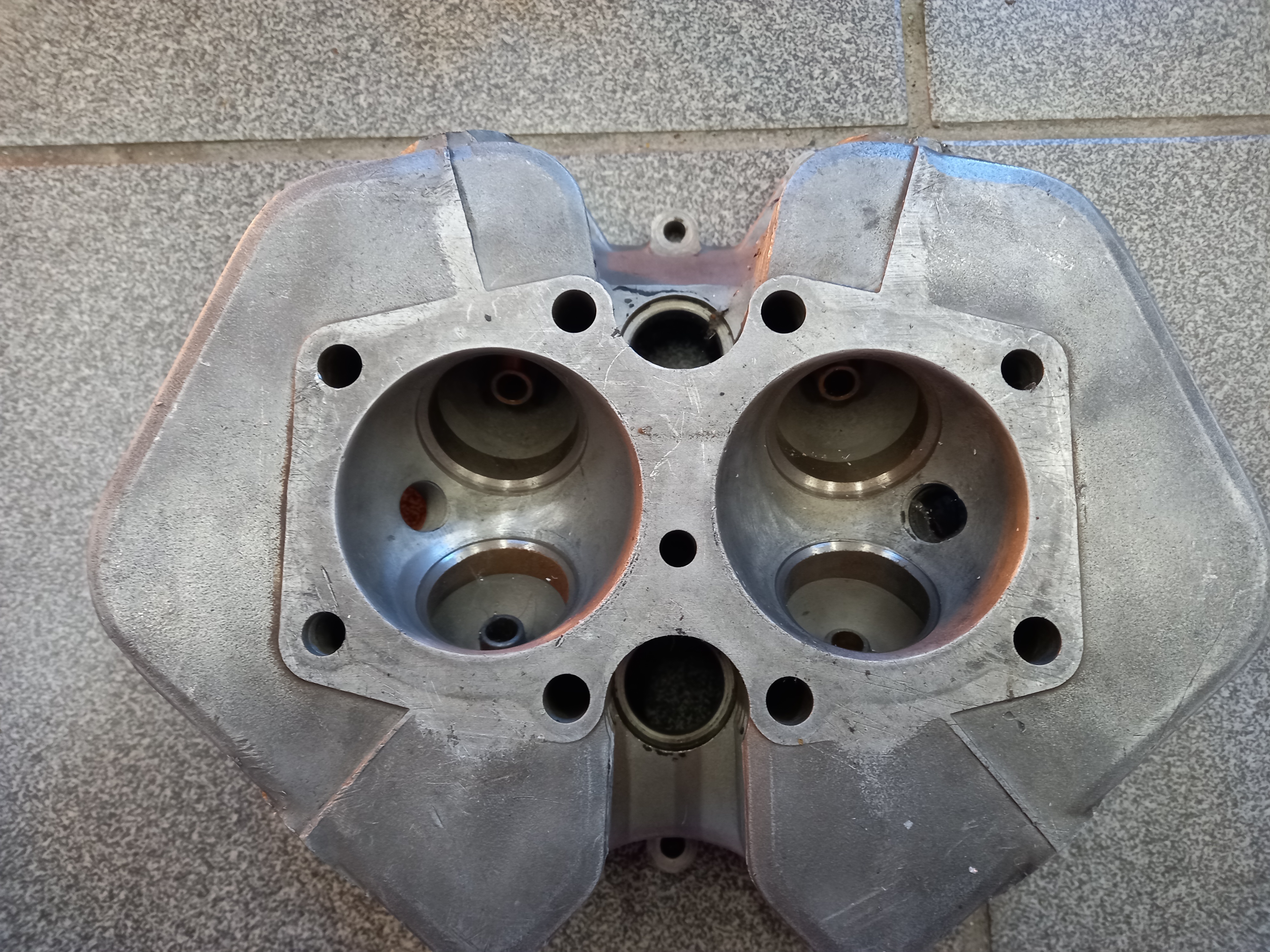

    Here are the 63 and 67 heads. 63 with smaller ports and valves has none and 67 head has inserts.

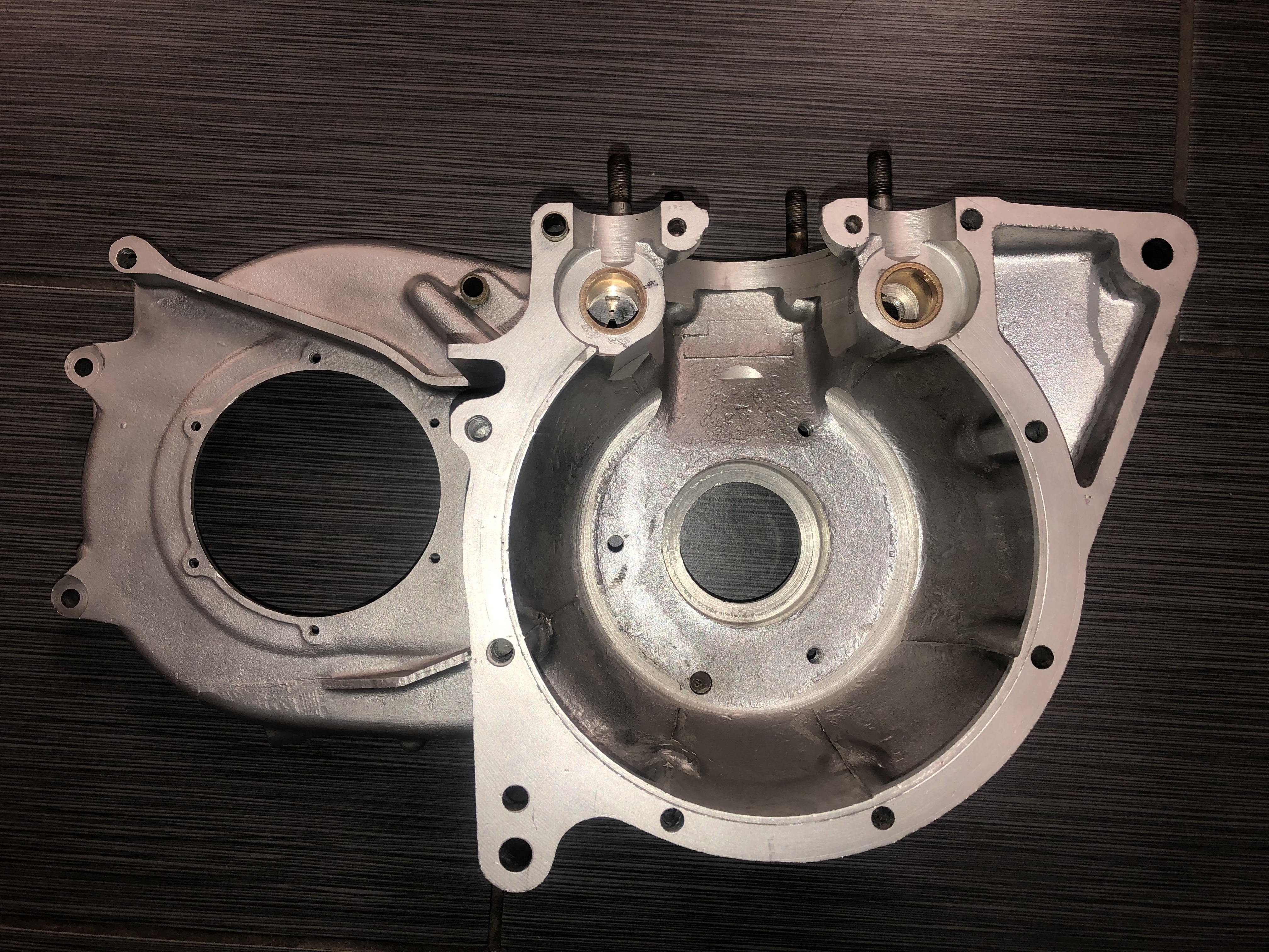

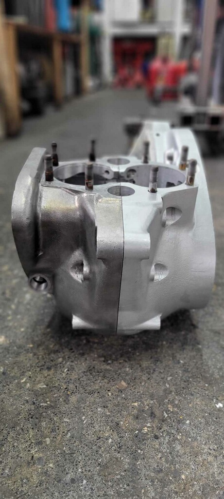

    I picked up my engine cases from Sean at Motorelic (https://motorelic.com) here in Northern Virginia. He vapor honed my engine cases, head and rocker boxes. I was considering not having this done since I had cleaned the cases quite nicely, but I’m really pleased with the results! Sean did a great job and he has some very cool builds in progress now.
    I then drove my head down the road a bit to Rob at Virginia Vintage Cycle (http://virginiavintagecycle.com). He was gracious to take a look at some of my problematic parts, especially my pitted cams and tappets. Looks like I’m in the market for new cams and tappets now as the pitting was too deep to consider then serviceable. Rob went over his head rebuilding process. He also took a look at the place in my head where the head bolt hole breaks through the inside of the head (and is plugged by a steel insert) and says he sees this on a lot of heads and is not a problem the way it is. He was putting several bikes together and offered me several build tips, specifically on a transmission he was installing - which will save me from some mistakes I was probably going to make. All this to say that he was very generous with his time and knowledge. He also has some very cool custom bikes in process as well as restorations and is very busy these days. Glad he could fit me in.

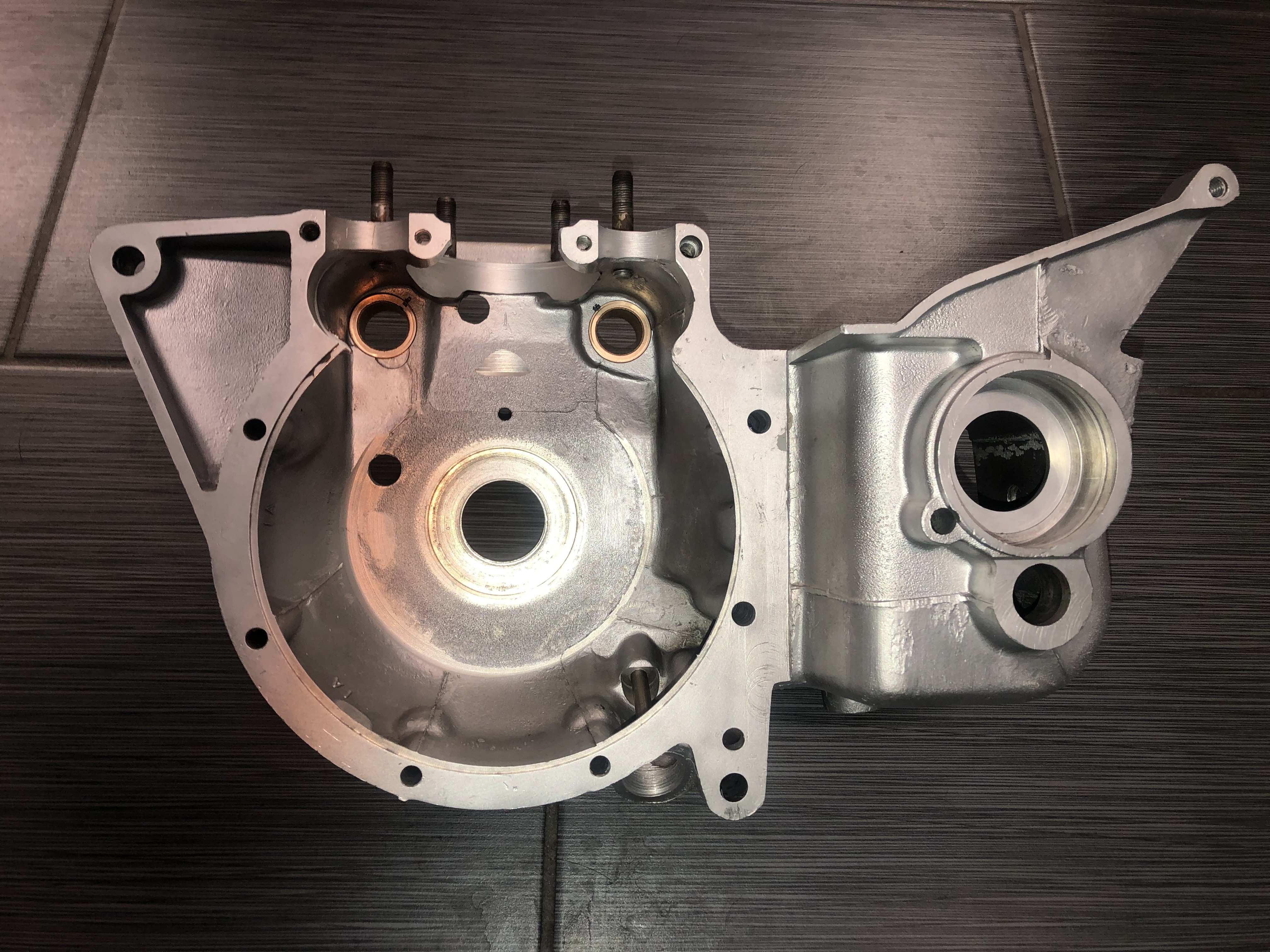

    I finally got some time to install my cam bushings. The cases were very clean. I put the bushings in the freezer for a couple of hours and then installed them with the driver tool sold by Lowbrow customs. Then used the reaming tool for the bushings with the cases bolted together. I fitted the cams and put the cases together and it seems that they are a good fit. Now on to replacing some bearings.
