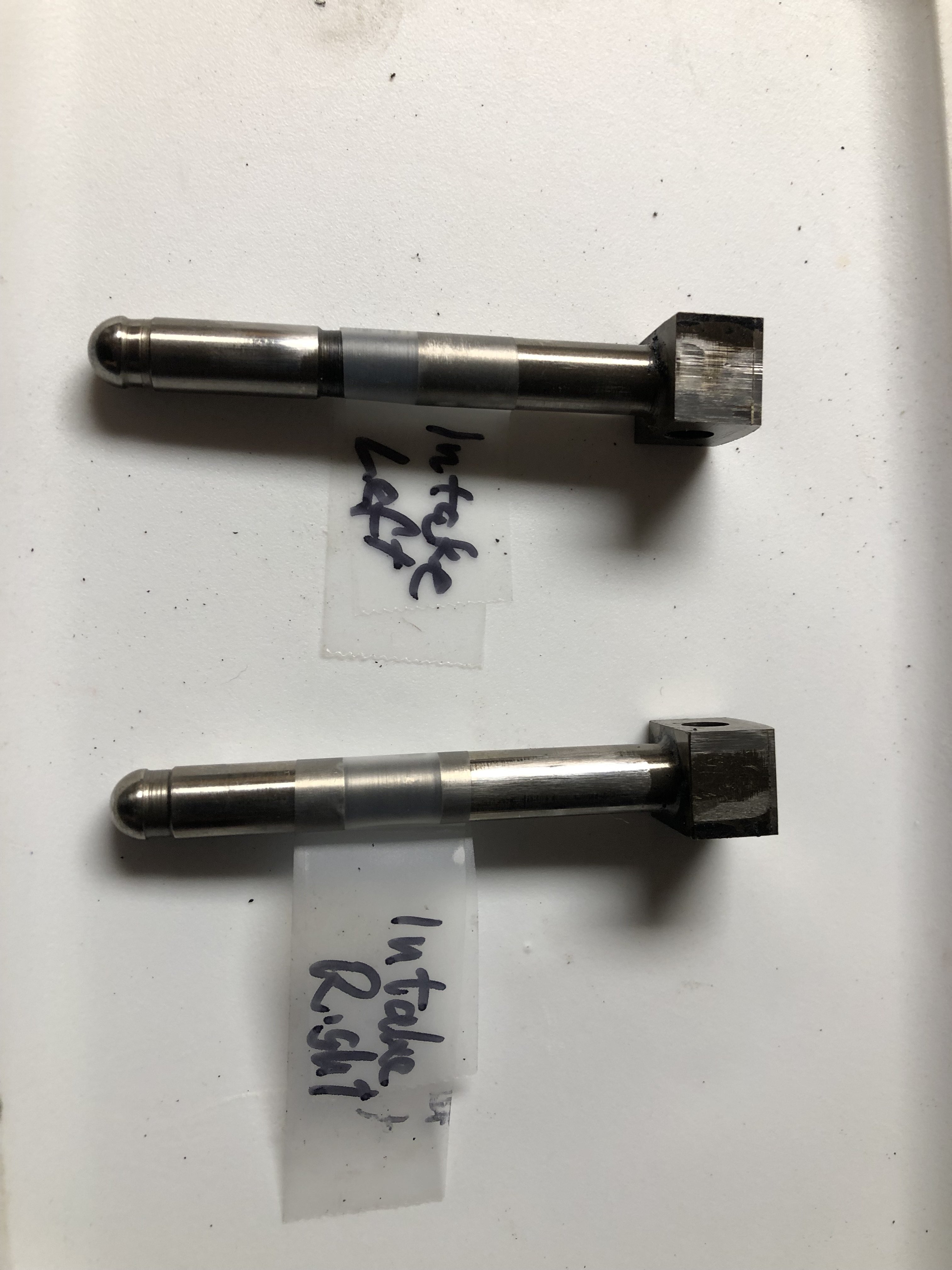

    on the tappets, the R is ground to a 1 1/8-inch radius, and the standard to 3/4-inch. they give different durations and accelleration as a result, so you should have all of the same kind. i have read that the T120 came with R tappets 1966 -on.
    are you keeping the cams? what do the lobes look like? in a perfect world you would not put a different tappet onto a lobe that had worn-in to a previous one. but people do it all the time and i suggest you get hold of an R intake tappet to replace that standard one.
    if you end up buying new cams you can have the tappets refaced. i think the standard cut is 0.010, or at least thats what ionce measured onsome

    I was thinking that I would keep the cams, but may have to replace the tappets. I know this may be elemental - but how do I determine if the cams are ok? There doesn't seem to be much injury to the lobes. Since one of the tappets doesn't have the "R" designation, I was thinking I would need to replace them.

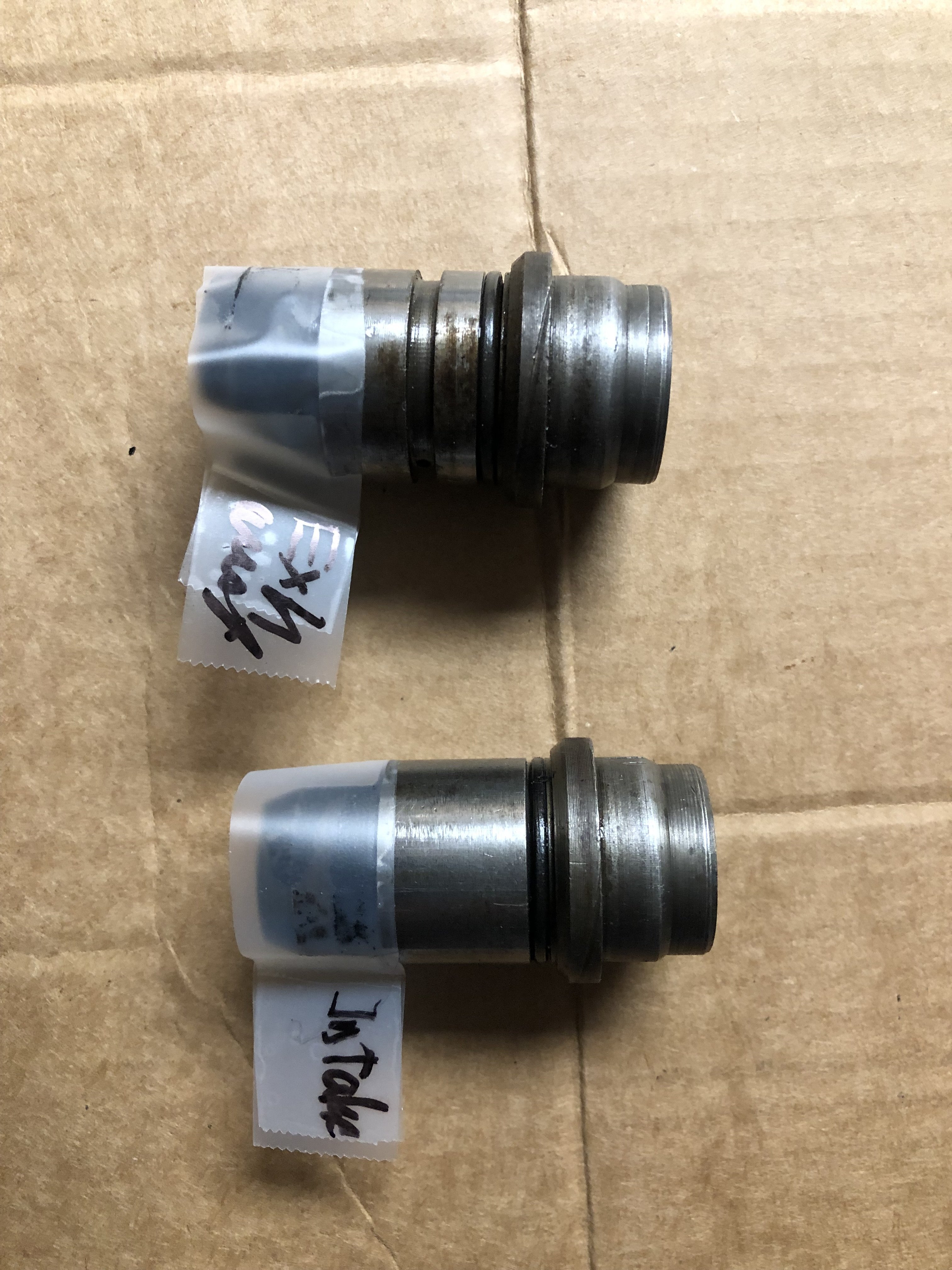

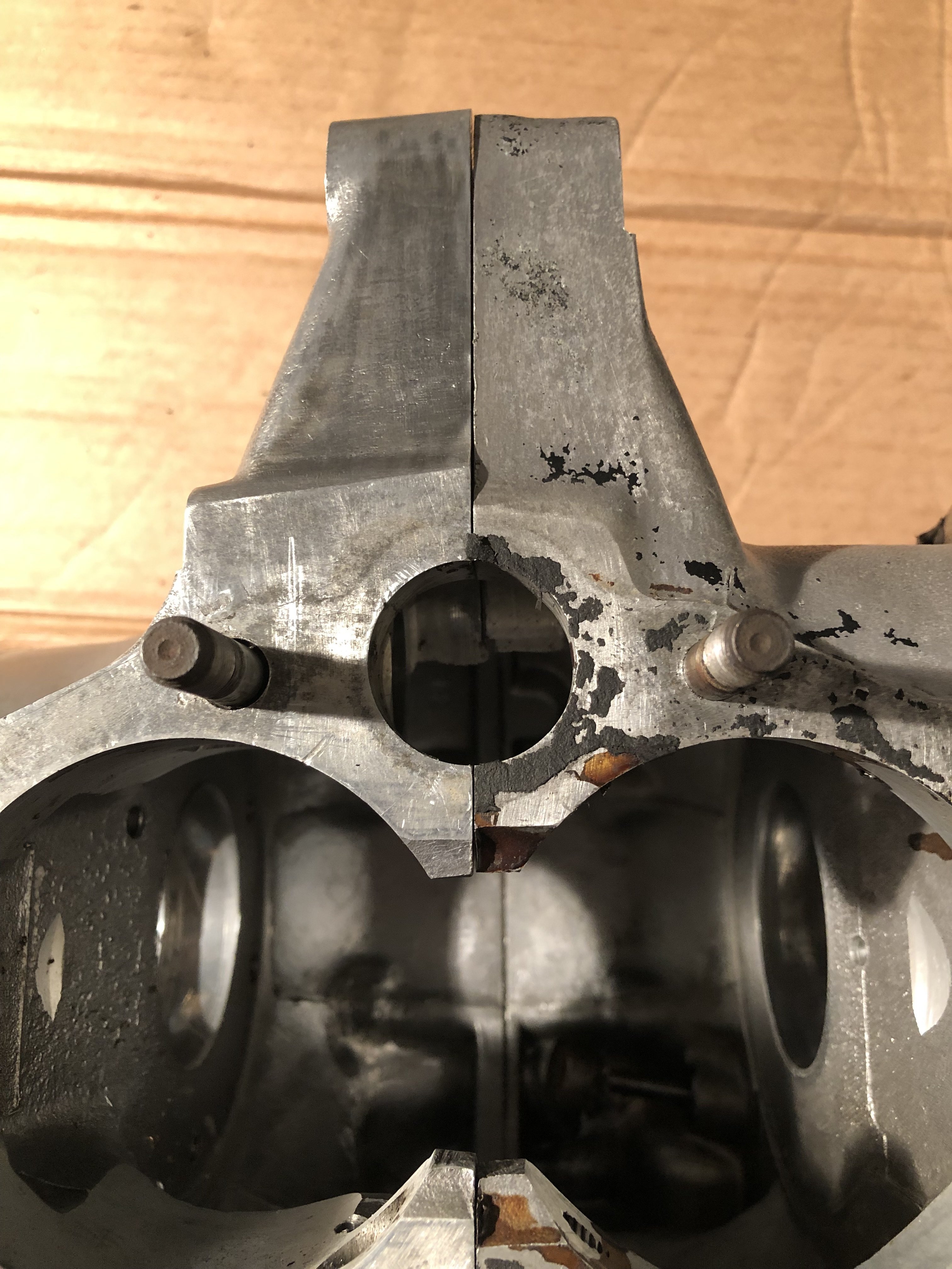

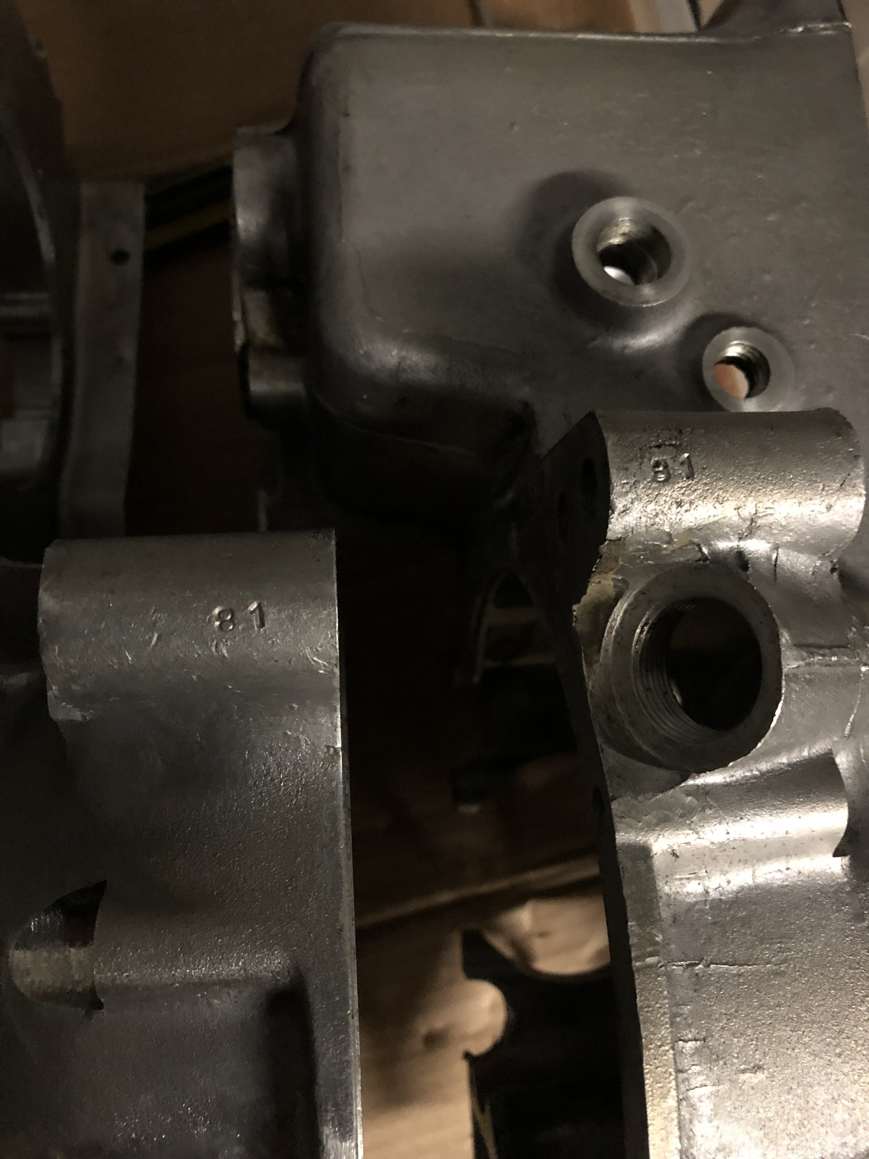

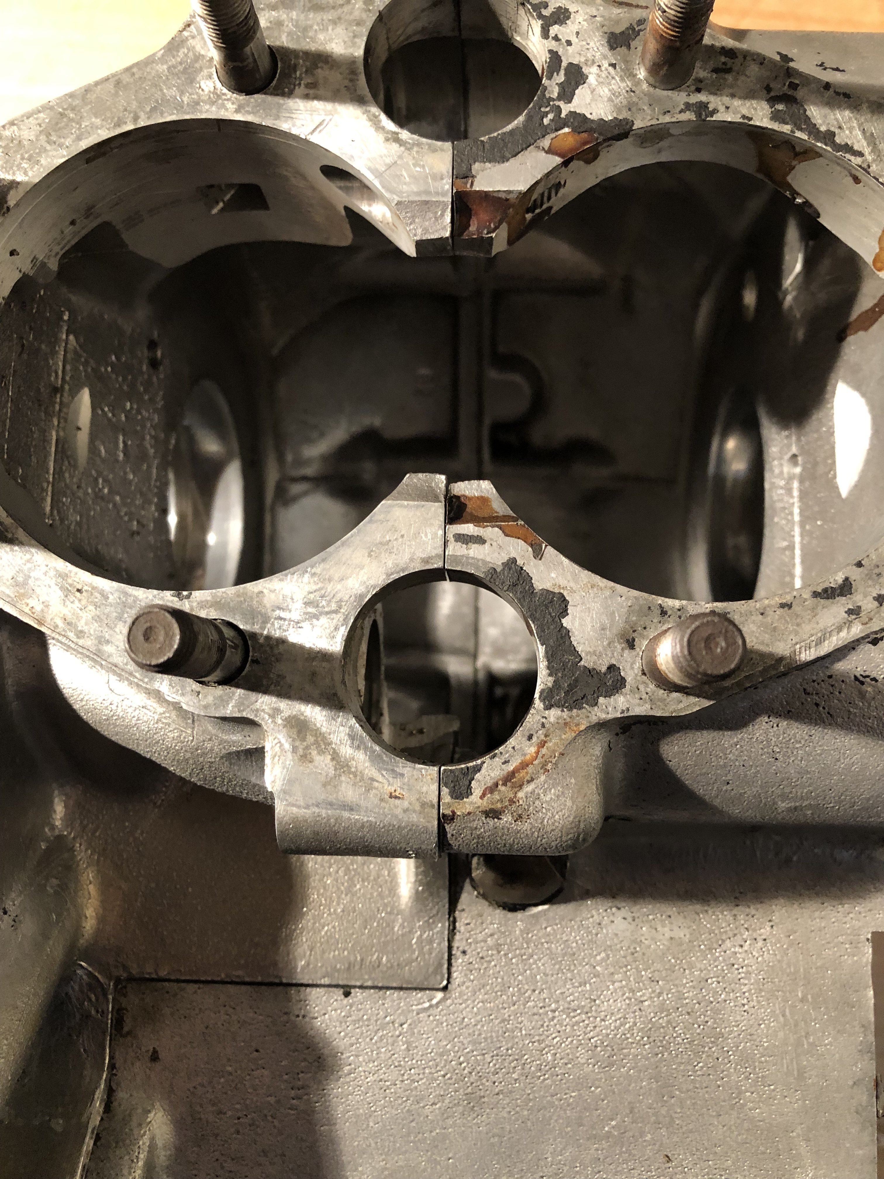

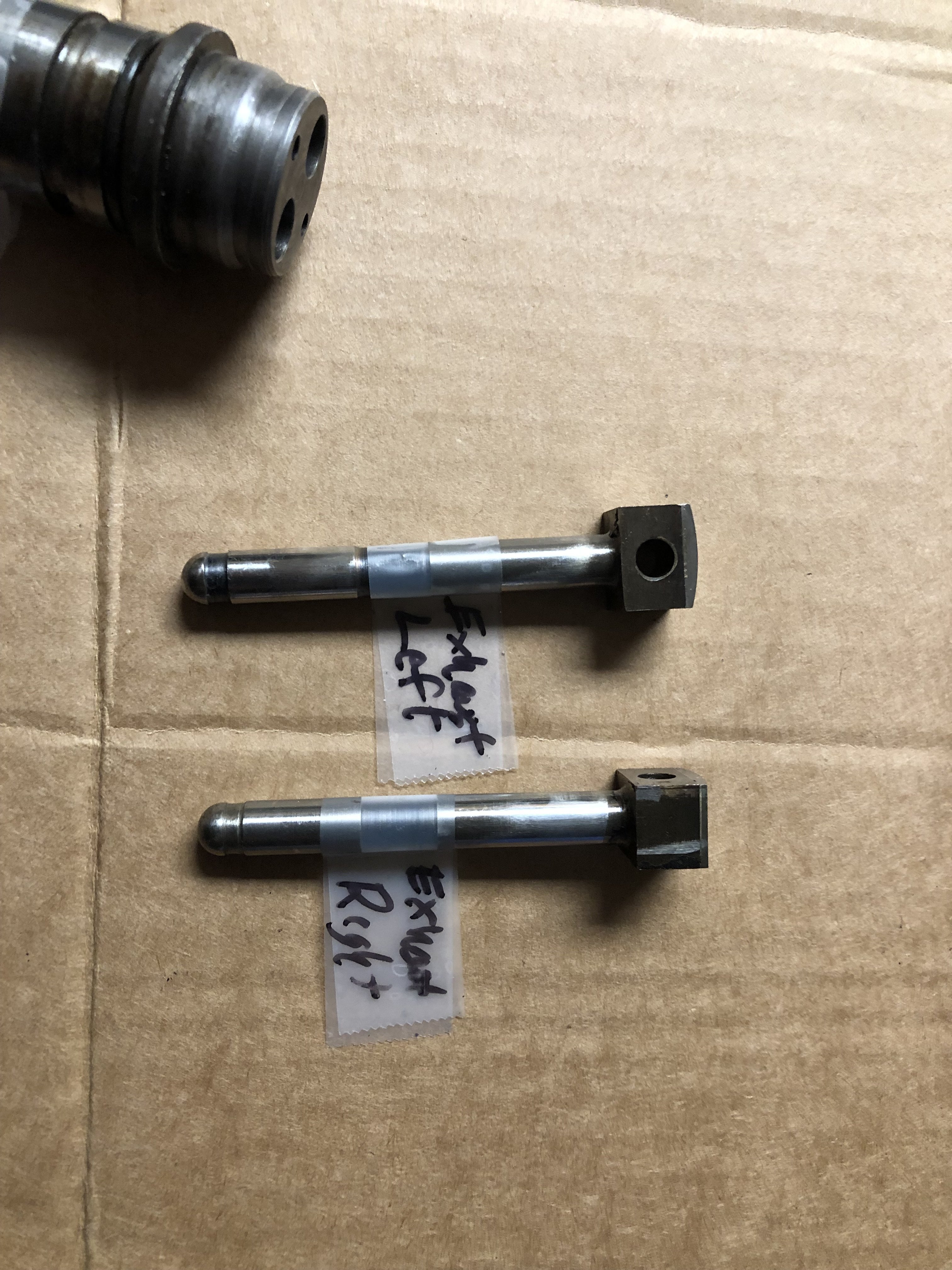

    Some Tappet advice needed. I had thought that 3 or my tappets were the “R” type and 1 was not. Well, after carful inspection I can make out an “R” on all 4 tappets. So I suppose the means the previous builder was consistent. This being the case, the exhaust tappets do not have a machined cut away space with an oil hole. My engine is from 1969 and I thought that this meant it should have the exhaust tappets with the machined flat area and an oil hole, which should face out on assembly of the exhaust tappets. Do I have my facts straight?
    Also, I am wondering if the case halfs are from different engines? As I put the cases together the casting doesn’t seem to match. As to the oiling of the exhaust tappets again, on the right side case, the exhaust tappet oil feed drillway is plugged. So perhaps this is why the exhaust tappets have no cut out and oil hole. Perhaps stranger again is that the cylinder (An old Routt big bore) does not seem to have an exhaust tappet oil feed drillway that would correspond with the drillway in the case. If any members can shed some light on this tappet sling question I’d appreciate it. From what I’ve read, the 1969 engine should have the exhaust tappet oiling system.
    Thanks!

    Its common practice for some engine tuners/manufactures to mix and match R and non R lifters to achieve desired lift/duration and not an issue as even Triumph ended up deleting the exhaust oil feed on later engines with the advent of better materials/metal treatment being used, I block the front tappet feed on all engines i build these days. At this stage it would be best to grind or replace your tappets/lifters and the cases shape wise all differ over the years but all factory cases have matching numbers stamped on the lower frame bolt lugs.

    Darkman, thank you. I took a look at the cases and yes, they have matching numbers. So it looks like I will be OK to leave the front tappet feed blocked on my engine case. Also on the tappets - it turns out all of those from my engine have the R designation. From my review of the engine manual, however, it looks like the exhaust tappets should have a machined cut out and small hole in the stem of the tappet. All of the tappets from my engine look like intake tappets. So with the front tappet oil feed hole blocked does one need the exhaust tappets with the machined cut out and small hole in the stem?

    Its only some aftermarket cam makers that spec R for both inlet and exhaust on unit 650's so use what your cam maker specifies with your current cams. Don't concern your self about the oiling as even i block off the feed to the front lifter block with standard cams just as Triumph did with later engines. If you decide to go with standard cams 70-9989 ex and 70-3134 in cams are best overall for street use with R inlet and non R ex.

    you dont need the tappet oil feed with your megacycle cams. did ypu mark the orientation front and back when you took the tappets out?

    Unfortunately, not. Only left/right. What kind of problem might this provoke?
