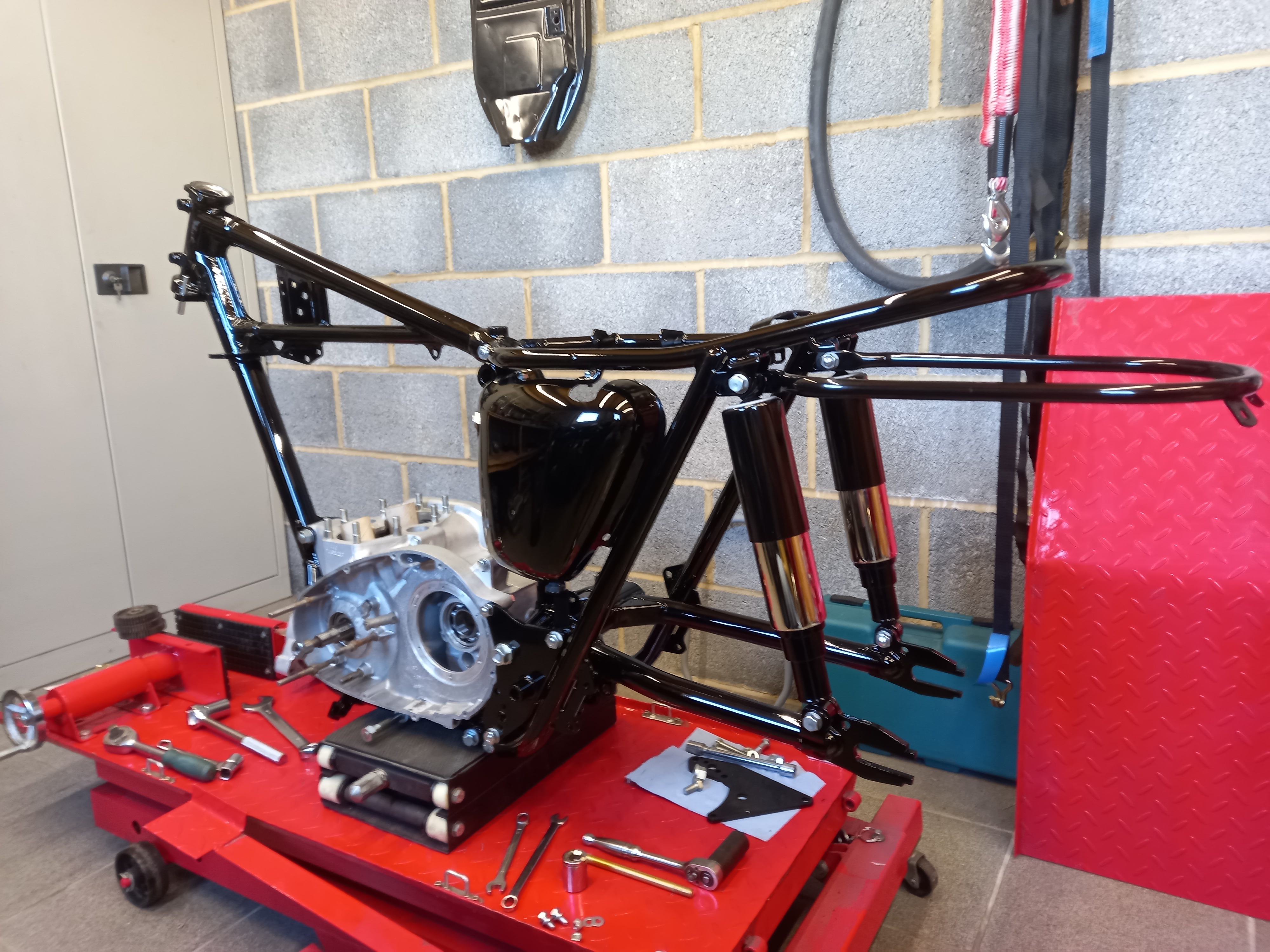

    I fit the two frames together and then the swingarm, just built mine up.

    Thanks! Wow, great photo. Gorgeous!

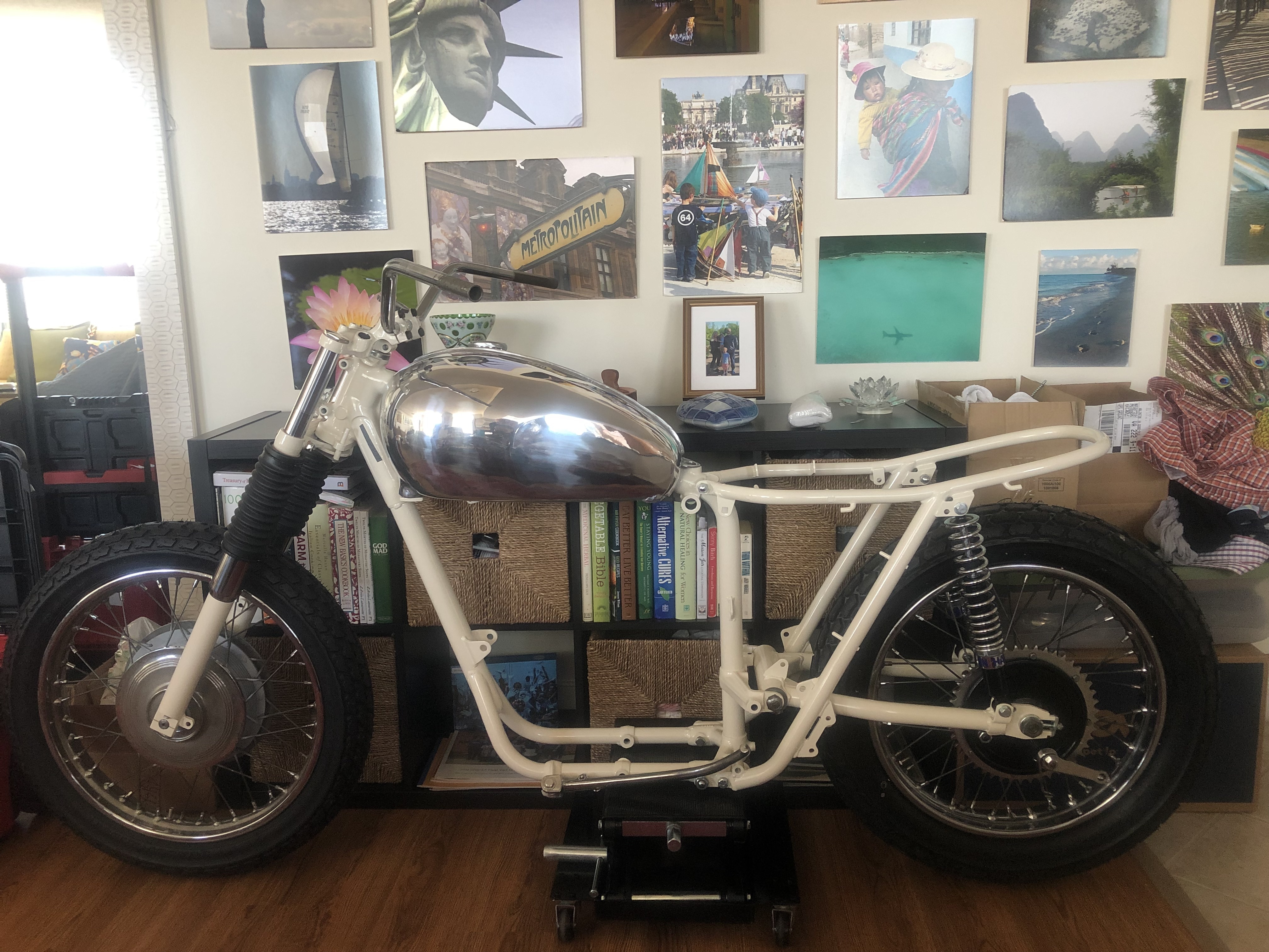

    I decided to take some time to get my chassis rolling so I could install the engine (as soon as I get the transmission indexed and sealed up) and continue the engine assembly in the frame. Here are a before and after for any interested folks.

    Sundance - that is going to be one good looking bike. I really like the frame colour. It'll be a corker when it's done. Bloody good job :)
  17. darkman
    7,648
    Looking great, like the colours :)

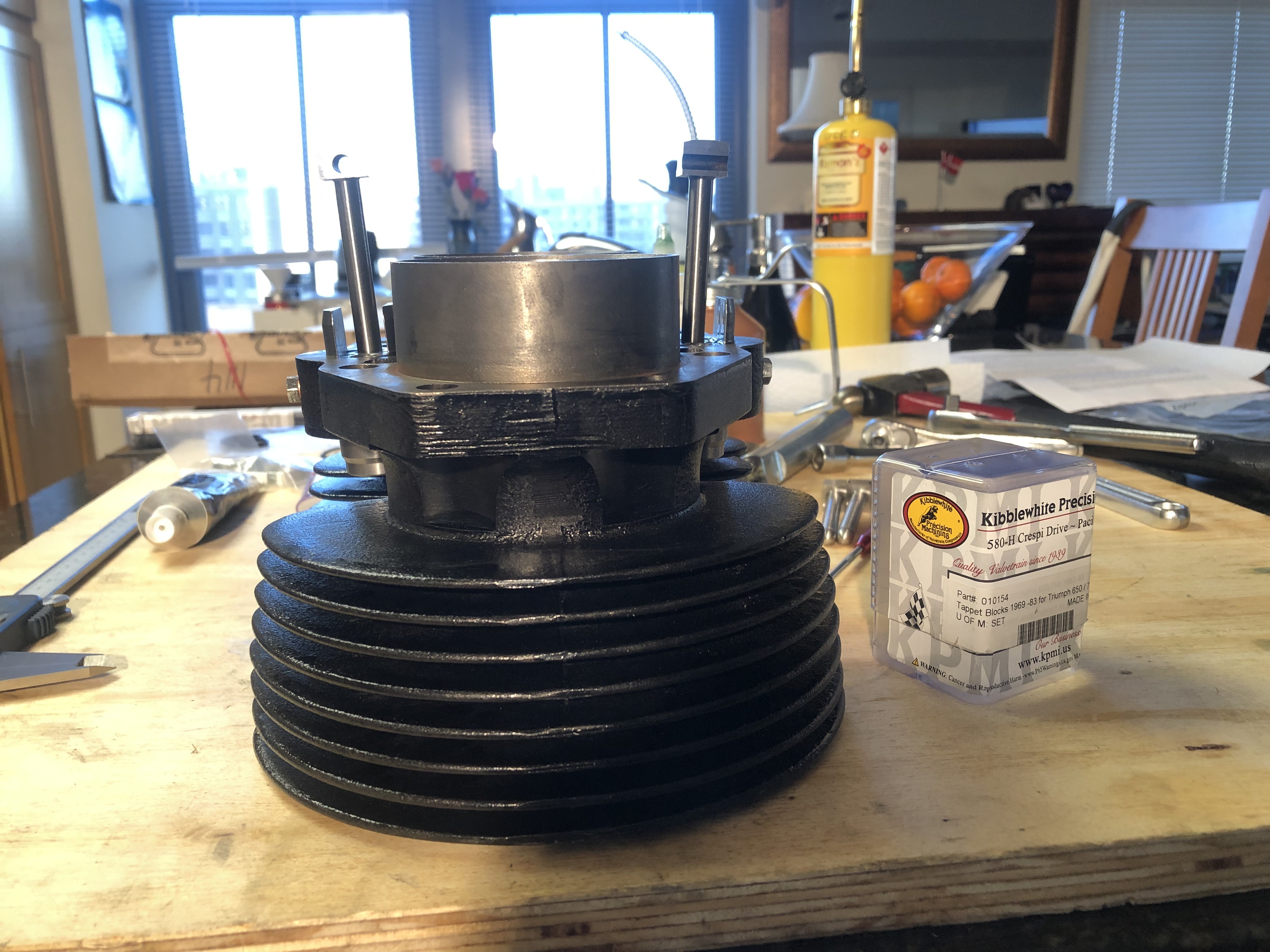

    Help with Cam Followers - I was going to put on my barrel and pistons and head this weekend but ran into some difficulty. I purchased new Kibblewhite tappet blocks from fagengine (Part # 010154) and new inlet cam followers (PN# 70-3059 R) and exhaust cam followers (PN# 70-8801) from The Bonneville Shop. So I installed the blocks and when I got to fitting the cam followers I found they will not fit into the tappet blocks. If I try the fit from the other side they slide in an inch or so, but from the side they need to be installed they go in a 1/4 inch or so and no further. Have any of you had this sort of experience? Thanks.
  20. darkman
    7,648
    Other than cleaning the bores in the lifter blocks and carefully deburring all the parts i have never had a problem with LF Harris parts but not sure about others.
