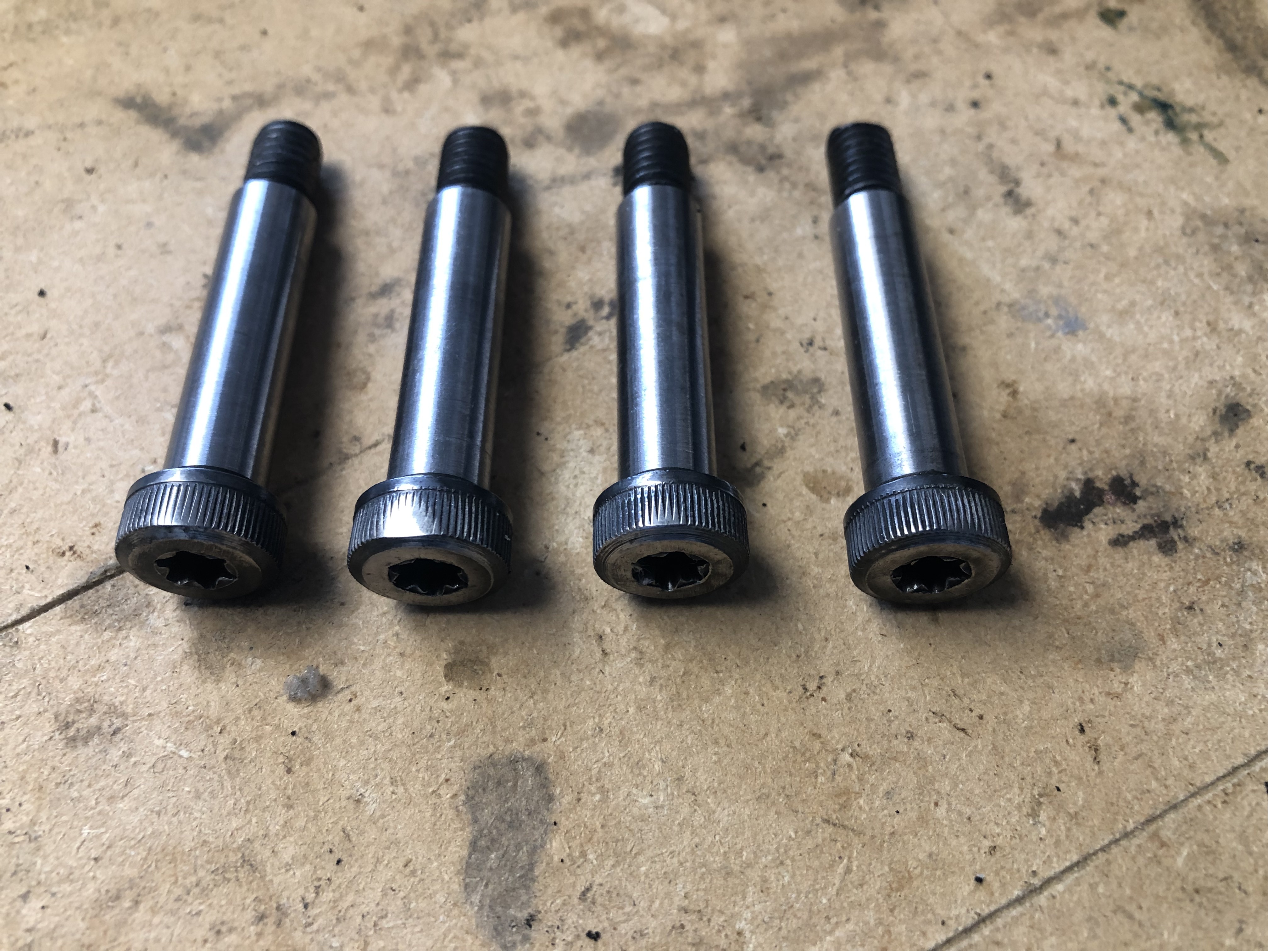

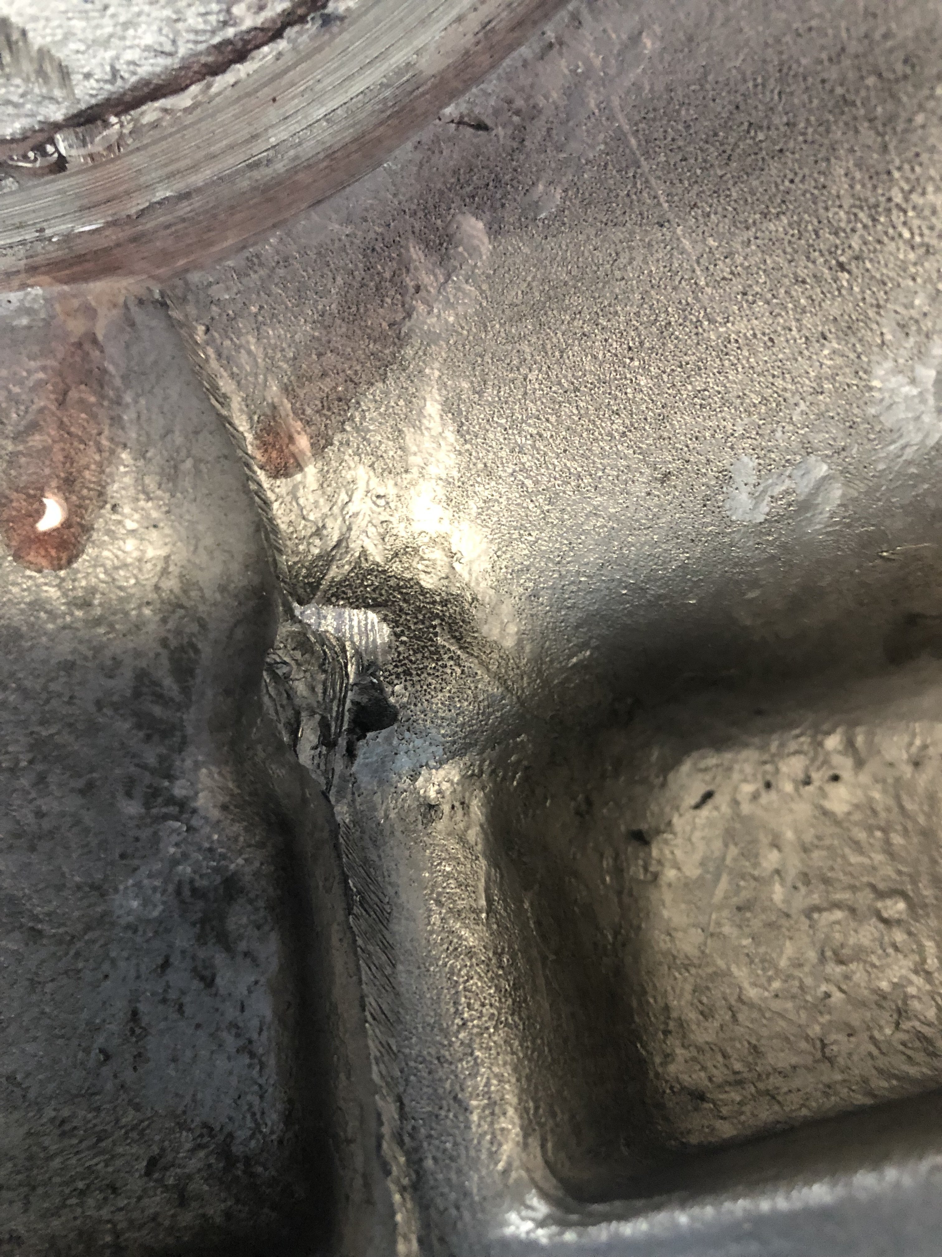

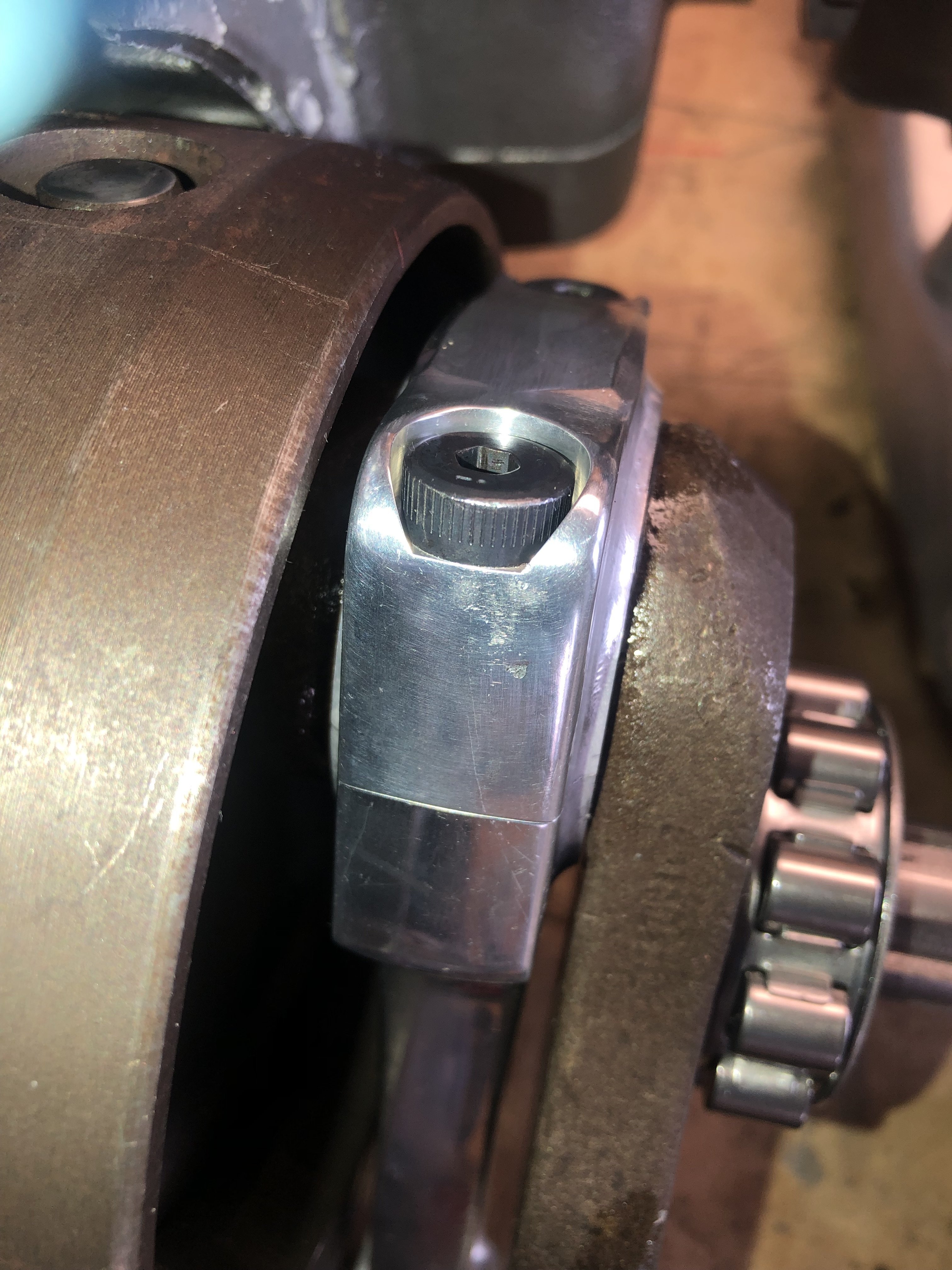

    In addition to my concern about the crank’s freedom of movement, I noticed that every once in awhile the left rod stuck slightly at the same place. It didn’t happen all the time but when it did it was at the same place. So when I loosed the case bolts quite a bit, then the crank ran freely and was able to rotate on it’s own when the rods were at the bottom of the stroke - very nice and smooth. However I still had that small hitch/glitch/check occasionally on the left rod right at the same place. It was when the big end of the rod was about 110 degrees from the top - so the big end is towards the bottom of the case. This was quite consistent, it didn’t always happen, but when it did it was in the same place. So I could not really have a clear conscience to not check this out. So I separated the cases and when I checked the left rod there was not problem with it’s rotation on the crank. So I noticed that the end of one of the left rod bolts seemed to have some abrasion, that is some of the black was off of the nut edge. I thought that maybe it was hitting the inside of the case somewhere. I also found a shiny spot on the inside of the case that seemed to align with where/when I thought the rod was sticking. My rod bolts are new from JRC, they were the same dimension as the old rod bolts. I spoke with a gentleman at JRC about the bolts and he sent them my way. So I got out my old bolts, and it looks like the edges on the top of the bolt(s) were ground down a bit and polished. I suppose someone may have done this before assembling. So at this point I may need to get my Dremel out and take a bit of the edge of these rod bolts off. While I just have them sticking at one point I should probably grind polish each of them because I wonder if when the engine heats up and expands there could potentially be more rubbing. Has anyone had experience with this sort of thing? Thanks!
  3. darkman
    7,641
    Even with the new L F Harris rods it sometimes necessary to remove a little from the L H case around the cam bushes.

    rather than mess with a dremel on the rod bolts, i would see whether you can solve the problem by removing a bit of metal from the cases, as darkman is suggesting. the integrity of those rod bolts is a lot more critical than a minor bit of aluminum on the cases.

    OK, thanks for the advice. Since the prior bolts had some material removed, I've gone ahead and polished a bit off on the bolts and case. If the tolerances were so close, I'd hate to think that would lead to some future bad event.

    your jrc rods are pretty large to start with. if you look closely you may find that your cases have been relieved a bit for them already
