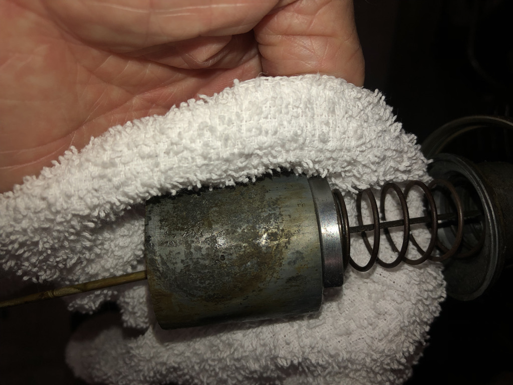

    Well, it looks like my Amals have some more problems that anticipated. The slides are corroded and would need to be replaced as there is a hole in one of them. So as I put together the parts list of rebuilding and repairing the Amals, versus getting some new Mikunis or Amals and I wonder if in the long run I'd be better off with something new. EDE0697E-979B-447C-B6B8-AF551CEF4973_1_105_c.jpeg
  5. darkman
    7,660
    I would replace them :)
  6. Iron
    Iron Guest
    Yep, agree, bin those

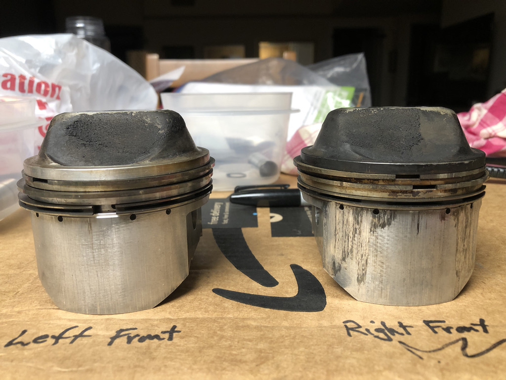

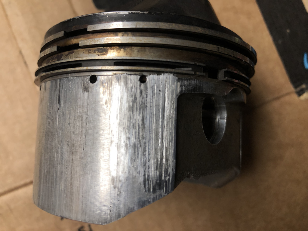

    I've made a bit of progress. Finally removed the head and cylinder. Found that the pistons are probably beyond help and the cylinder may need replacing as it seems to have already had a coupe of overbores, the pistons revealing 060 on their domes. So now I believe I will need a new cylinder, pistons, etc. I've been looking at the Morgo 750 as well as what they have on M.A.P. cycles. Additionally I am considering whether or not to redo the head myself or send it out for a rebuilding since that is a critical part and I've little experience with installing valve guides and valves, etc. Any comments are appreciated on replacing the cylinder as well as any other items. I will continue to take the engine apart and examine other parts for damage, like rods, etc. Thanks.

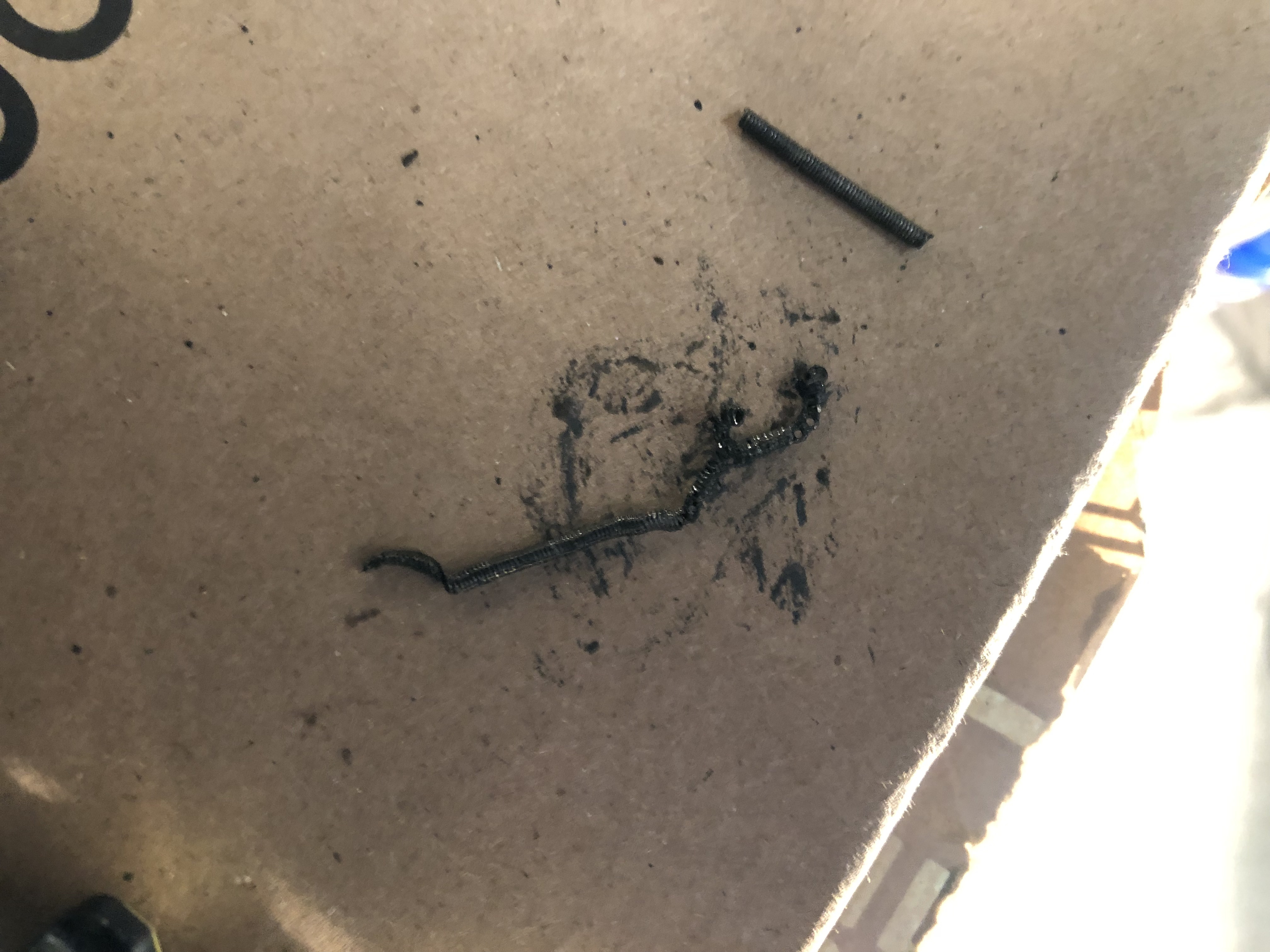

    So I made some progress on my engine tear down on the primary side. I got stopped when I tried to take the rotor off the crankshaft. I don’t have a 2-jaw puller and it did not come off on its own - so I’ll have to get the 2-jaw puller soon to get the primary chain off. I found some parts of very tiny springs in the oily bottom of the primary case. I’m wondering if any of you might know what these could be and what kinds of problems this might indicate with the engine? Thanks.
  18. darkman
    7,660
    Good to see it coming apart and as for the springy thing my only thoughts are someone might have used an old speedo cable outer as a chain oiler pipe instead of the correct plastic pipe.

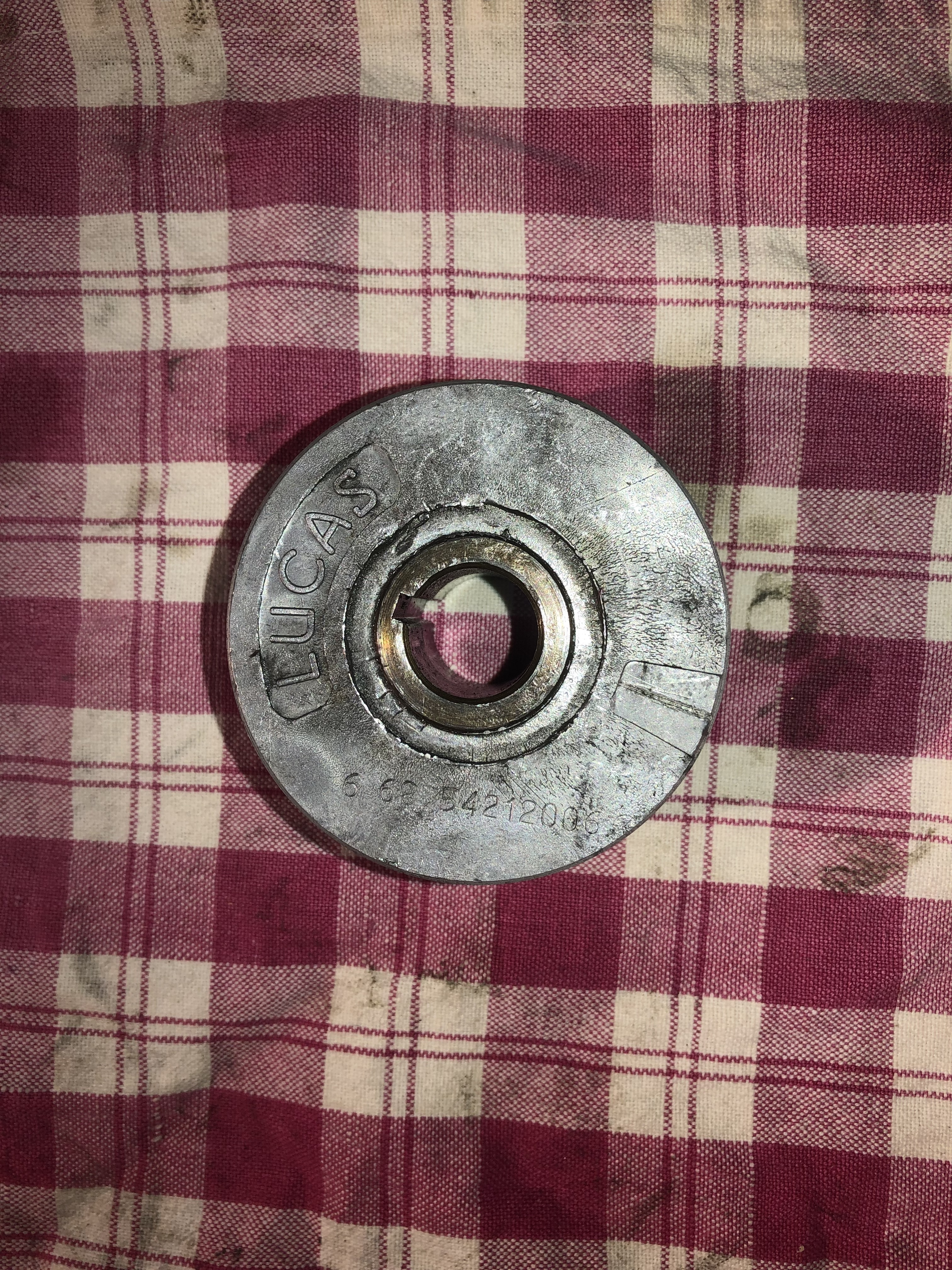

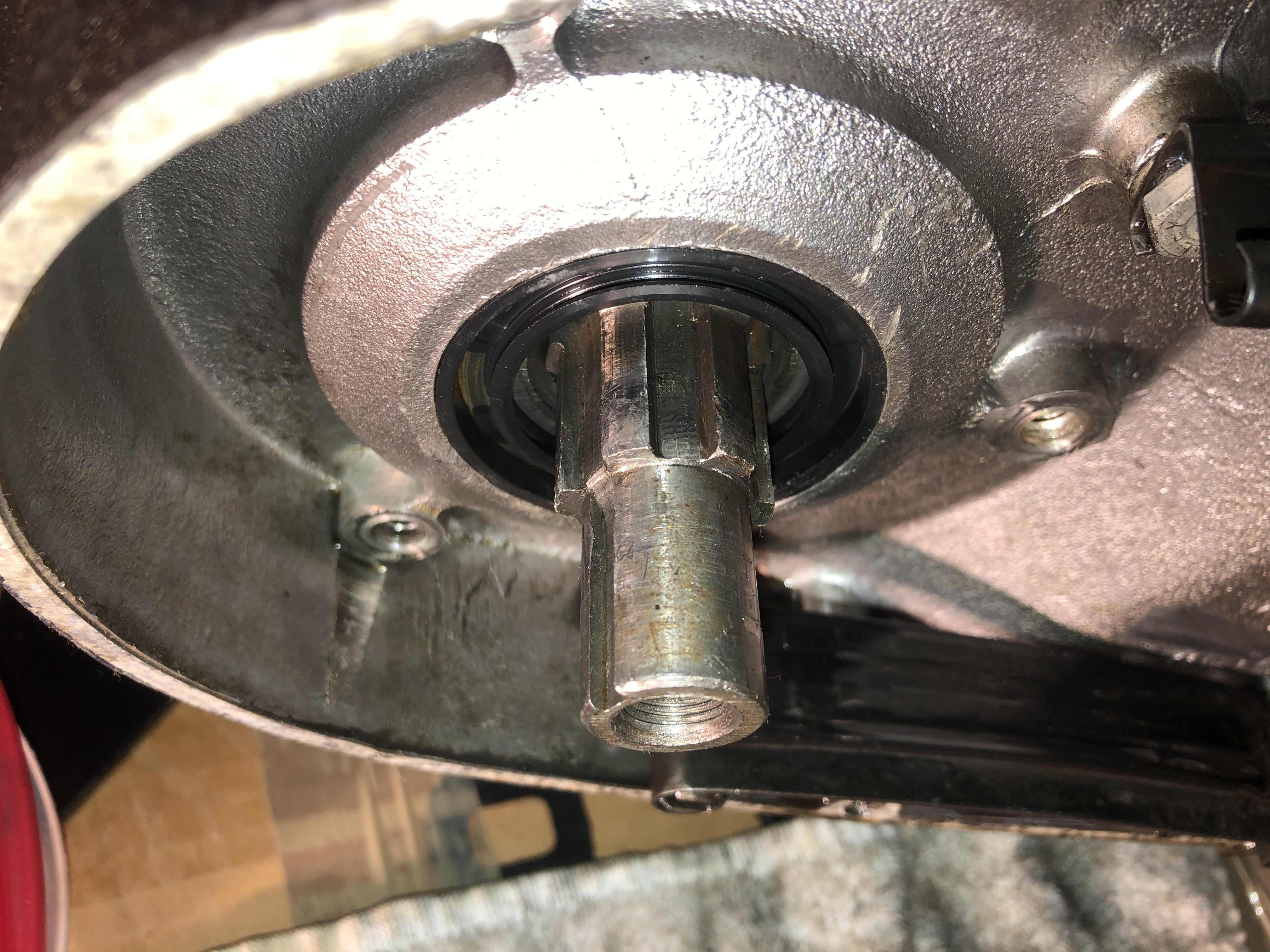

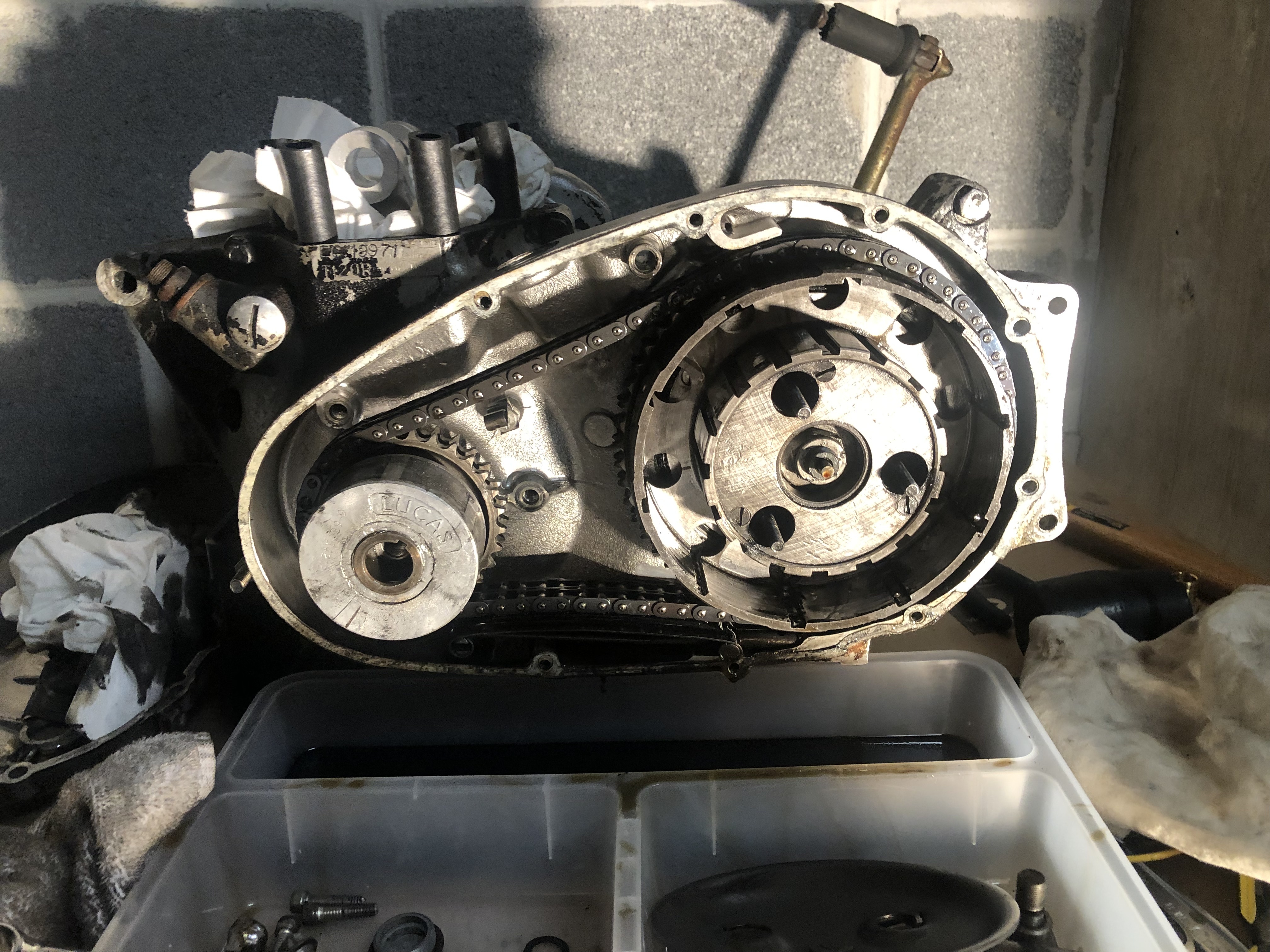

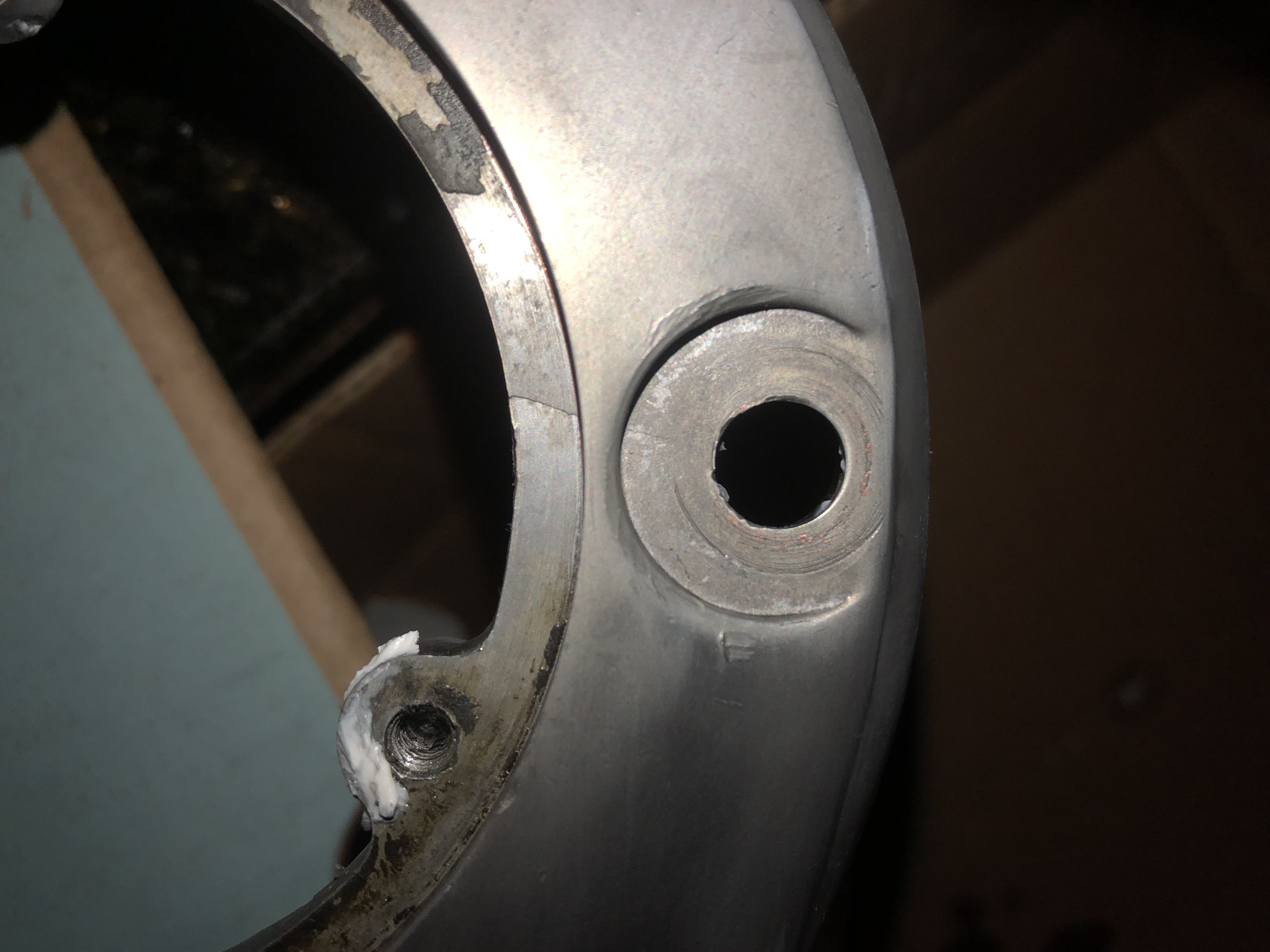

    The last few days I made some more progress on my tear down. I’ve got the primary side off as well as the timing and transmission. I was initially stalled by the rotor, but was able to get a 3 jaw puller to get it off.

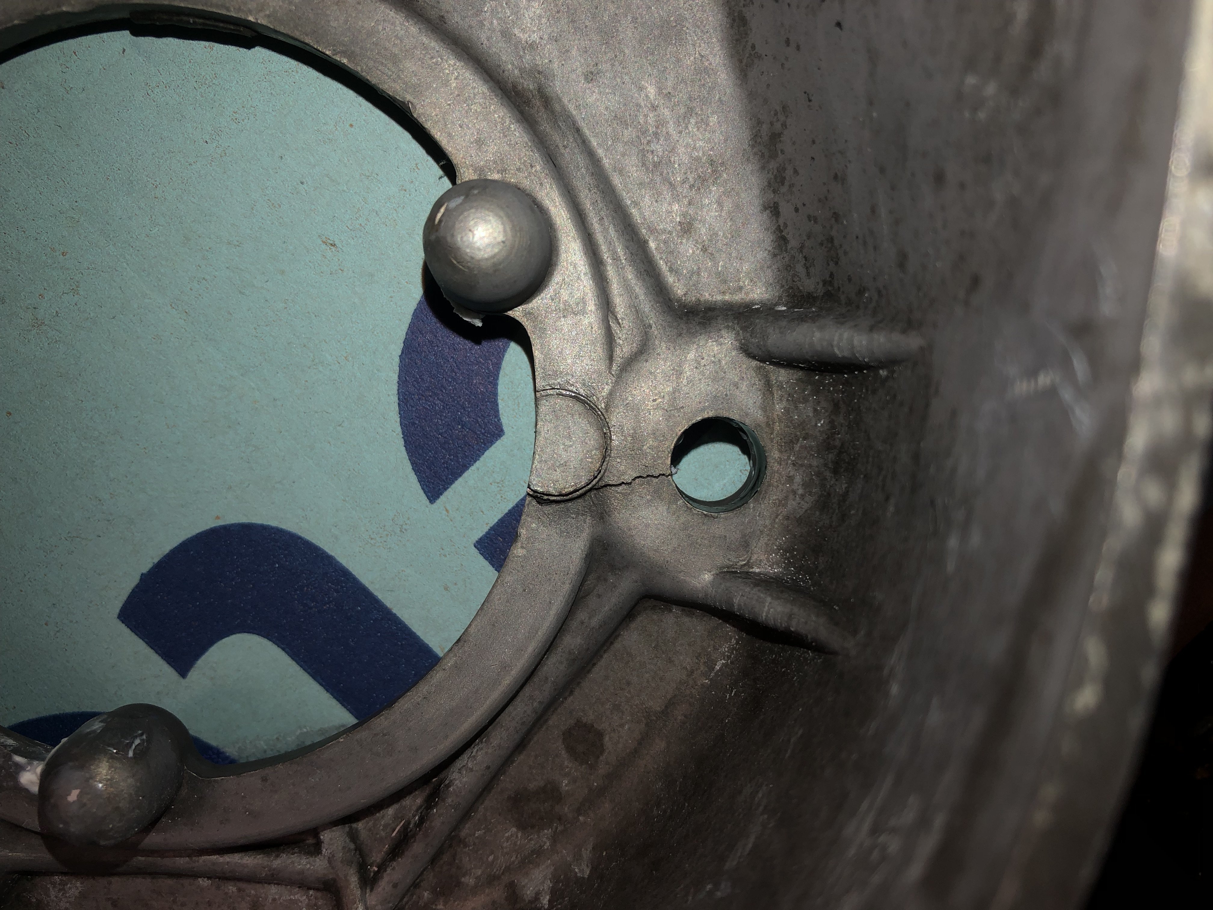

    I noticed a small crack in the primary cover, it doesn’t go all the way through - wondering if this looks of or should I have it fixed?
    The crank end on the primary side was hard coming off, it seems the reason might be that the end was a bit bunged up. The primary chain tensioner didn’t appear to have much wear - so perhaps it had been adjusted properly and is still in good shape? The drive sprocket seems to have some wear. Whoever build this before used a lot of goop on top of gaskets!
    I had some difficulty getting the advance off as the interior threads would not take my puller. Looking closely it seems they have been damaged, so this should probably be replaced.
