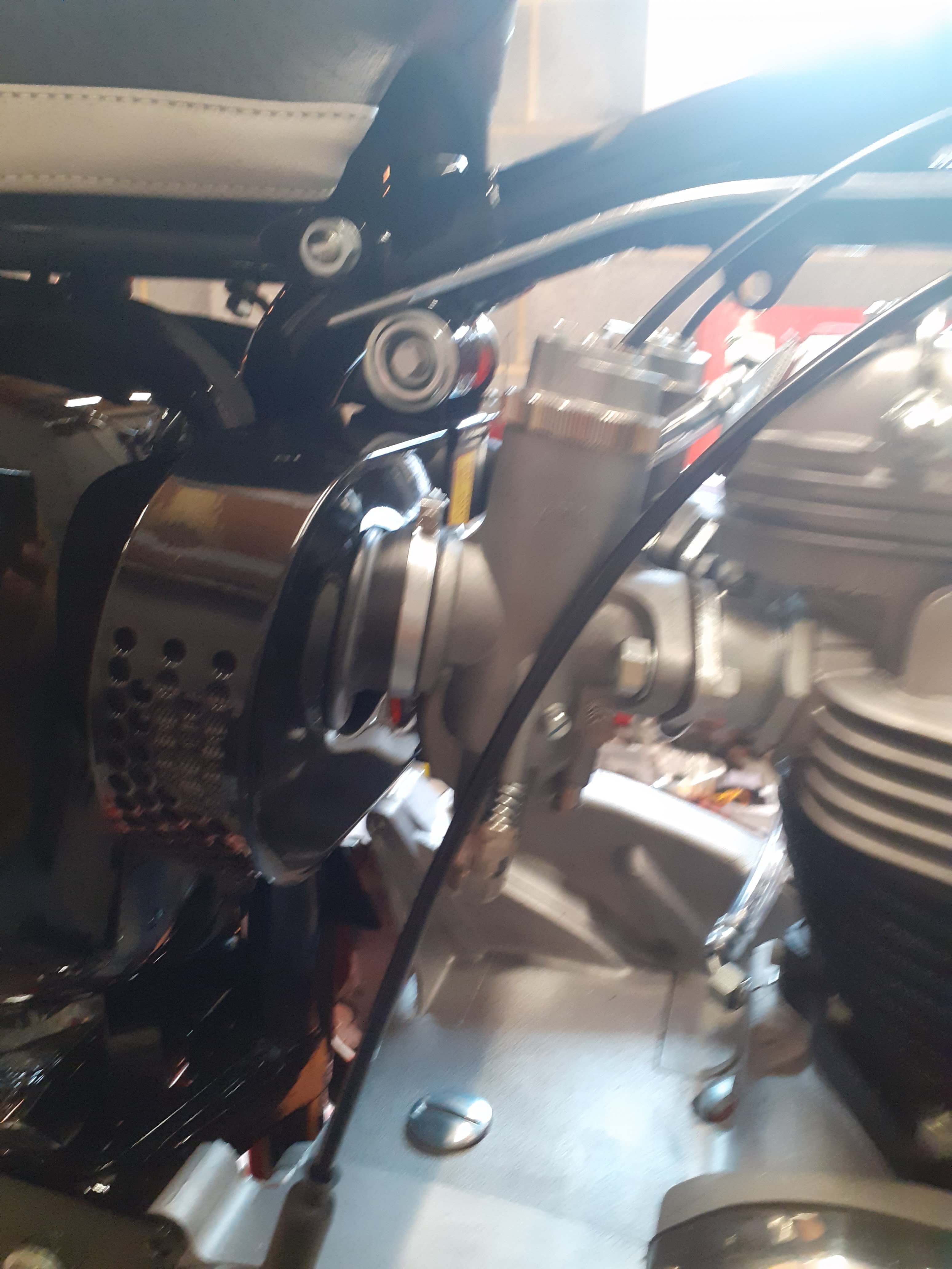

    Just little jobs today, fitted the correct BSF nuts n bolts to the front mudguard stays as i had temp used some later UNF ones i had and finally got the one piece or uni filter to line up correctly. 20191227_115107.jpg

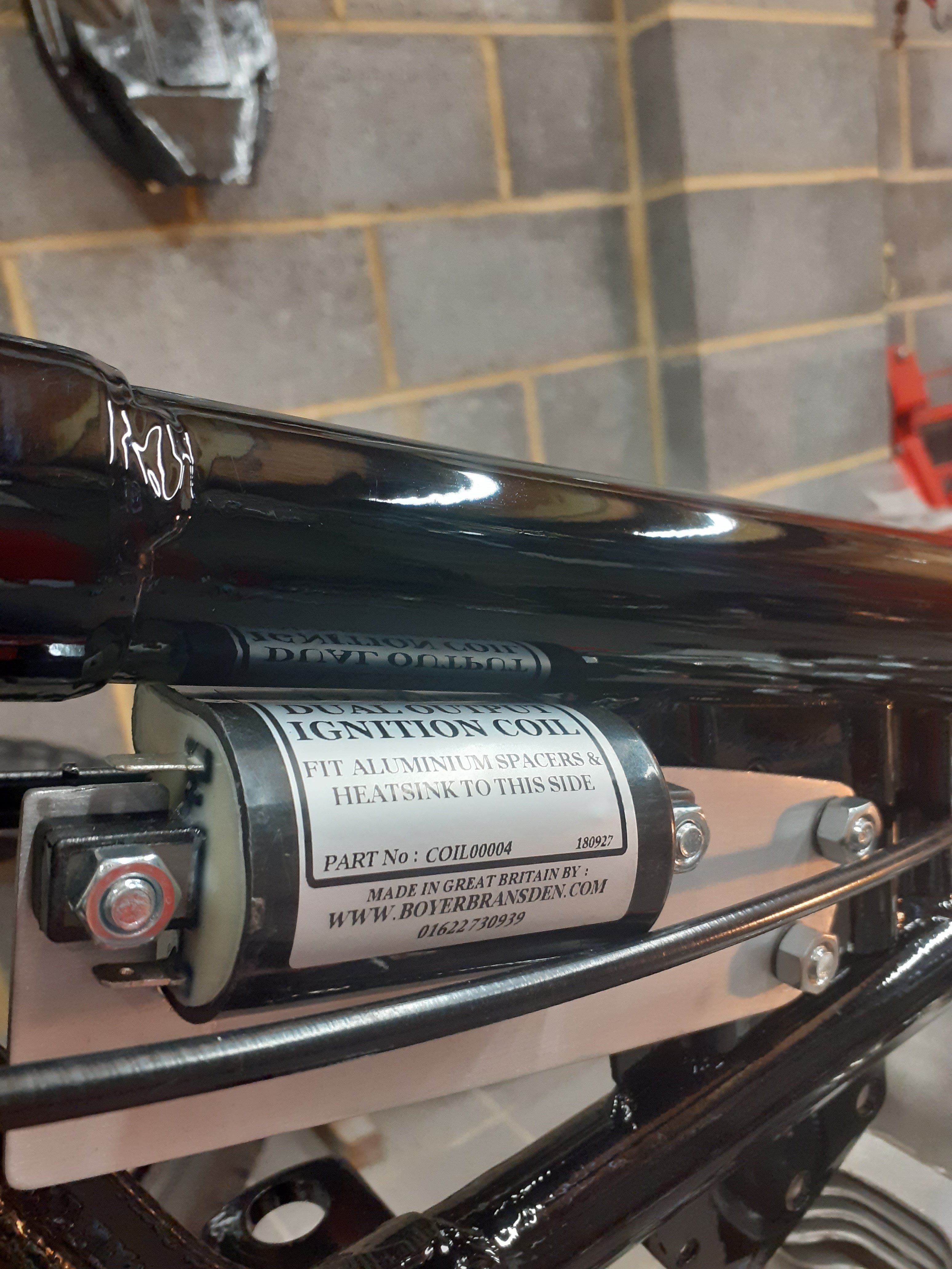

    A little more progres today, fabricated a heatsink/mount for the Boyer twinspark. Just the electrics to go now.

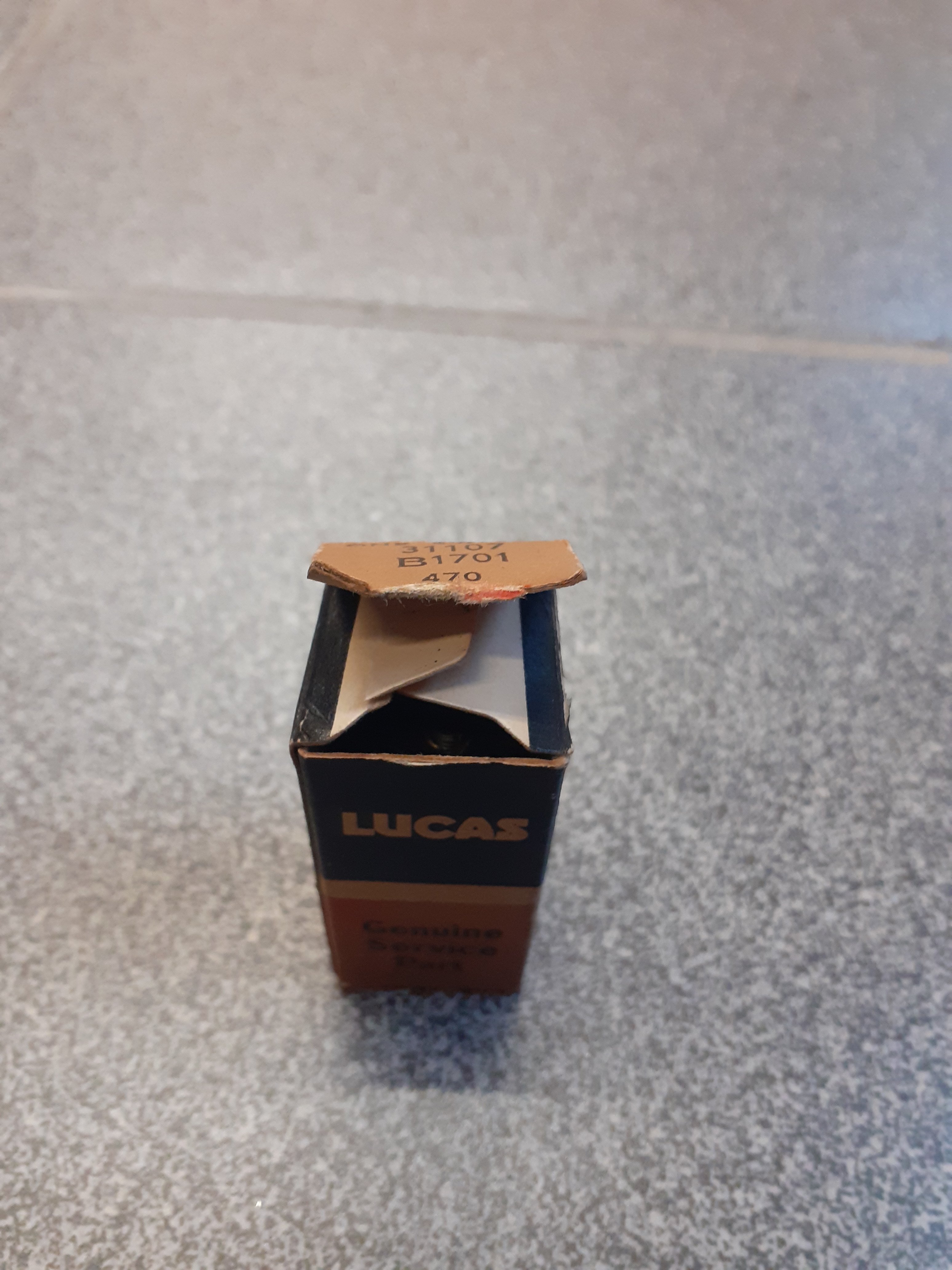

    Just small jobs to do now, fitted new brake shoes to the rebuilt and painted rear brake plate. Fitted a small horn inside the toolbox out of sight ready for making the wiring loom and fitted the NOS Lucas kill switch that i will use as the horn button as i have a hidden kill switch.

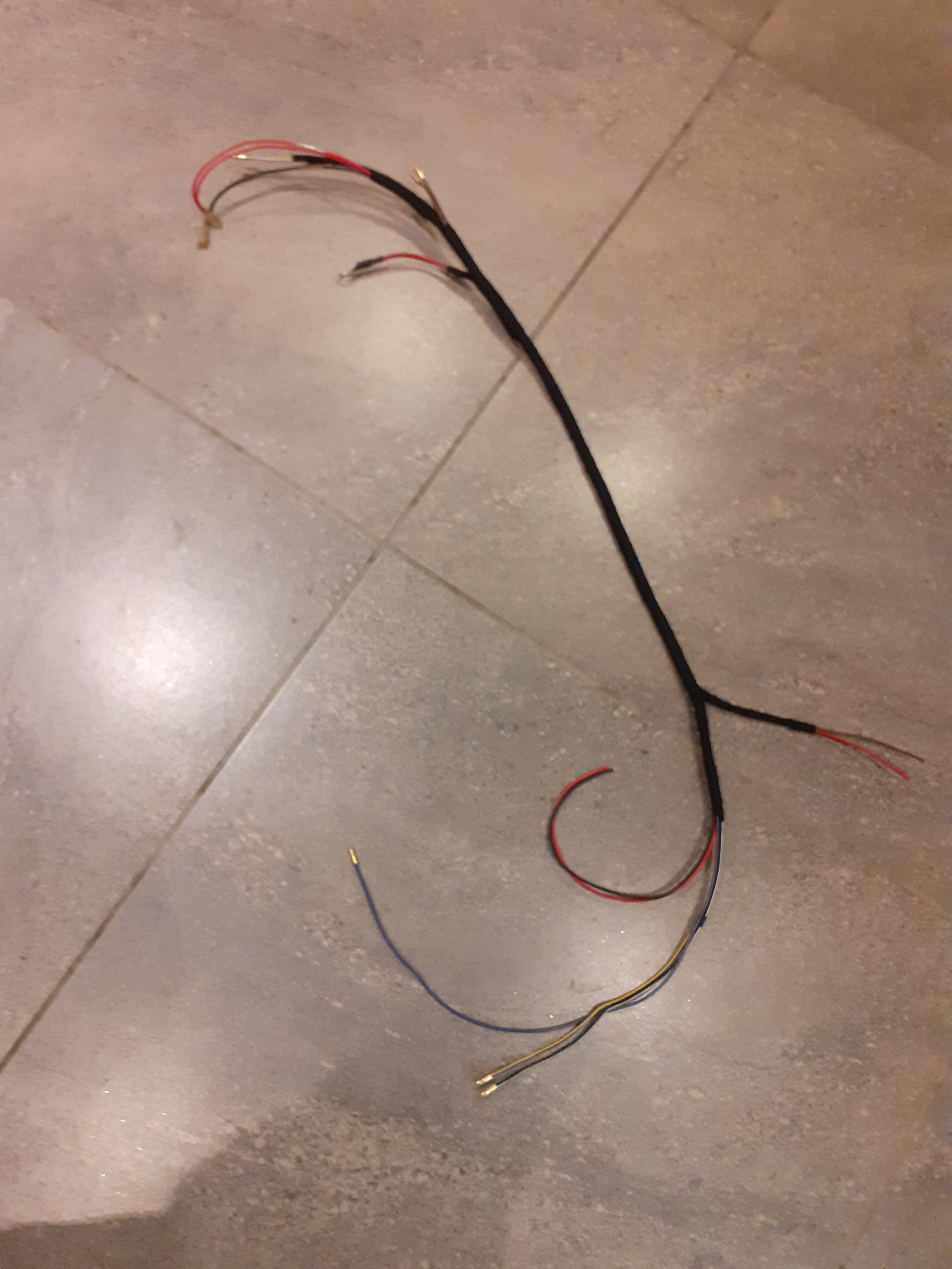

    Made Up the one off wiring loom today :)

    You gotta love those old bikes, just enough wiring to do the job. Haven't seen those connectors for years top job

    Thanks DD, i have started doing some small private work now. Mostly i have paint servicing and engine work lined up and will post some of that work as i do it. As for what i thought was the correct colour button a little more reading of service books and some help from Alan revealed that the TT model should have a black button and the T120 with a battery has the brown button but i will stick with the NOS brown Lucas as its for the horn.
