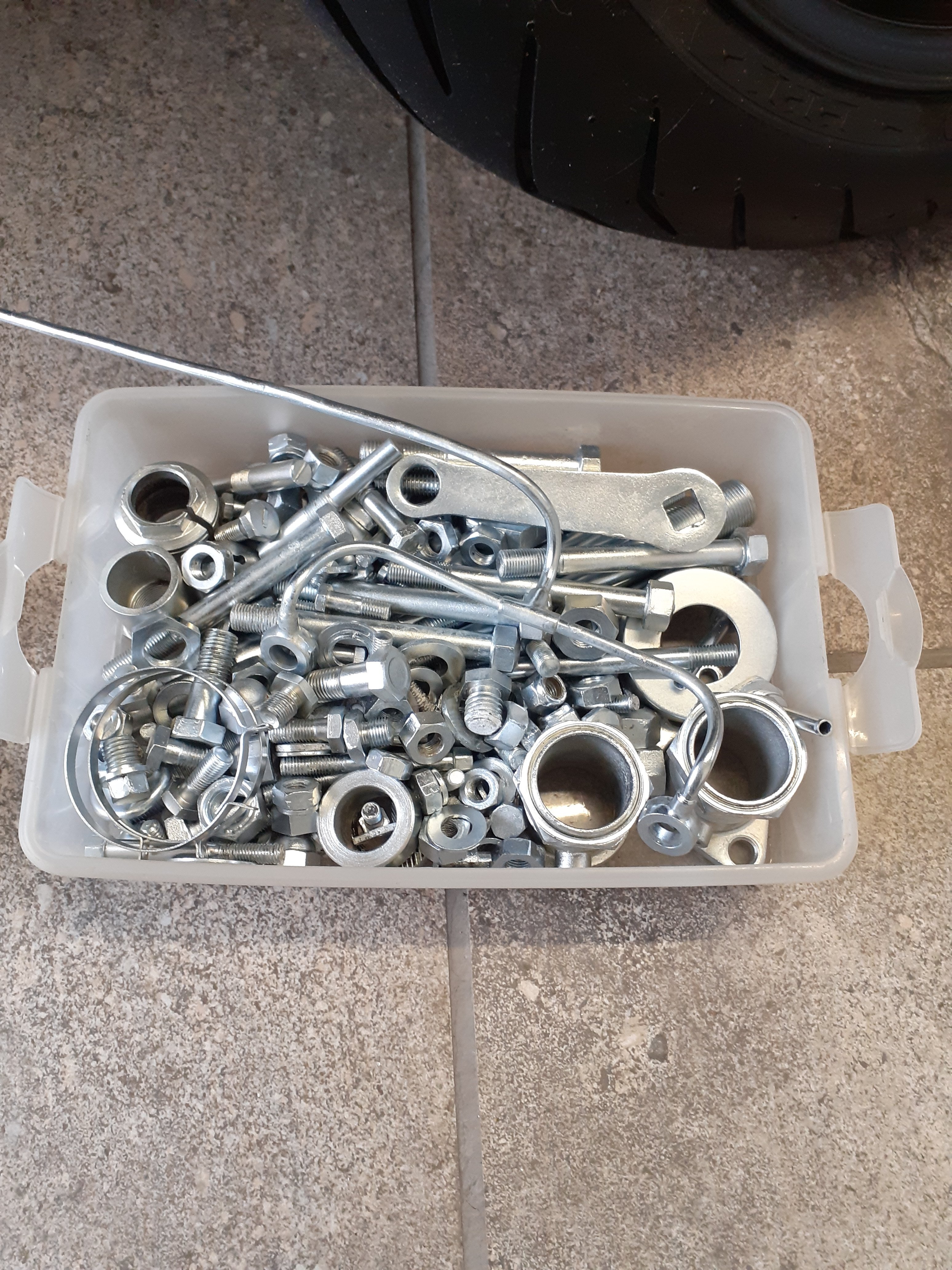

    At last the fitting have been plated and also the last few chrome parts done, now i can start the final build :)

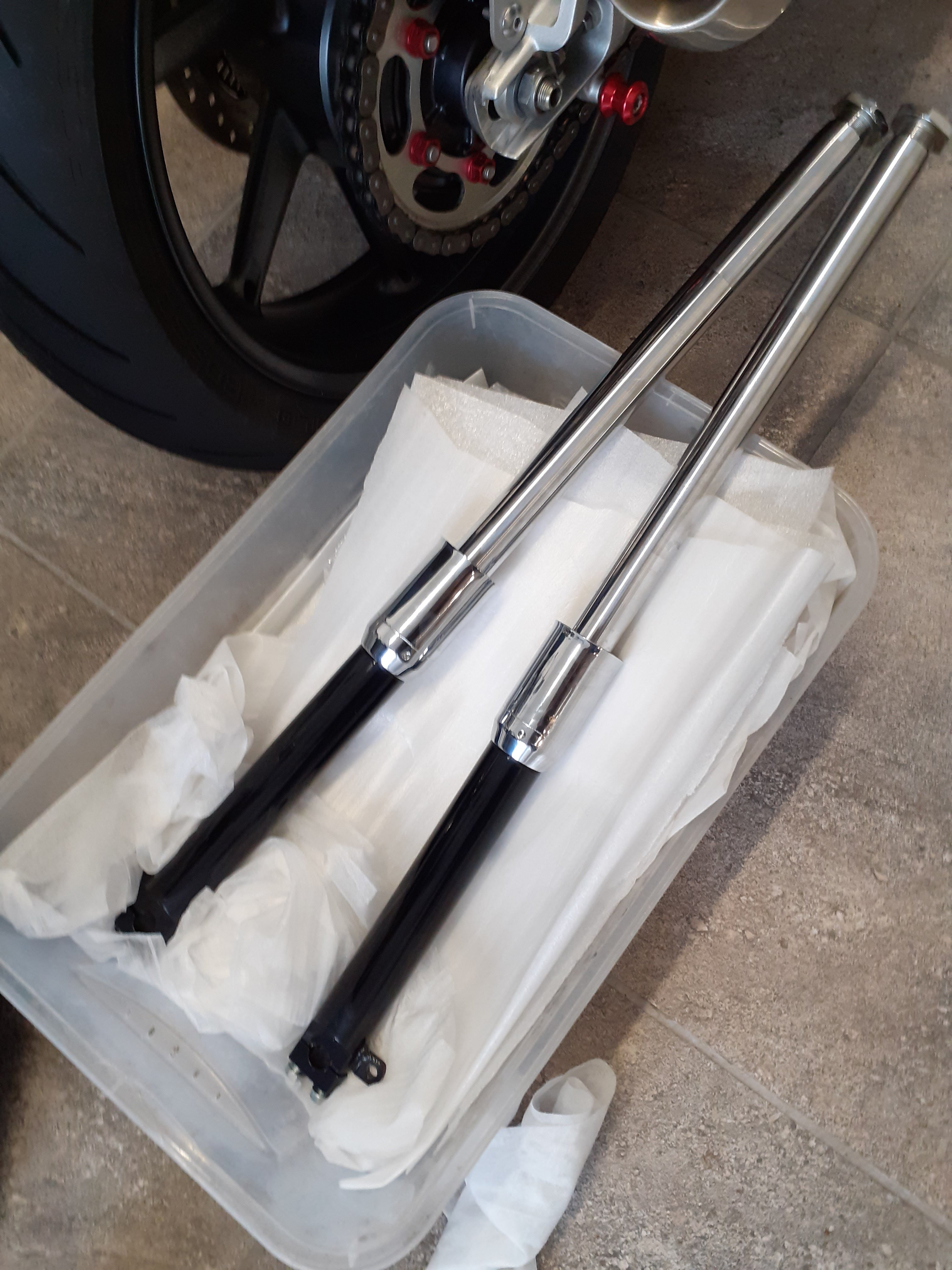

  7. darkman
    7,639
    Todays little job was to rebuild the painted fork lowers with all new bushes stanchions and seals, i hope to fit them tomorrow along with some other jobs.

  9. darkman
    7,639
    Slow progres today but fitted the rebuilt fork legs into the yokes and then released i had a missing spacer so couldn't do the front hub, so fitted the bearings to the rear hub.

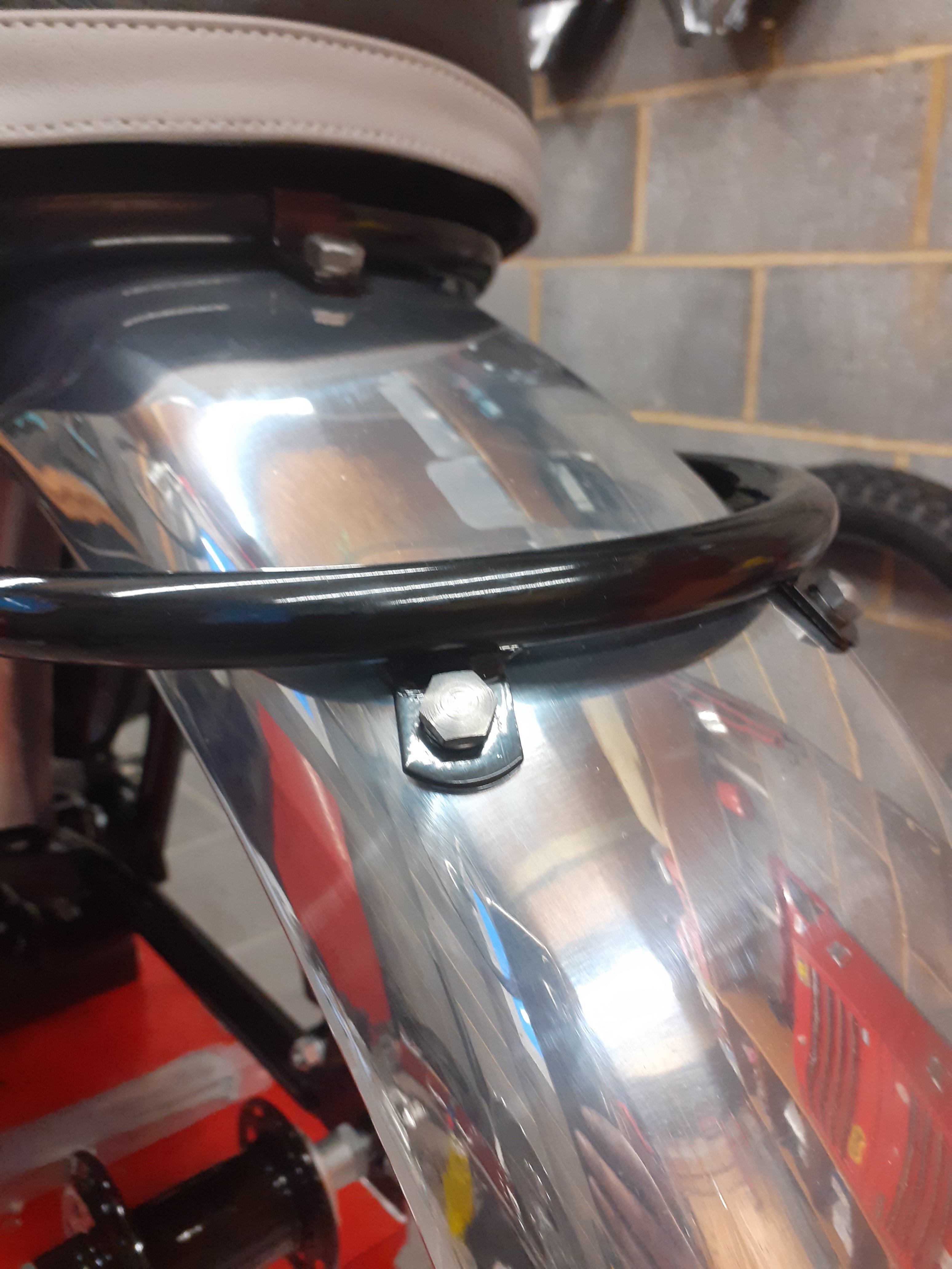

  12. darkman
    7,639
    Front hub bearings done and brake plate polished, both mudguards have had a final polish and fitted.

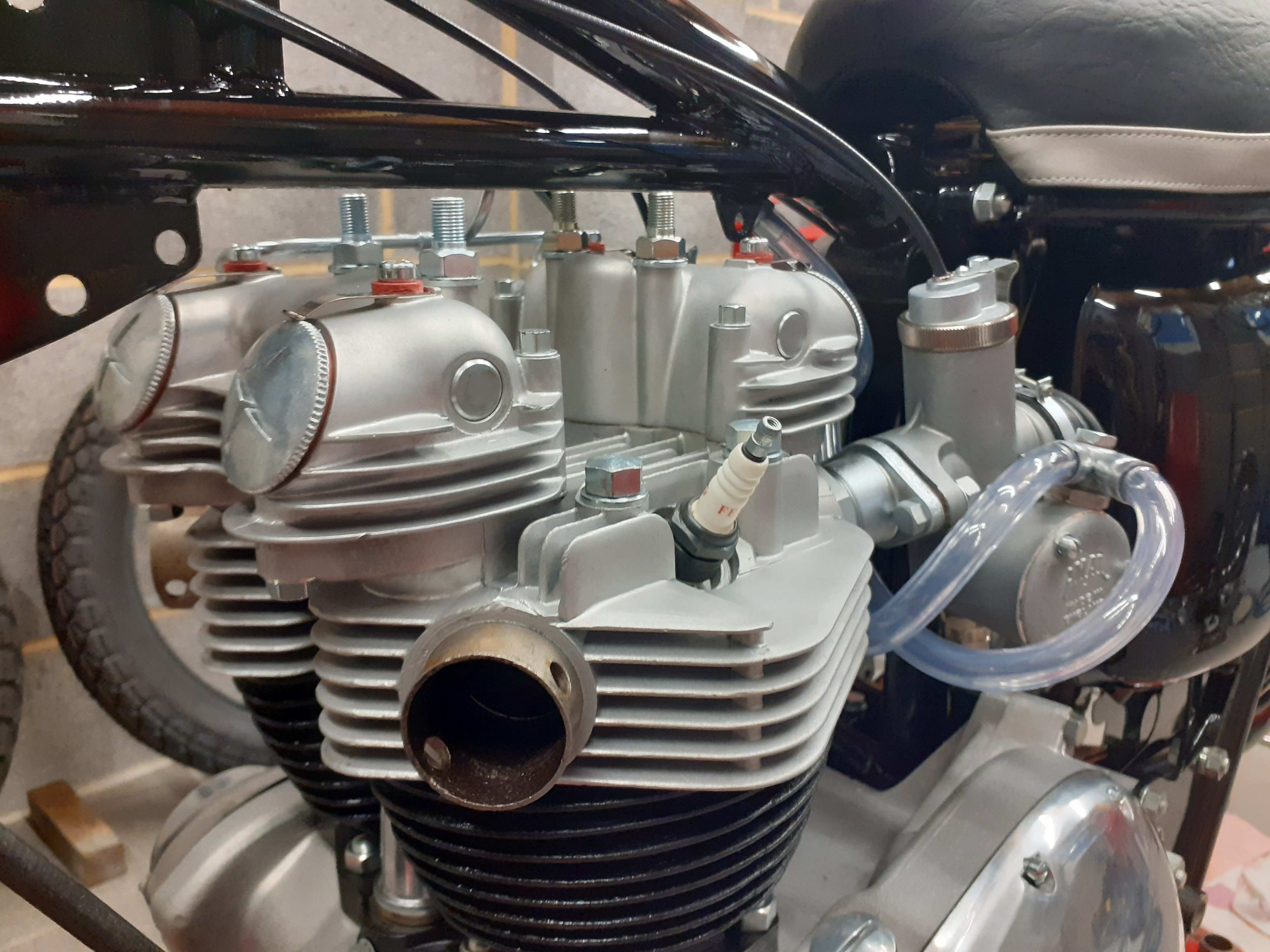

  18. darkman
    7,639
    At last i have sorted the push rod tubes and new rods, rebuilt the rocker boxes and finished off fitting the head and carburetors.
