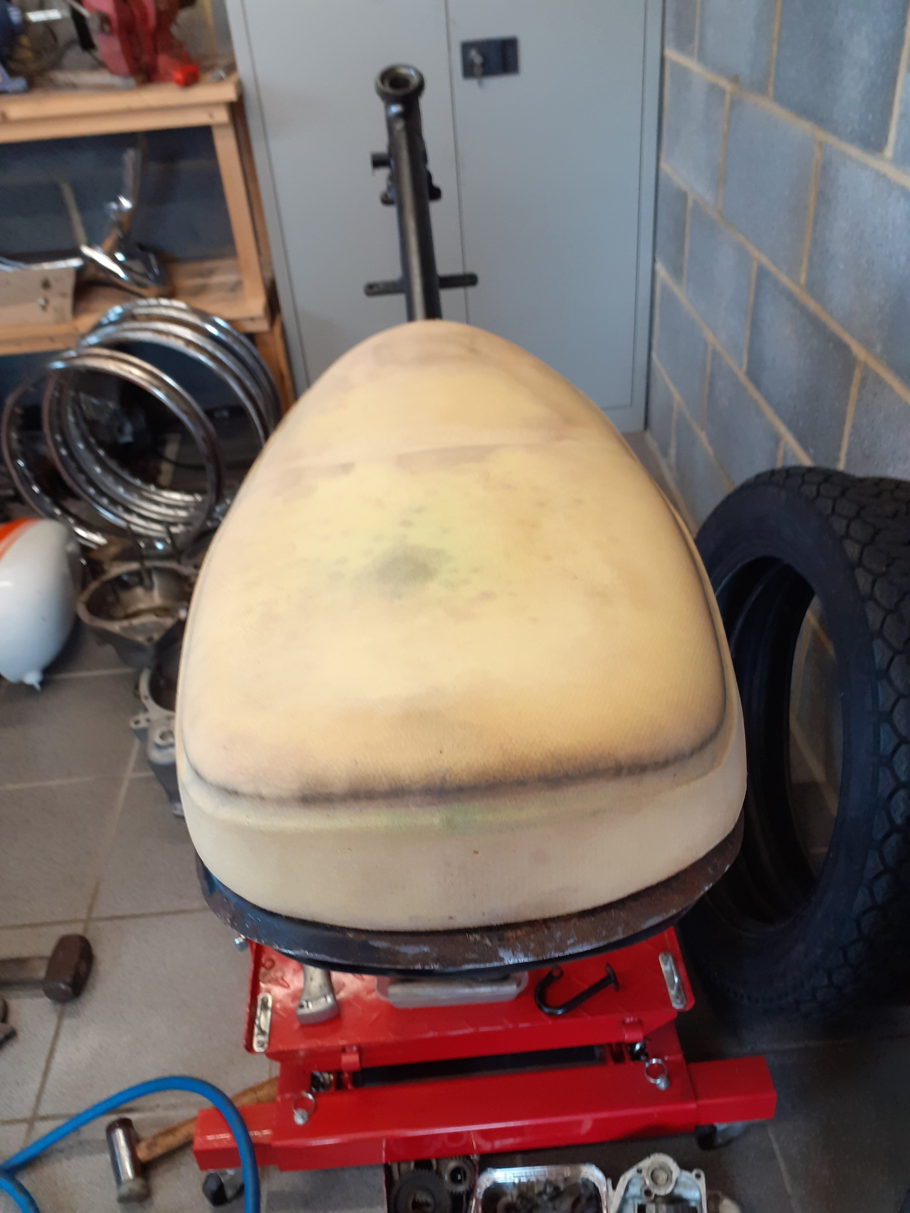

  4. darkman
    7,568

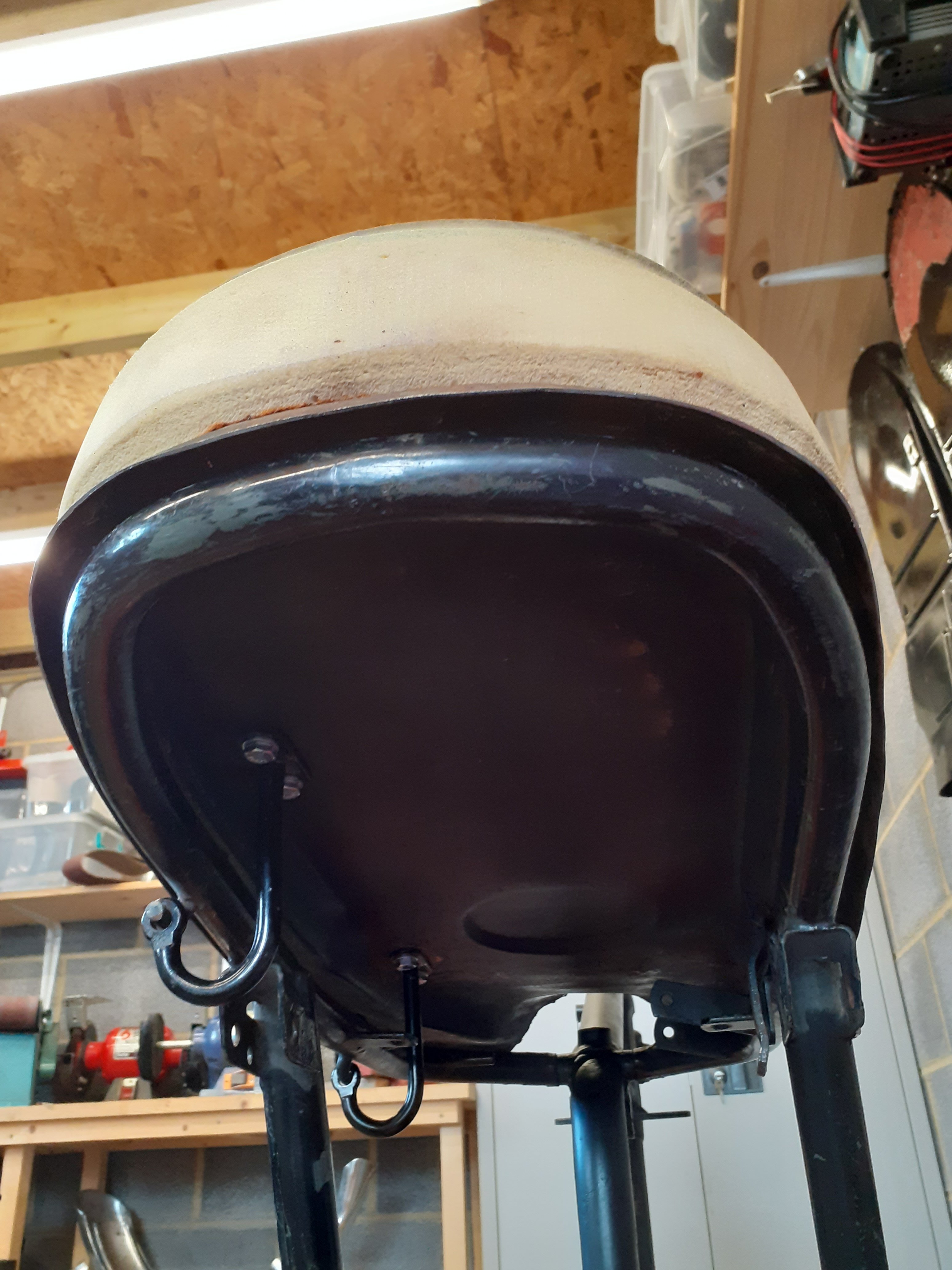

    Today i have stripped some wheels so i can send off the original rims and all the other parts for chroming, repaired and reshaped the seat base to work with the NOS hinges and an original S/H seat sponge :)

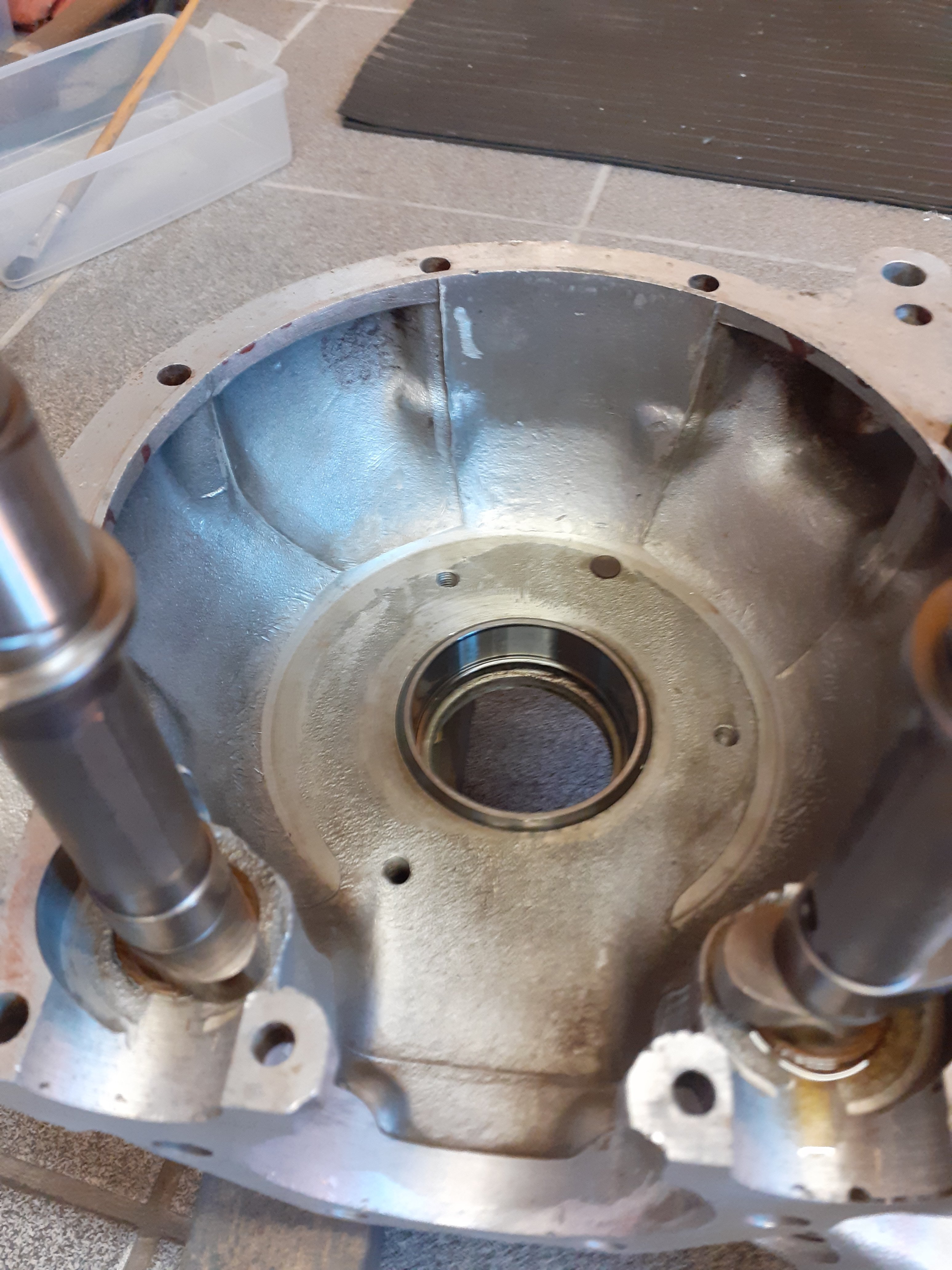

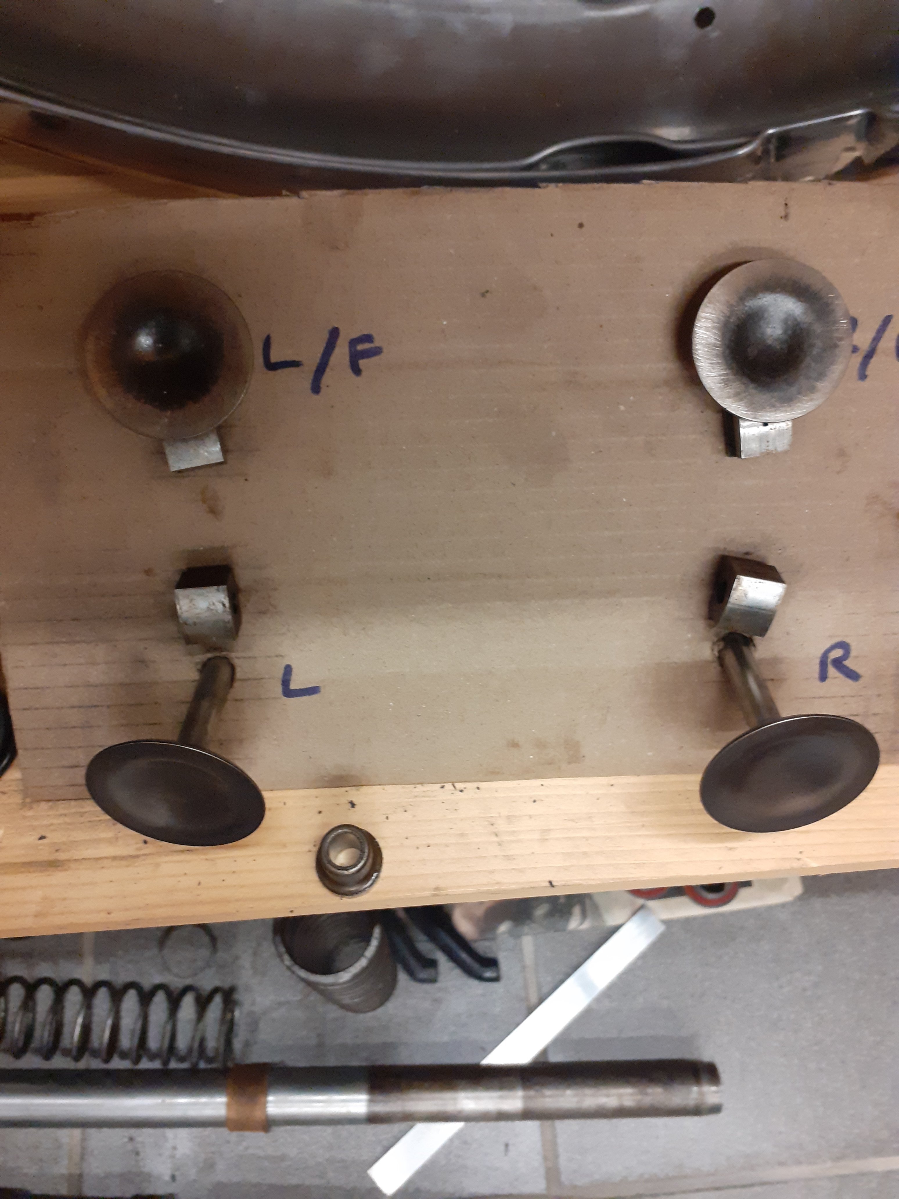

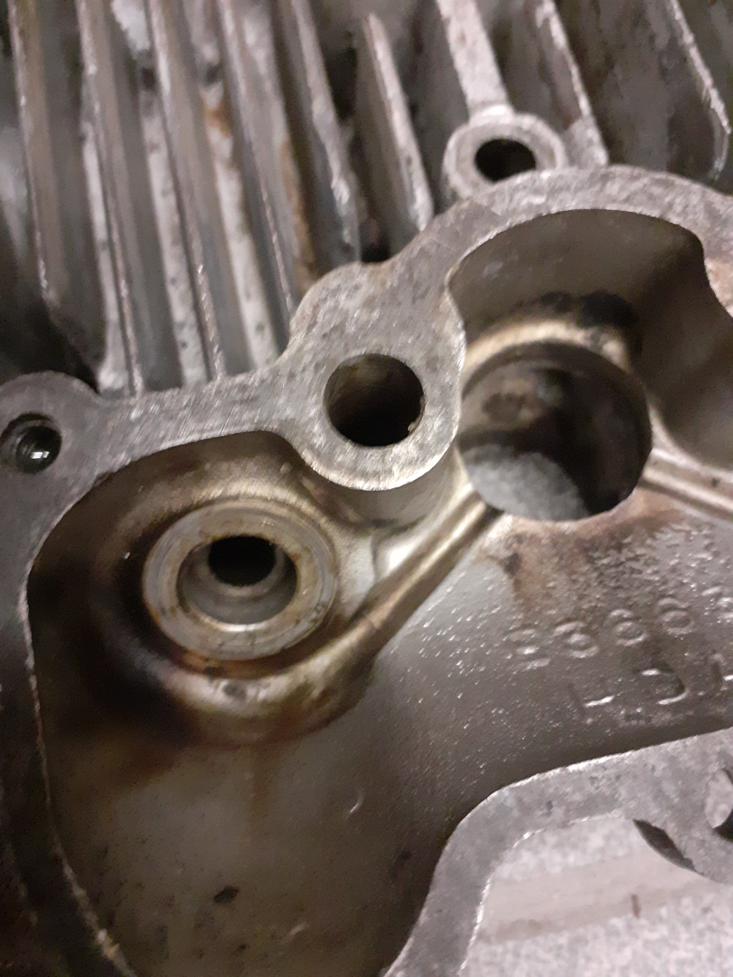

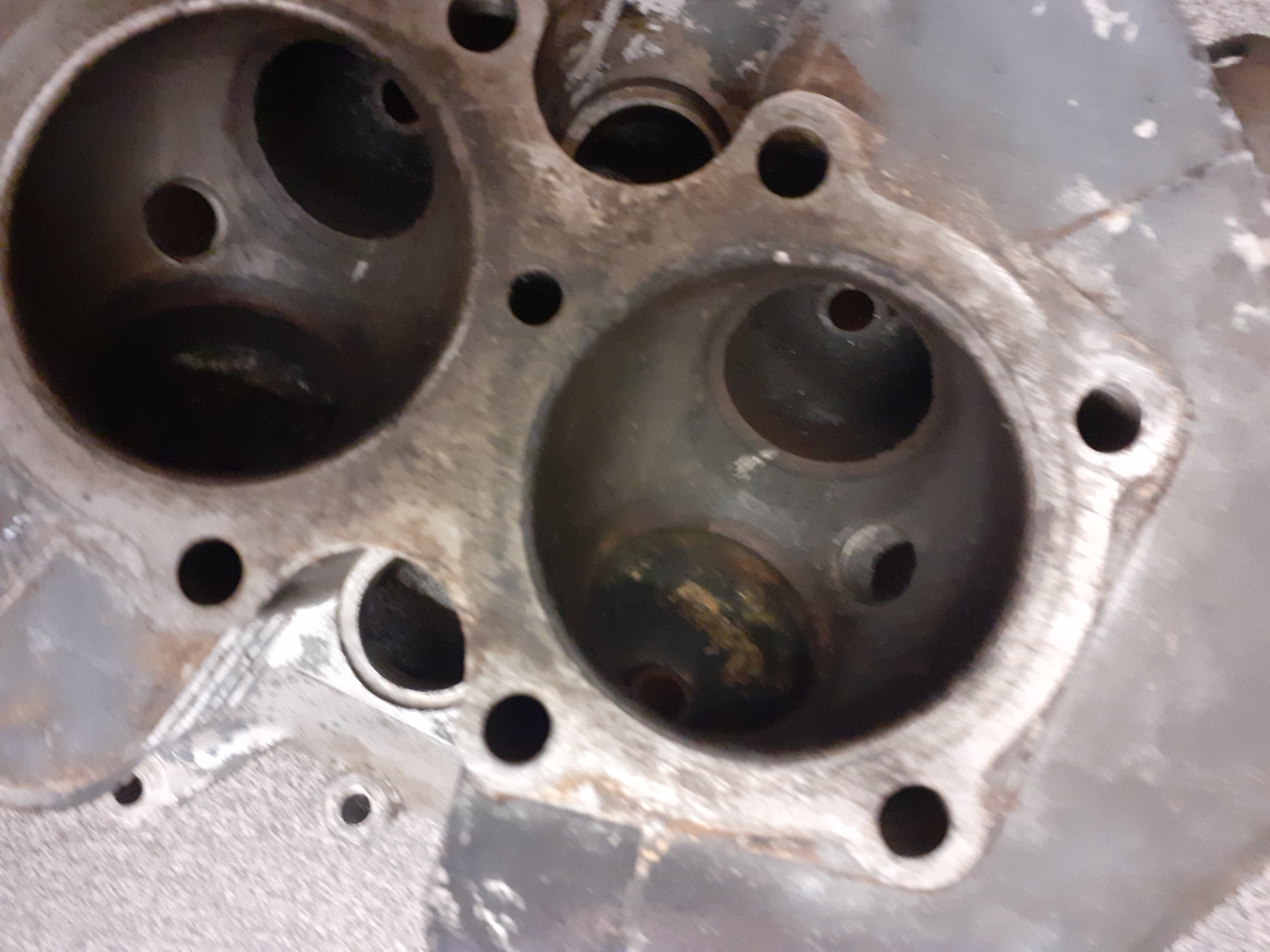

    Managed to get the crankcases welded where the rear chain had beaten its way through and striped the head only to find a broken valve guide :-( new guides on order and more pics to follow.
  9. darkman
    7,568

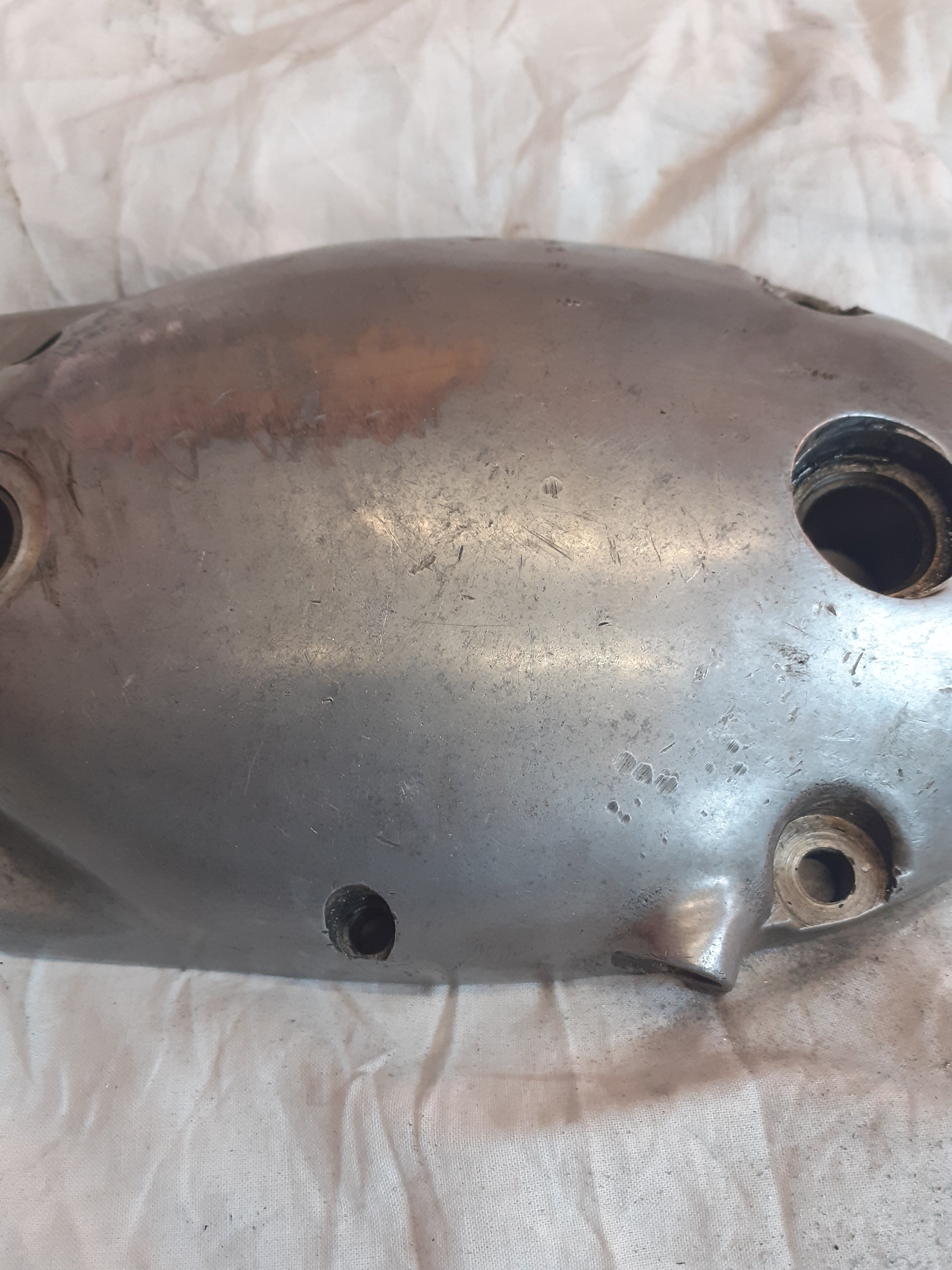

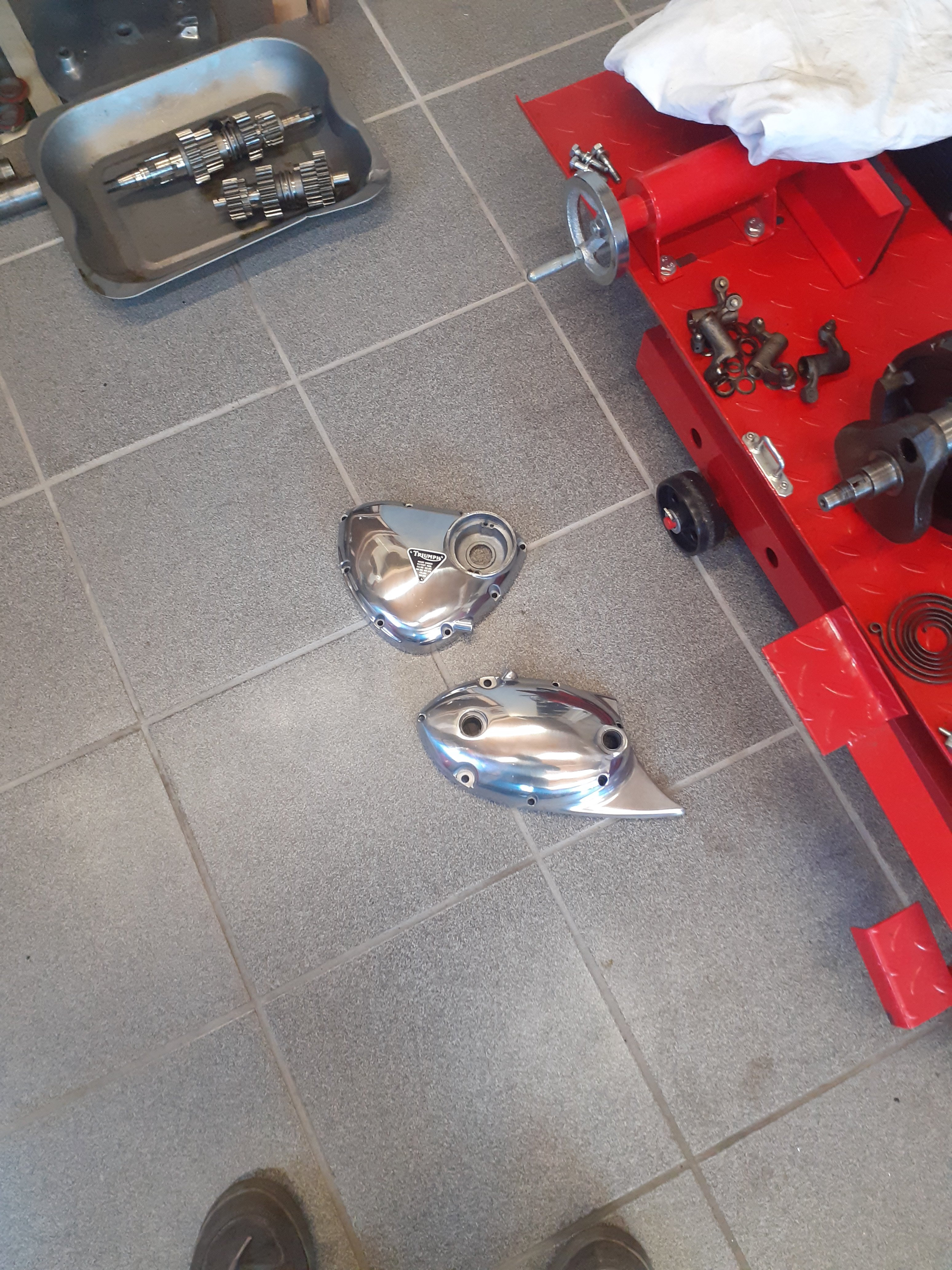

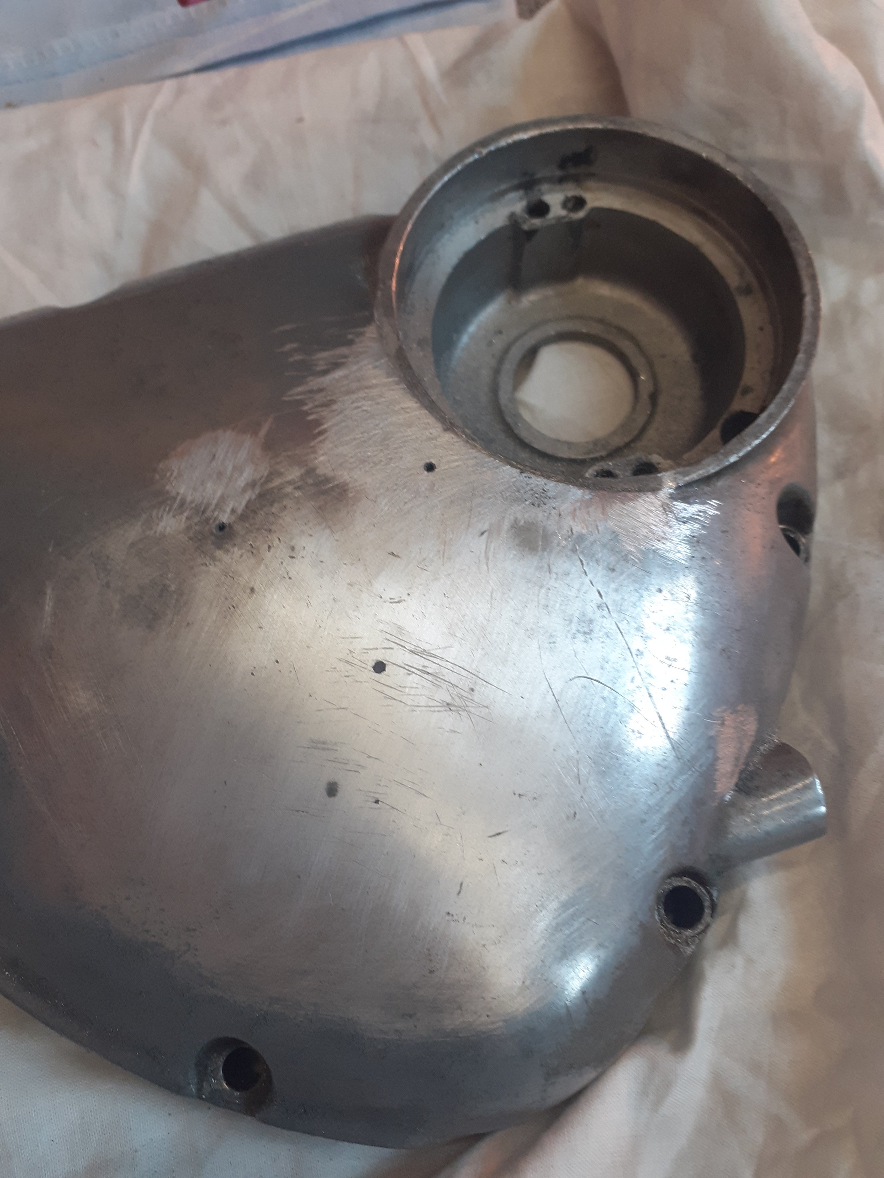

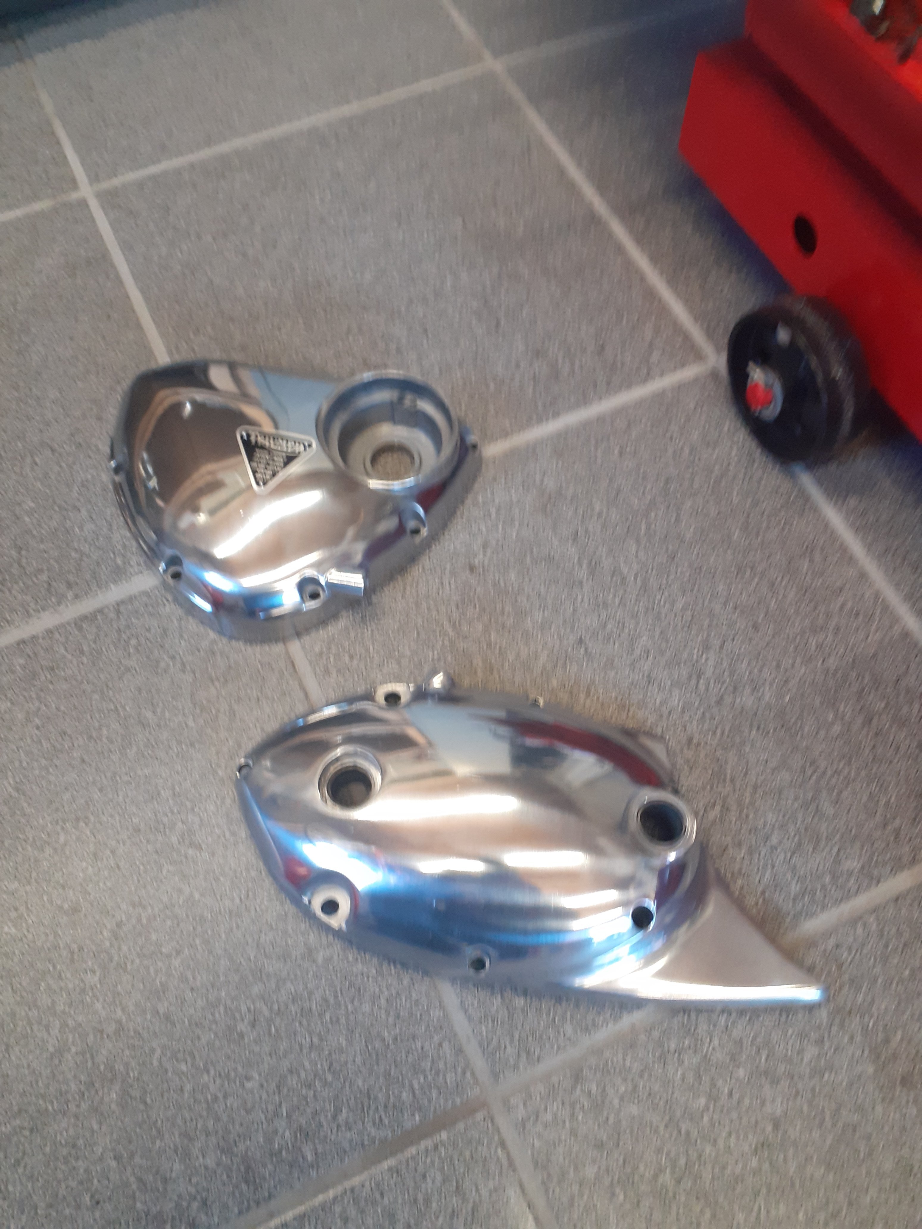

    Dirty work time, its wet n cold today and i got a sweat on preparing these 66 cases lol polishing next.
  10. NightRider
    NightRider Member
    Aug 11, 2019
    47
    Europe
    One more piece in the current project prepared! :)

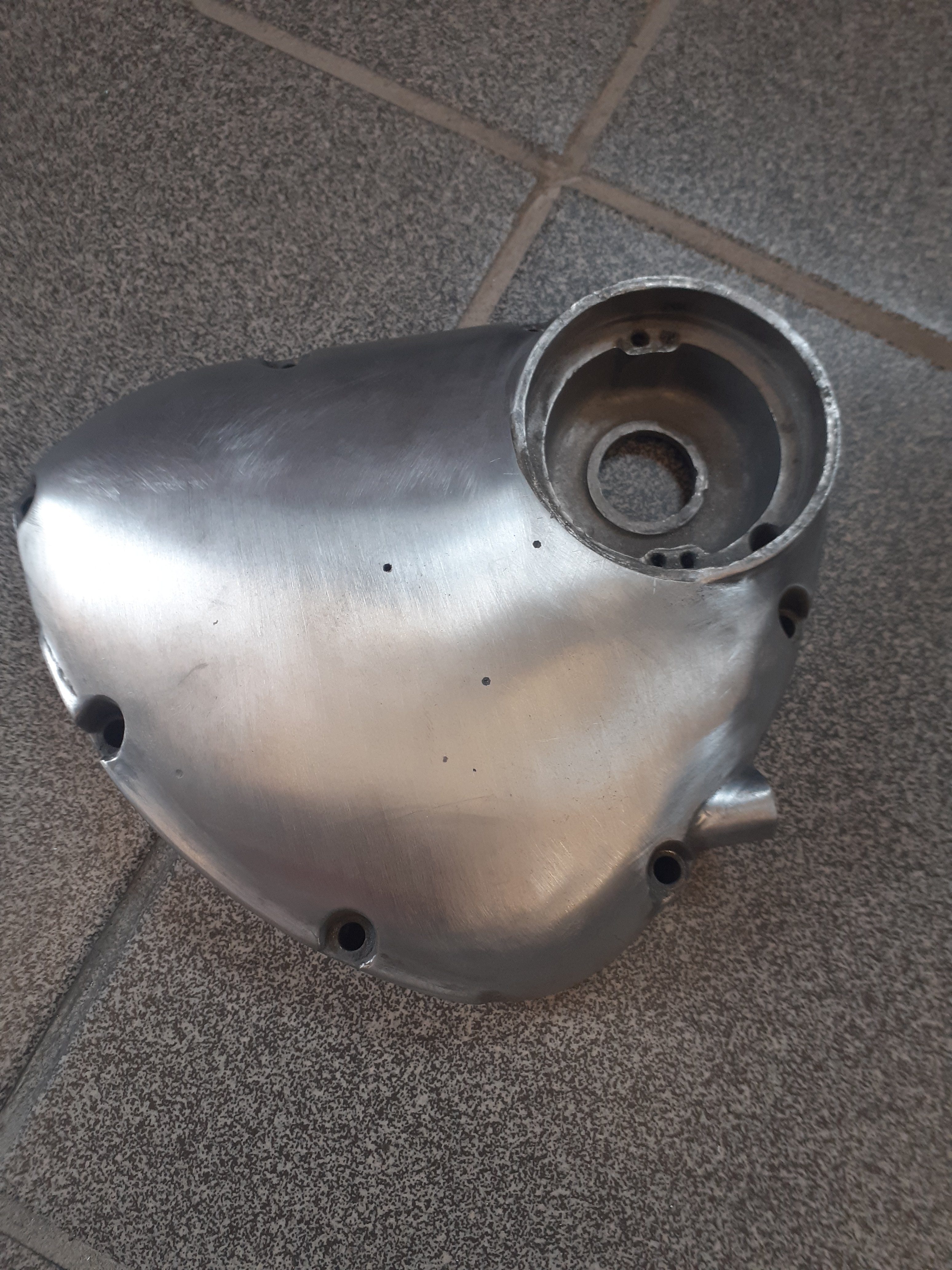

  11. darkman
    7,568
    Finished off polishing this afternoon and ready to go :)

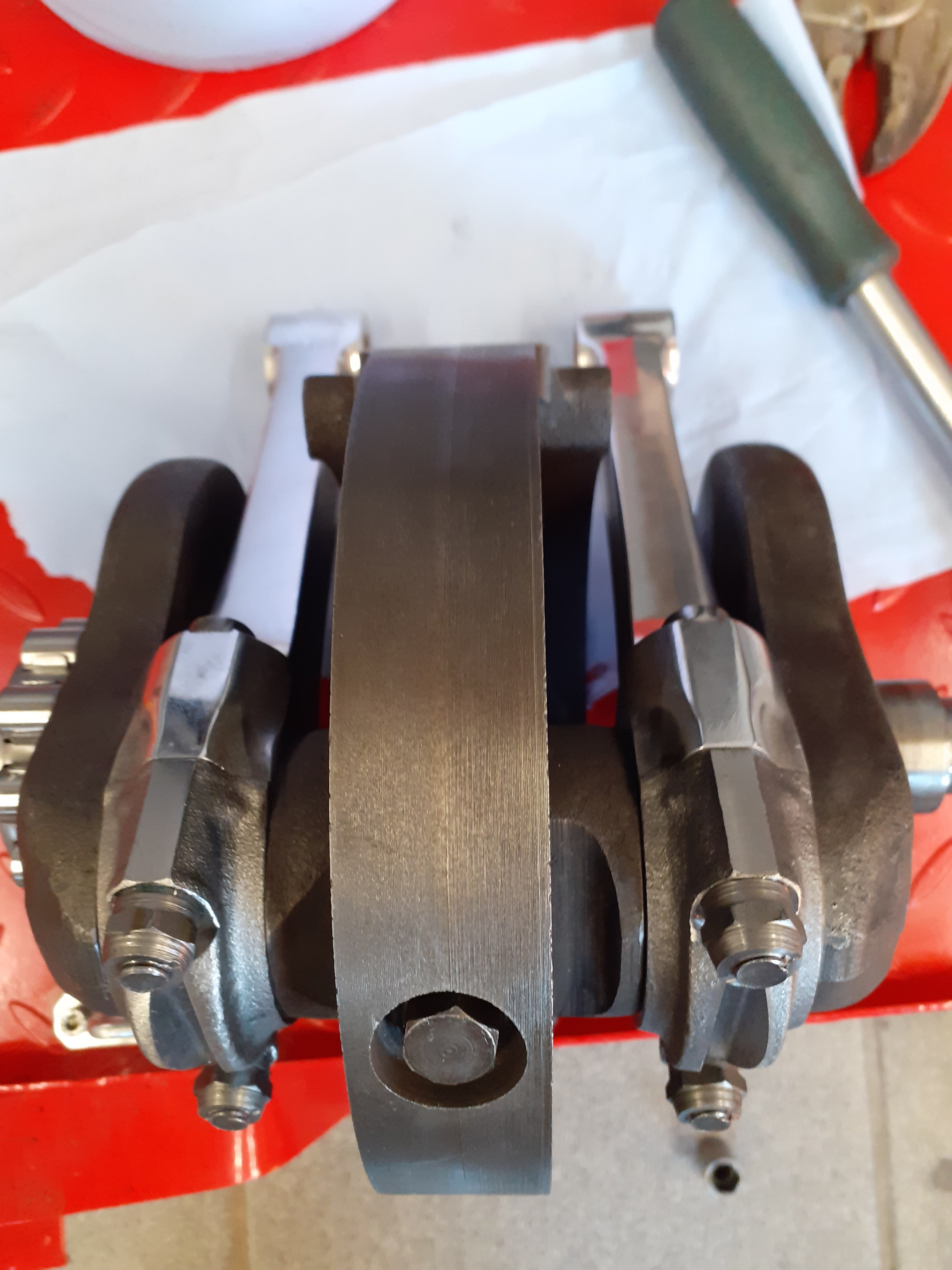

    7,568
    Sludge trap cleaned out and crank ready to go back in cases with new bearings [​IMG] 20191017_154832.jpg

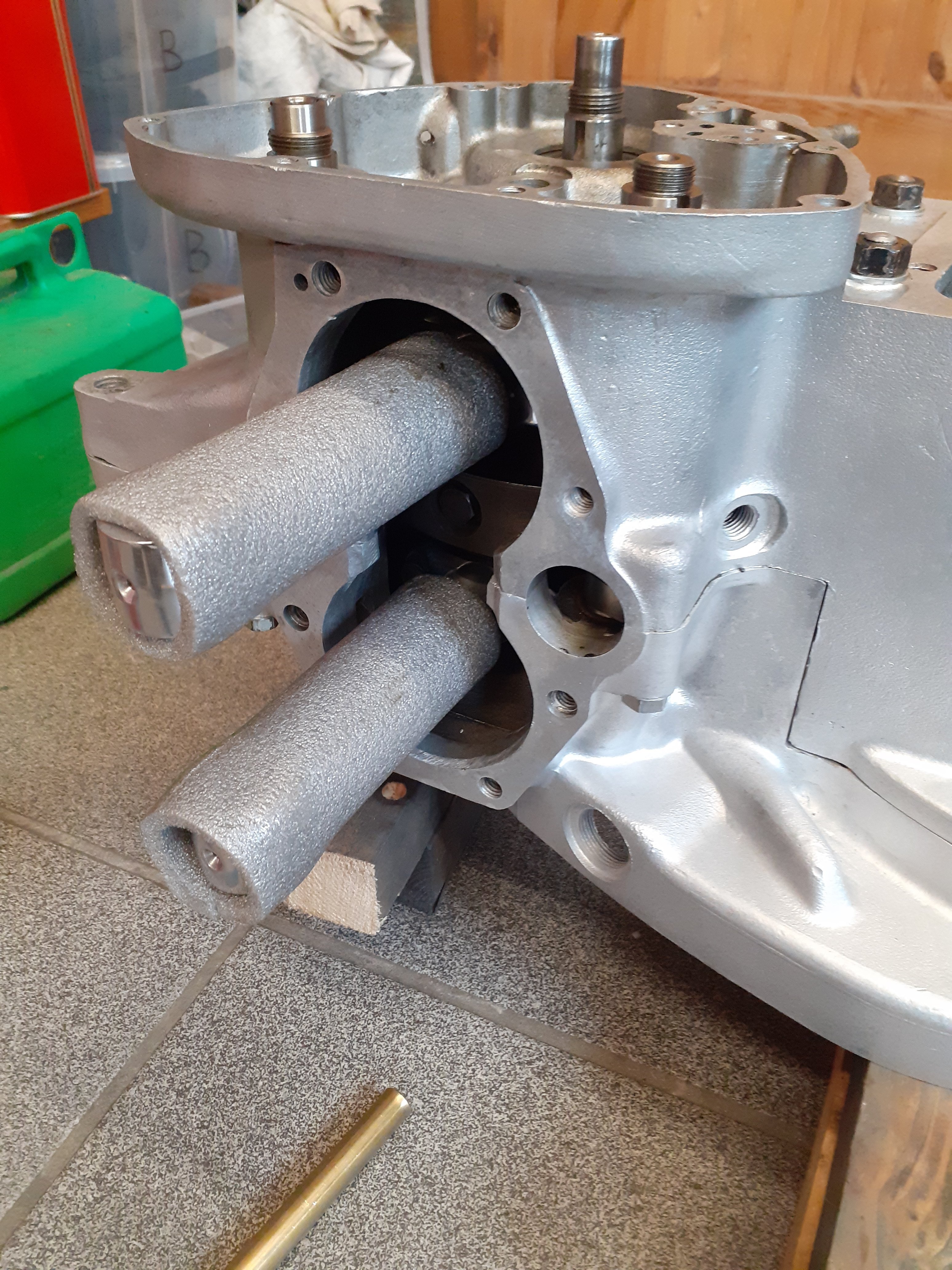

  15. darkman

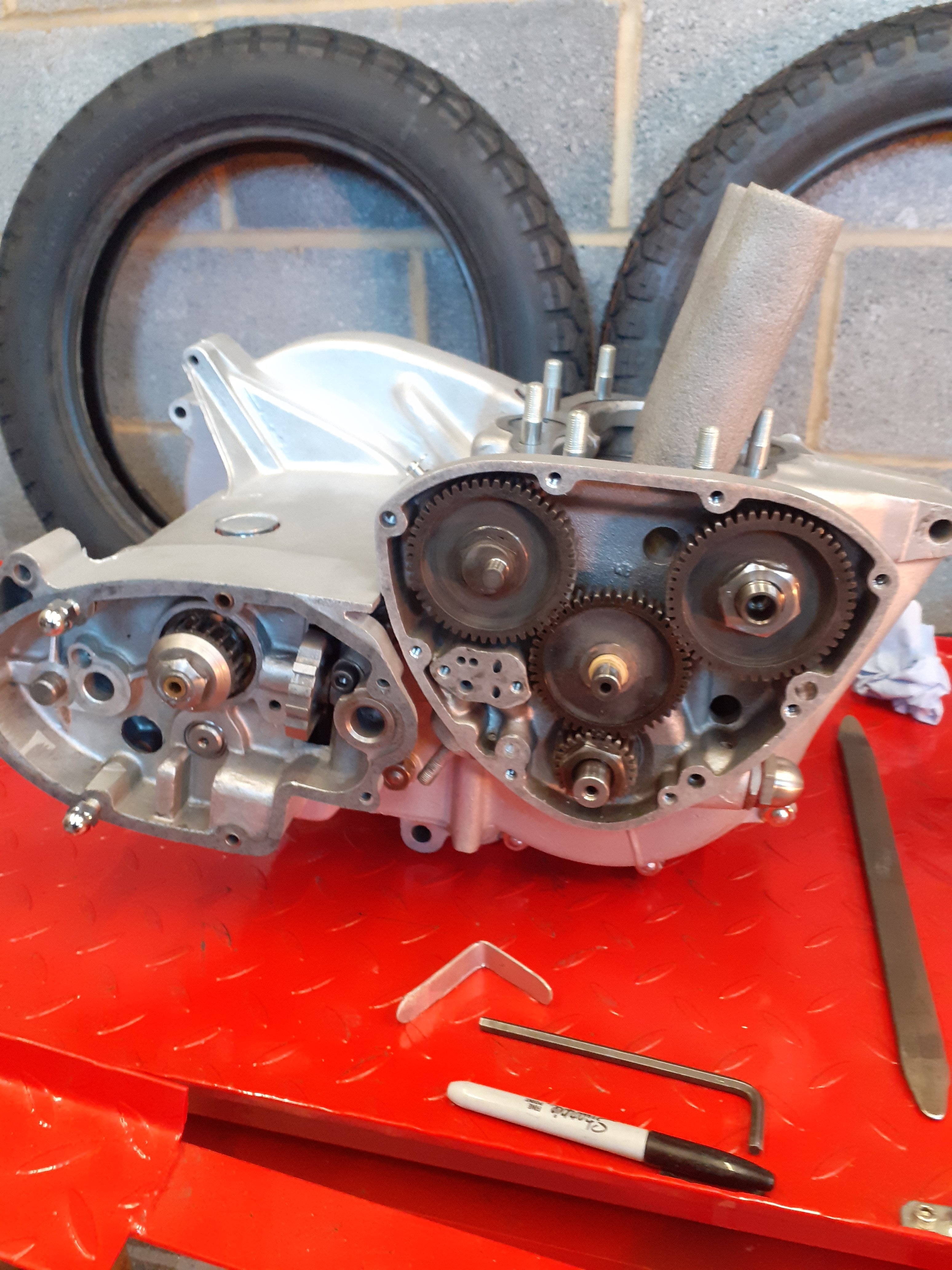

    7,568
    Another step forward cases all blasted and cleaned out with the 66 T120, new rods n shells fitted along with new bearings cams and breather valve.

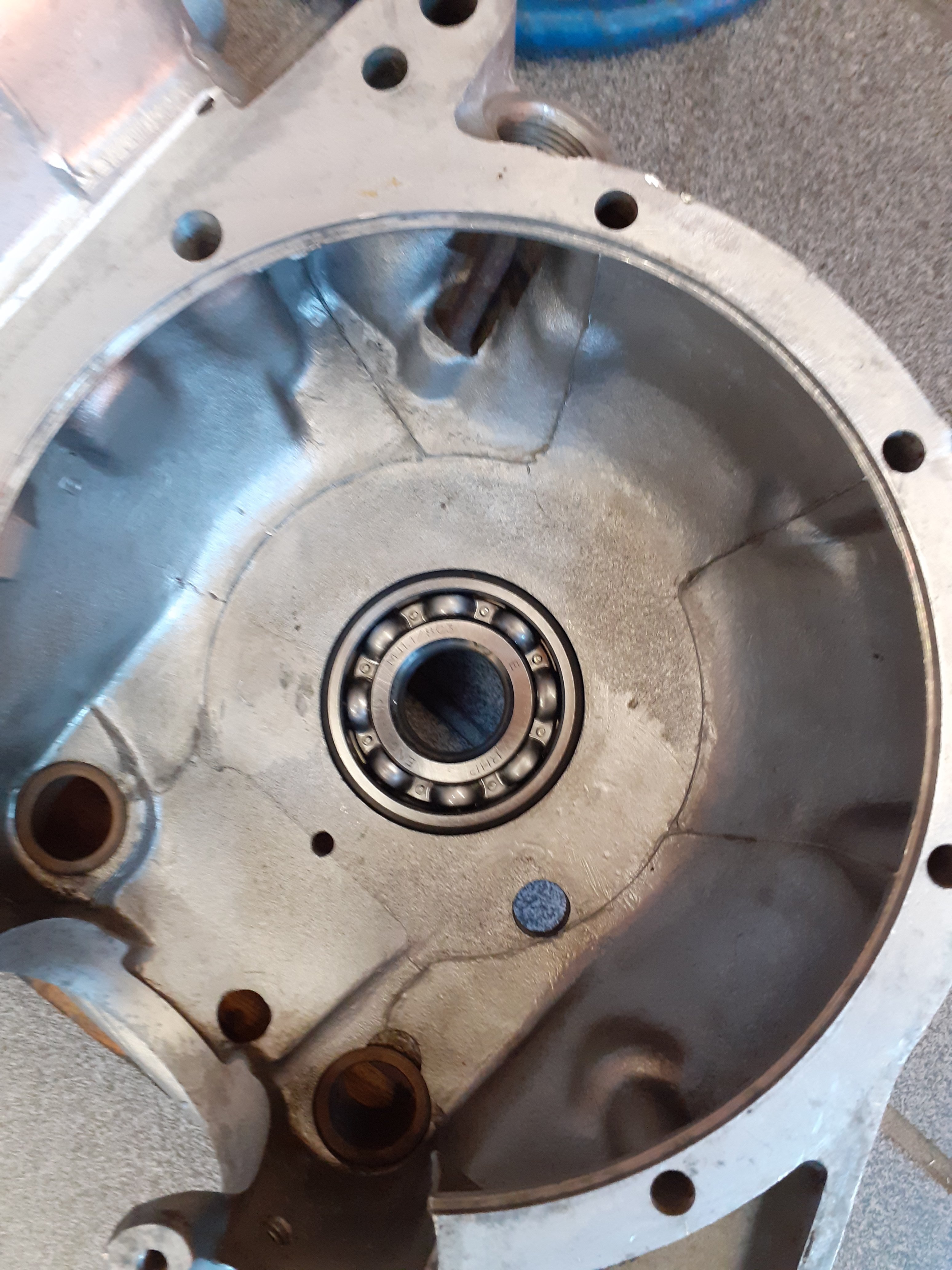

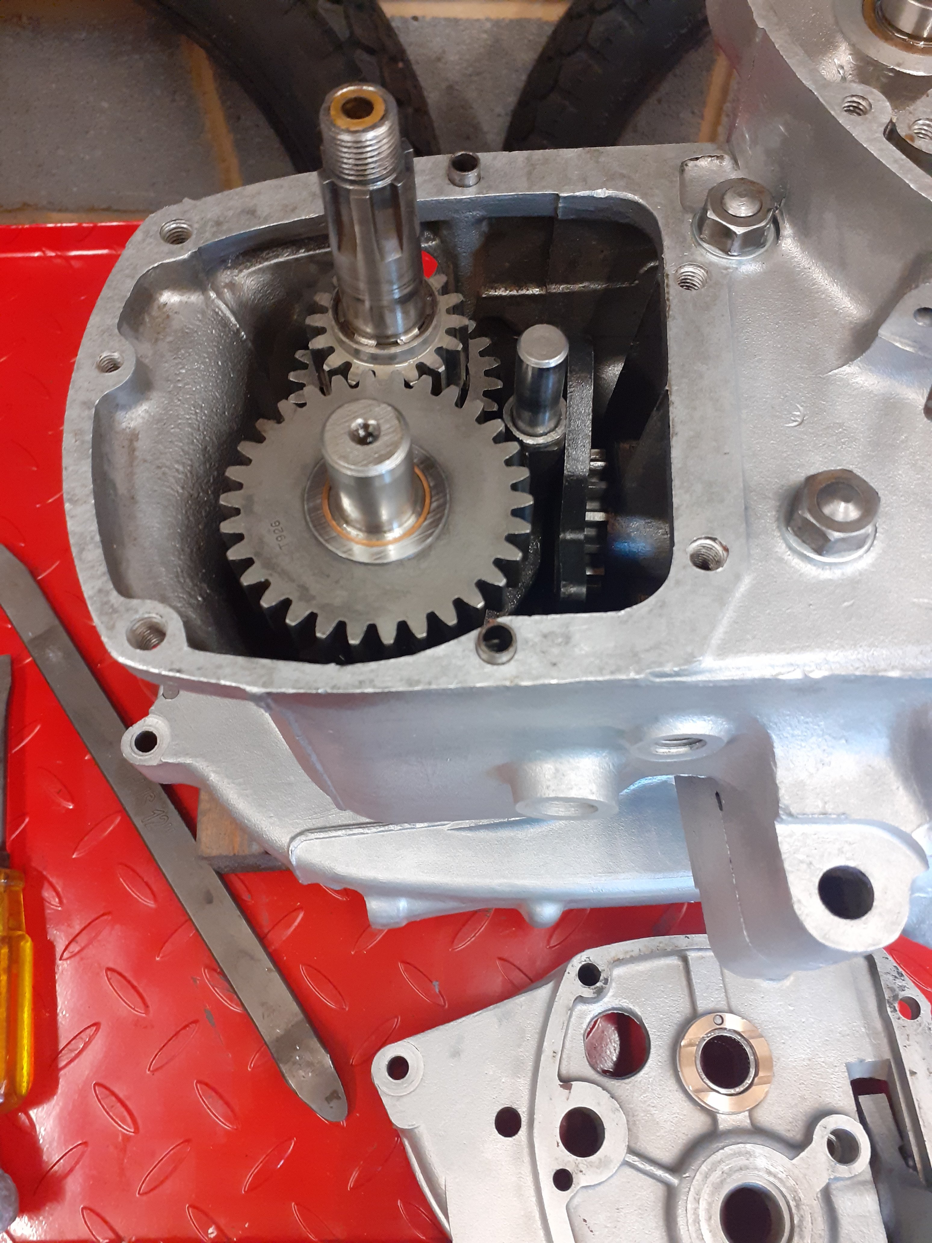

    Todays little job poping gearbox back together with new bearings inc needle rollers and thrust washers, first gear bronze bush was messy so fitted a new one and all ready for indexing and outer covers next. 20191021_161845.jpg

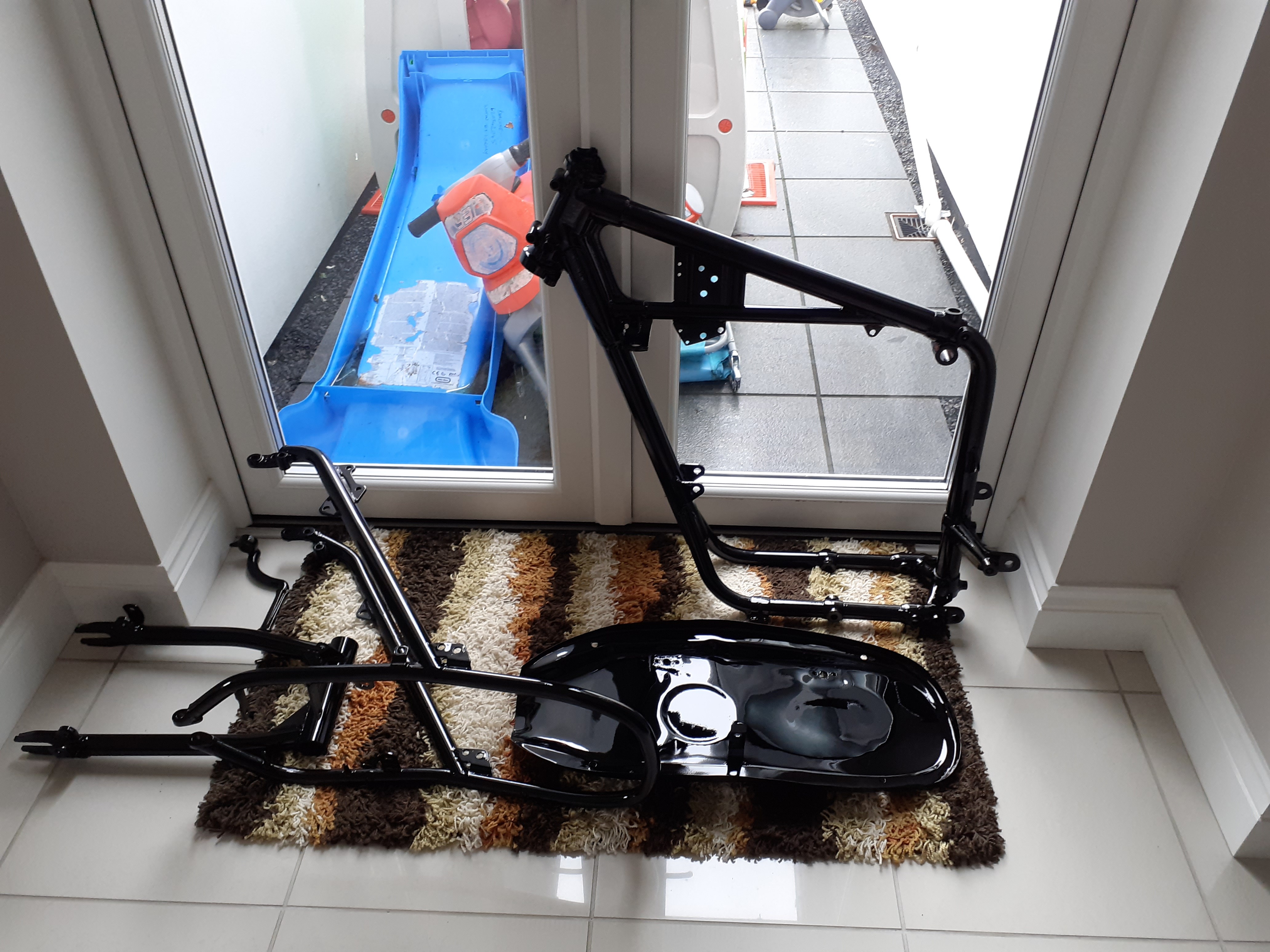

    Few more little jobs done in between prepping frame for paint i managed to index the gear selector and middle cover along with setting up the cam gears. 20191027_121514.jpg
  18. darkman
    7,568
    At last the easy bit has arrived as nearly all the prep work is done and i can start the final build of shiny bits.
