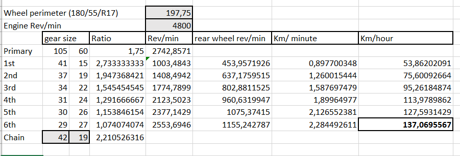

    I quikly made an excel sheet to calculate differences.
    18 teeth sprocket at 4800 tr/m:
    Same with 19 teeth sprocket
    I hope I didn't outdid the calculation, but looks like it's realistic.
    If someone wants to play with my excel sheet pm you email, I'll send it.
    Just gonna add the perimeter calculation from tire indication.

    Received the 19t sprocket.
    It's now on the bike. Despite a new 4 weeks lockdown starting and a 10 km restriction, I made 2 rides to compare. One alone, one with Madame.
    I will keep that 19t instead of the 18t. It's smoother, imho better adapted to the engine torque curve.
    The bike still have enough power to catapult me in a few seconds.
