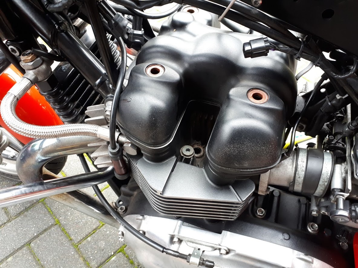

    Here are some pictures, which show how easy it is and might help if anyone fancies giving it a go but wasn't too sure. :grinning:

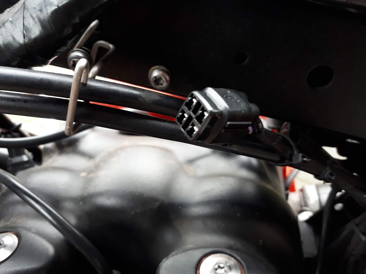

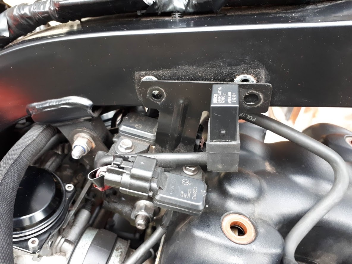

    Remove the seat and the two bolts holding the tank on. You need to lift the tank up and lean it against yourself as you stand on the RH side of the bike so you can access the electrical connection, fuel hose and breather pipe underneath. This is why it pays to have the tank empty - its bloody heavy when full!
    Disconnect this connection.

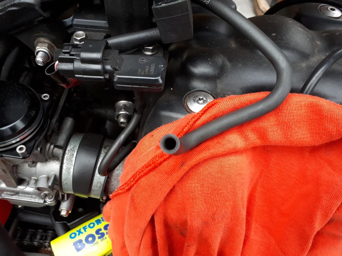

    Pull off this breather hose.

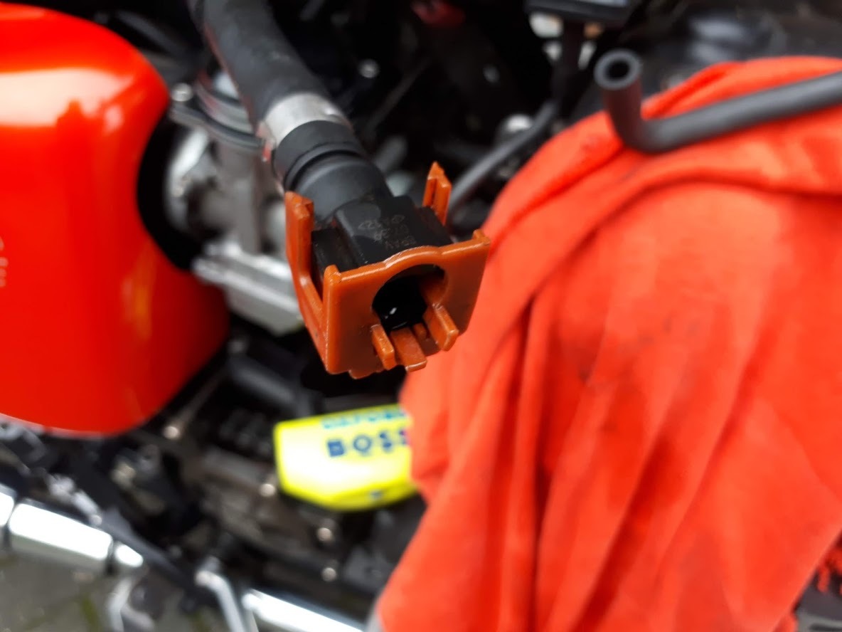

    Push the orange collar down on the fuel hose connector and squeeze both sides in until it pops off.
    Remove the four cam cover bolts with (they are Torx head bolts).
    Remove spark plugs.
    You need to unbolt this to enable the cover to be removed.
    This is what's under there from the LH side of the bike. The cam lobe on the exhaust valve is pointing straight up, the other is the inlet valve.
    Checking the exhaust valve from the RH side - cam lobe should be at the position shown (about 11.00 o'clock). The exhaust clearance should be between 0.25 - 0.30. Mine was spot on at 0.26. (the inlet clearance is 0.15 - 0.20).
    Job done :grinning:.
