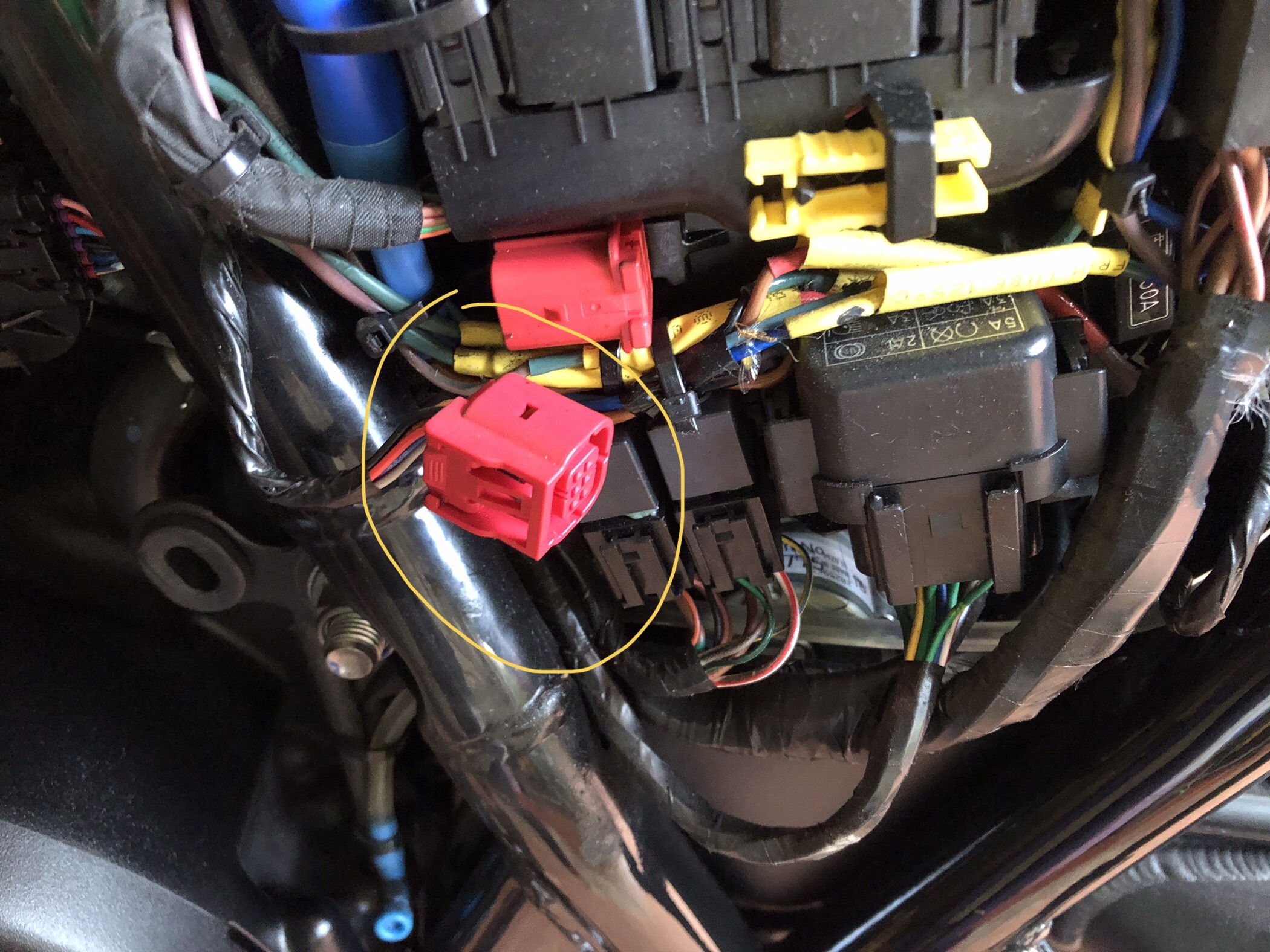

    Can anyone please tell me where I can connect to turn off the check engine light. On a triumph scrambler xe 2024. Is it under the seat or side cover. Can’t find it on the 2024

    Red 6 pin connector behind the LH sidepanel.

  16. Tim Warner

    On the 2024??
  17. Pegscraper
    Pegscraper Elite Member
    Jun 12, 2020
    3,869
    #17 Pegscraper, Aug 19, 2024
    Yes.
    I assume by "turn off the check engine light" you mean read and clear the fault code?
    The 2024> bikes have a new 6 pin connector instead of the earlier 16 pin connector with updated firmware/software.
  18. Tim Warner
    Tim Warner New Member
    Jun 1, 2024
    Florida
    Yes. Thank you so much. You rock.
