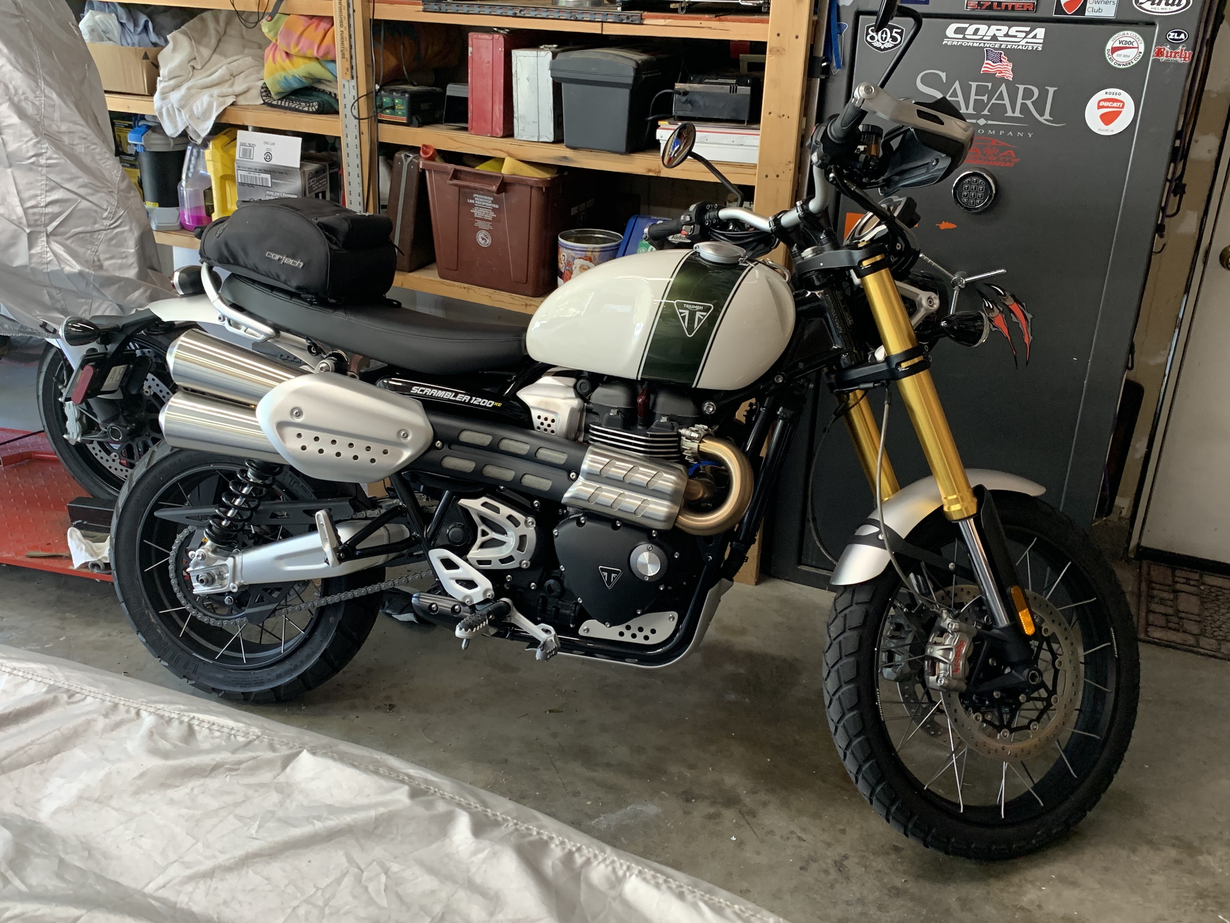

    Has anyone had to use or tried to use the emergency key transmitter under the seat? My new 1200XE has been in the shop all week and the technicians can’t seem to get the bike to recognize the regular keys for use when the key fob fails.
