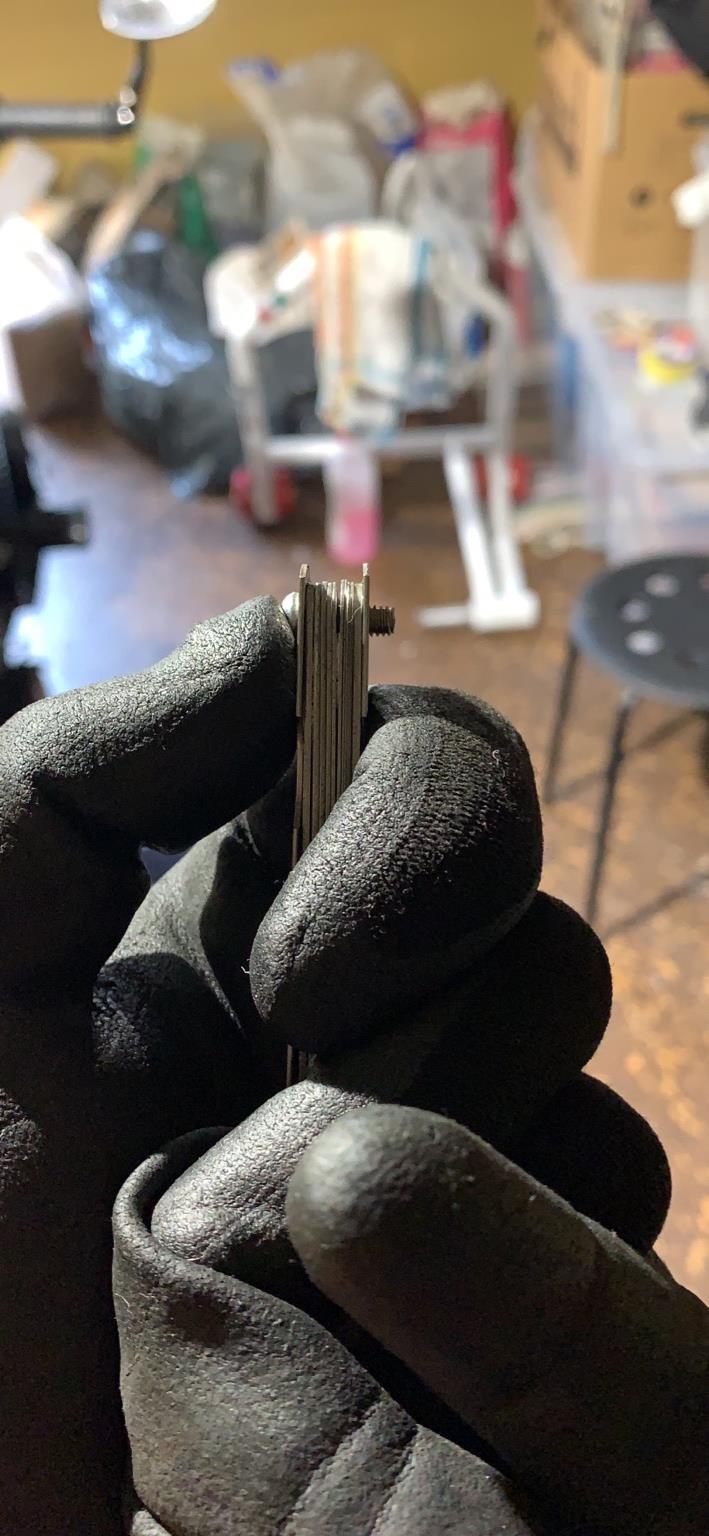

    Half way through measuring away I noticed that I had lost a nut on the feeler gauge set.
    Trying to find a small nut in the engine wasn't the easiest task. Had to have a beer and started a search party in the sheed.
    And managed to find it on the floor after an hour.
    Its nice to deepen the relationship with the bike.
