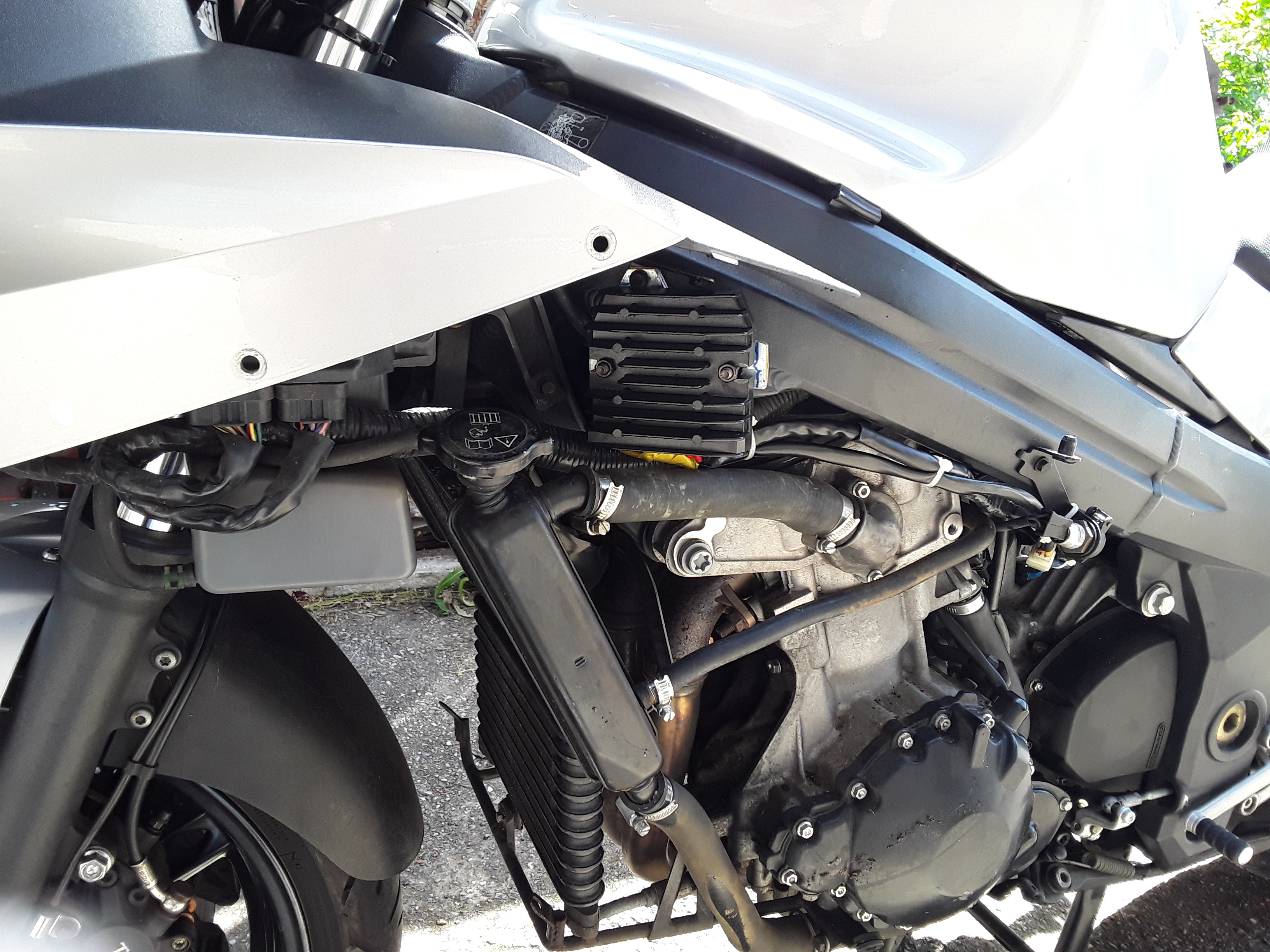

  3. Hubaxe
    Mar 25, 2020
    1,718
    Aix Les bains - French Alps
    Voltage regularor now on the left side
    I extended the cables and made à bracket from aluminium.
  4. Hubaxe
    Mar 25, 2020
    1,718
    And here it is
