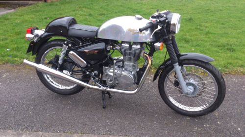

    Thanks guys. if I don't re-map or change air box. can I just change zorsts? I put TOR,s on my thruxton in 2006 but that was a carb bike. im not after more bhp just for it to sound like a motorbike. This is my part ex, a RE clubmans so I will have plenty of power with new Bonnie

    What was that clubmans like out of interest??

    I liked the RE Clubman. It ticked a lot of boxes ... I like the café style and the sound was proper, an old bike with up to date brakes and electrics. easy starter and no oil drips. I wanted a bike with longer legs and smoother at 60-70 mph. I think it would make a great second bike in the garage. but needed the part ex dosh
